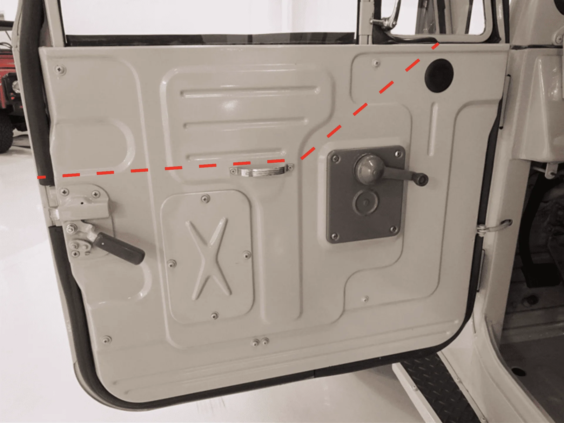

Do you have any pictures on the construction of those half doors?
No process pics. Sorry. Basically I found some donor doors that needed some work so I didn't feel too bad defiling some pristine ones.
Then I decided on the profile I wanted. Not my original pic, but borrowed to show the pattern I chose. I wanted the height of the B pillar to continue across the door and then the angle up to the front hinge was decided by wanting to keep good strength there and avoiding access holes.
After I cut the doors equally, my body guy and I added caps. I'll get some pics next time I'm at the garage. I am converting the window crank hole to house speakers. Trading windows for speakers.
