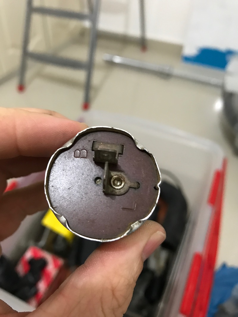

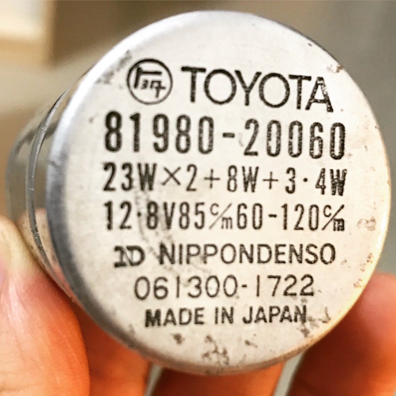

But I want something Toyota under there. The OEM part was still installed in the truck and the wiring harness had simply been diverted to the replacement flasher. My OEM flasher relay is this one...
I don't think it's broken, it just a resistance issue that keeps it from working. I bought a new one (still available in region) and it didn't work either.

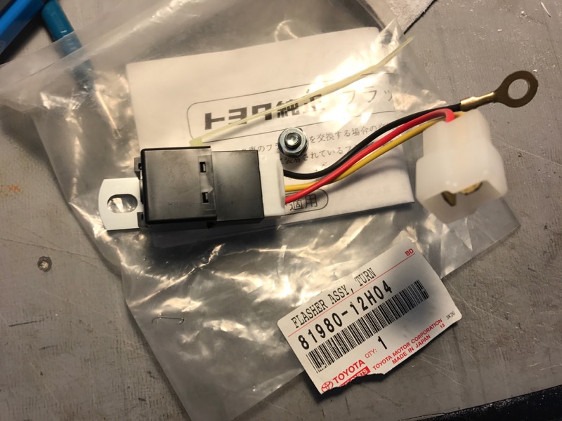

In any case, somewhere on the forum I'd read about replacing the old ground-based unit with 81980-12H04...
So I popped it in and it didn't work.
The B and L connections seem to line up... from my original flasher:
...to the right ones per the instructions...

When you tried the new, non original, Toyota flasher, did you ground the black wire with the ring terminal? Won't work at all without that ground.

If they don't come on at all then defective flasher, or flasher not grounded (OEM can flasher does NOT require the case to be grounded. The REPLACEMENT Toyota flasher DOES require it to be grounded through the black wire.)

One last cause could be that someone (whoever put the Wagner flasher in) may have swapped the B and L wires in the two pin flasher connector to make it work. The Green/White wire should go to the B terminal and the Green/Blue to the L terminal.

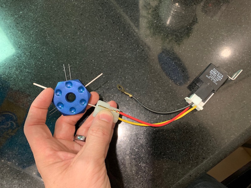

So... I'll spare you the test and whatnot that I did in terms of what worked, didn't work, etc. I know my lamps were all OEM as all the light housings were replaced with brand new OEM units including lamps upon the rebuild. When I finally tested for your final comment (someone swapped the B and L wires) everything worked out. Ha! Sure enough I found the splice were they'd done this.
So with some quick work of my plug/pin tool...
...I had the problem corrected.
