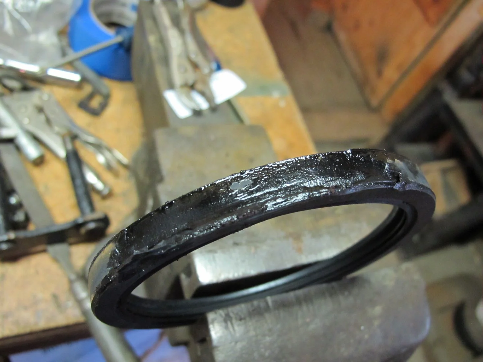

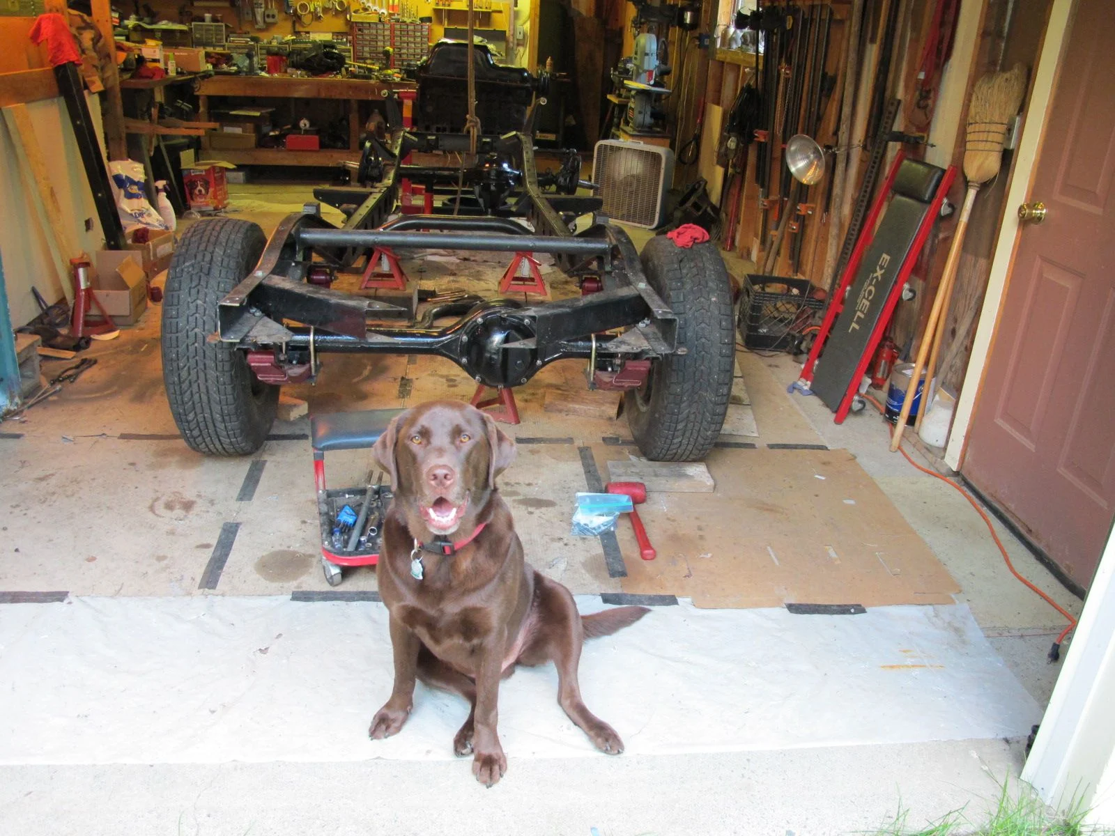

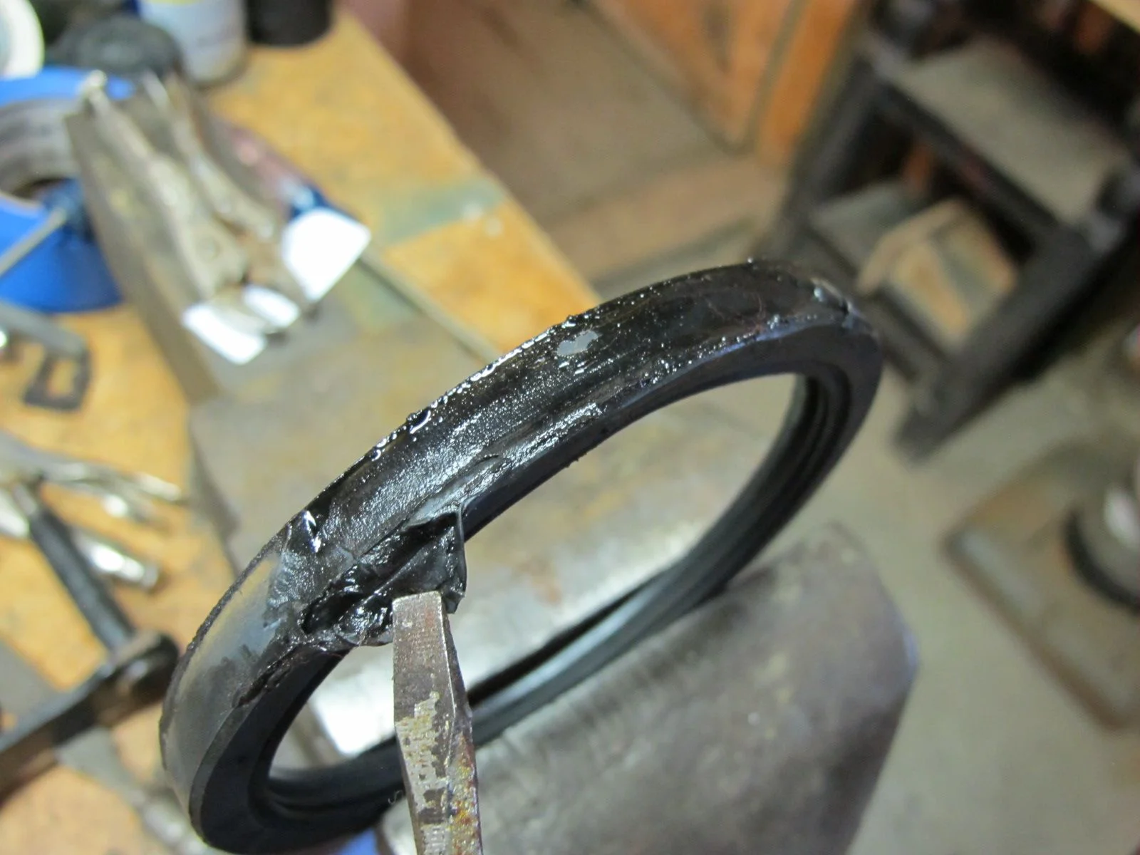

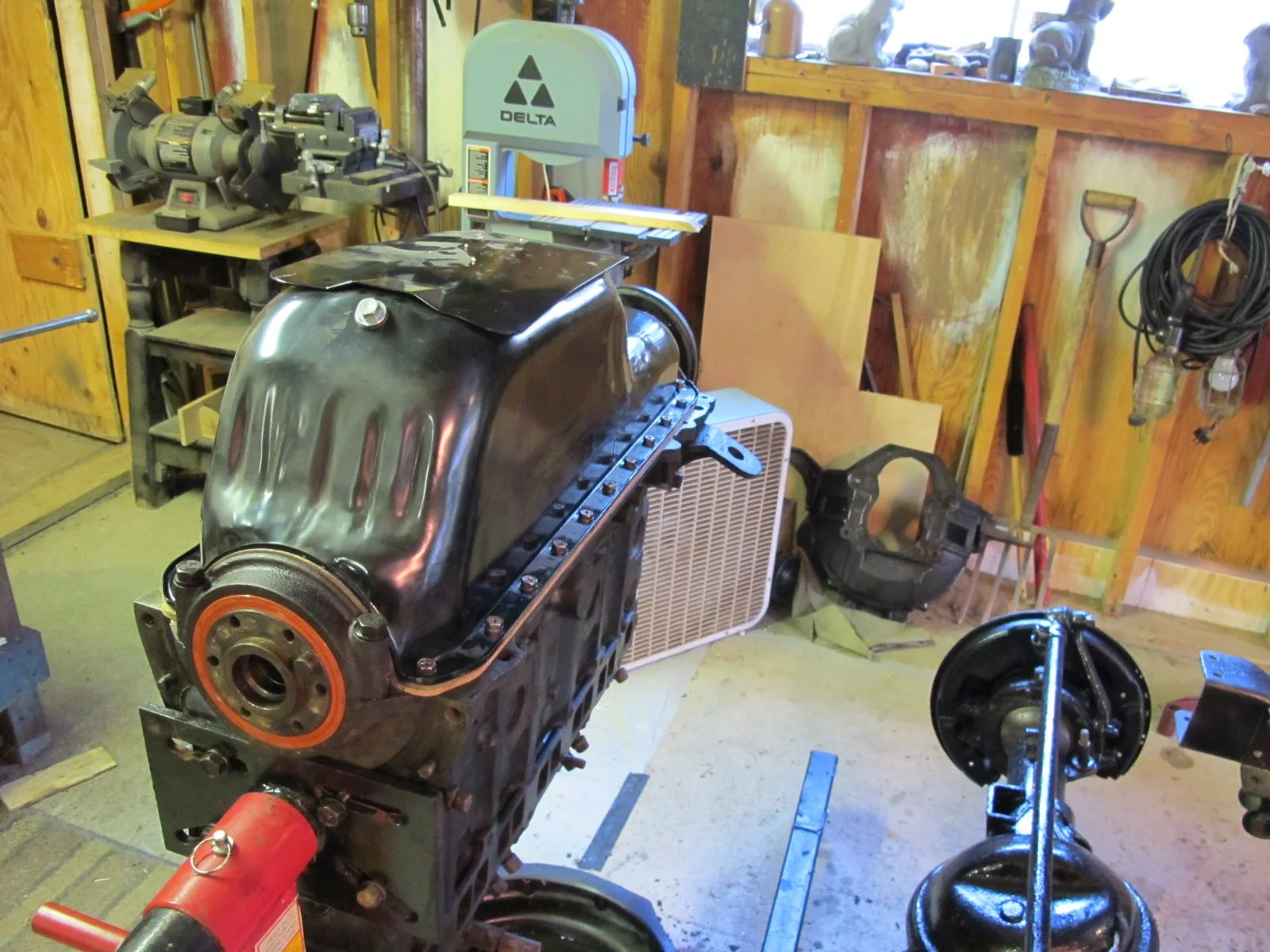

With my trustful companion, who loves in the face consultations I got the front and rear differentials overhauled, cleaned and painted. Had a real fiasco with front brake rotors for the 78 FJ40, Autozone is selling FJ60 rotors for FJ40, one vendor here on mud is selling rotors with no manufacturers or warranty info for $112 eacho_O and you don't know if they are $29 C-Techs or $79 Mountains? The donor frame needs some attention. The tube cross member has to be removed and the 78 cross member installed, will be fitting a plate on both ends and bolting it to the rails, the radiator housing mounting bracket holes will have to be relocated and a plate welded on the front left end rail for the steering dampner. I installed the new 61013 oil pan using the old style one piece 61010 gasket, it fit very well and seemed to seal with 7 ft lbs of torque to the mounting bolts, also installed a new rear main seal and could not believe what the old one looked like:eek: I had been losing oil but never saw that much leaking under the bell housing, I would recommend to anyone changing out the rear main seal to bite the bullet and change the oil pan gasket as well; I think the only way to change the RMS is to take off number 4 bearing cap and placing it in instead of using a driver. It's nearing the time to put the engine back in, a turning point.....my buddy just told me it's time to take a break and play some ball:)
