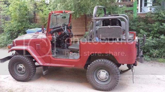

Took the top off for the 1st time in 15+ years haha. Not sure i wanna put it back on. Would love to just go soft top year round. It only is out 6 months a year

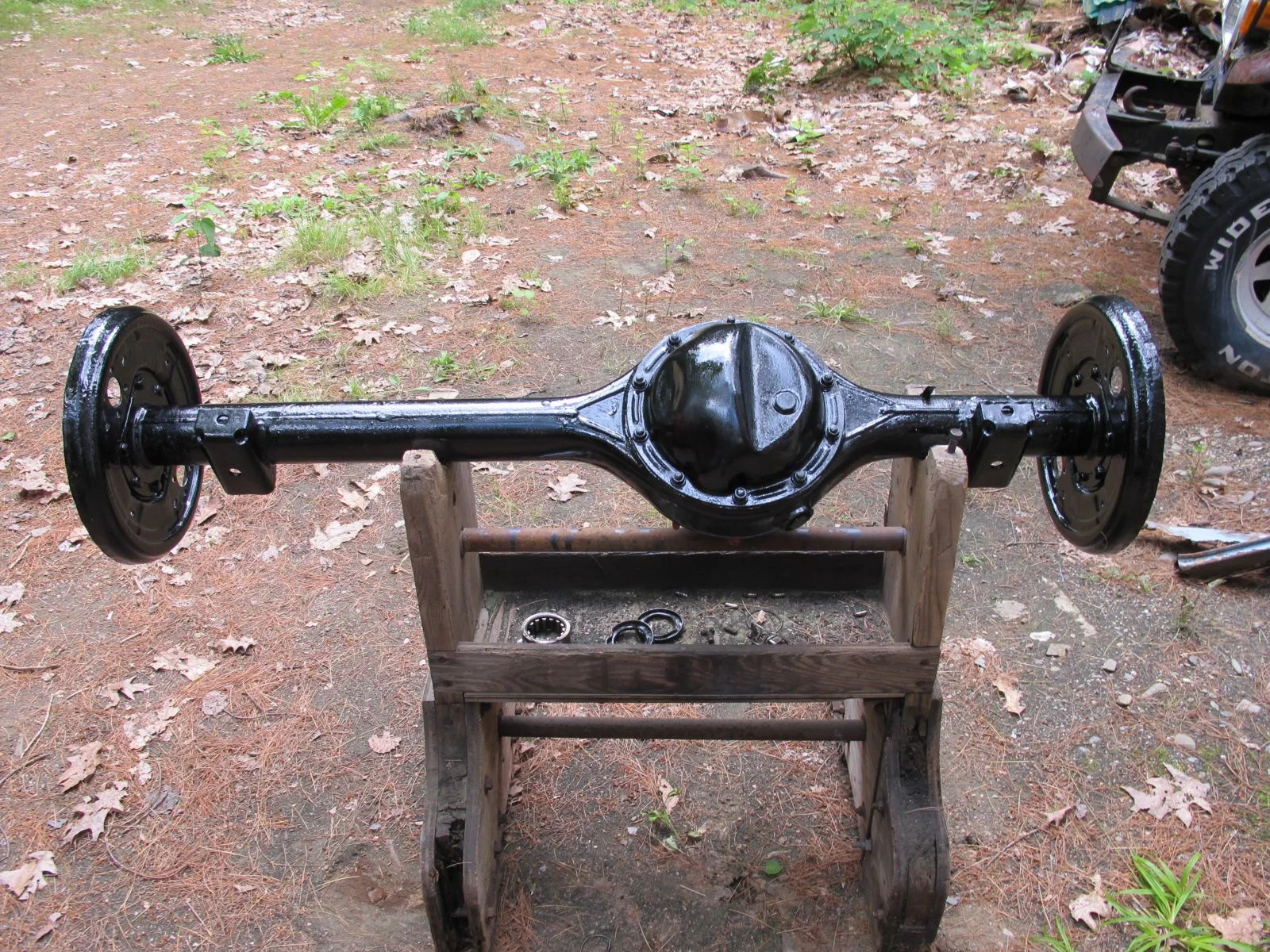

After finding this I decided to take another of my axles, which has much better leaf spring mounts, for a swap, sand blasted it, got caught in a shower and could not believe that within 20 minutes of the end of rain there was surface rust covering what I'd just blasted:bang: So I painted the axle with Krud Cutter Rustex and waited a day before I painted it with Martin Senour Rust Proof MD It came out ok.
New axle shaft bearings, seals oh, and I'm painting all axle components with the same procedure, Rustex and MD. While letting things dry I found some reasonably (or unreasonably) large flakes of metal from my front axle, I'm ok with metal flour but think it may be wise to pull the diff carrier.

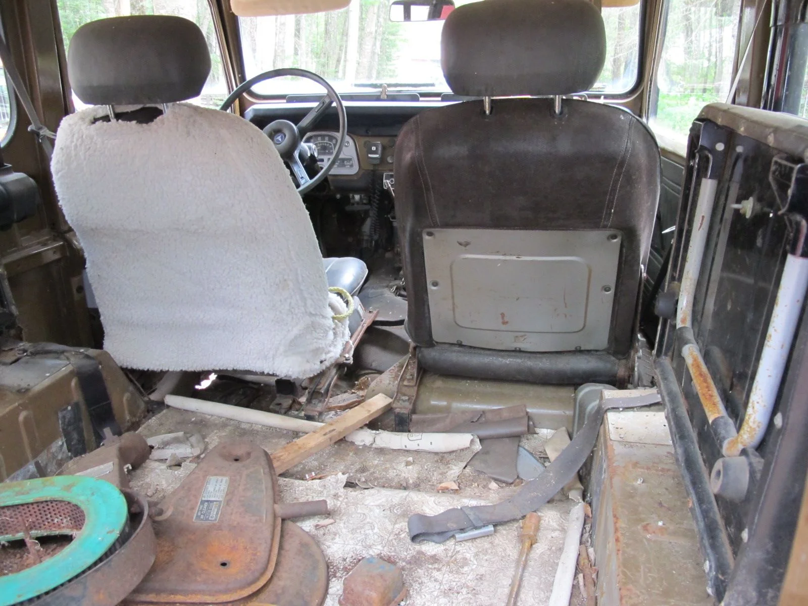

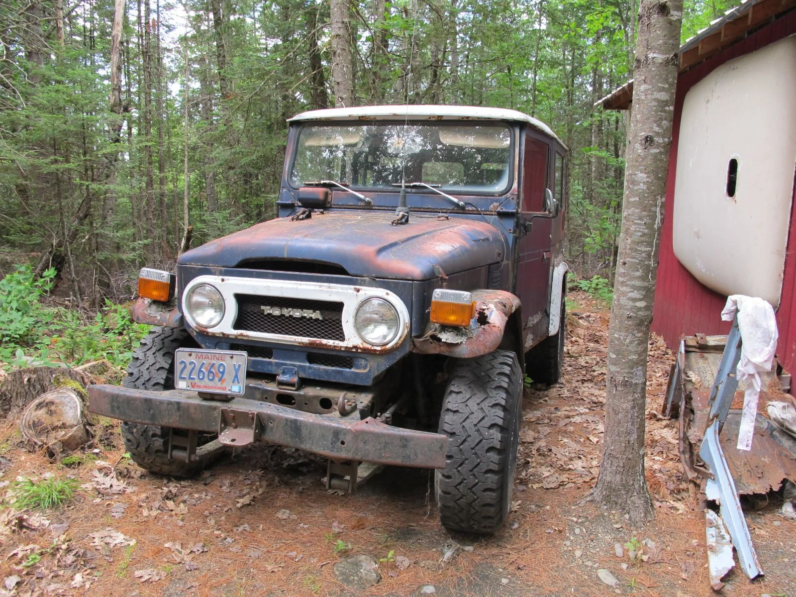

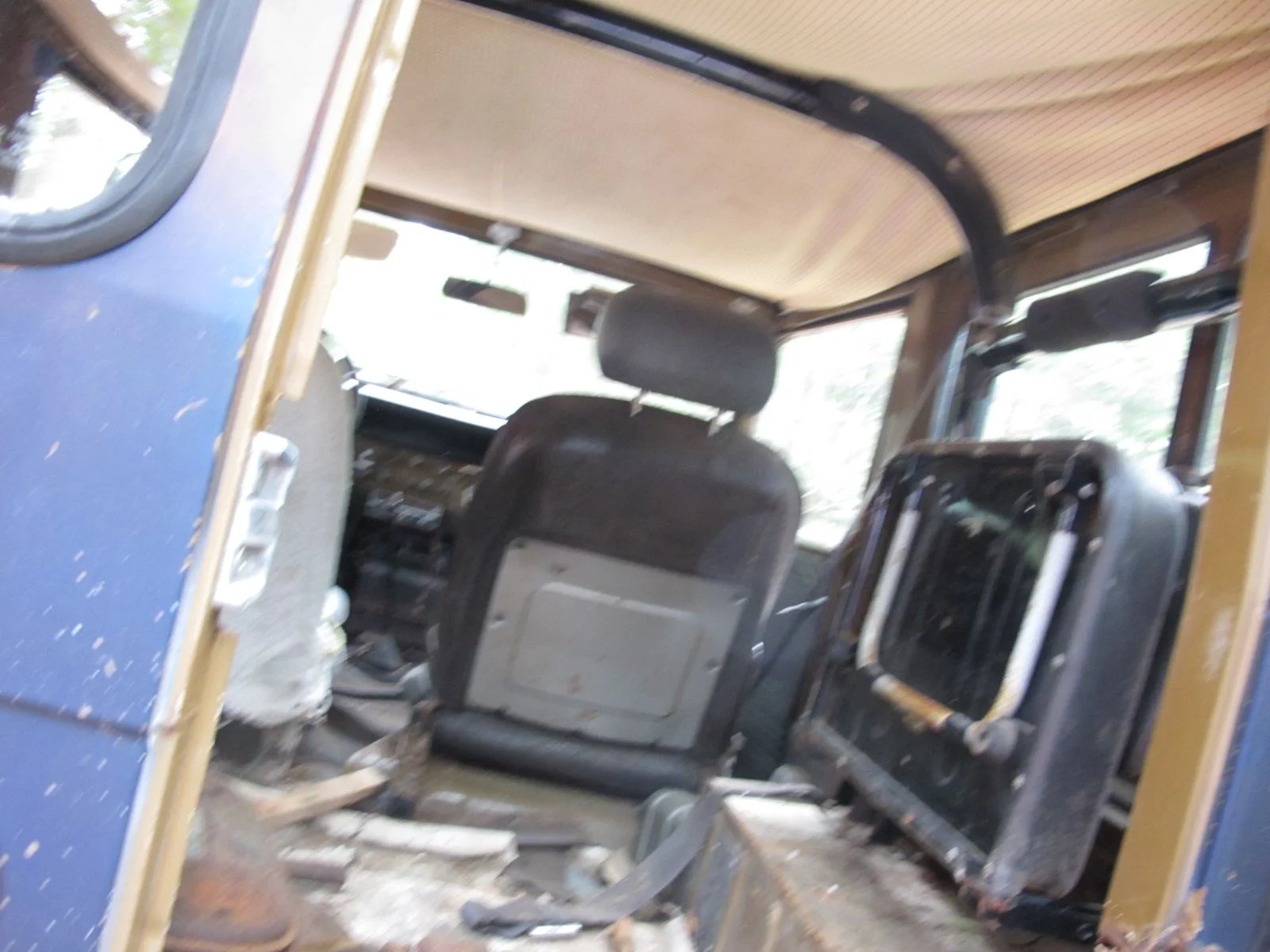

Today, I started disassembly of the front axle and found so much grease in the wheel hub that I could not remember putting there. I also found the staked washer behind the first wheel nut quite grooved by the outer bearings inner race, I'd like to know what this is all about, the inner race should not move, is it a worn steering knuckle spindle or were the spindle nuts too loose? Both sides had worn washers. Of Course I have been buying parts for this rebuild for a couple of months now and then found this donor 1977 FJ40 parts truck I figure there will be at least $1200 in parts that I can use on my 1978 FJ40 rebuild ( only paid .6K and the rest of the truck parts will go into inventory!!). So as soon as the axles are done I can bring in the new frame and go from there...
