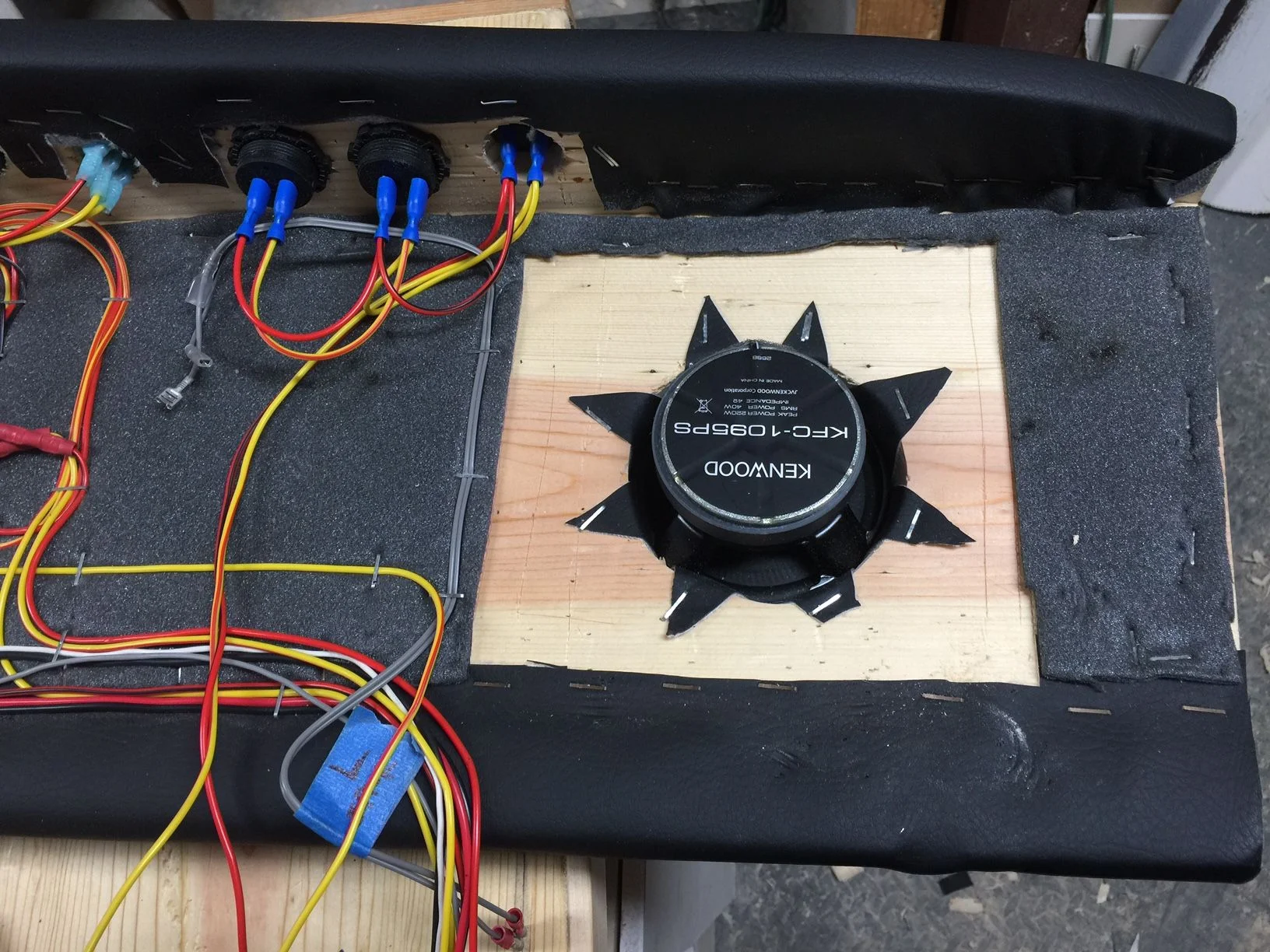

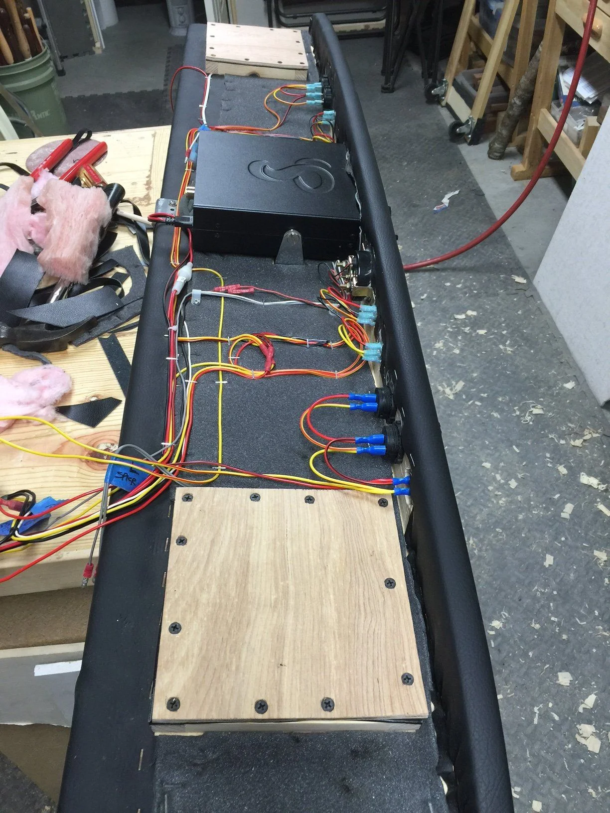

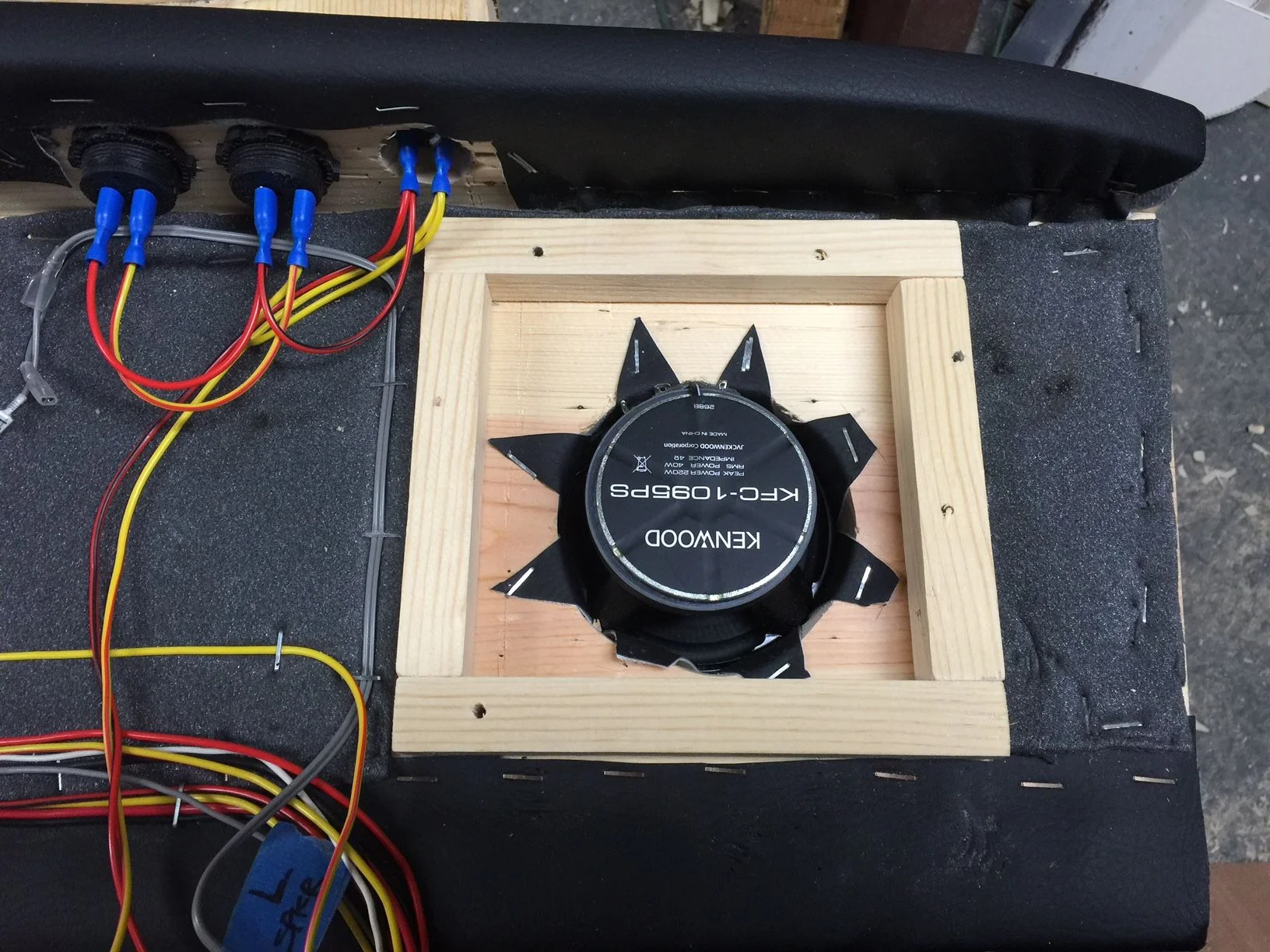

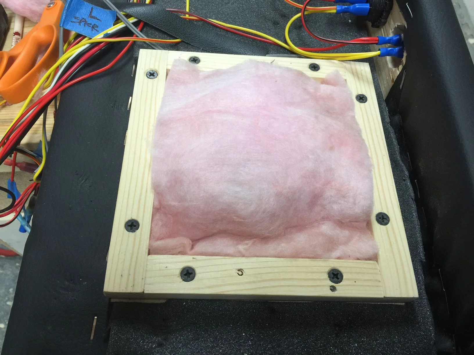

I built speaker enclosures for my overhead console, here's the process I followed. Thanks to @ginmtb and @Weber Sarge for the great ideas!
full
Speaker enclosure box construction

Counter sunk and screwed down firmly and insulation fitted

Cut top cover to fit box
full
Sealed top cover to base and screwed down
