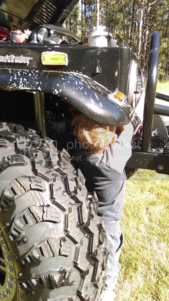

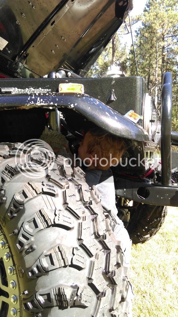

Took mine for the first proper drive (longer than 500 feet lol) since i got it back together. With head lights and brake lights and a fuse box and other vital things like that. Even took it down a couple few trails and tested out 2 and 4 low and the suspension.
Drove better than i thought it would overall and i was impressed which is a good thing i guess..
