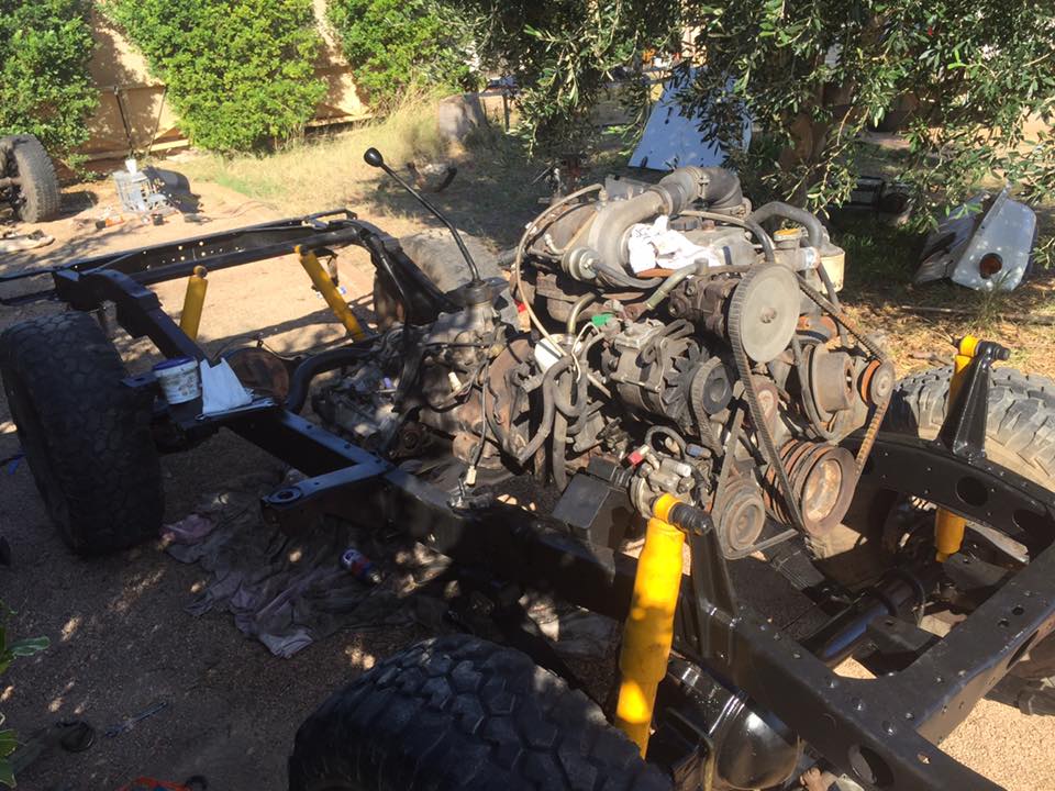

I have been working pretty hard getting this 77 torn down. Hopefully, I will get the frame to powdercoating Friday. Then get the body panels to the sandblaster.
After that I can start to get my head around all the bagged parts fixing and repainting them, and rebuilding the hubs, clutch, suspension,brakes, motor, electrical, etc etc. I sure did take a big bite on this one. I keep telling myself....one assembly at a time.
Looks good usernametaken,
