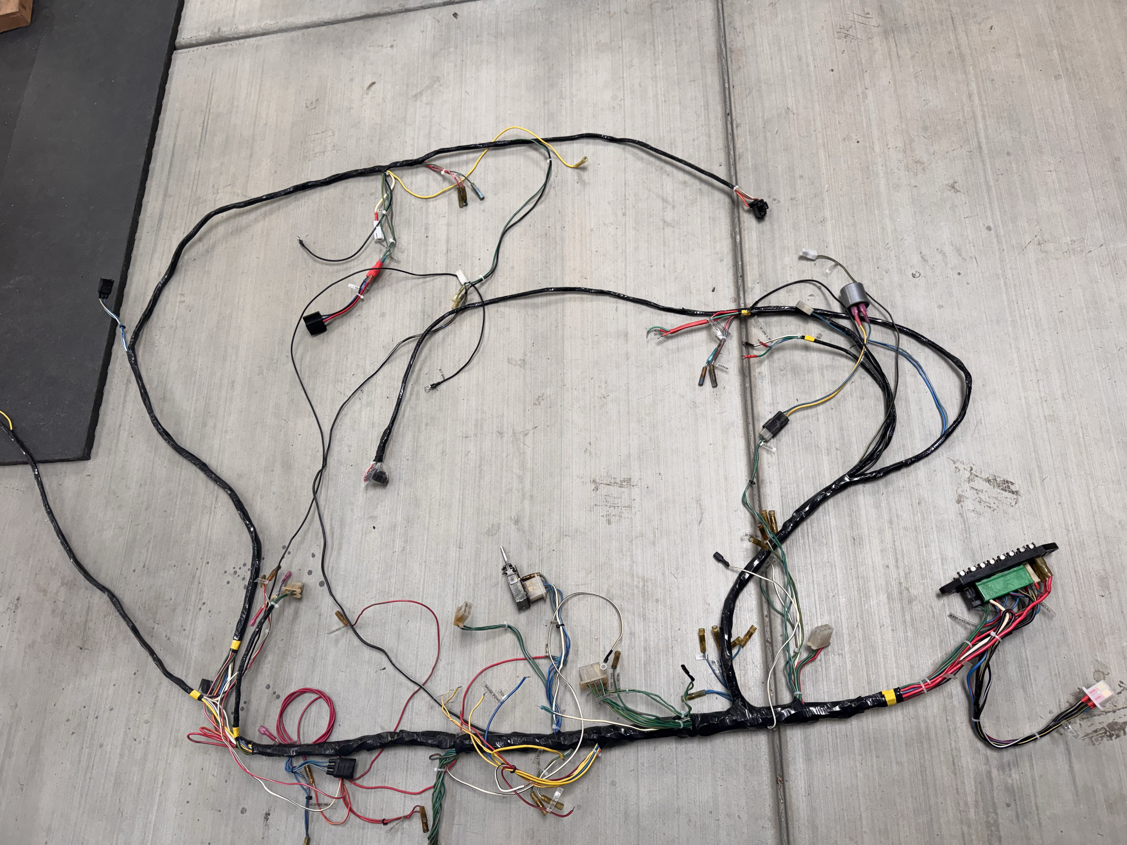

I never would have guessed the wiring harness would take this long - been in and out of the dash about 6 times now - tie it up, check the fit, out again, redo etc etc. getting closer
Yeah they do. I imagine your complete replace is a ton more work then my '79 which I just pulled every section out, cleaned the wire with simply green, fixed bad spots and rewrapped with cloth harness tape. That took me a lot of time. But was worth it. Now I can see the wire colors at each device and switch and match it to my wiring diagram for diags and troubleshooting. I replaced all the broken plugs with factory ones too.
