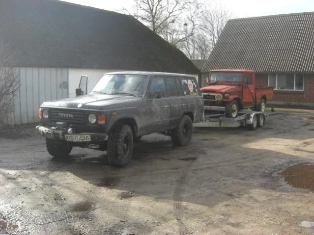

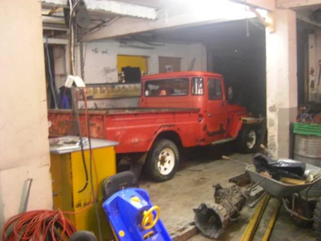

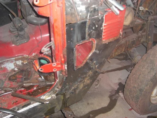

Bought a HJ45 and start welding.

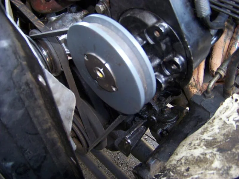

Then, I decided it was high time I swapped in the new power steering pump and waterpump that I have been carrying around for the last 6 months. I had adjusted the squeaks out of them, so there was no rush, and they had both been replaced under warranty, 'cause they were squeaking...I said. Traded in very old, not-even-trail-spare quality parts as cores...
While I had both pumps out, I took a couple pics of my Mark A. power steering pump mount...that doesn't work with the Scout box 'cause they bump into each other...that I've been promising to take for Mark A. so he can make me a new mount that will work with a Scout box on a '55. And maybe 45s too.
And then, when I got both pumps in and plumbed, I started it up...and there was a great squealing and even smoke. So I turned it off.
Seems the waterpump wasn't turning. So I took it all apart again, except for the powersteering pump of course, looked at the waterpump, couldn't see anything wrong with it and put it back on. With lots more black RTV this time.
Works fine now. Squeaks & leaks are gone. Put that sweet new powersteeringpump pulley, from IPOR on as well. I'll take a pic of that, to qualify as tech...

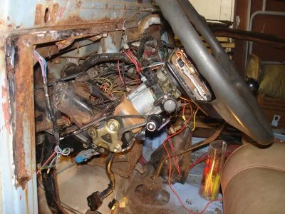

last two weeks...whew...it is done....
bought a fj62 (400 bucks), and stripped it down for the steering column, 3fe engine, electrical wiring, and anything else that looks good enough to put on the old man (my fj40, 69). Sold a few parts to a guy in Bremerton, and the body/frame to a guy in Vancouver (made back 130 bucks). Yes, that was cheap pricing, but the parking area is clear again.
That didnt last long, bought some fj40 body parts for $50. driving way not clear again.

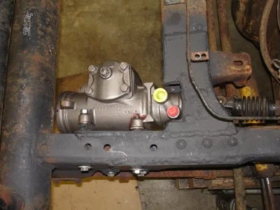

Finished the power steering mod from Power Steering Pro's. With the fj62 steering column. :steer:

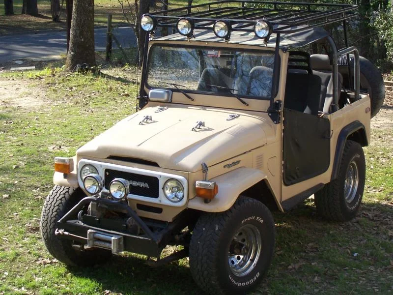

Replaced the rear end with a full floater model, added 4.11 ring and pinions, a new rear A-arm instead of the anti-wrap bar, new 10 inch steel wheels, new 35-14.5-15 boggers, new front bumper with cibie fog lights, new pro comp shock absorbers (9000 up front, 3000 in the rear), new polyurethane bushings, replaced front drums with disc brakes, and added selectable hubs.
You know, just routine changes!!!!
Pics coming very soon!!!
