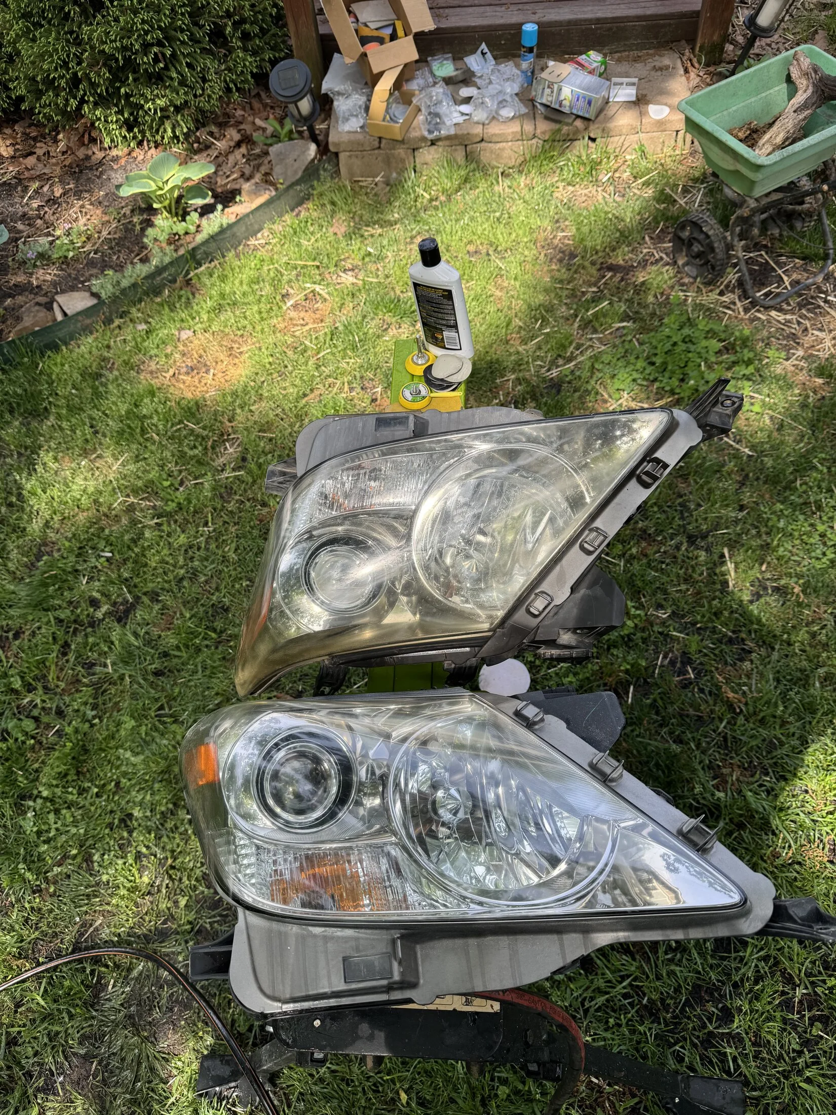

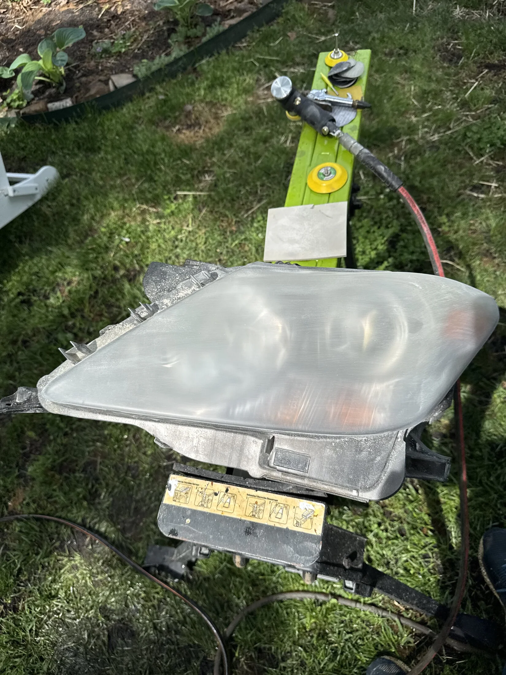

Another headlight restore post. This is my 2nd time in going on 5yrs of ownership. This time headlights off. You can really get at all the nooks and crannies this way. Started with a 3m ultra fine pad, then 800, 1200, 2000, 3000, then 5000. Finished with some Meguiars headlight polish.
They definitely do not look new, but holding off that $1200 itch to get new ones just a little longer.

Looks like you have a stock bumper.
Any insight to whether an arb with hoops would impede the headlight removal? Or think that may be able to slip out with bumper in place ?

I replaced my headlight assemblies without removing my bull bar.

You do have to remove or at least get around the plastic bumper to remove 2 of the bolts for the headlight (one of those two may be behind the grill, but the other is near where the fender and the bumper meet. @tbisaacs has replaced his headlights, but remember he has an Ironman bullbar and not the ARB. So YMMV.

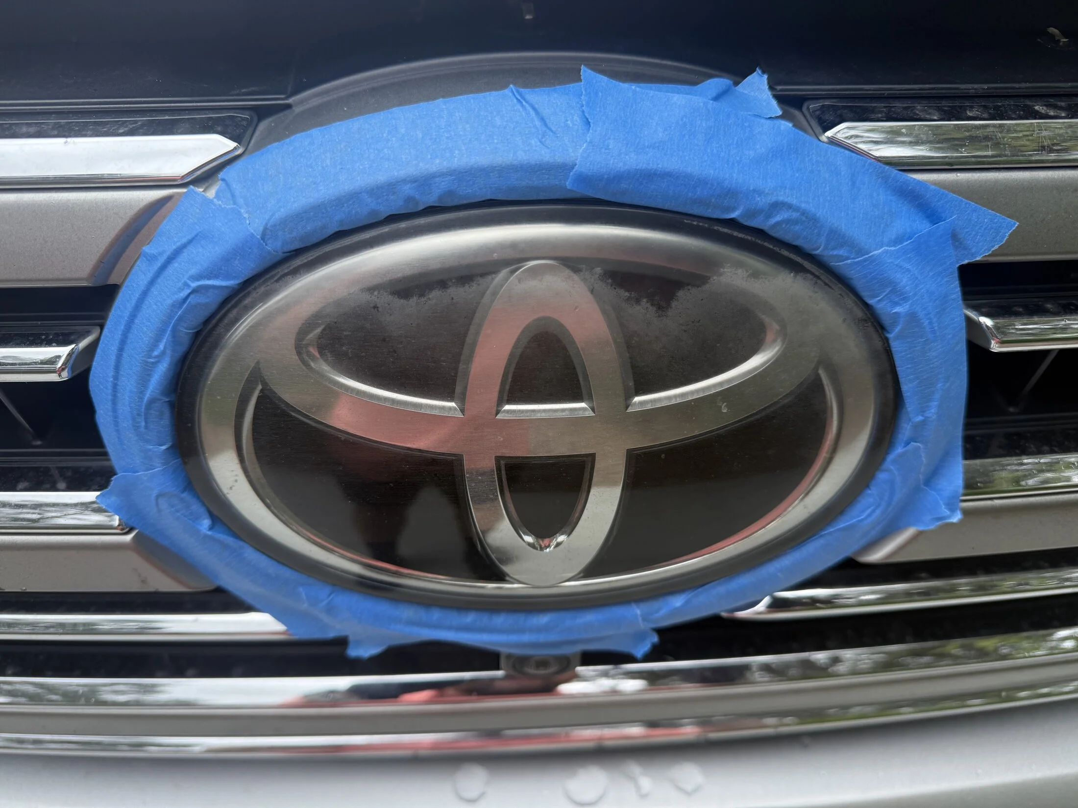

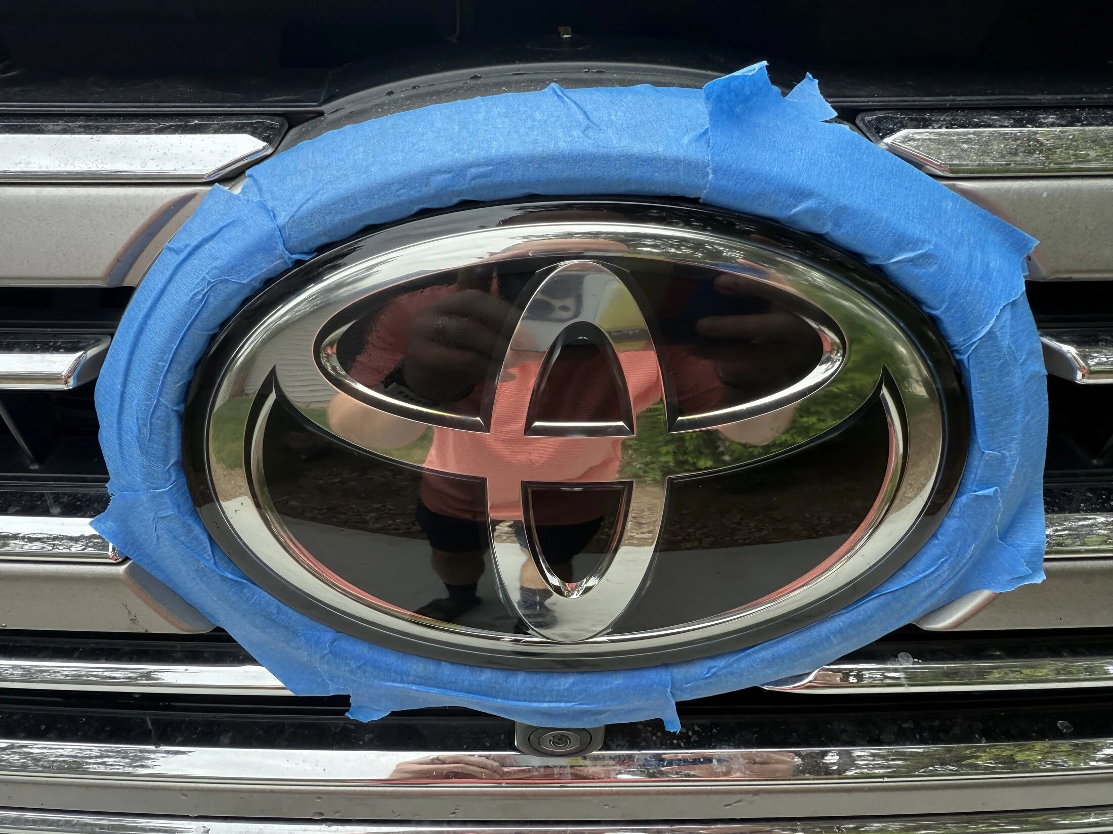

Clean up of oxidized Toyota front badge. It wasn’t in bad shape yet but I had 20 minutes between meetings to get it done. We will see how long it lasts but the $15 headlight kit from Cerakote is more than enough to do it at least one more time if needed.

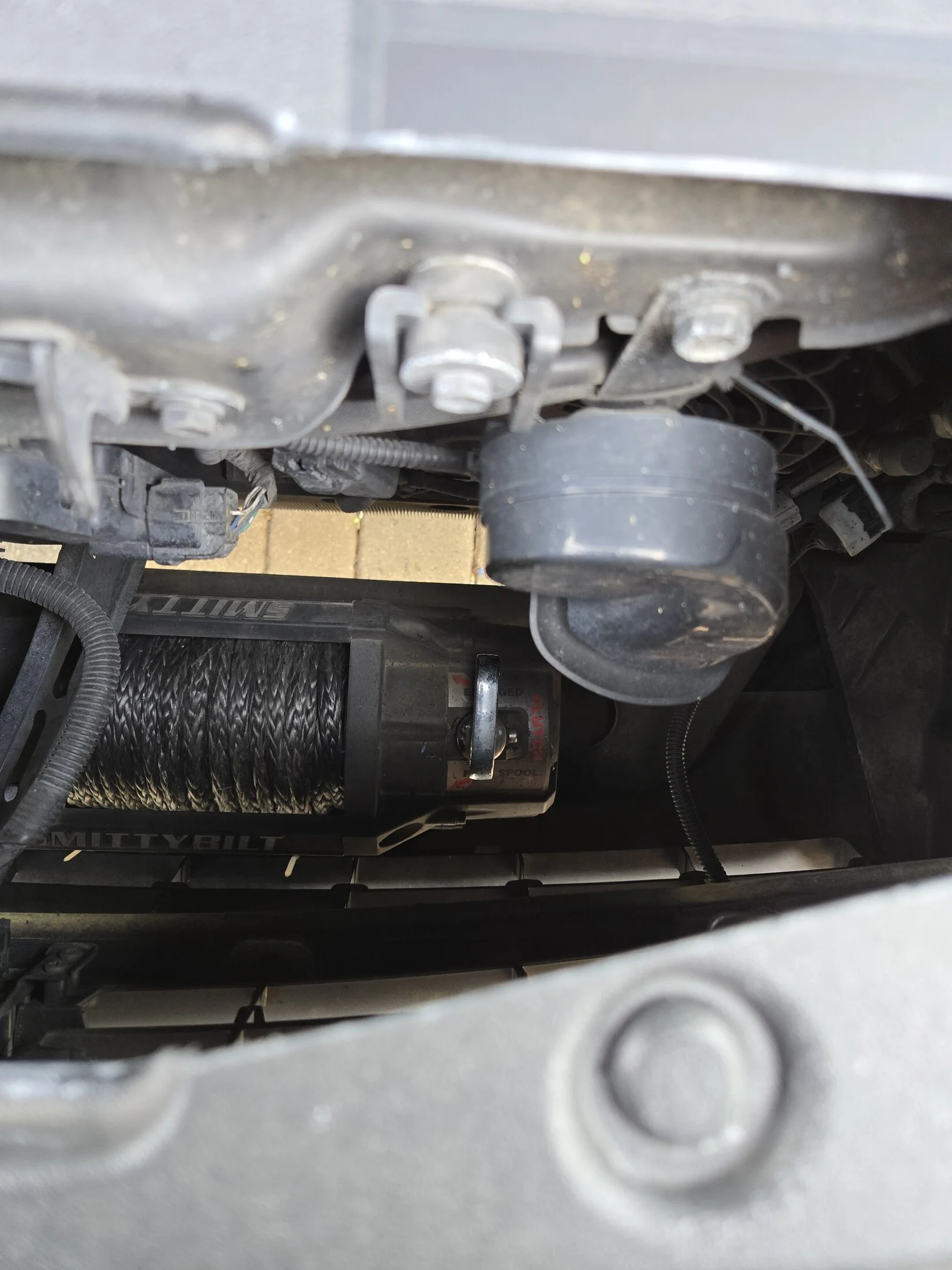

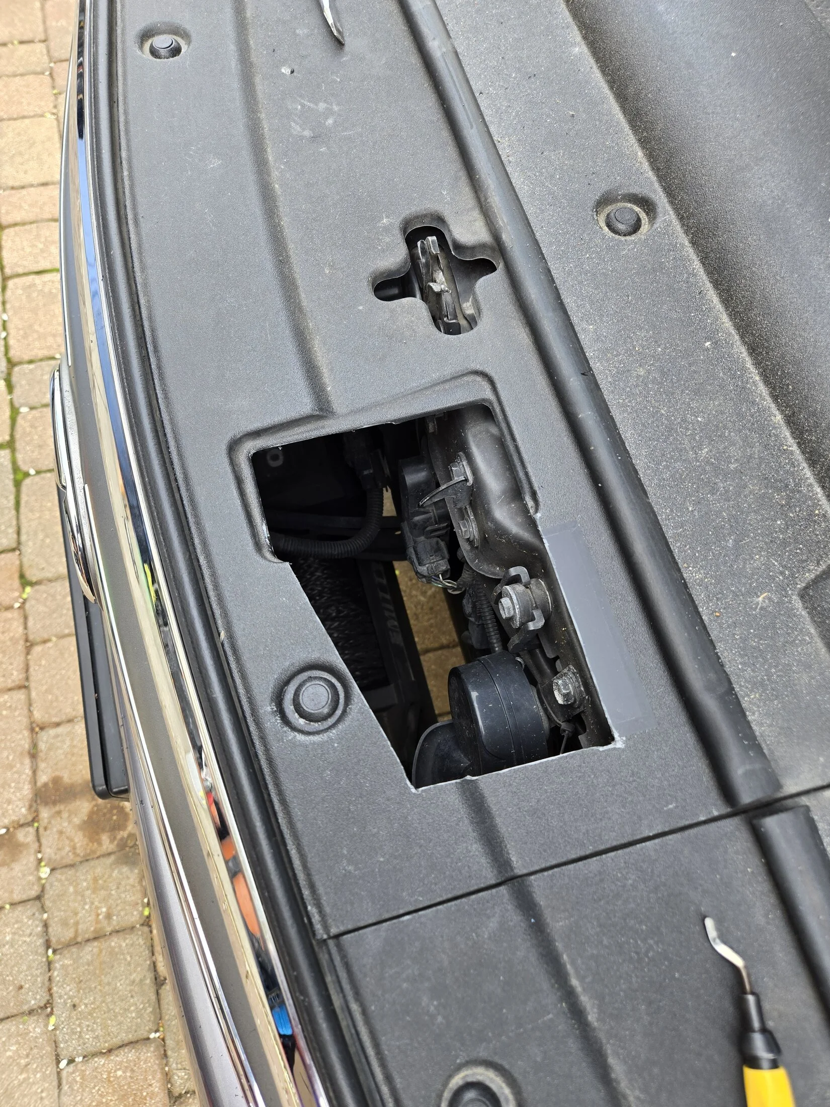

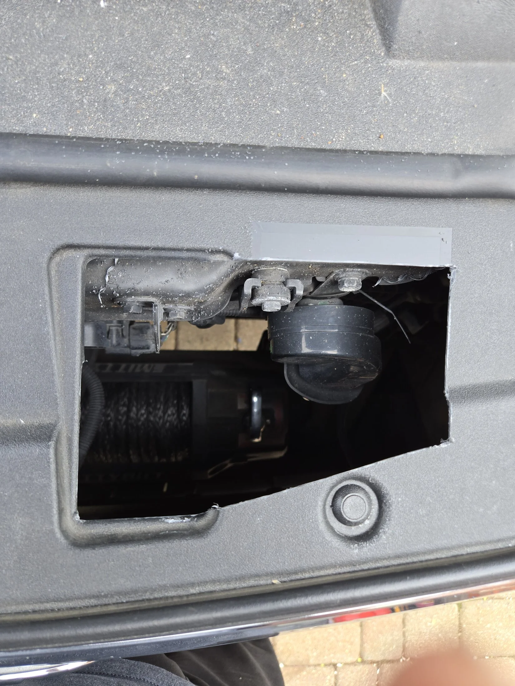

I cut a hole that makes my life easier at times. ;)

Looks good. Another option is PPF if you don't want to keep doing this every year or so. You can order the film pre-cut for make/model/year. Installation isn't too bad.
Looks good. Another option is PPF if you don't want to keep doing this every year or so. You can order the film pre-cut for make/model/year. Installation isn't too bad.I
I was considering this, any recommendation on brands?
