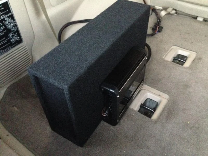

Audio upgrade
Finally...I got Bass!! and iphone 5 connectivity as well as bluetooth audio.
Kenwood 7" touch screen DDX790
Kenwood X500 amp
JL subwoofer

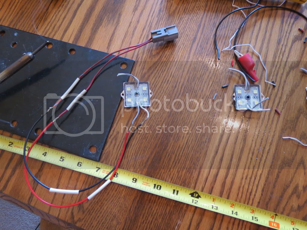

Got my puddle/courtesy lights back since they were missed after removing the running boards.

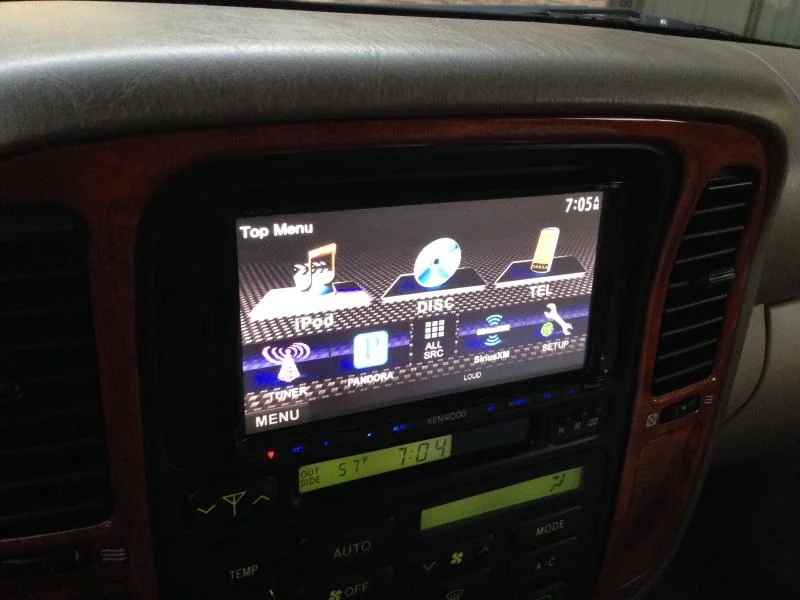

I added a Kenwood double din with Bluetooth. Wow Crutchfield came through big time. Also threw some front speakers in as well. Now all I run is Pandora through it wirelessly very sweet I must say.

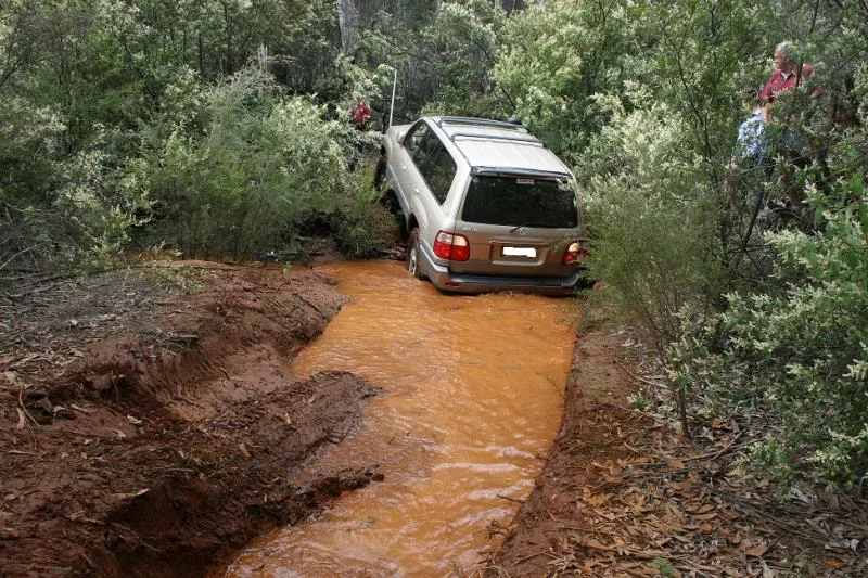

Drove the car through mud and recoverd a LC200 and a GU Patrol.
Super50, why did you choose the mono amp?
I didnt. I told the installer I wanted nice sounding bass, and he suggested that set up.
I like the sound, and its a compact setup which I can disconnect and remove when i need the space. I also have a dial up front to control the level of bass.
OK.
So how are your speaker wired up, directly from your head unit or still using the factory amplifier?

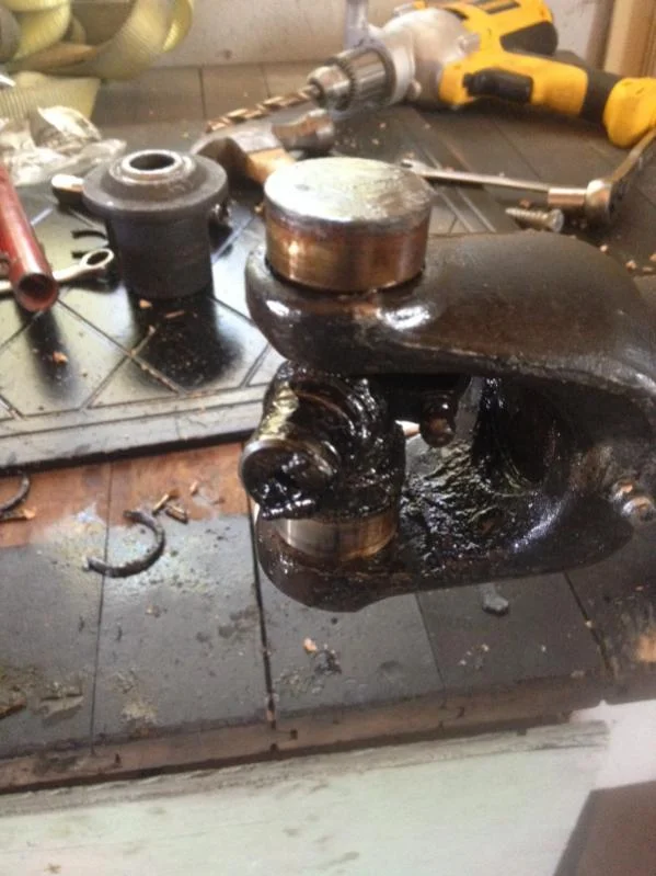

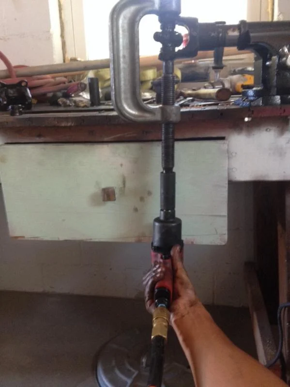

Replaced rear u-joints to remedy vibe noise. Was distracted and forgot to pull the c-clips out. Shattered the old bearing cap into pieces but thankfully did not bend the yoke. What a dummy. Anyway, all is new and I'm happy
