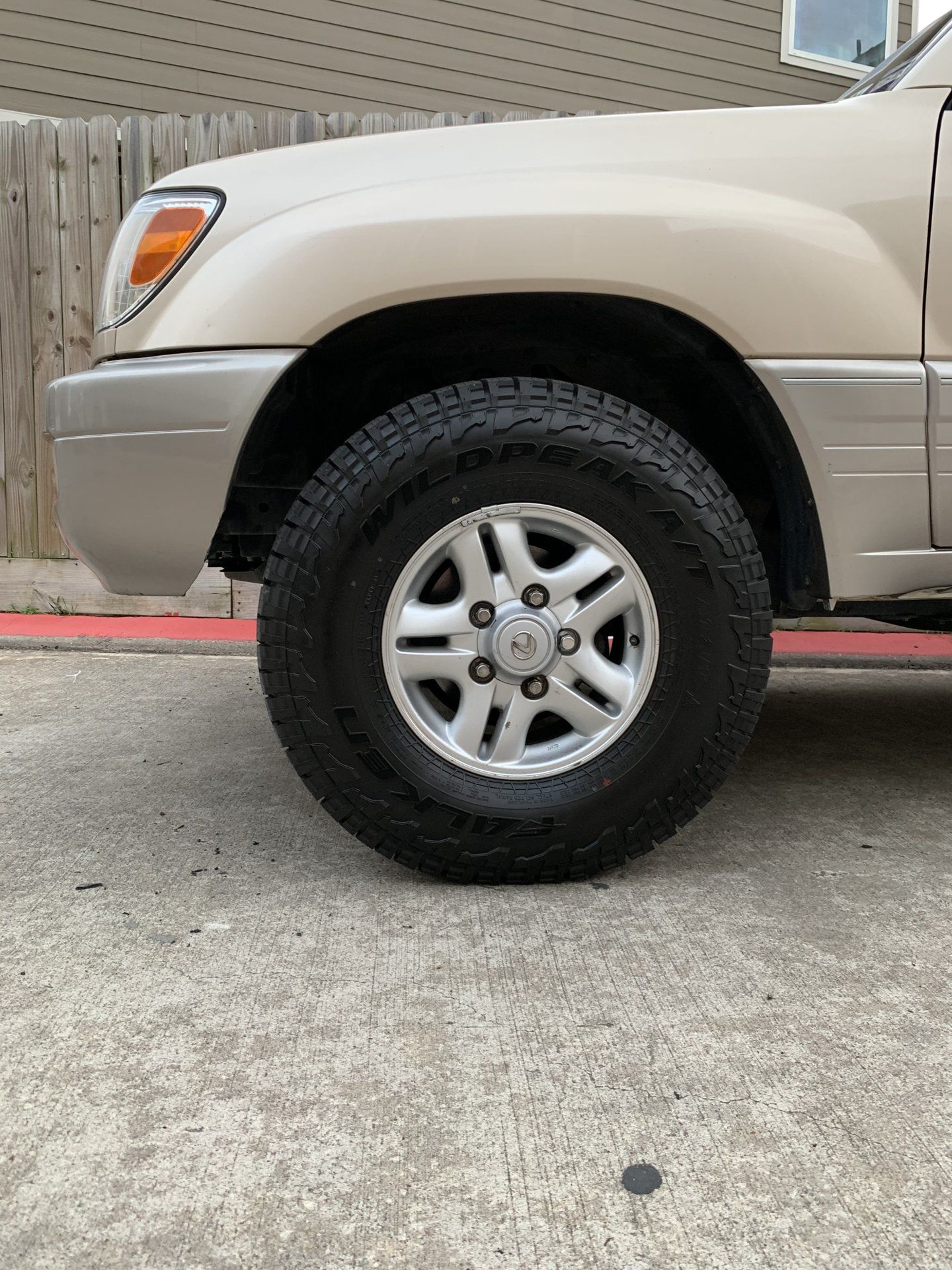

After adding some 1.5” hubcentric spacers, I experienced a minor rub when a wheel would be turning and on an incline. I trimmed the edge of my 98 front bumper, and a little section of the inner fender liner.

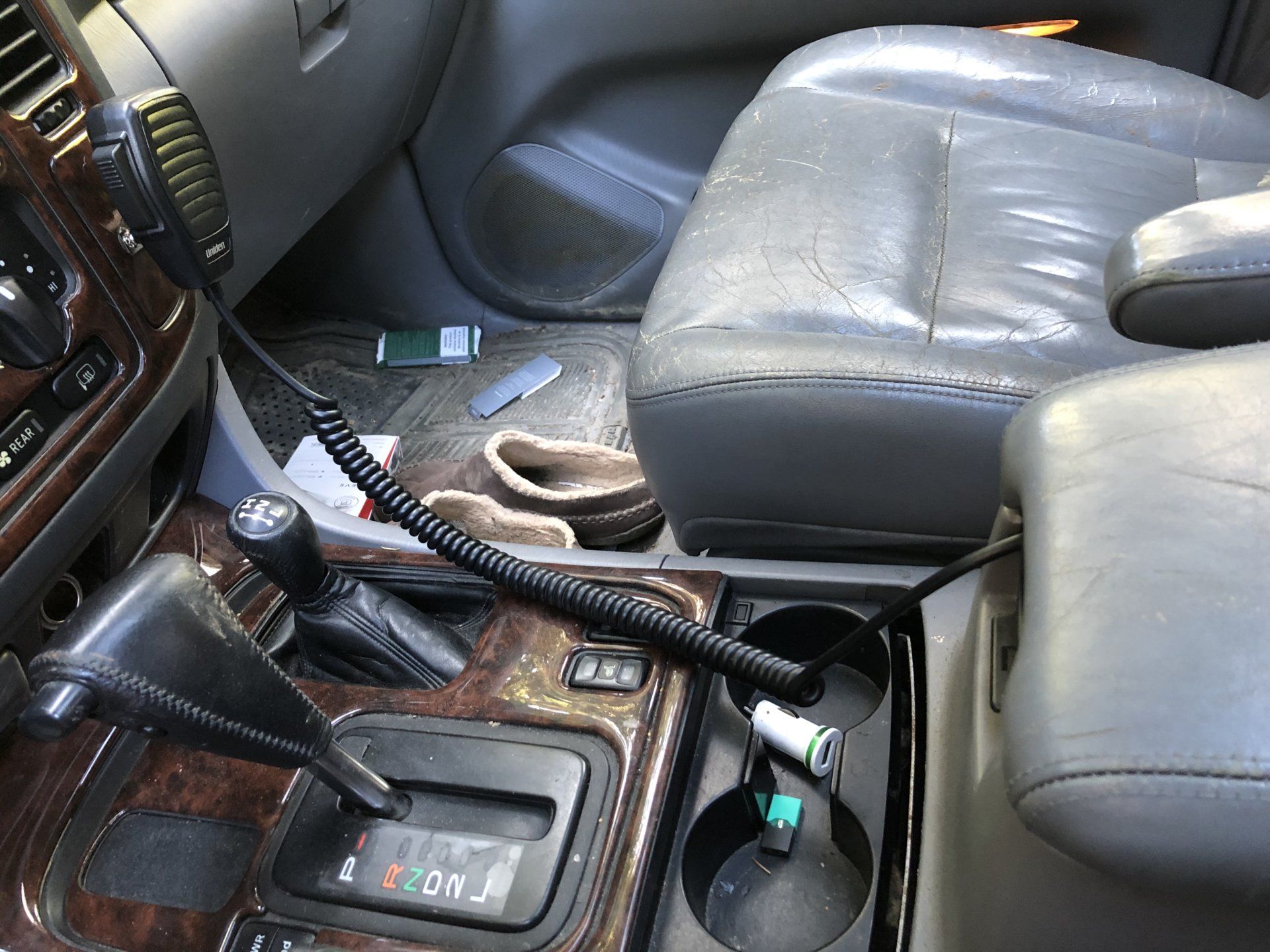

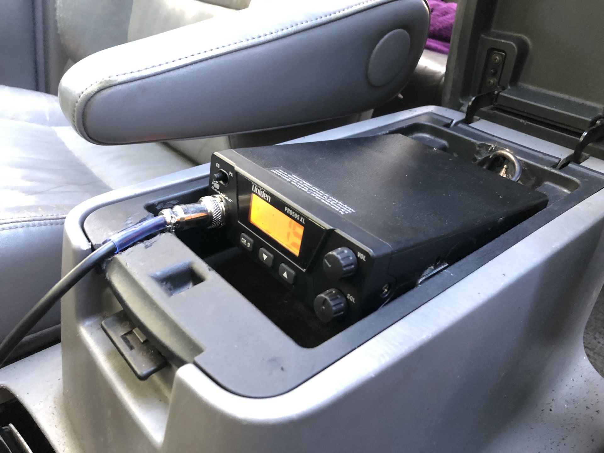

Put in a Uniden pro 505xl and a 4’ firestick. It’s not the best quality install, but I really like the location of the cb. It’s really convenient.
Anyone that’s planning on doing a CB definitely make sure you get a SWR meter because mine turned out to have a grounding problem at first so the SWR was dangerously high, which can damage the radio

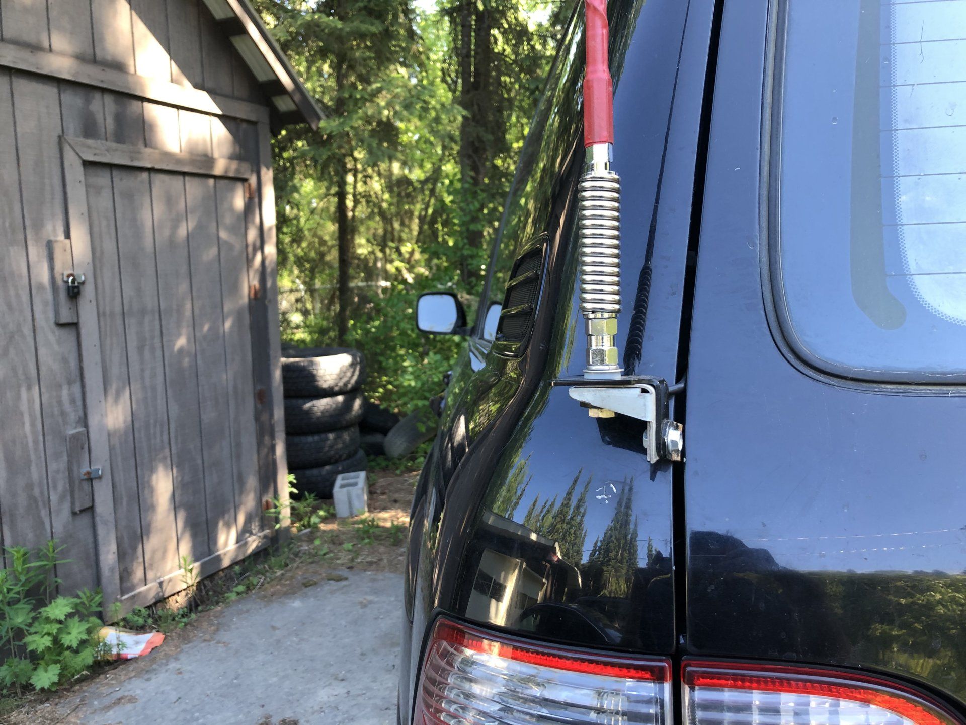

FINALLY got around to designing and installing the prototype FM/CB antenna mount for the STOCK location. I make these for the 60 and 80 series and you guys have been after me for the 100 series.
Will get these refined and as an offering soon.
