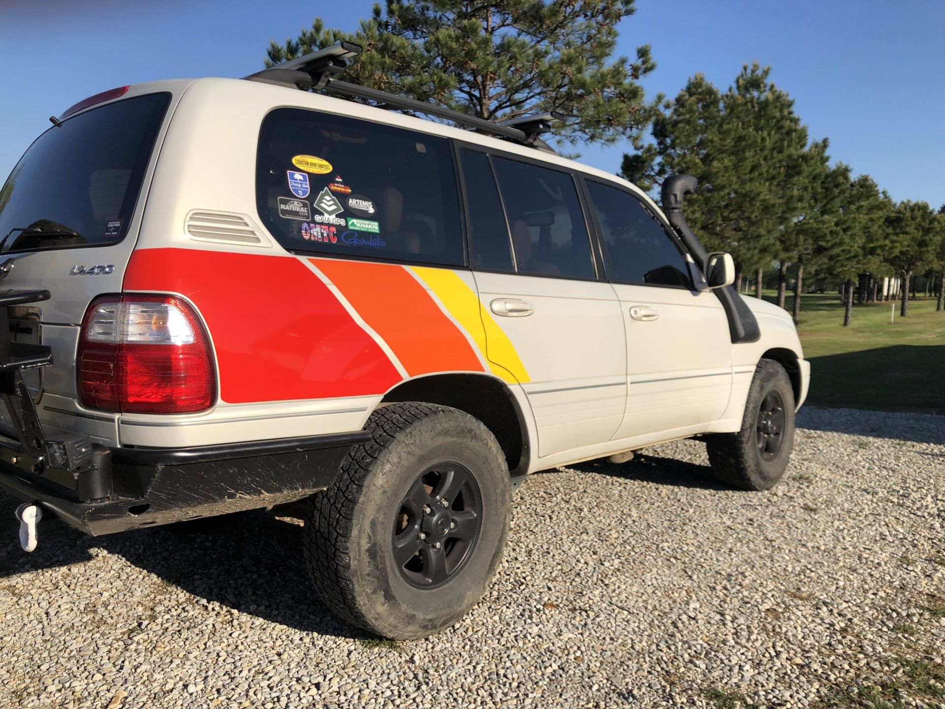

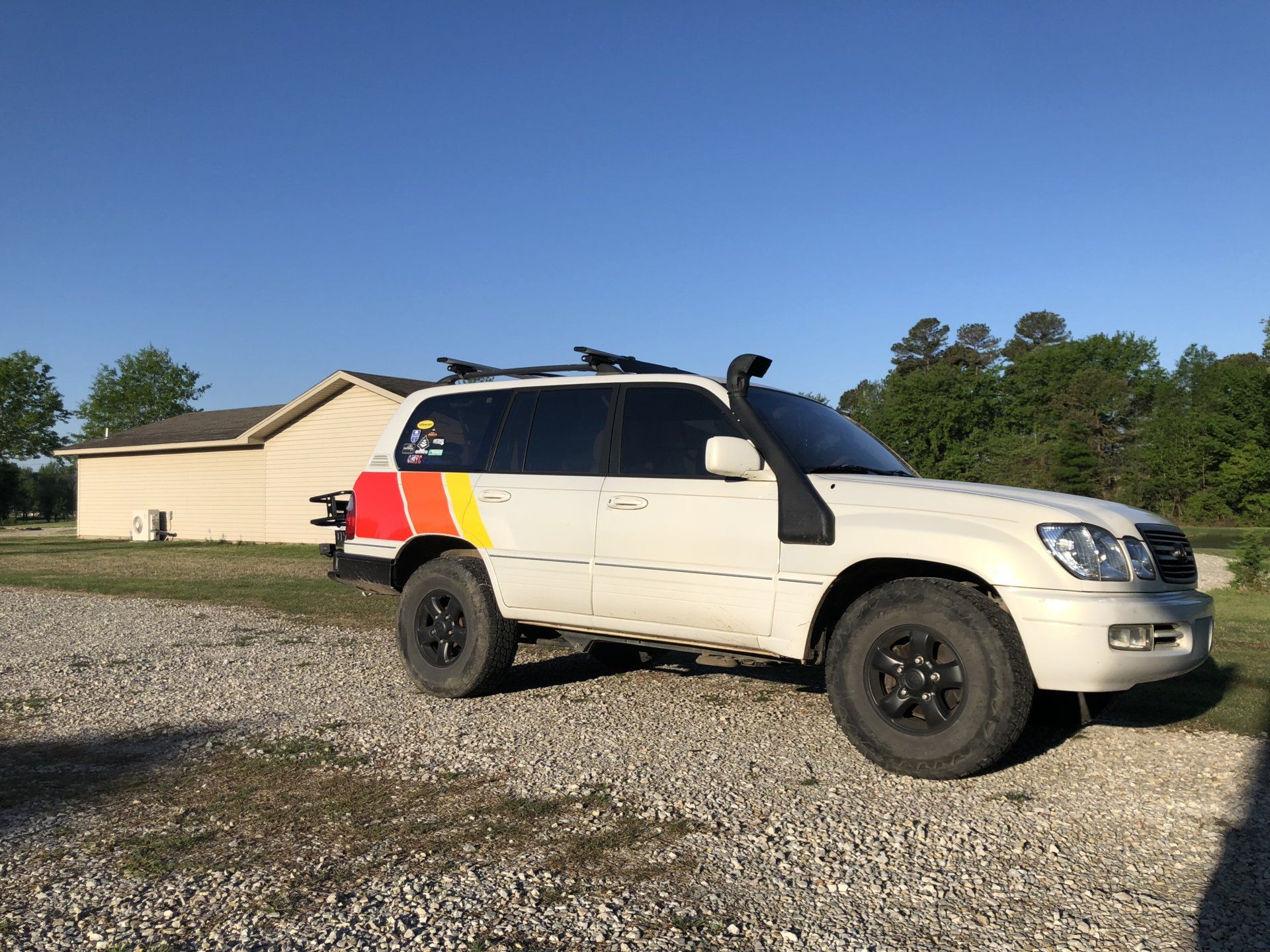

Disclaimer : Yes I know the pinstripe is still there, I don’t know what Lexus used to put it on there, but it absolutely won’t come off. I’ll try some goo gone tomorrow and see if I can get it off.
Anyways I’ve been wanting to put some Ivan Stripes on the truck for awhile now and finally just ordered the vinyl and got after it. It doesn’t look super great in person but for my first time messing with vinyl it’s not bad. The door jamb was the hardest part.
I had pinstipes on my truck as well when I first got it, one side was vinyl and the other side was actually painted on. After reading up on it acetone was what ended up being the trick. A little bit on a rag, wiped right away.

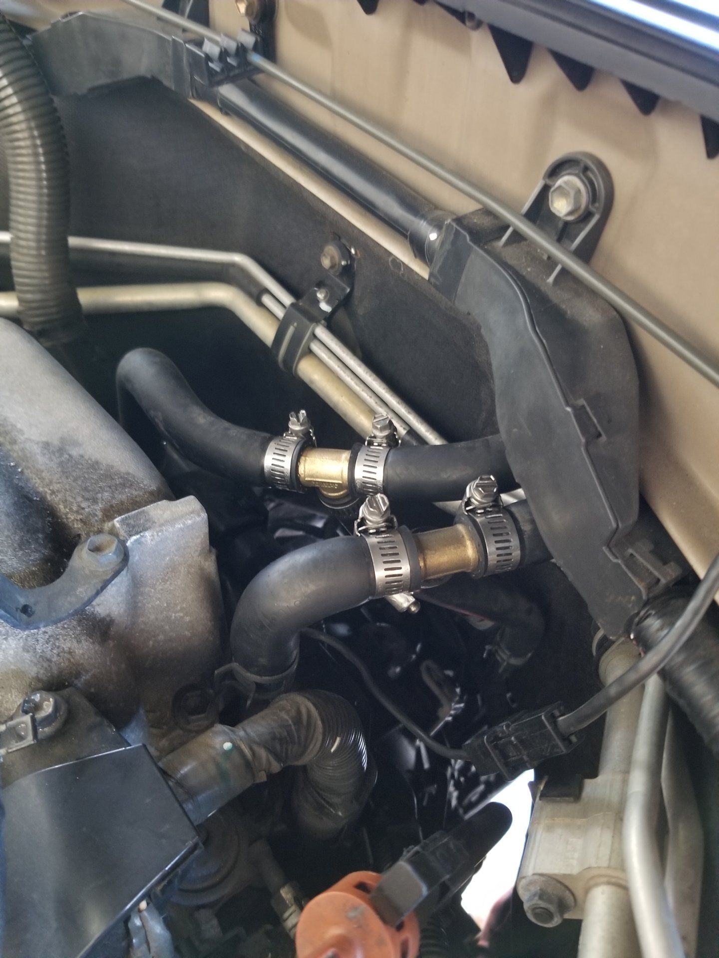

Replaced the heater T's with brass from home depot. The old ones both broke on removal, and I had to fish out little pieces. My 1999 with 175k miles definitely needed it or it would have probably stranded me pretty soon.
I did drop one of the damn nuts that hold on the engine cover and couldn't find it.....so I guess I'm going cover less . It was a pretty easy job, but uncomfortable trying to get the clips off the hoses leaned all the way into the engine bay

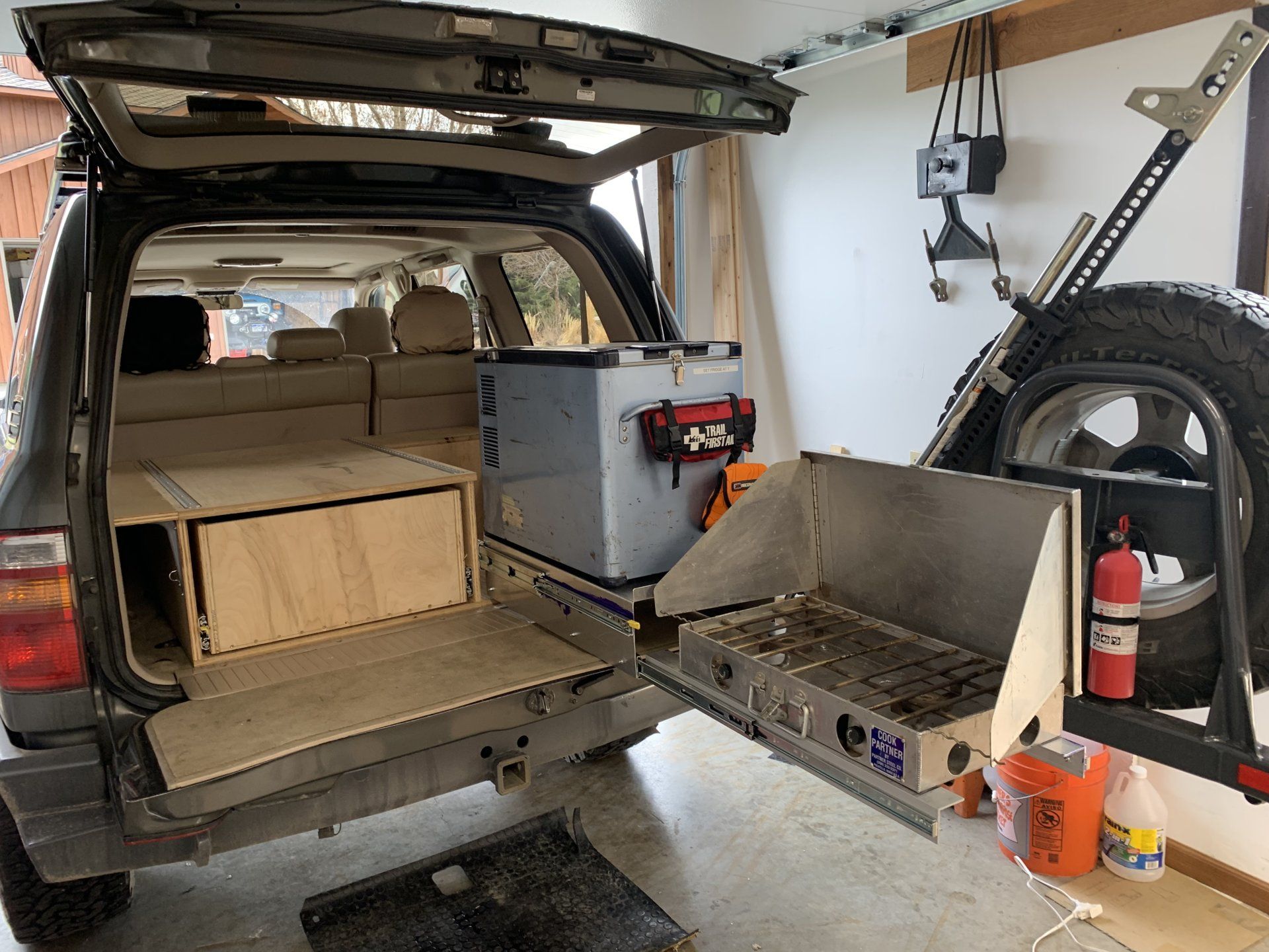

Getting closer on my rear kitchen/drawer setup. Gotta' build the side wings, drawer fronts and then carpet and finish the wiring for the outlets and compressor.

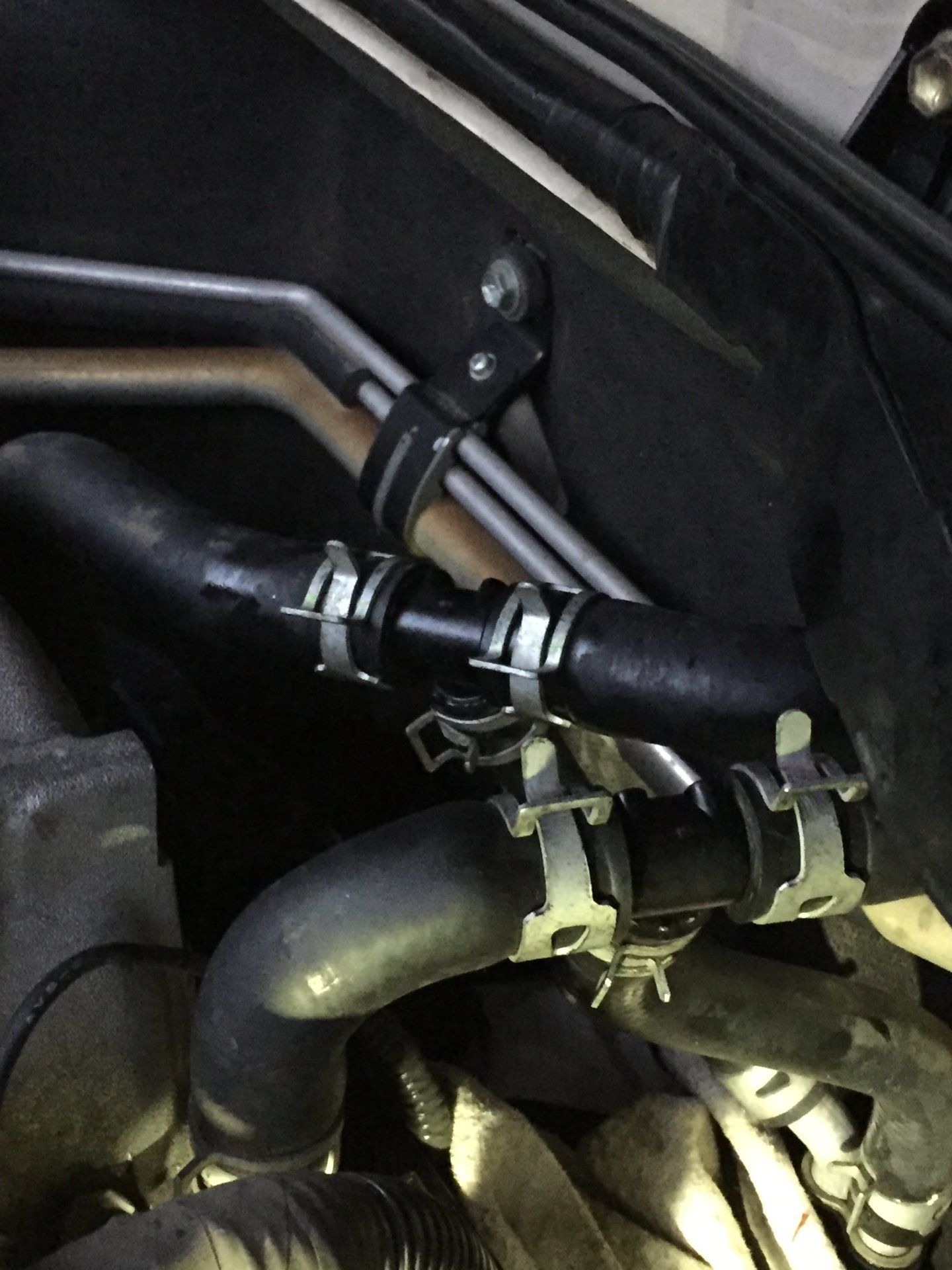

Did mine today....oem plastic. Gonna buy brass for the next time...
