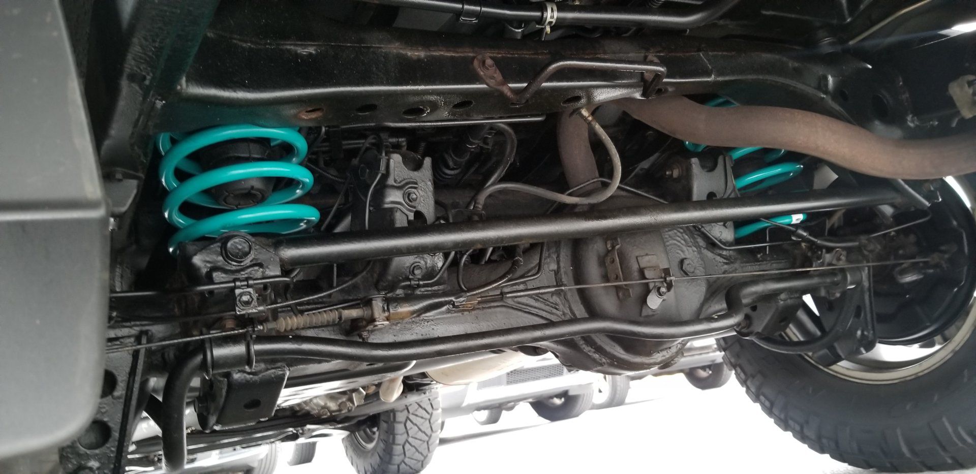

Having great results using Dobinson rear springs (C59-221V, originally for 80 series) for AHC. This is with sensors maxed out on their original bracket. Helm joints up front were not shortened. Neutral pressure out back were about 6.0 give or take. Initial reactions showed that I had fairly strong rebound, without a lot of bounce. After a few days of settling this improved. Stopped by Lowes to buy 210lbs worth of Sand tube bags and the ride now better than stock. Rear also has 295/70/18 spare and 3rd row totalling over 300lbs. dissent bumper coming soon to replace those sandbags.
Again, the ride is much more compliant now with a lot more control with the stiffer spring after about 8k miles of driving. Rides like a dream with firmer bumps, nothing jarring. You guys with more AHC lift could benefit with this setup, without the sandbags and more weight capacity;).

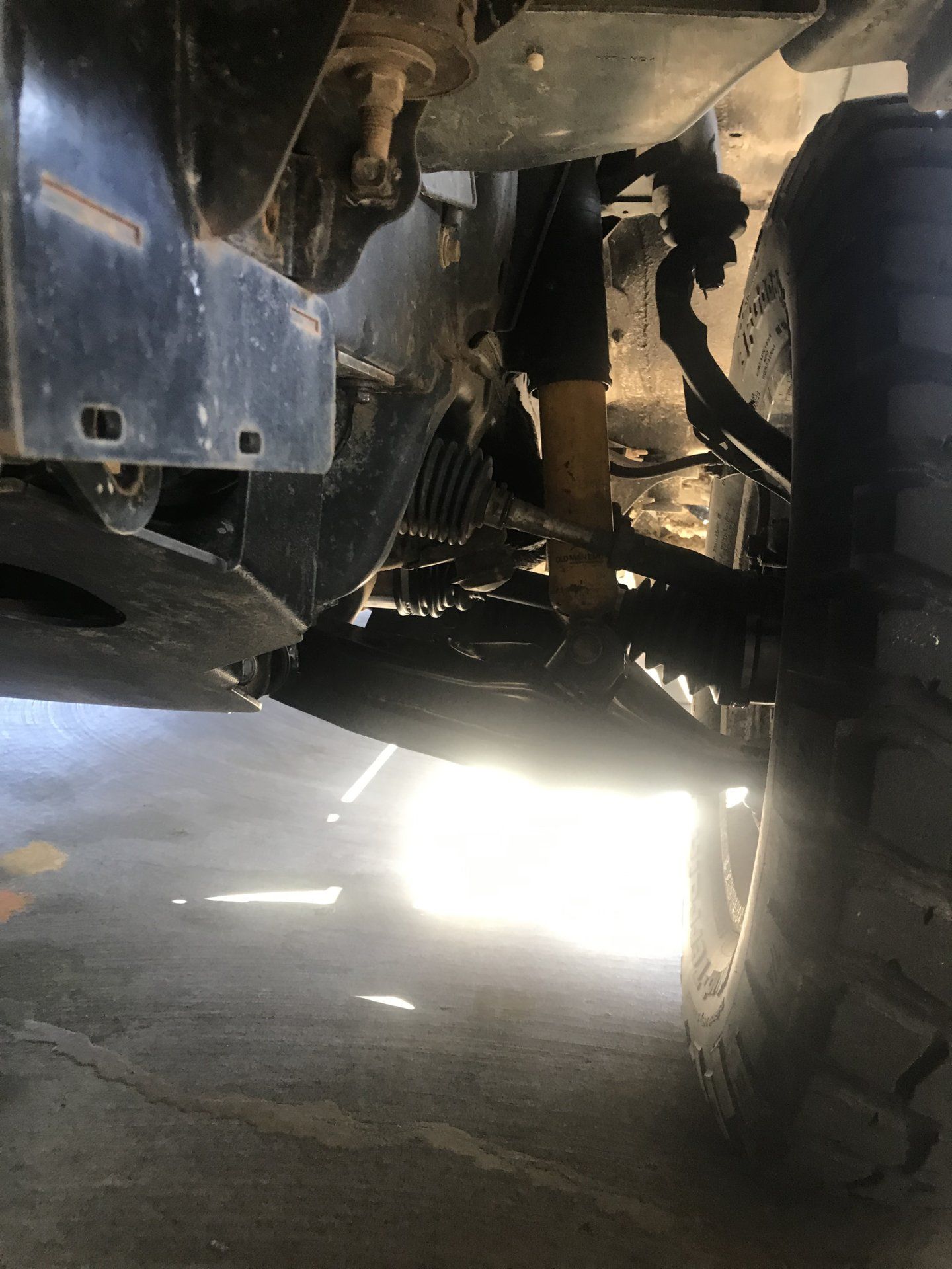

Off topic from your post but did you use por15 or some type of rush inhibitor on your undercarriage there?
The best it has driven since before the 36 hour race in 2016.
2 New lower control arms and 2 new axles.
Did you replace the frame side bushings too?

Lower control arms come with only one bushing pressed in. The other bushing is pressed in to the frame and is not part of the control arm. Those bushings are a royal PITA and I am curious if the shop deemed them important to change or not.
I ask because I am on the fence to replace my LCAs and the frame side bushing scares me.
I know my lower control arms and bushings were trashed from some severe off roading in the 36 hour of uwharrie race in 2016.
I will ask them.
As smooth as it is now, I would bet yes.
