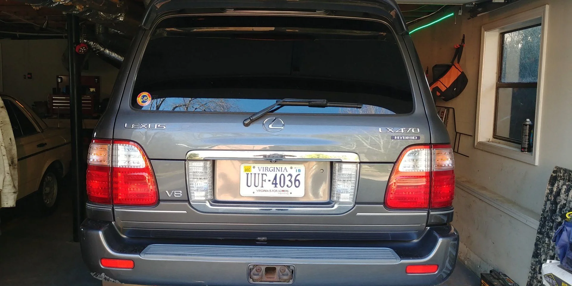

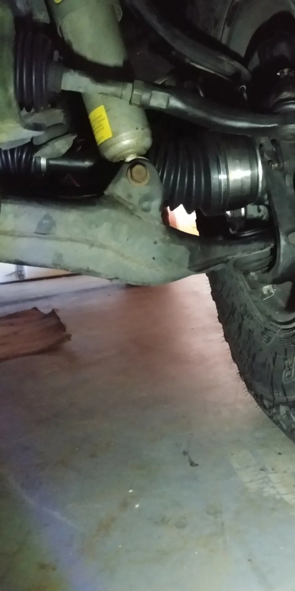

Bought it (technically 3 weeks ago). 2003 LX 470. Super clean inside and out. 237k on the clock as of last week. Replaced low beam bulbs (i really wish there are an easy plug &play solution to make these brighter). Opened up the steering column and adjusted the extension of the steering wheel (bad telescoping motor). Had the AHC fluid flushed and replaced, a new alignment done, CV boot replaced(will need to do the other one soon).

1- Sweet shiny new calipers (with pads and rotors, of course)
2- Sweet shiny new CV axle on the DS
