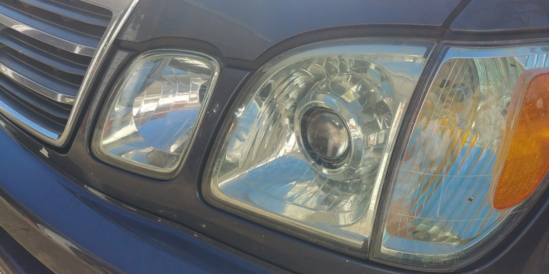

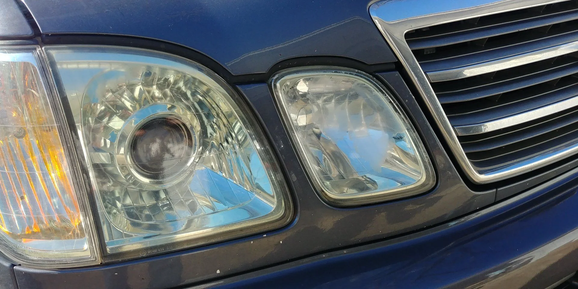

Hit them again wet sanding with the green pad then polish with the orange pad and some compound. Never should have done it. Not happy.
Did you use a drill polishing pad with the compound? The green scotchbrite is much too course to get a clear lens. I'd go 600-800-1000-2000-2500 after the green scotchbrite. I have done several and they look beautiful when finished.

Not entirely impressed, might be worse. May have to hit them again with the 3000.

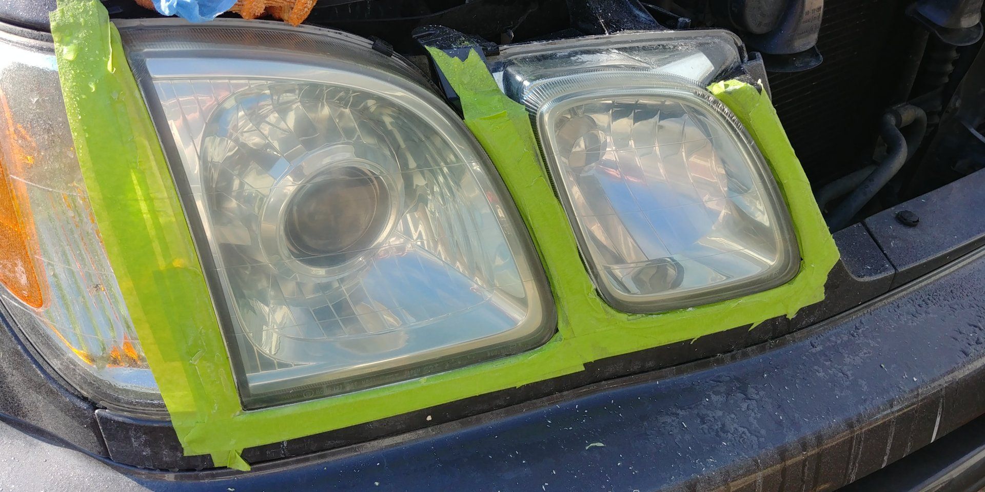

I used the 3M kit for my LX today. Someone had done it previously, and the clear coat was peeling. This is the first time I've used one of the kits. Generally I've ever just hand sanded down to 3k or 5k or something that's basically printer paper in texture, then followed with a polish and a sealant, reapplied each time I washed or detailed the vehicle.
The problem with the 3M kit, IMO, is that it relies on the clear coat wipes to provide the actual clarity, so you never actually get a clear lens, just the illusion of it. I decided to leave my lights slightly hazed after the final foam sanding disc, and will properly buff them with my porter cable when I get home to ATL after Christmas. Not much for detail supplies at Mom and Dad's.
Kind of tricky to see here, but the previously applied clear coat was peeling from the top, giving me a dulled edge across the lens
You can see some of the high spots of the clear coat here:

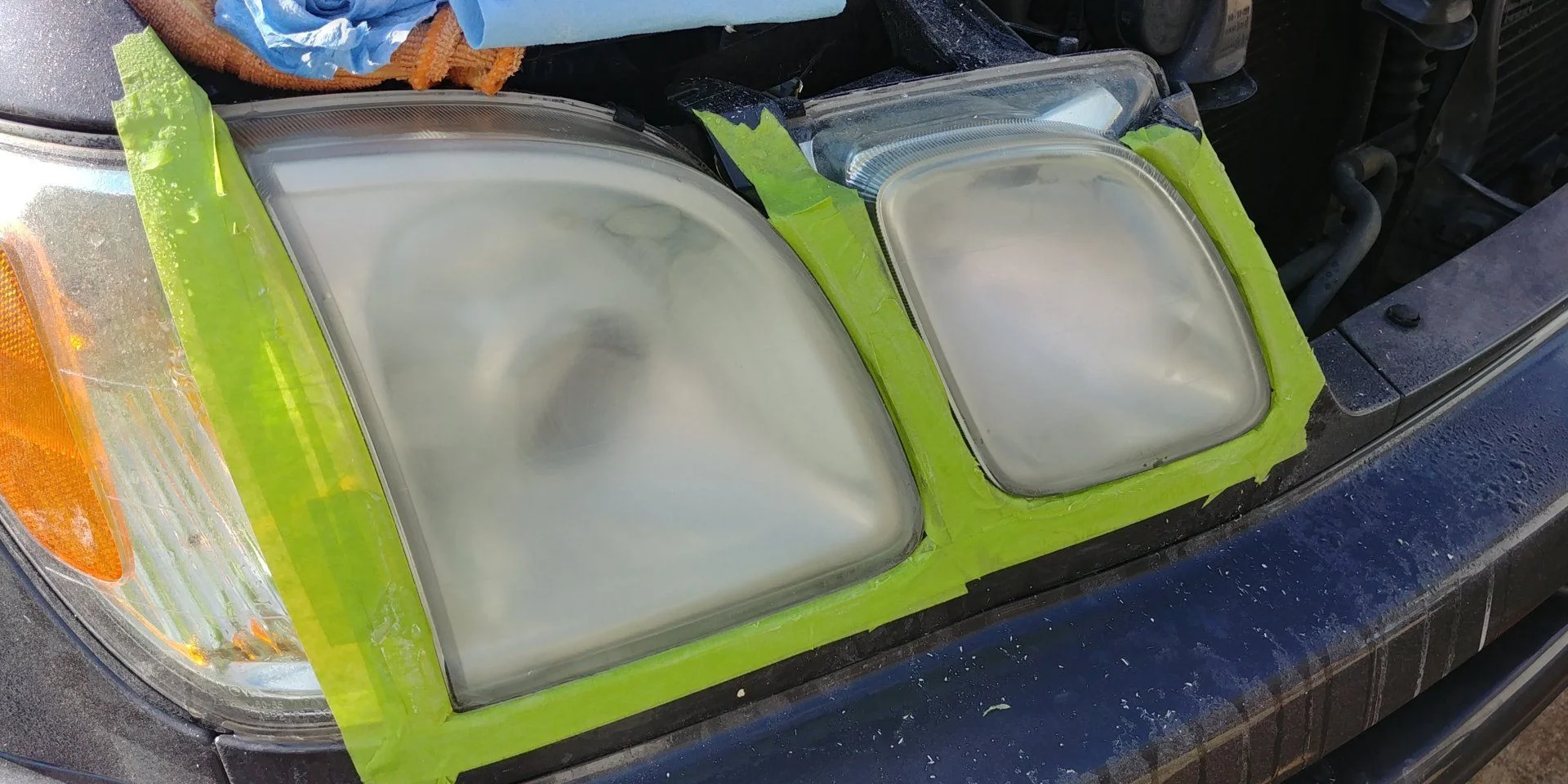

And this was after the foam disc. Better, smooth for sure, but definitely not clear enough to call it done and cover the cloudiness with their clear coat wipe. IMO, it's kind of a half-assed product for people who don't have access to real abrasive pads/polishes to do it correctly.
