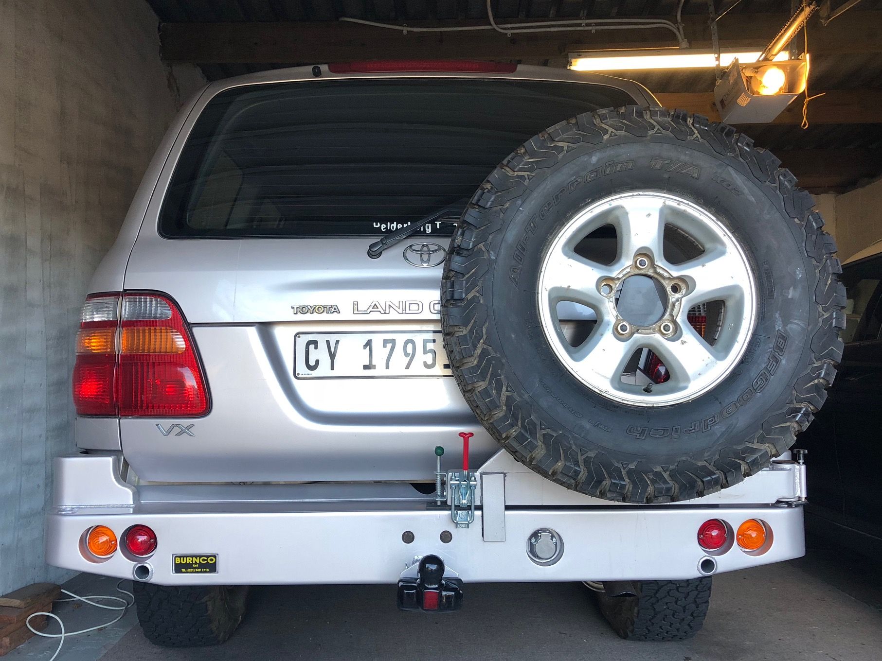

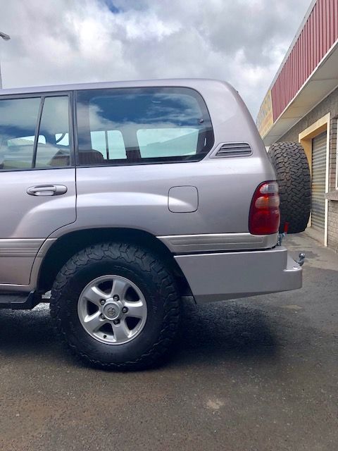

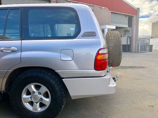

1. New rear bumper with wheel carrier (Colour coded). Underneath the hook is an Anderson plug to charge aux batteries in a camper trailer.

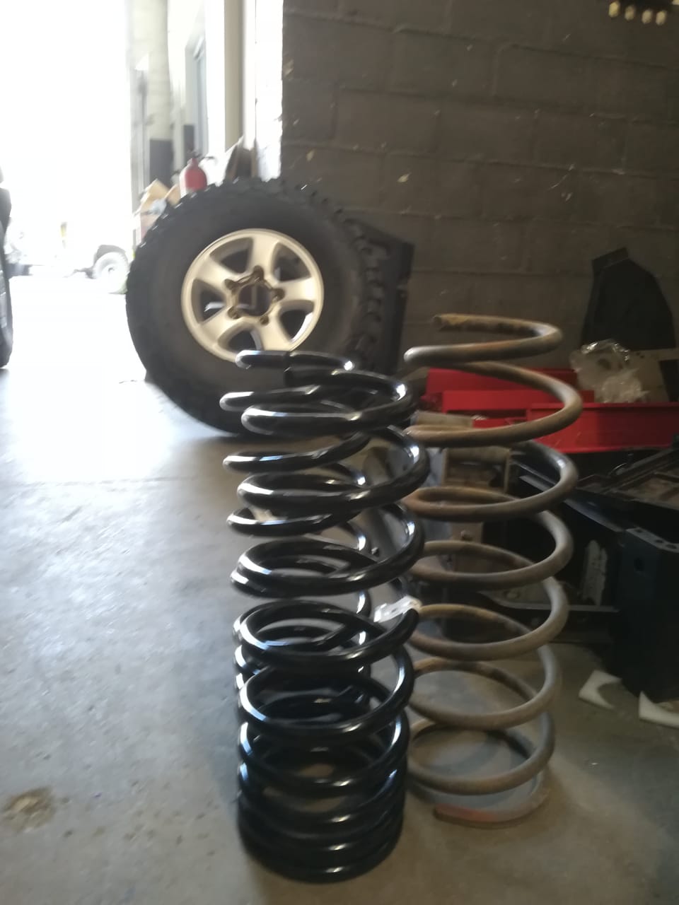

The weight of the additions and the full sub tank dropped the rear onto the bump stops with the old standard coils. It was replaced with new OME 2866 coils. Every thing is back to standard level again.
Old and new coils together
Before the coil replacement
After the coil replacement
The ride is like a new vehicle. The OME2866's give a very soft comfortable ride but maintain stifness when you hit the bumps.
