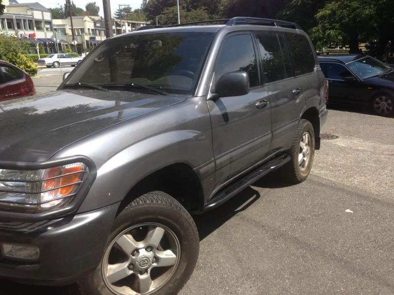

Figured out what those bolt holes are for...
I can't tell from your pic did you cut a hole in the plasticware or just drill holes and bolt straight through?
running boards off yesterday
sliders on today! many thanks to Brewski for the good deal and installation help!
Got tired of looking at the faded black plastic. Read some promising reviews online. Picked up some 3m bondo restore black from Wally World. Taped up the bumper and applied. Looks decent. Rattle can would have been just as good.

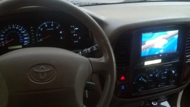

I also upgraded the console lights with LED's. Haven't driven at night yet, but they look fantastic.

How many and which sizes did you use for the dash? I was driving home last night thinking I need to do the same thing. Did you do the ones in the center console too? I've done all of the map lights, door lights, etc but yet to do the dash lights.
Is there a write up on this somewhere? Seems like an easy mod that would look great! I want to do it now...
https://forum.ih8mud.com/100-series-cruisers/409313-led-instrument-panel-gauge-cluster.html
Here is 'one' of the links. In the 2nd link, Ckkone listed what specific bulbs you need. The second thread is a must read.
https://forum.ih8mud.com/100-series-cruisers/748876-ac-illumination-2.html
My instrument panel mod only required six bulbs..(Speedometer, Tach, Fuel, Water, Oil, Battery) Each of those bulbs was a V-Leds #74 6k white. It's basically a 3 LED bulb. It's tiny.. You can do that separately from the console. Ordered those bulbs from V-leds.http://www.vleds.com/ You might need to confirm this, but it's basically this bulb:
http://www.vleds.com/bulb/74-led/wh...wedge-base-dash-light-bulbs-37-74-1-pair.html
I also replaced the lights on the console, and I purchased all of those lights from superbrightleds.com. Pay particular attention to the second link as it regards the console. The second link lists the specific bulbs, and and as I noted the superbrightleds website. The website is a pain in the ass, but their product is good, I'd stick with it.
It is a great mod. The bulbs are cheap and the result is dramatic.

I put the links I used as guidance for the LED upgrade above. I only did the gauge cluster and the console, I'm happy with everything else. If you have questions or it doesn't make sense, please ask, we should probably do a better outline of the bulbs required. The tricky part is just getting the right bulbs, the actual install is a just a matter of getting the instrument panel and console off.
But as a heuristic, you can do the instrument gauge with 6 V-Leds #74 6k white(3 LED's in this bulb) and the rest from the Superbright LED's website, with the specific bulbs listed on the 2nd link.
