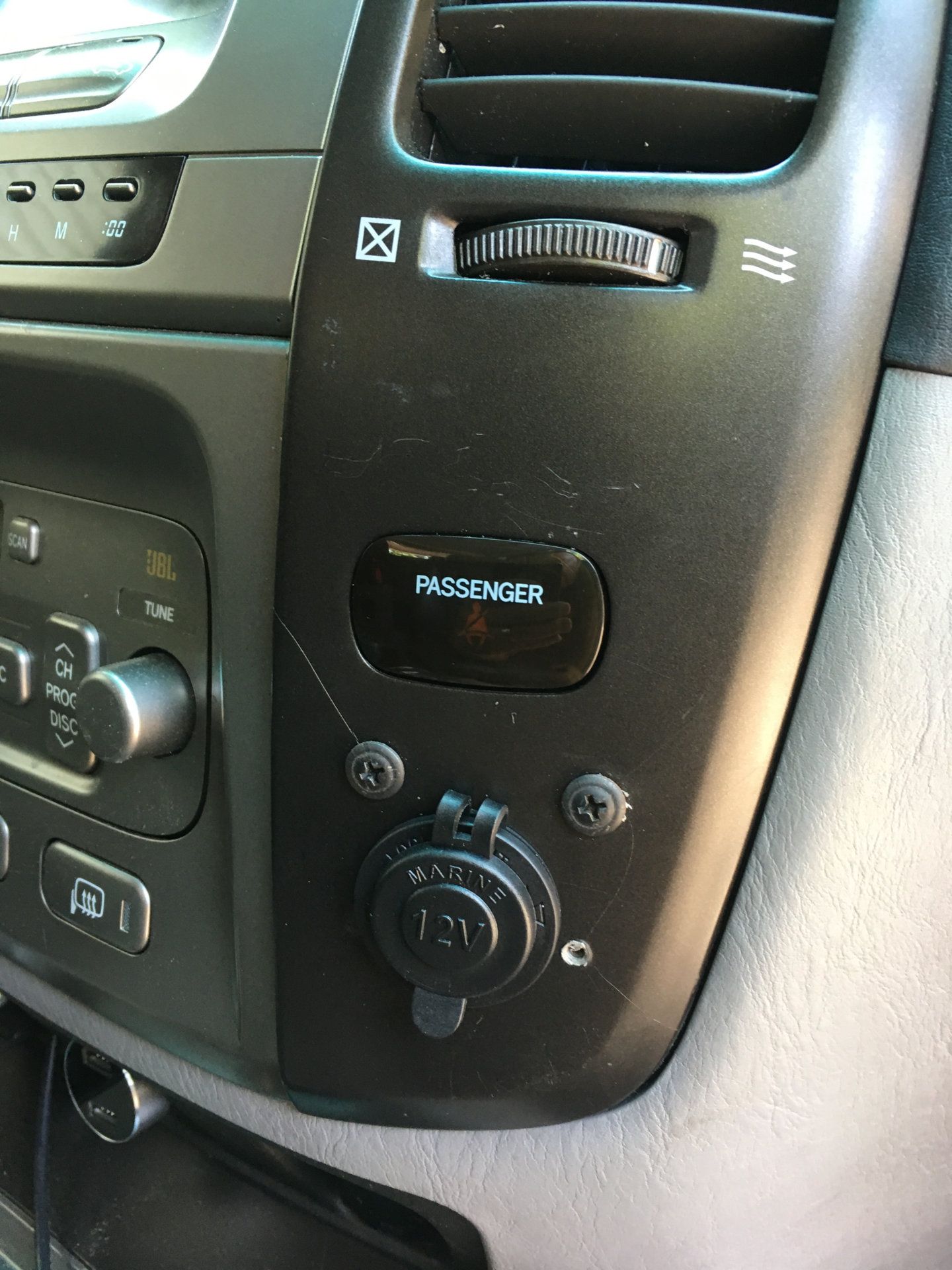

The only thing I am really using it for ATM is to power an inverter and an always on 12v I wired up this morning (for a dashcam). Also for peace of mind that I won't have a dead battery when I wake up in some remote location. My primary battery is aging, I figured I can get a couple more years out of it this way.
12v and Inverter mounting. Gotta keep all my Milwaukee accessories running!
