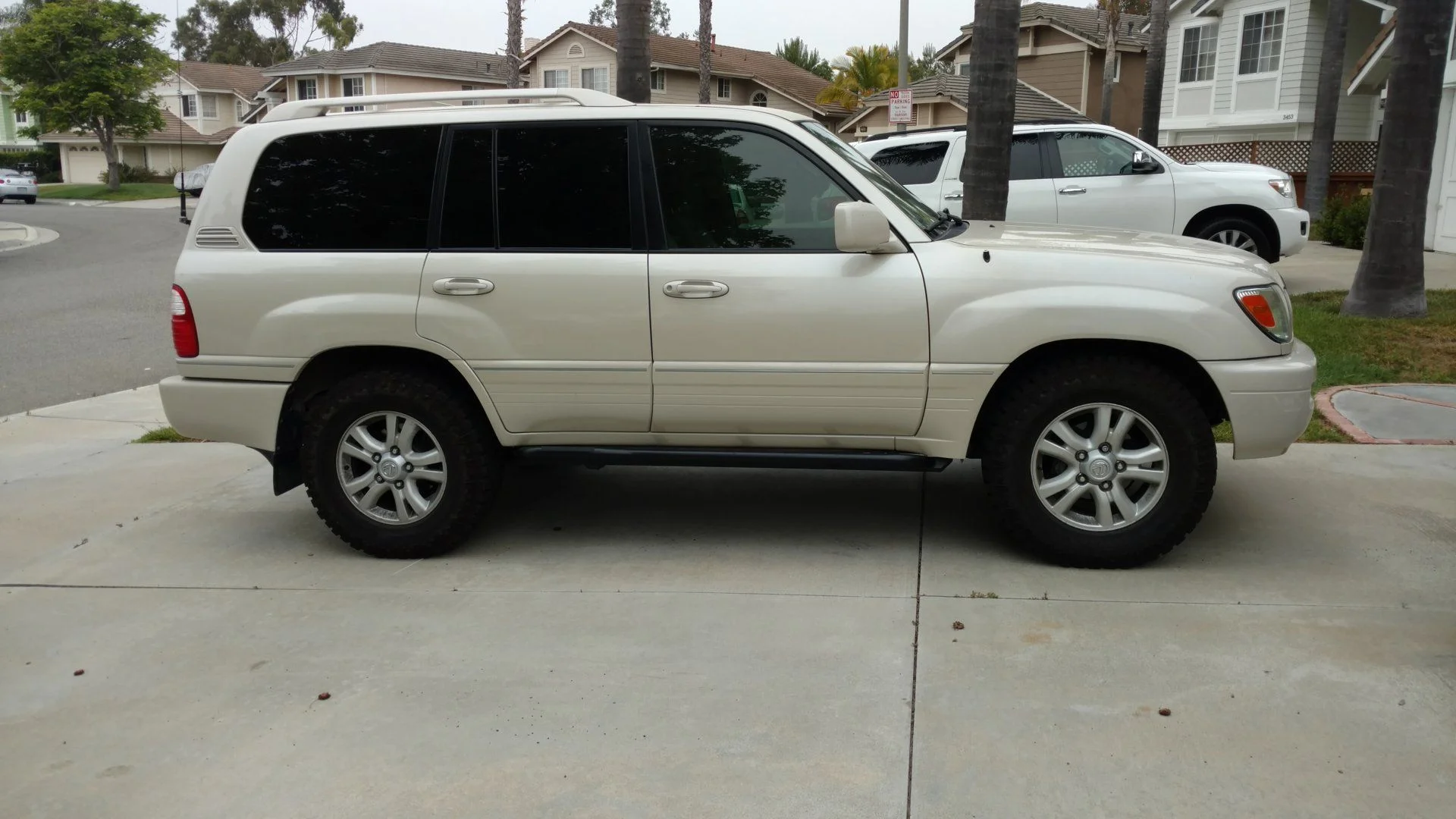

More like over the past few weeks but just now getting around to posting the pics...
  • Replaced the stock street tires with GY Duratrac 275/70/18

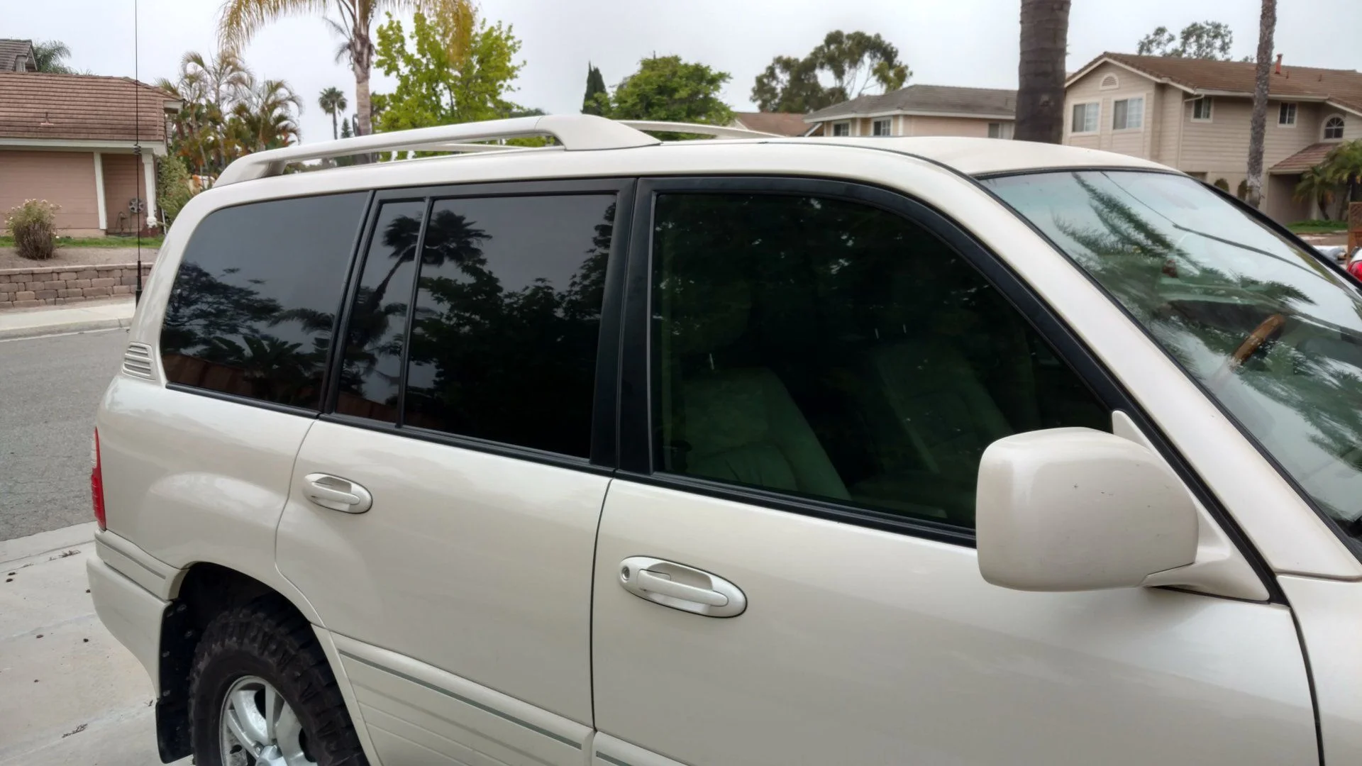

  • Tinted all side and back windows

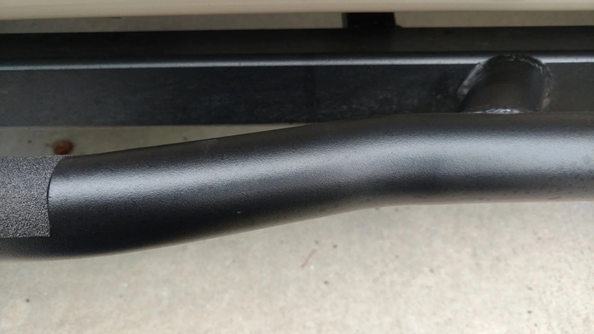

  • Installed White Knuckle Off Road sliders - had them powdercoated locally in black satin with a light texture

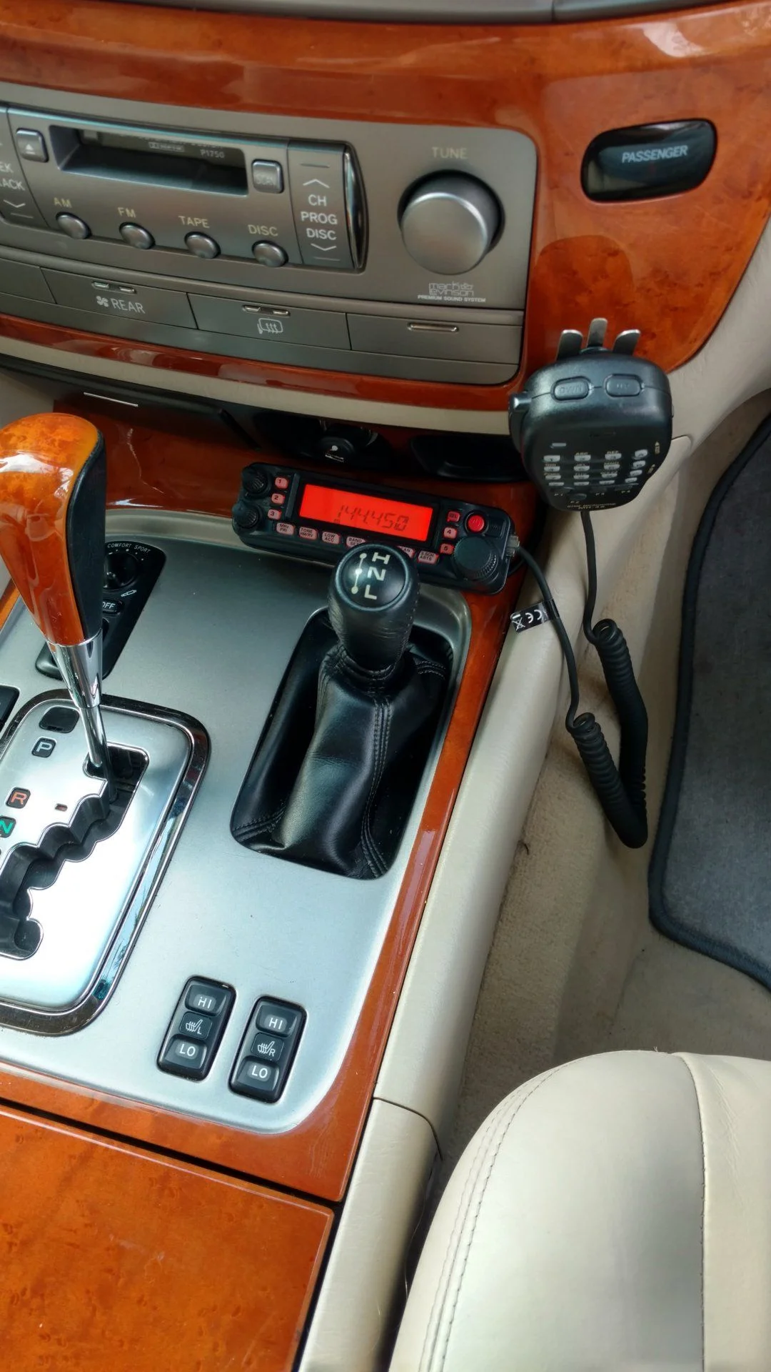

  • Also installed the Yaesu FT-7900R 2 meter radio (actually installed that almost 2 months ago)
Great looking rig. So simple and clean looking.
Thank you! Well...it is for now anyway. :hillbilly:
Someone tagged the bumper and little of the fender while it was parked. Ins will take care of the fender and paint and then will get paid out on the value of the bumper and paint. Benc will be receiving another order soon! Other mods to come after as well...

Nice looking truck there. Did you just black tint on the windows over your factory gold tint?
Thanks. It was like that when I purchased it from the P.O. It’s definitely an aftermarket job though.
