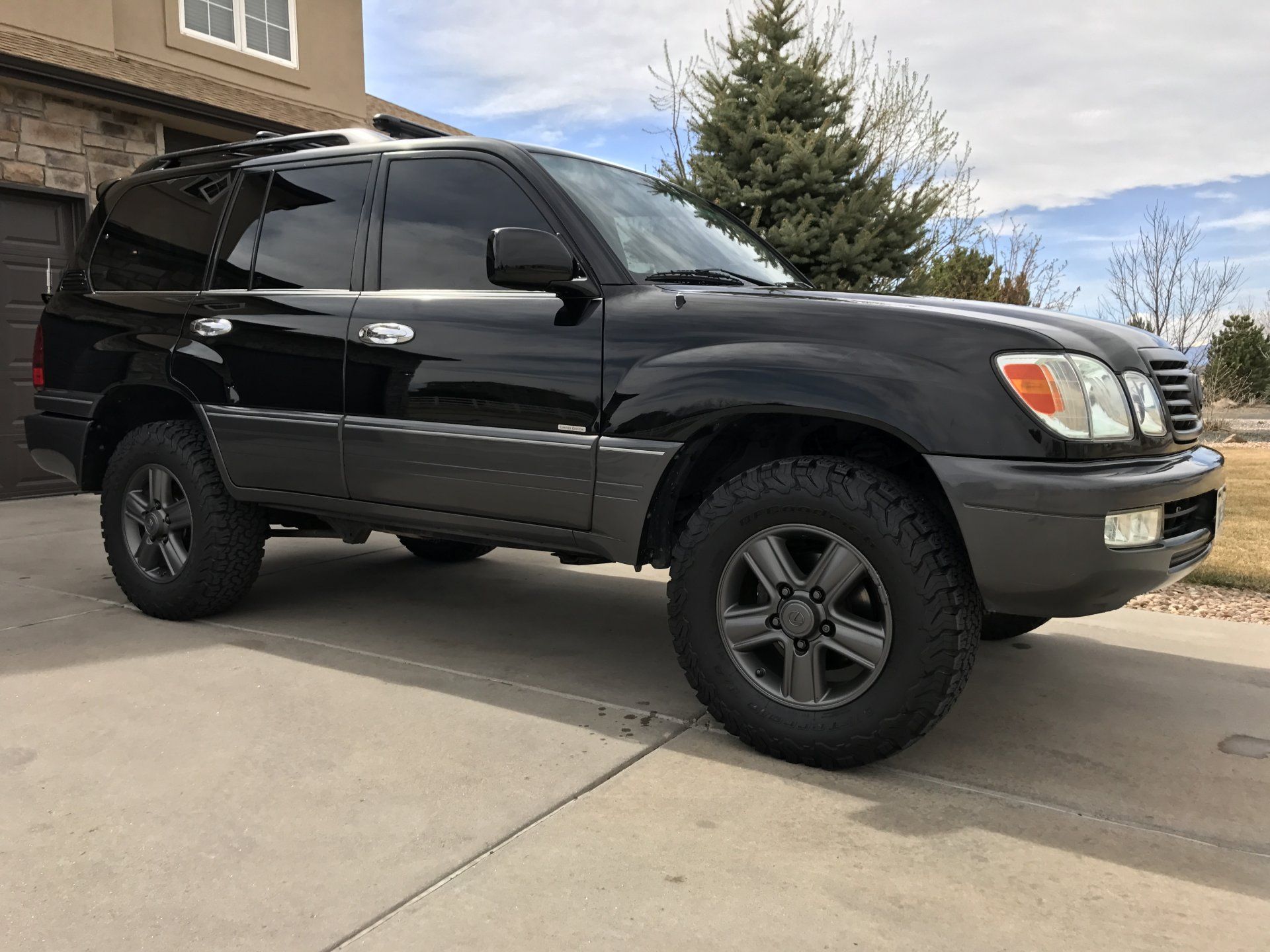

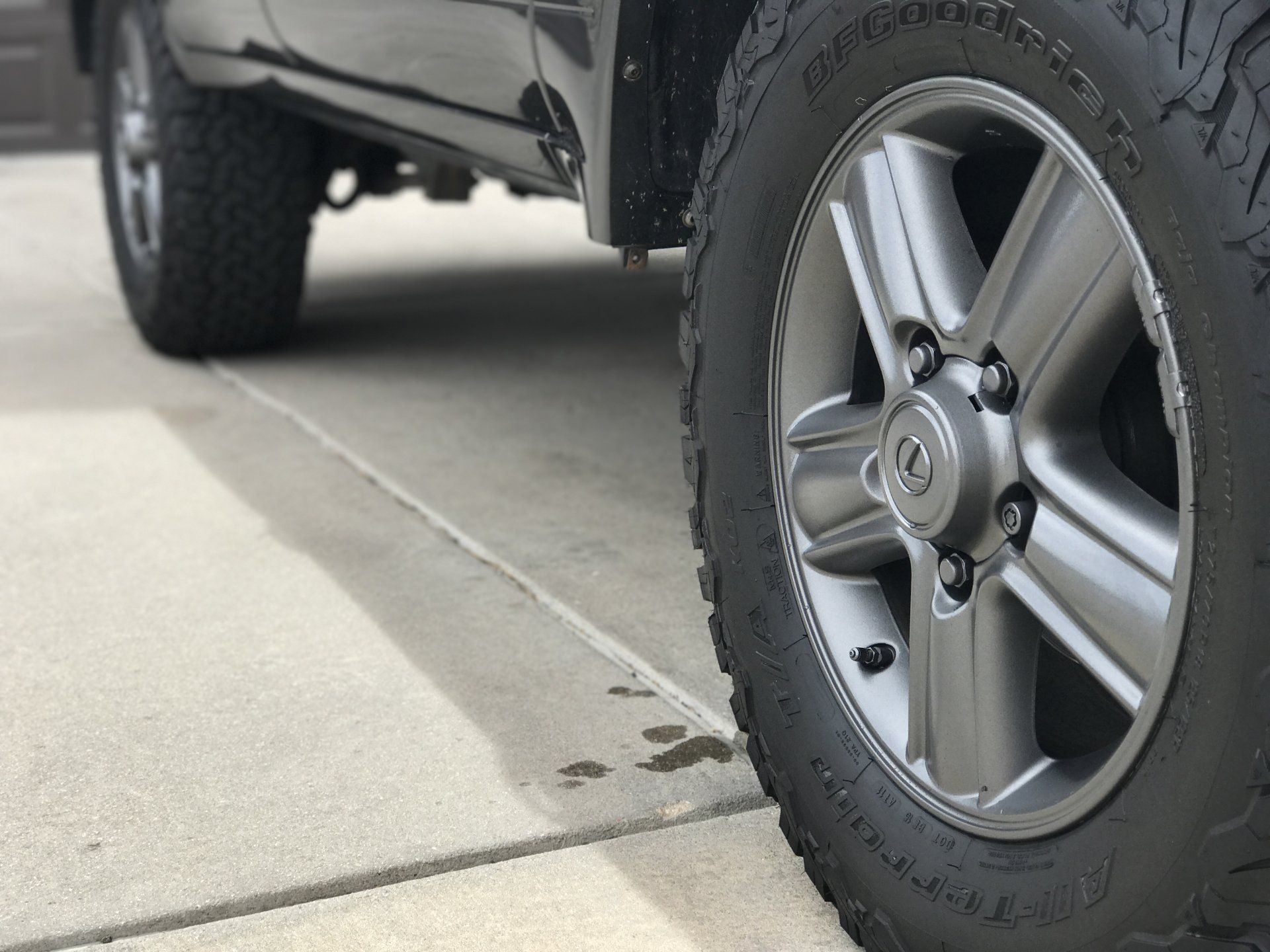

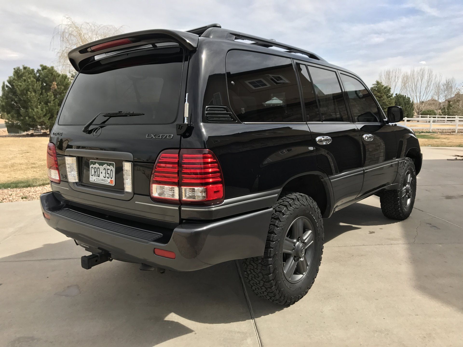

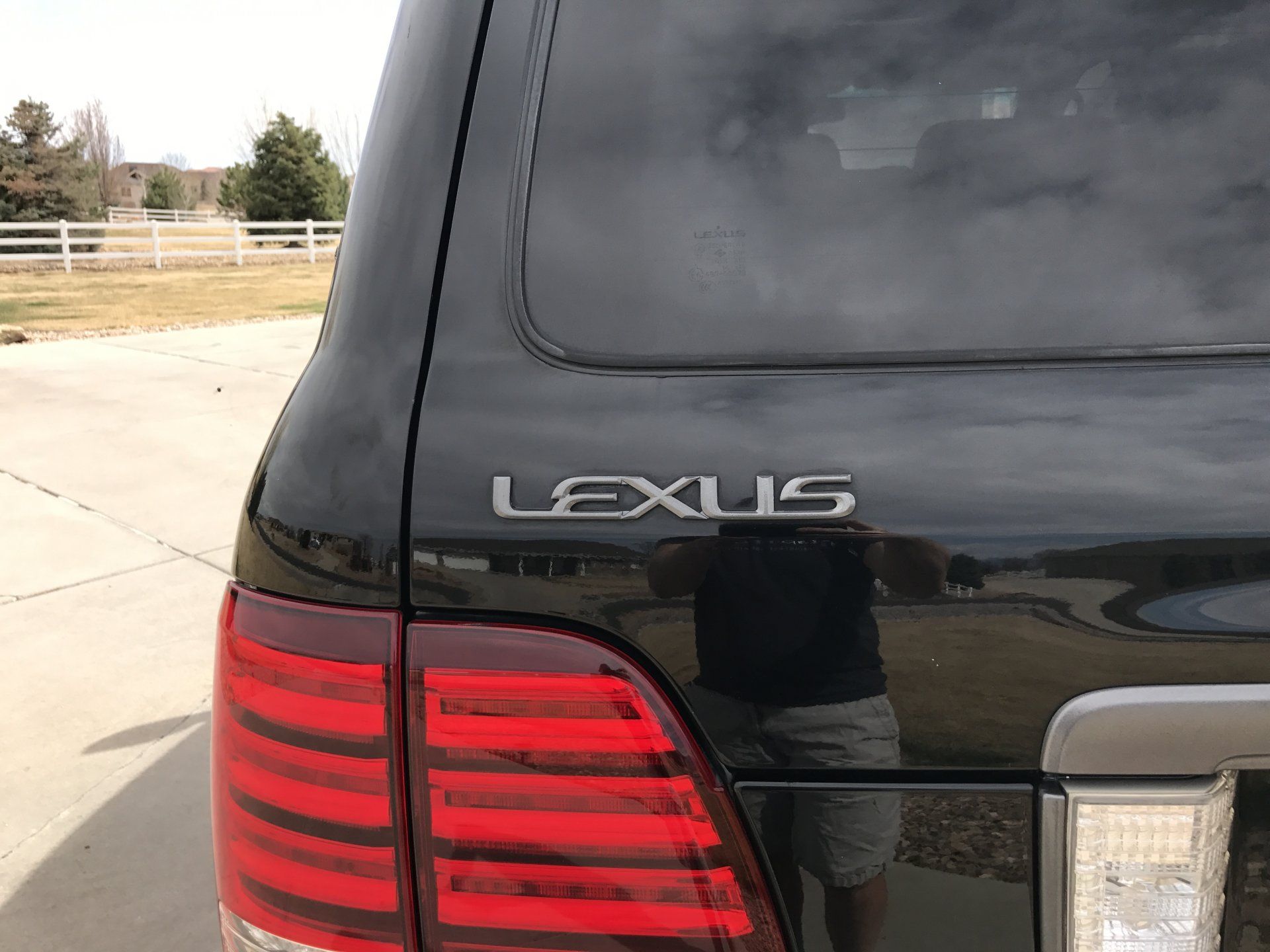

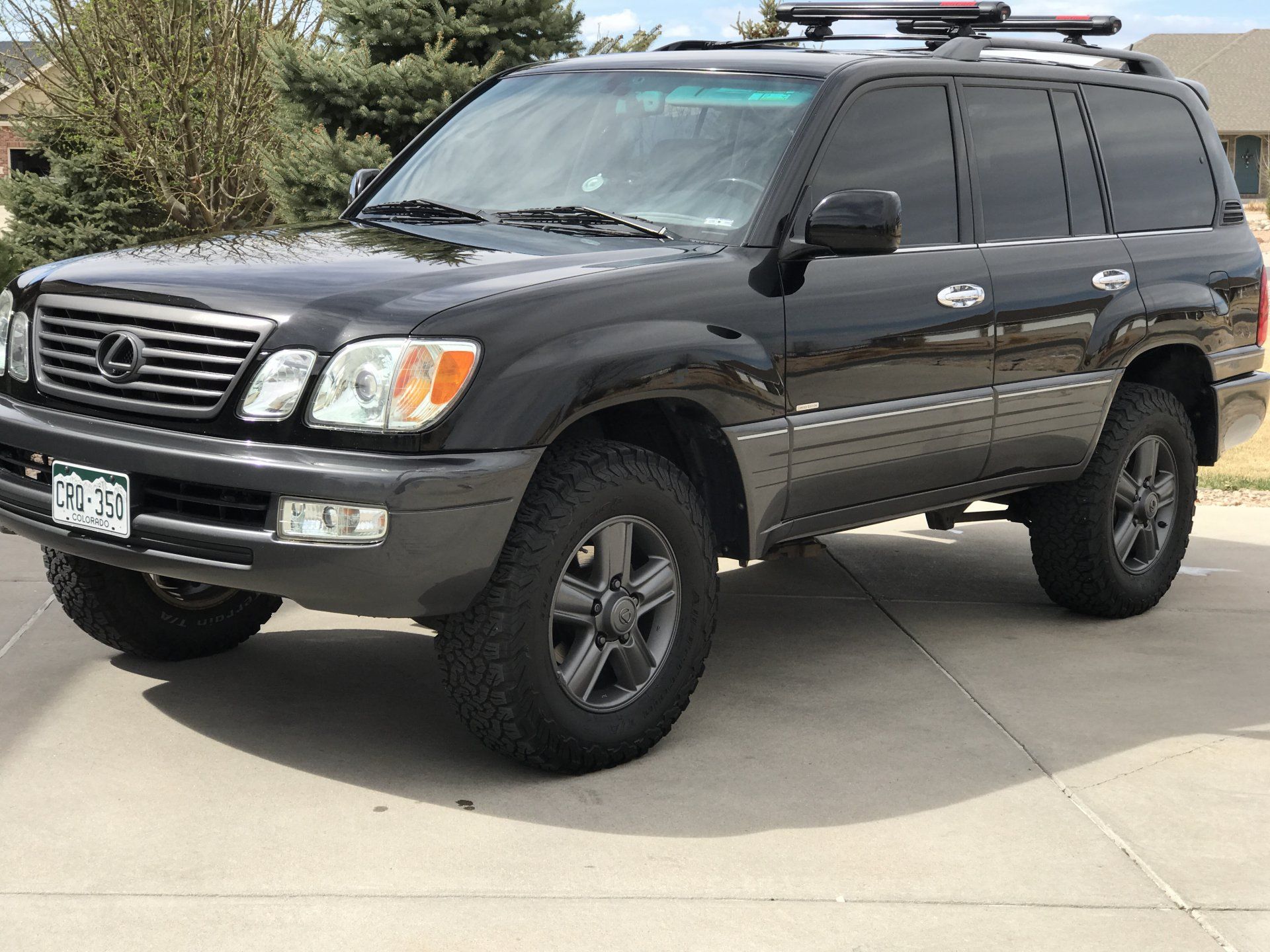

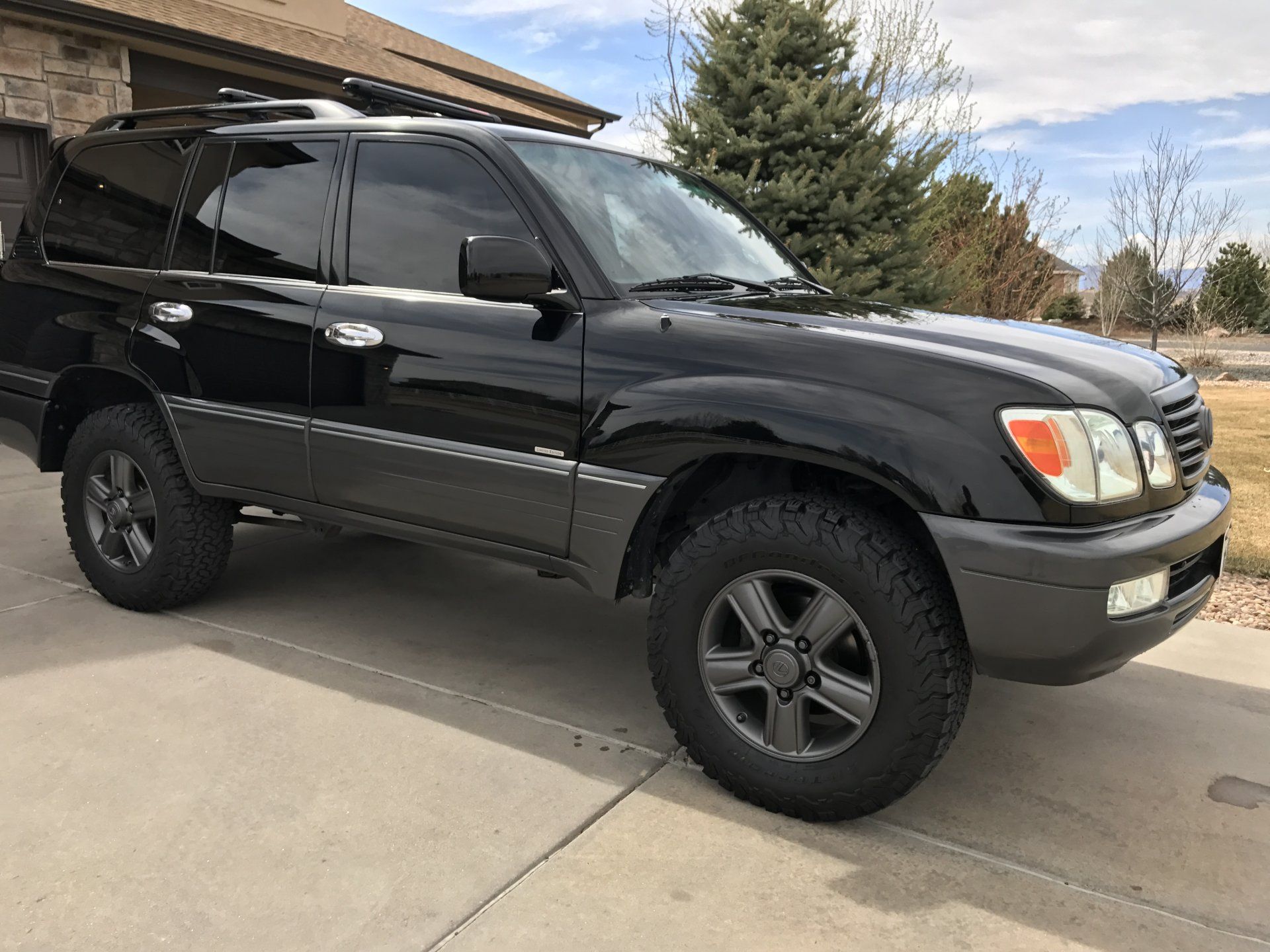

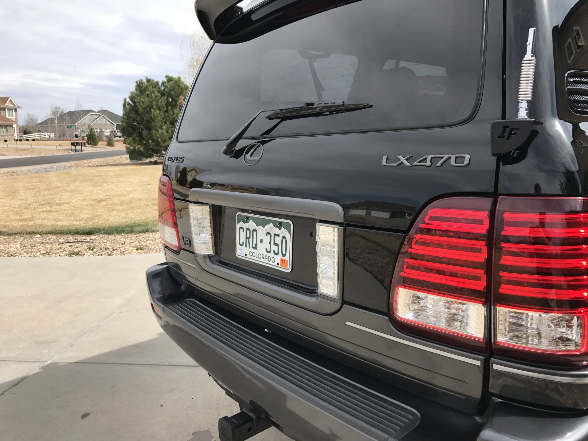

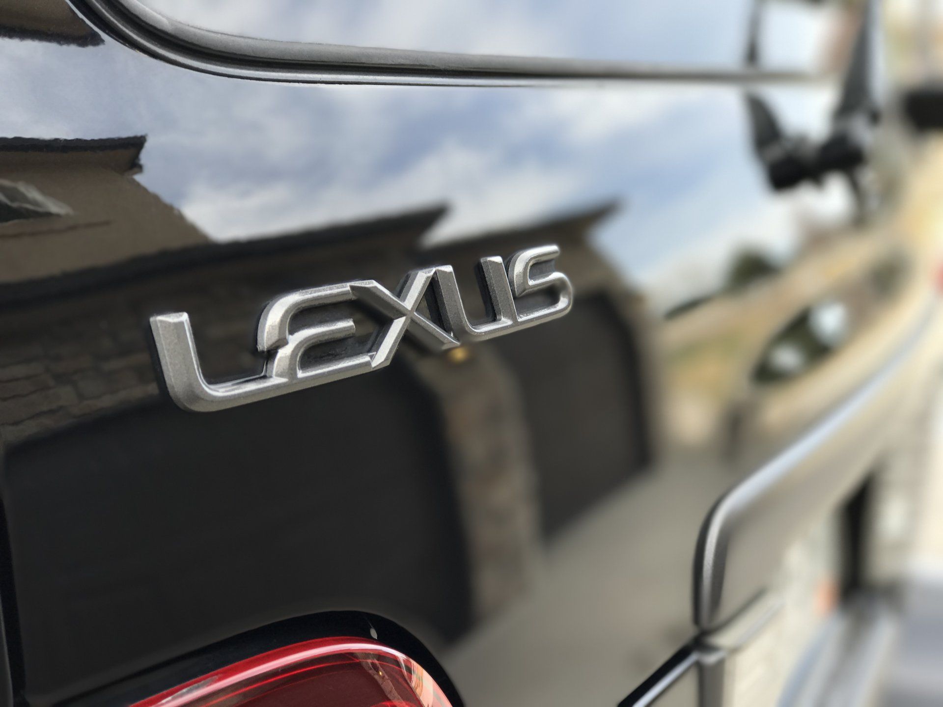

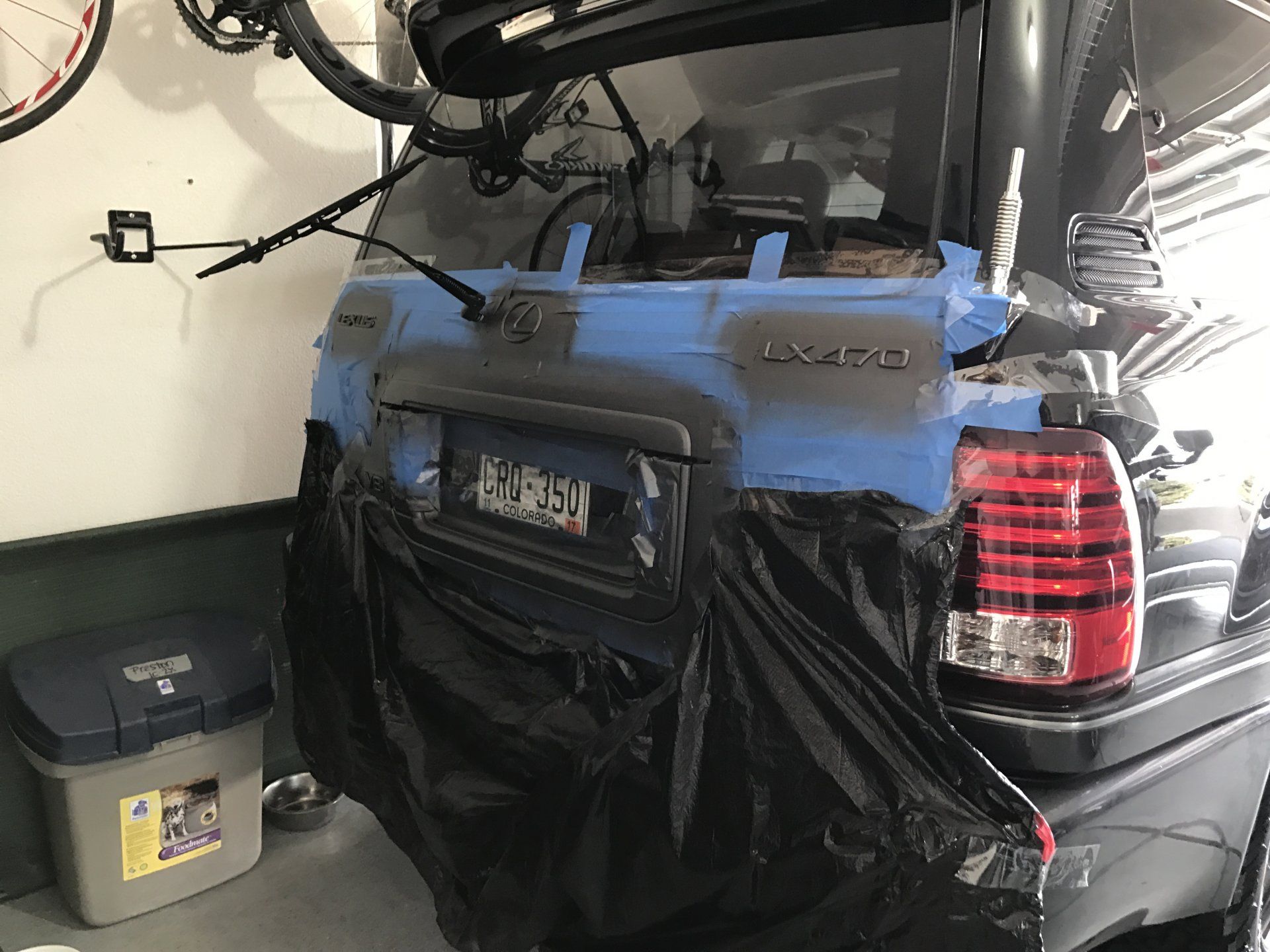

Washed, De-badged and added a few HP's

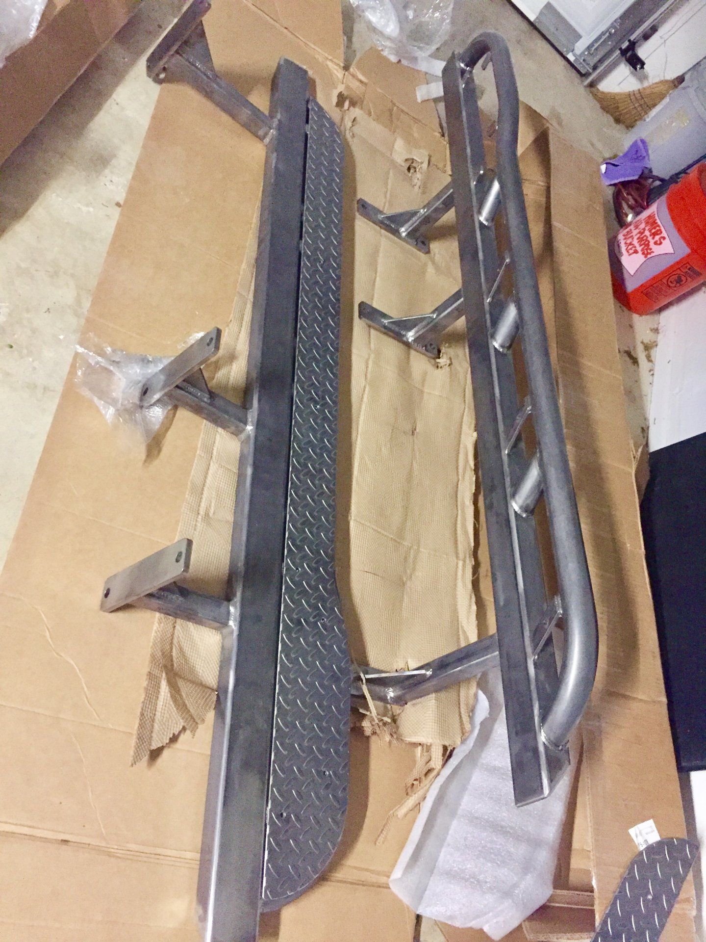

View attachment 1427065 Christmas in March has arrived. WKOR sliders with full top plate. They made them at a 10 degree angle for a better step. Skipping the gym this morning and headed to the hardware store for some primer. Still debating but I'm 99% sure I'm going to paint them "anthracite" color to match my wheels. Any thoughts?
lets see how they look!

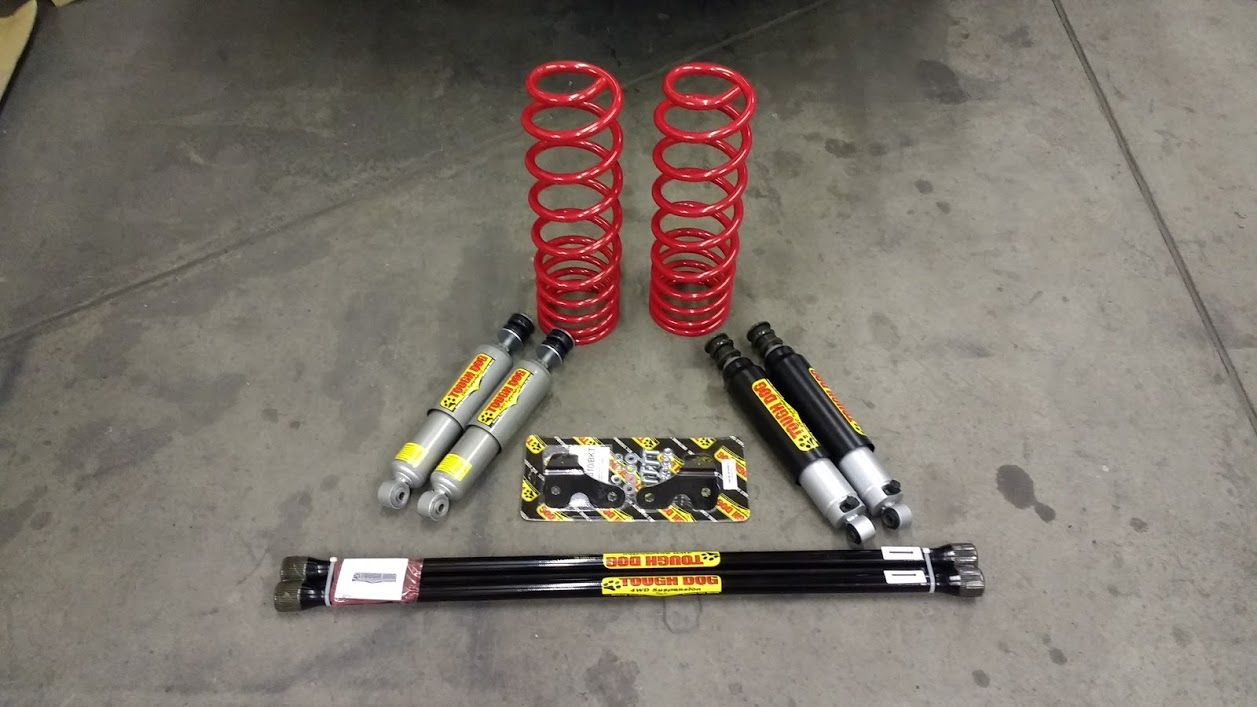

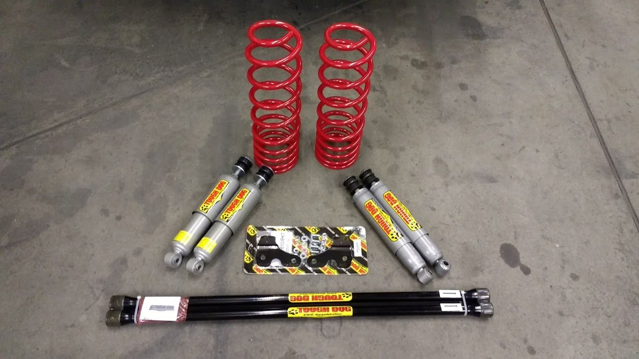

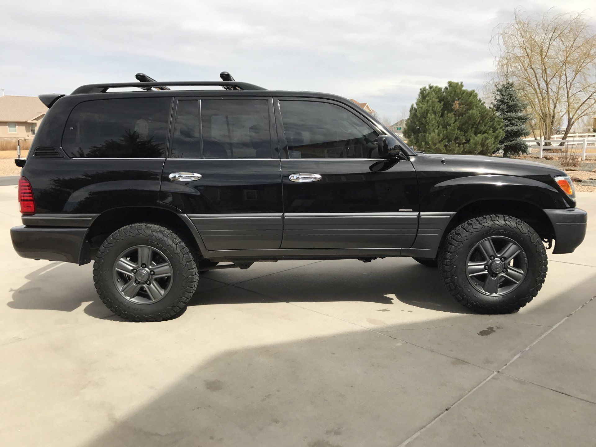

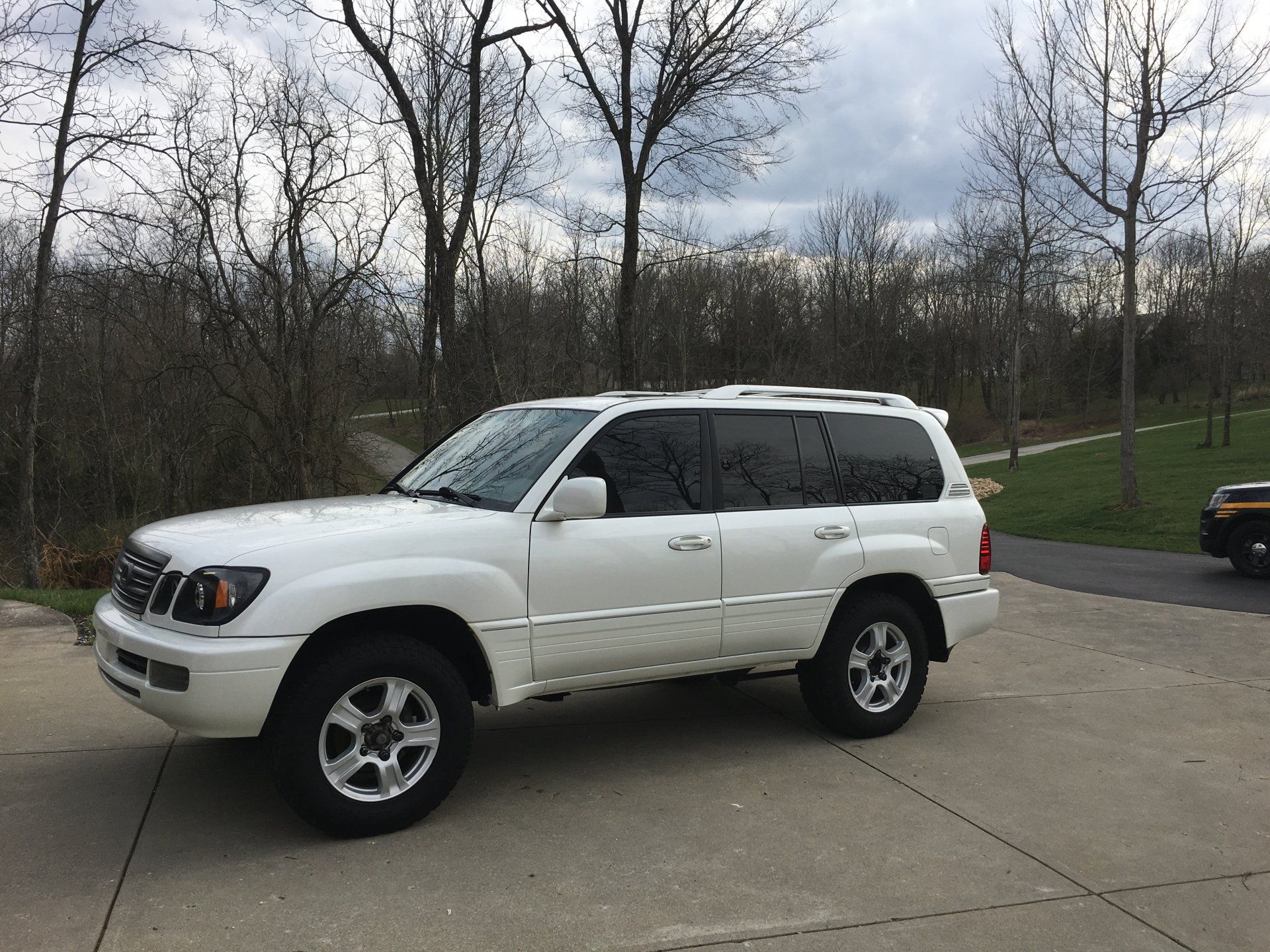

The big box truck dropped this of today...I THOUGHT about doing it! Plan to install some 865's and these items next week!
TourFlex with 53mm fronts and 45mm rears
w/ 53mm fronts and 41mm rears
Are you installing or advertising? Just curious because I'm running the first pic on my LX. I'ts taken me a long time to fine tune it as the adjustment dials on the 9 stage adjustables have zero feedback or indication of when you have gone to another stage. After lots of driving around i've found the most suitable setting to be as close as I can make out 2.5 notches firmer from the softest setting.
Ideally my Big Bore 50mm's at the front will ride better when I have a Sahara bar fitted. All in all though, i've been very happy with it and they are a very popular choice here in Aus - Tough Dog-.

I'm the main US distributor for TD. I've installed several on customers rigs and my personal rigs alike. The dial works from the 12 o'clock position clockwise to 12 o'clock and then BACK, not continuous clockwise back to 1, 2, 3..... If you look at the dial there will be small dashes and large dashes. The large dash when first installed should be straight up and down in the 12 and 6 o'clock position, this is stage 1 it is the softest. First clockwise stage is 2, then 3, 4, etc.. the larger the number the stiffer the shock becomes. I run my 100 for the most part in 5, offroad 2-3, highway 7-8
Each stage doesn't actually physically "click" into a stage. Its more like a gate/petcock valve. Progressively increasing or decreasing the oil that passes through the valve of your chosen setting.
Hope this makes sense to you.

That does help, Thankyou v. Much mate.
I went to the factory as it's about 3 hours from my home. Quality operation.
What is your personal favourite setting for a

What would be your personal favourite setting for a nice highway ride whilst still being able to corner well enough and without harsh impacts?
Thanks again mate!

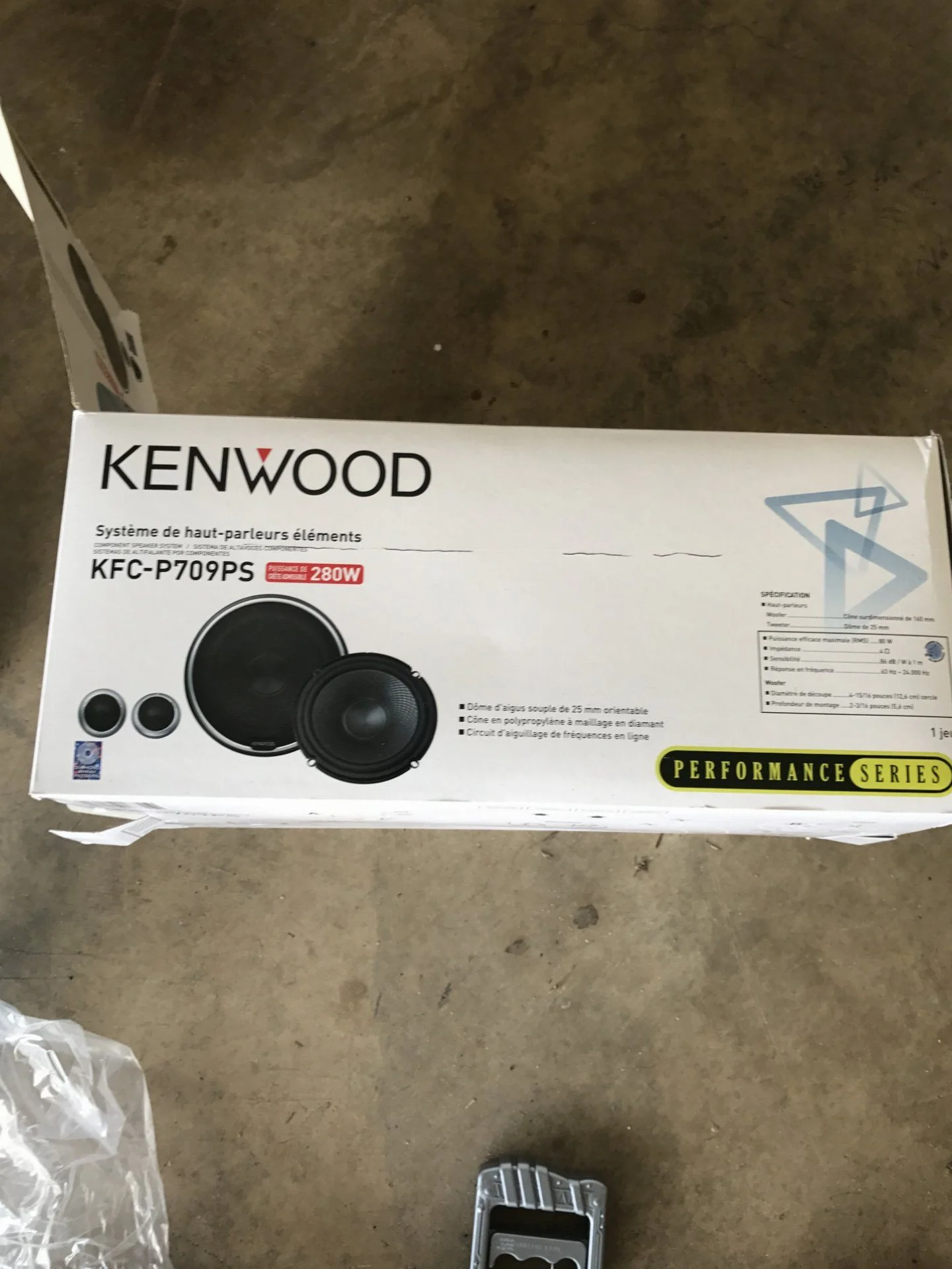

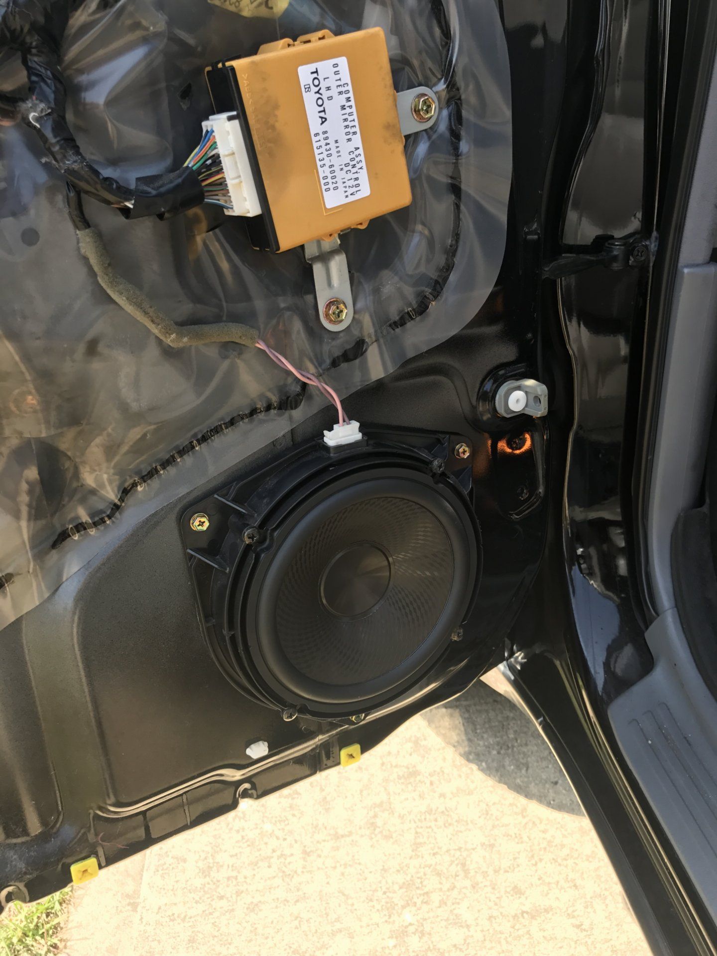

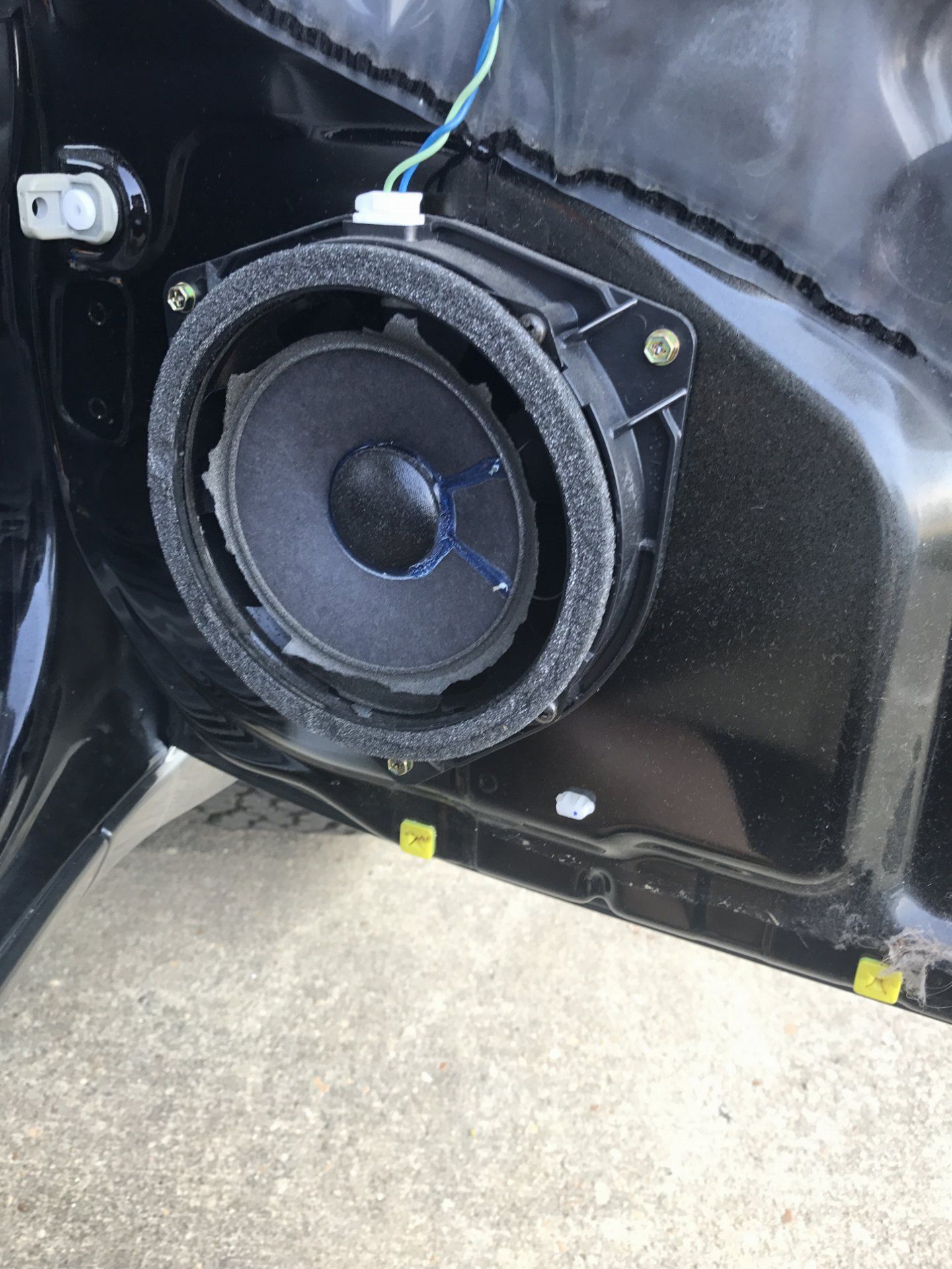

Tore my door panels off and replaced some blown speakers in the front.
Both sides looked like this:
Replaced with:
Had to modify the holes a little bit to fit but it was pretty cake install to say the least. They sound 100x better.

Is that plastidip?
Yes it is. Went on great. Probably 6-7 layers plus 2-3 layers of their "Glossifier" product. We'll see how it holds up on the trail.
