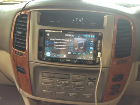

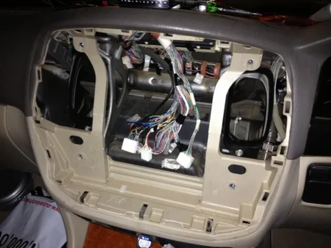

Took out the Toyota pioneer mp3 radio and fitted a AVH 5550BT straight outa Bangkok... very cool upgrade, didn't cut any wires, just stripped so I can reverse the procedure without too much hassle

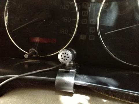

Put the mic here for now, will decide where to put it when the reverse cam & proper App radio cable arrive
Fit straight into the standard setup, luckily the speakers tested at 4.3 ohms at the head unit end, so that must be a reading from the factory amp... Sounds good, can only really go half way on the volume or there is distortion on the speakers but nothing is blown so that's cool
Managed to get the speaker wiring correct first try, thanks to this forum, pink+ & Purple- front left, green+ & blue- front right, and the back 2 were red+ & white- left & black+ & yellow- IIRC
