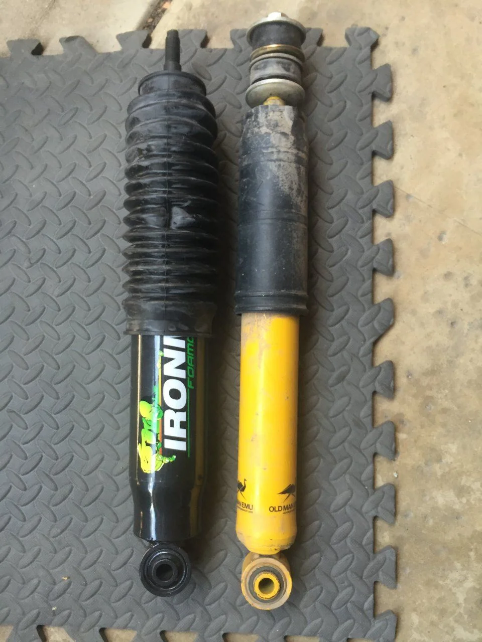

Installed Ironman Foam Cell Pros and extended (80 series) rear sway bar links. No off-road use yet, but if the usual commuting bumps/cracks and 15 manhole covers within a half mile are any indication, I'm pretty happy with the ride over the OME NitroChargers I removed after 2.5yrs. No more annoying enough jarring over bumps and my ARB fridge rattles way, way less over small bumps - even barely loaded on 864 springs. I thought a lot of my worries were from the stiffer sidewall of the Cooper STT Pros I recently put on, but no, all better. Did I mention I was happy?
