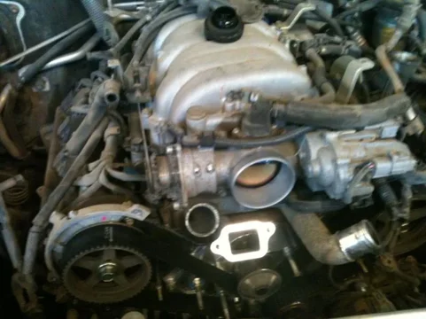

First for me, timing belt cover off

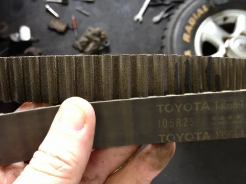

Little cracks starting to form at the bottom of the semi circle inside the belt

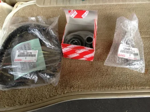

Timing belt kit for 1HD-FTE

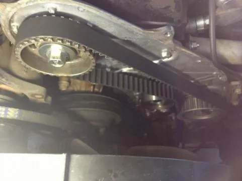

New tensioner, pulley & belt in, and timing marks checked by rotating engine 3 times
Cover & new sticker on

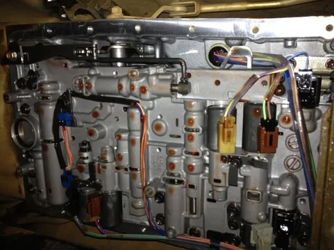

Dropped the sump & removed fine mesh filter, cleaned in engine cleaner, left out to dry, put back & replaced gasket on sump

ATF oil into Gearbox, first used 9.5 litres, then opened ATF level plug in middle of sump and 5 litres drained out, then ran engine and warmed upto 46 degrees celcius & rechecked levels and topped up to about 6.5 litres total... But of a mission, but had to get it right, re checked next day and level ok!
