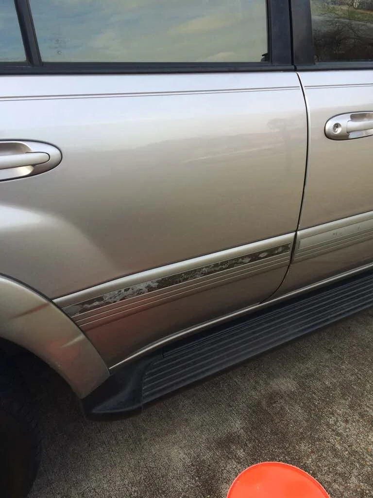

In the process of painting the "ugly" stripe.

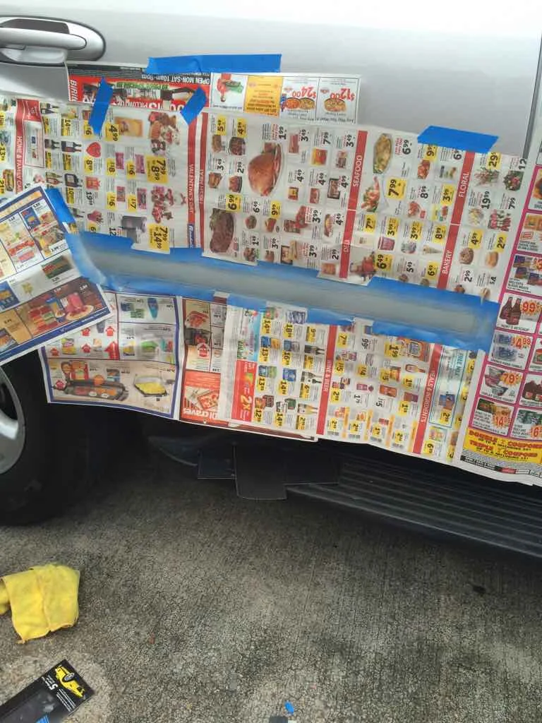

Taped it up, sanded it and primer. Drinking a beer while it dries some.
Not an exact match as the others, but it looks 9999x better. Will most likely just paint the rest the same.
Looks great! Did you clear coat it after the base?
Thanks. I didn't think about clear coating them, but will go back and do that when I paint the rest of the stripes.

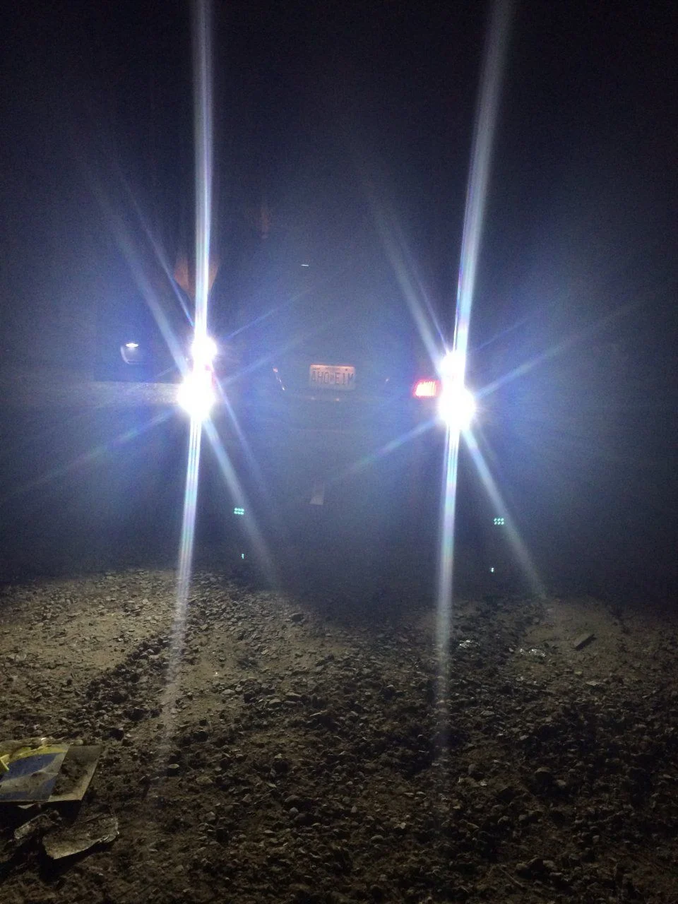

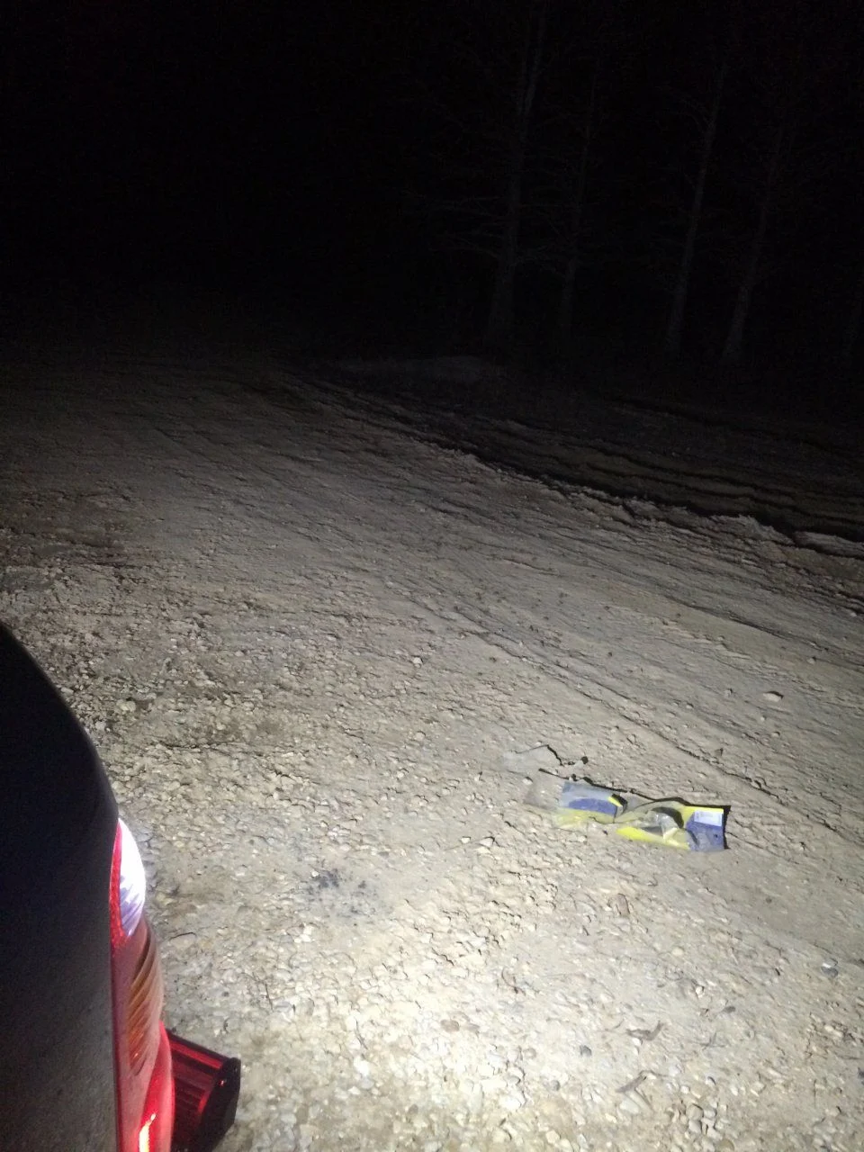

@joedirt it wa really easy. I pulled both rear lights out and cut wires going to the reverse bulb and tied in wire I had going to the lights. I love it. This was very easy all you will need is. Big washer for the underside. They only come on in reverse there is no switch bc I did not want to deal with running wires to the battery
KAWELL® 2-Pack 18w 1260 Lm Cree Spot Led Work Light Bar LED Off Road LED Work Light Worklamp Spot Beam ATV SUV Jeep Mine Boat Lamp https://www.amazon.com/dp/B00IXDHYQO/ref=cm_sw_r_awd_pHo1ub0HNCDXR
