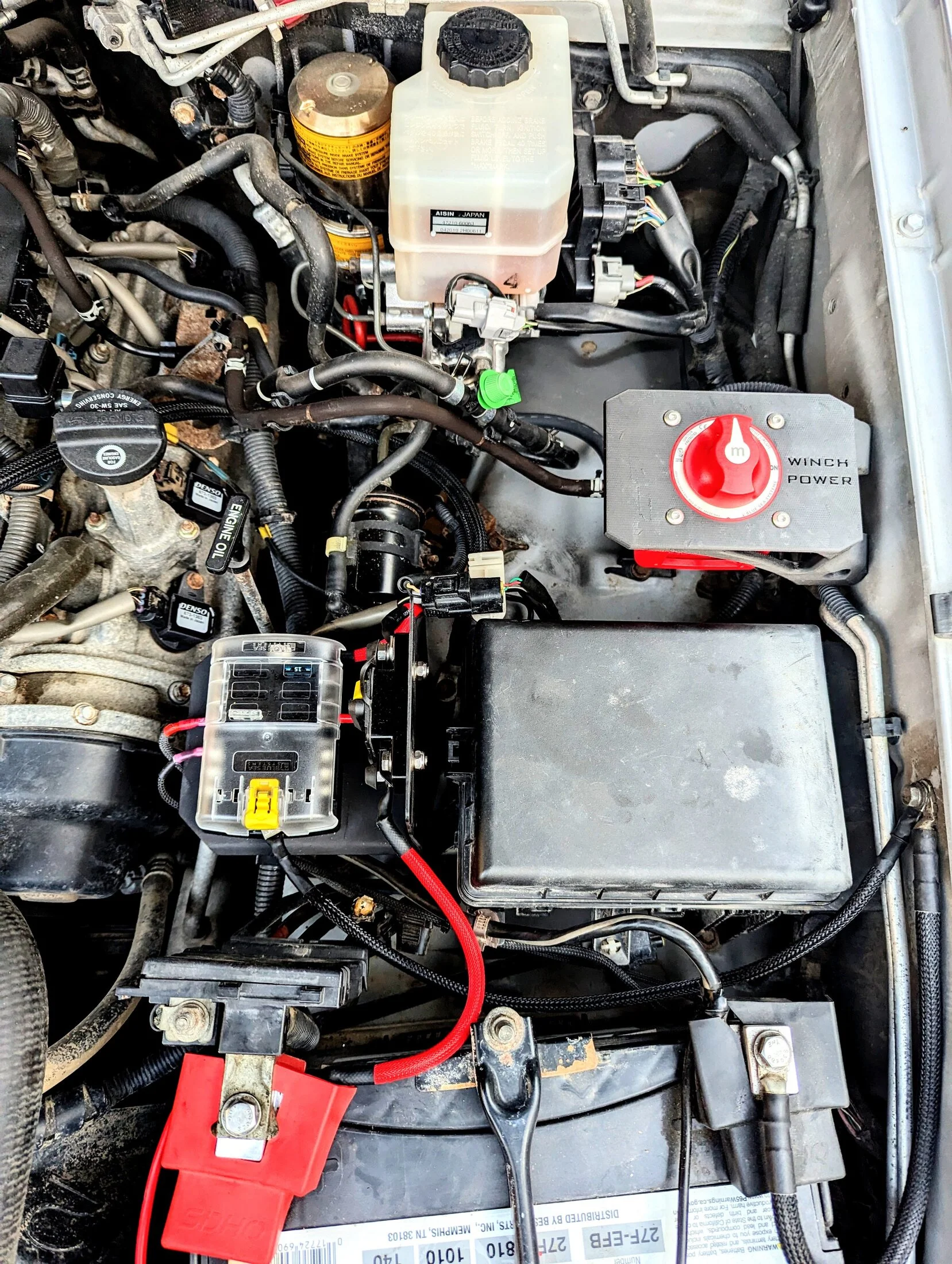

Finally started on wiring, got the winch power switch bracket from @suprarx7nut mounted in without issue on my '04. Still need to decide on a winch and purchase one, but one step at a time.
Added an accessory tray from @Ramathorn15 that I've had for a few years with a 6-circuit fuse box and 100A breaker. Just running the headlights (HID retrofits) so far, I'll add in aux lighting etc. as time/budget/weather allows.

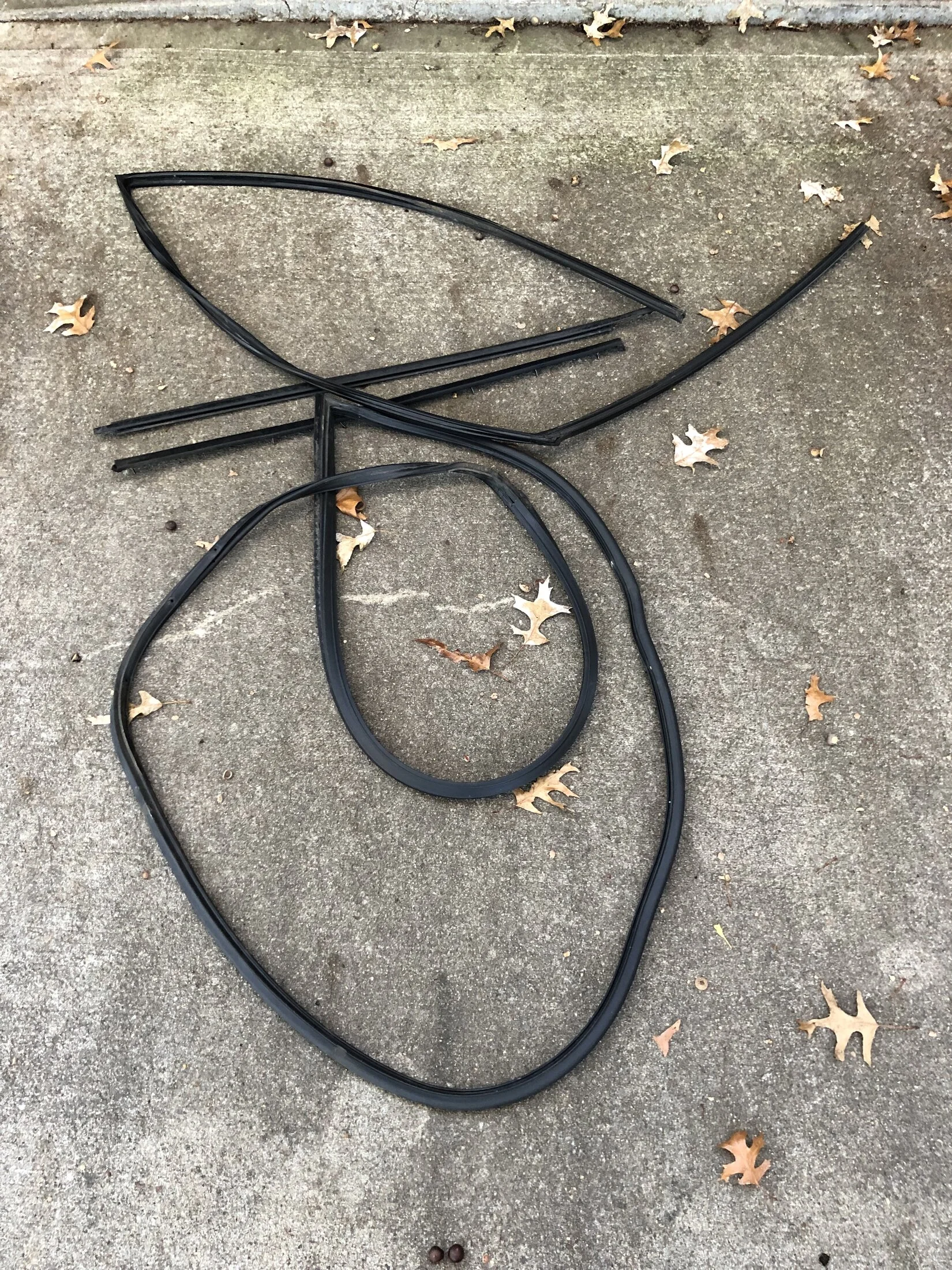

Got tired of hearing wind in my left ear while driving. Fixed!
When you bought the two straight pieces, did it come with both the rubber “gasket” and the plastic retainer bar? And how did you remove it? My kid broke the middle two pieces and I broke the top not knowing how to properly remove it.
Well, all the pieces you see are for the drivers door. The 2 straight pieces are the inside and outside pieces that wipe the window. The inside straight piece attaches to the door card with about 10 bendable tabs. You remove he door card and just take a screwdriver and bend the tabs. You will probably find it is stuck to the door card so you will have to use a trim tool to separate. The outside piece removal has been documented on YouTube several times and pretty easy to replace. I hope this is what you are asking. Let me know if you need more explanation.
Ahh gotcha. For some reason I thought these came off of the back doors. The little seal flap on the forward side of the rear doors are a little messed up on mine and while trying to fix it, I broke them worse. My eyes aren’t what they used to be and I hoped that’s what you replaced! Thanks for the reply!

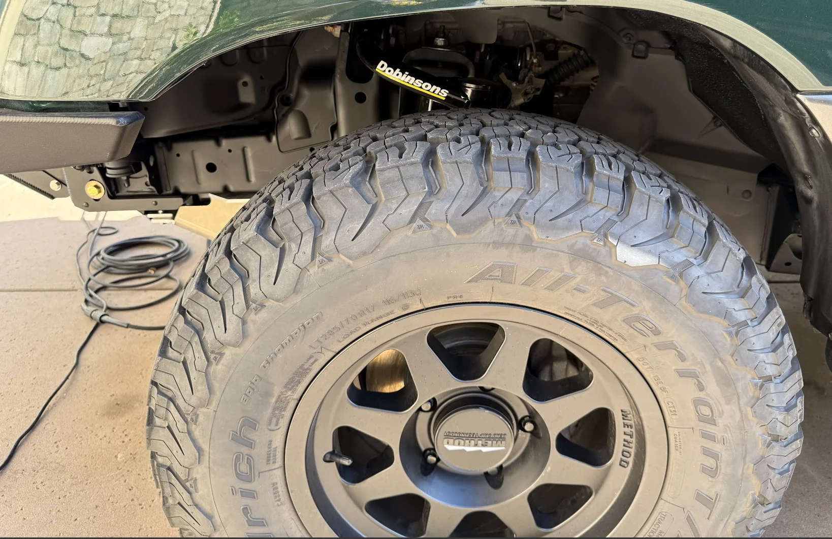

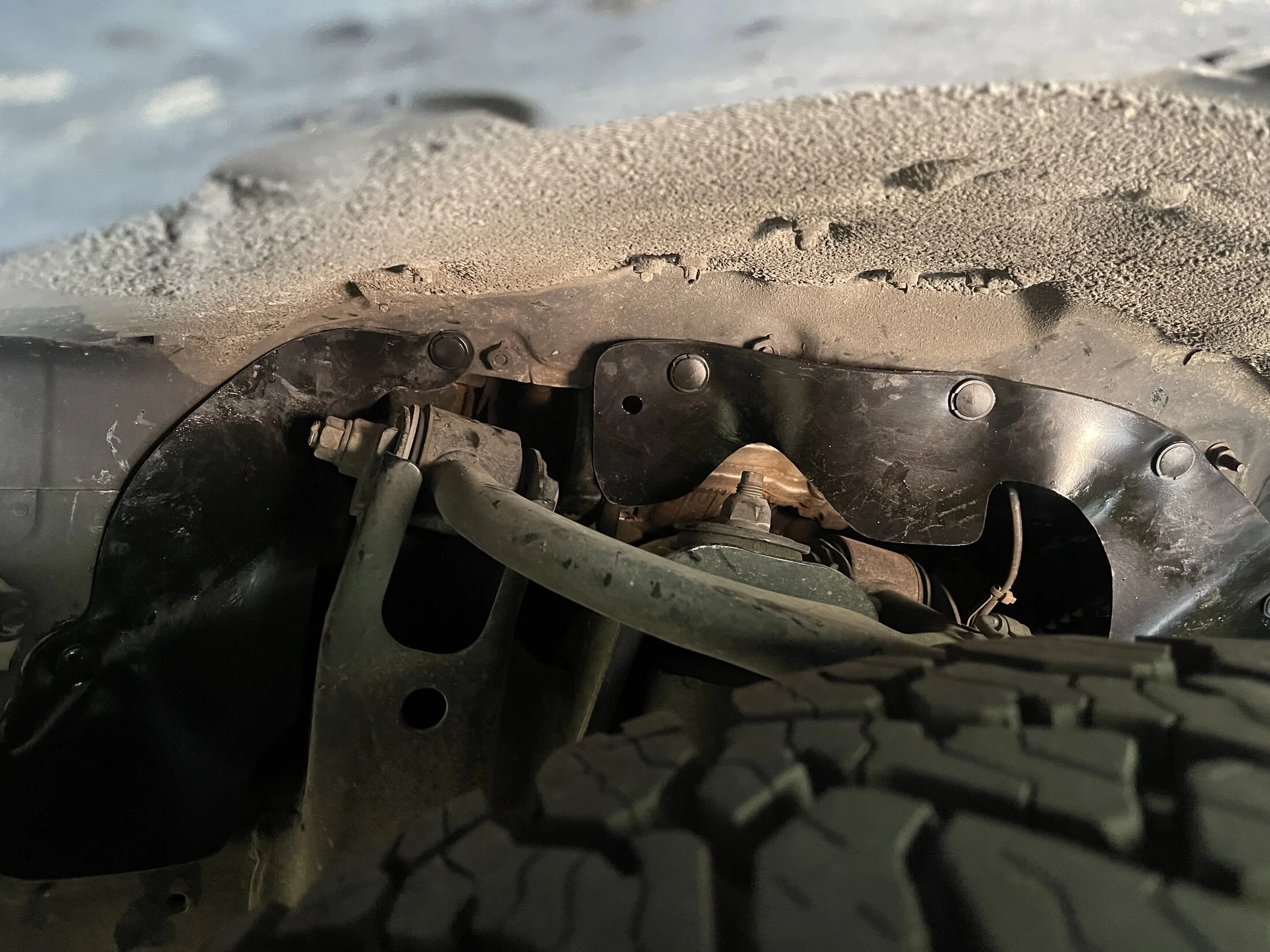

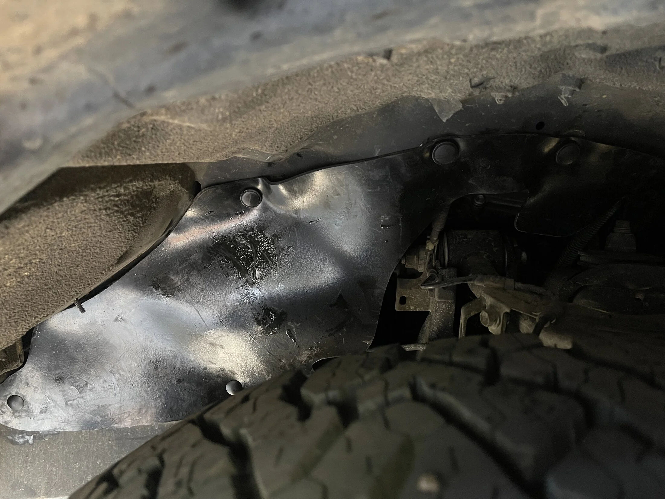

After I had my Dessent bumpers installed, you could see a lot more of the underside. Since I enjoy detailing, I spent 4+ hours on the wheel wells today, using lots of different degreasers and cleaners, wire and nylon brushes, and the pressure washer. I finished up with some paint on the metal parts (took pics before I did for resale, although it has been a Cali truck its whole life), and undercarriage spray. Pretty pleased with the results, although it will get messed up at the first rain. :) Now I just need to get a grommet for the one missing in the pic, and relocate the wires and windshield washer hoses a bit higher.
