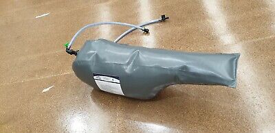

@TreatSmash, is that a water bladder? If so, any details would be appreciated. Been trying to think of a better solution than our current setup of a 6gal jug behind the drivers seat. It about drives me nuts listening to it slosh around back there.

Yes it's 35L bladder.
I got it on eBay,
I drilled out 2 holes in the wing face, added some grommets and the hoses come with the bladder.
Figuring out how to get the water into the bladder was more difficult, I settled on one of those pumps that you attach to your drill and I made a little hose extension to put on when I'm pumping.
It's gravity feed and it works great.
Thanks, sure are pricey but pretty sure I need one of those! Was wondering about the fill operation… gotta love a drill pump.
Well I had visions of a 12v pump AND if I could have found one that was bi-directional that's probably what I would be using, but between not really finding what I wanted and there being a lack of space (I also considered removing the AC unit in the rear and putting one in there) I just went with the drill method which is nactually really fast and easy. It'll pump 5 gallons in like 30 seconds man.
