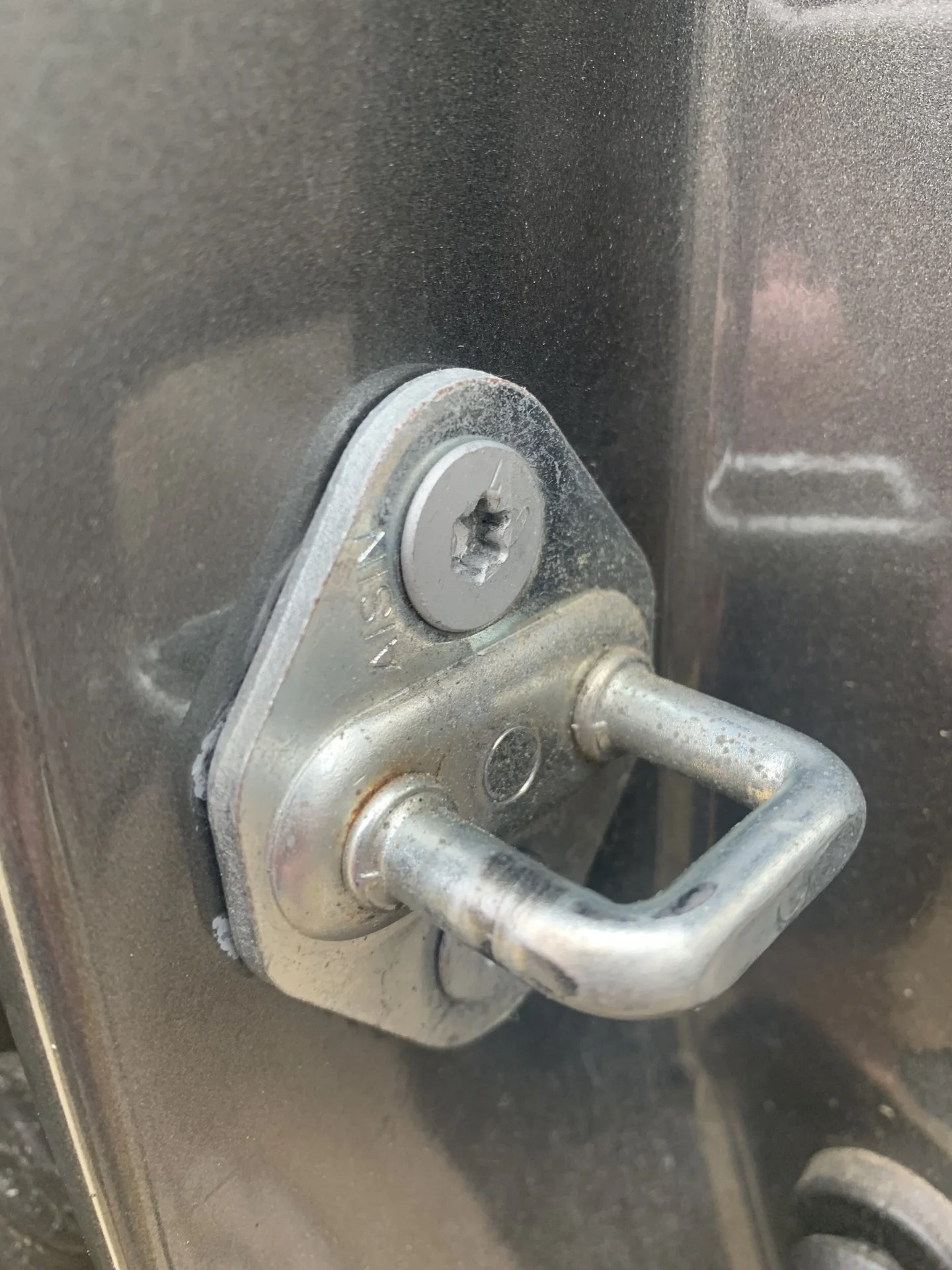

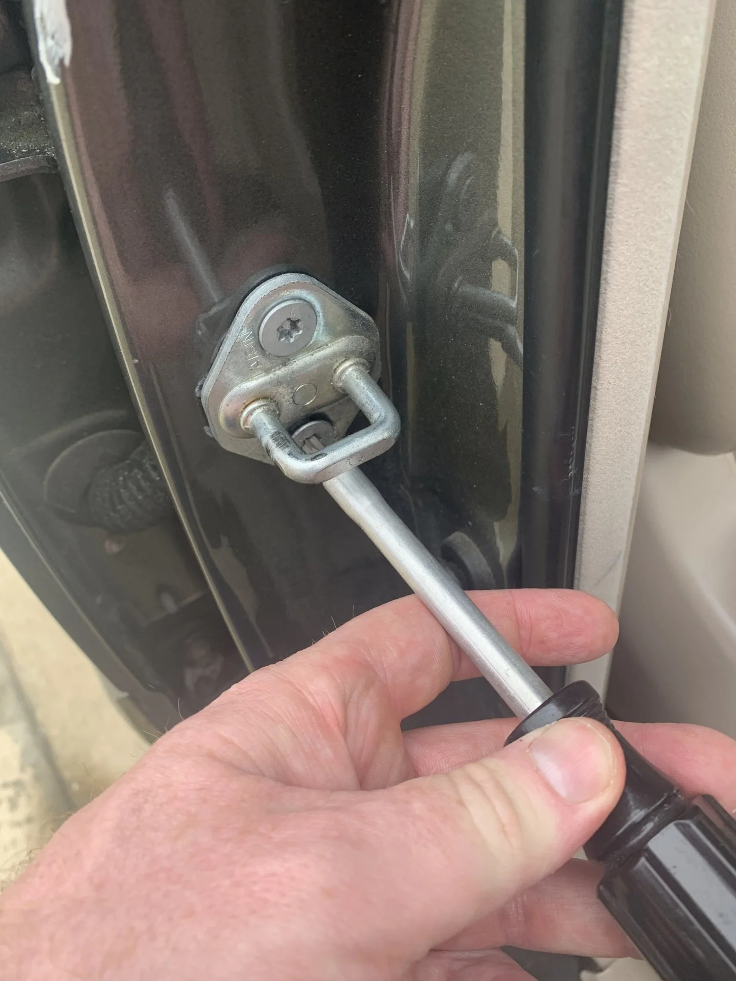

Not all LC things are LC-specific; plenty by now are just general old-car stuff. Passenger door was getting hard to shut and usually took two tries. I didn’t think the truck had ever been wrecked, so got to looking. Just needed the loose latch tightened up- I’ll probably keep playing with it and get some loctite on there when it seems 100%. 95% fixed while making my breakfast today.
Screw’s a T35- biggest torx bit in the box o bits.

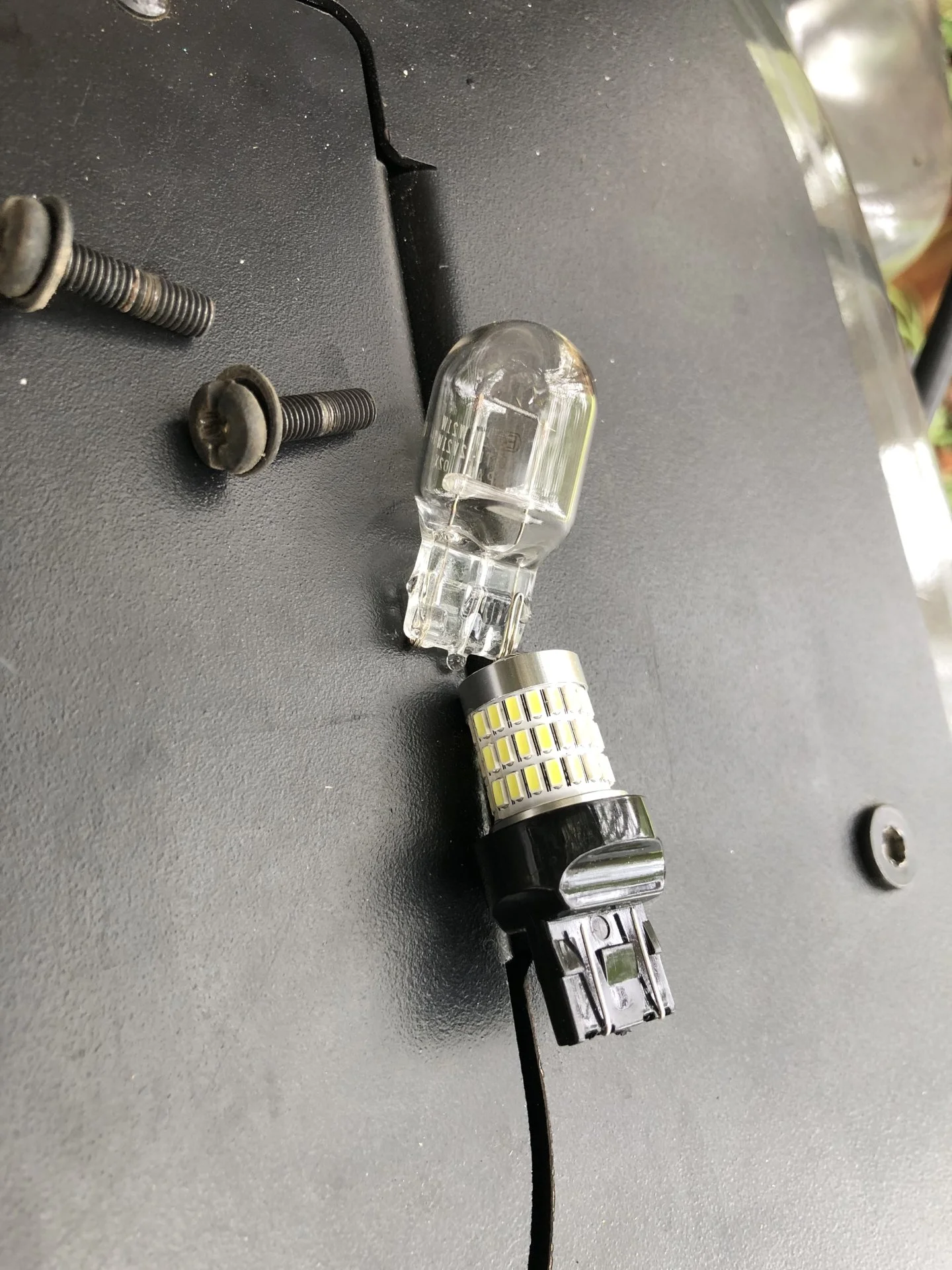

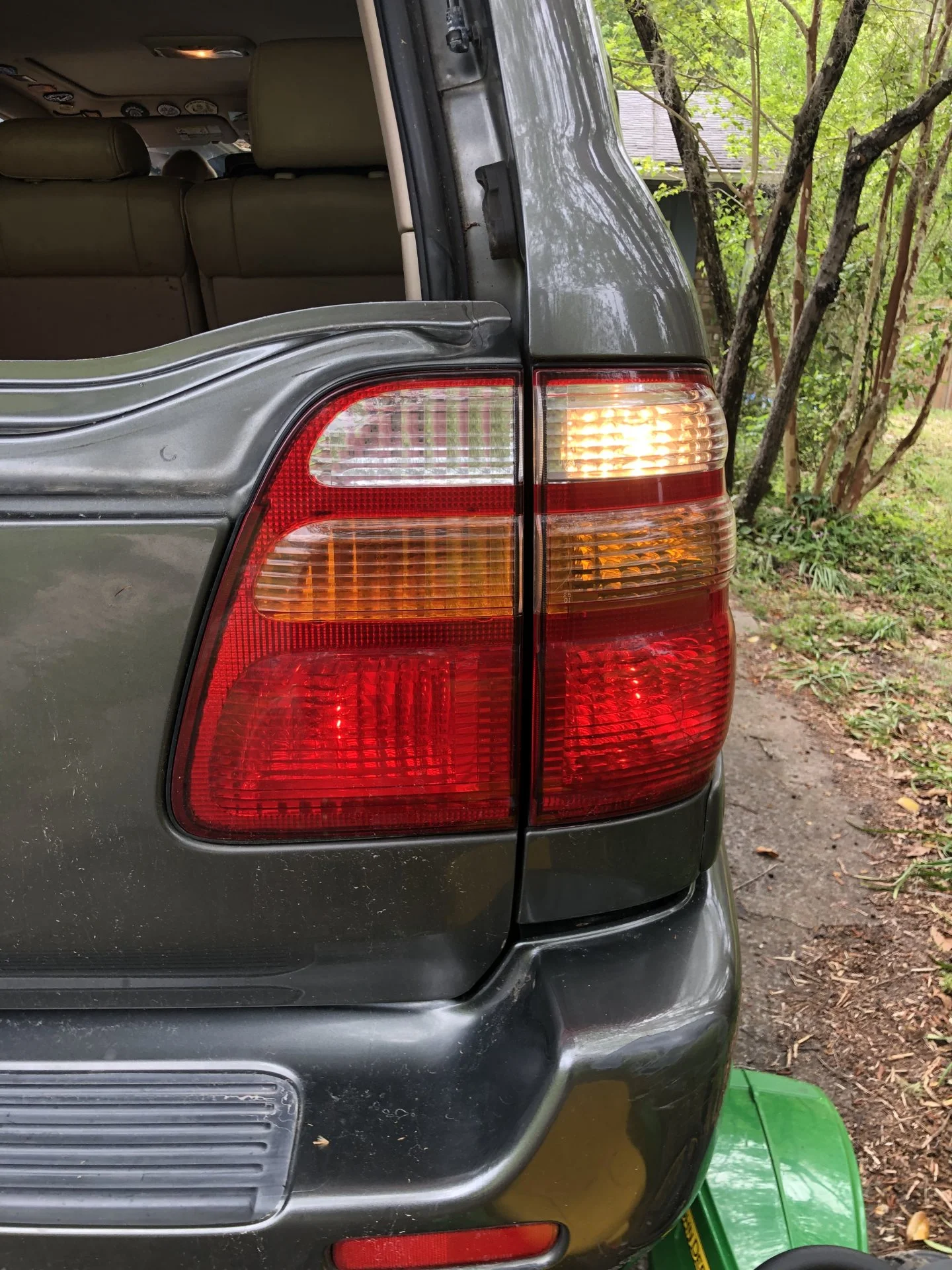

I also bought some “Amazon special” LEDs for the reverse lights. They actually look pretty good so far.

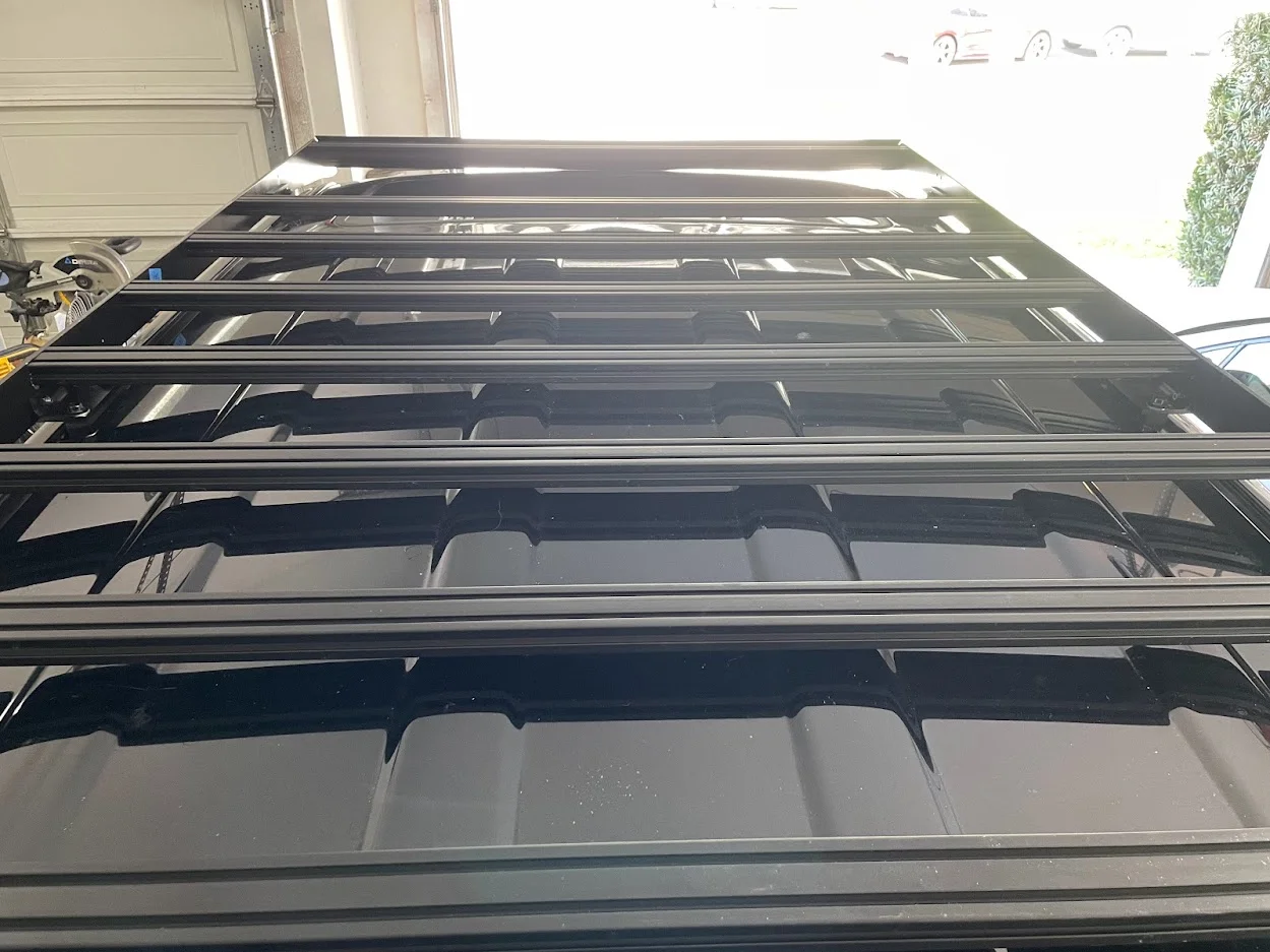

I can say that this DIY Prinsu style roof rack project is 99% complete. I'm waiting for Amazon to deliver the trim to put it on the bottom of the wind deflector. This project was truly a labor of love and sheer determination to see this through. Somethings I wished I had to make the job a lot smoother, like a drill press. Lining up the holes for the extruded aluminum cross bars was a challenge without a drill press. I had to sit there with a round file and kind of hone out the hole so it'll line up. Then I was sweating it drilling the holes in the wind deflector so that the T-nuts would line up properly. But i managed to do that but ran out of black oxide rounded 1/4"-20 bolts, so I ran to Home Depot to buy some nasty plated ones which I'll replace as soon as the black oxide ones come in.
If I were to do this again, and that's a BIG IF things I learned along the way things would be a lot better. But such is life.
EDIT: Amazon came and after i finished making the family dinner and ate, went back out to install the rubber molding. Now i can enjoy it.
