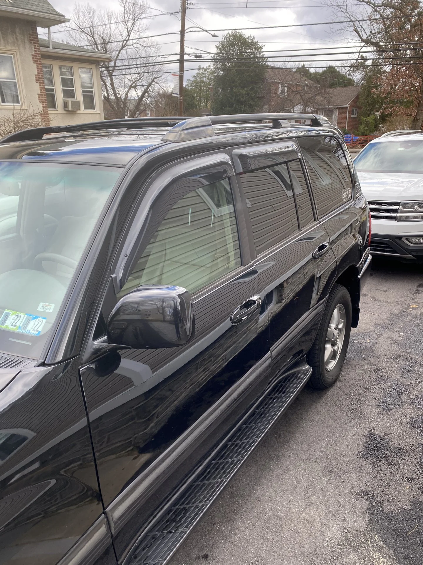

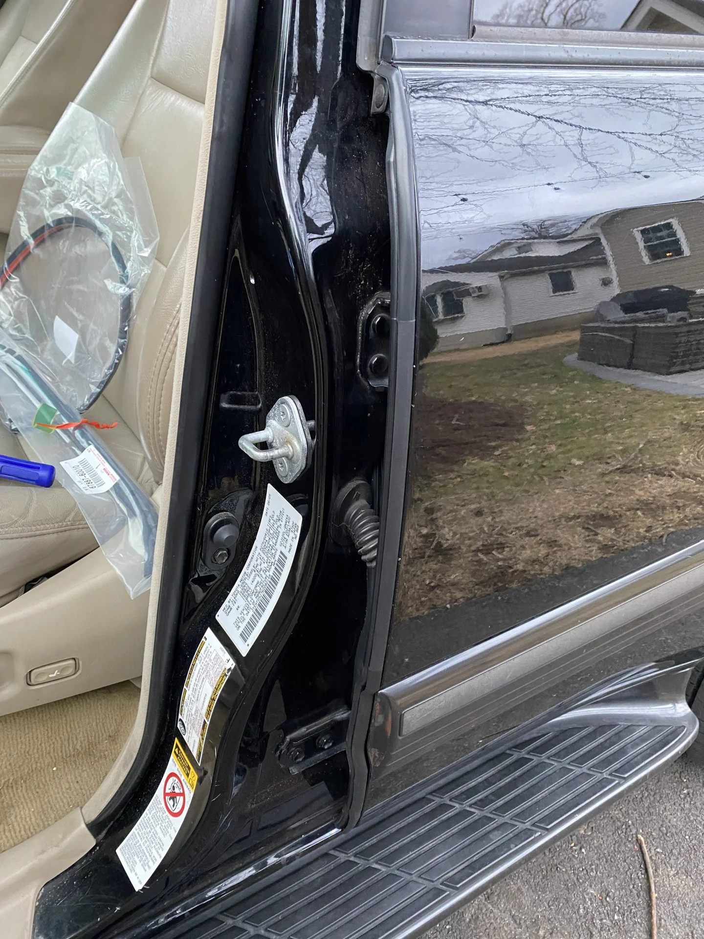

Installed the LX door seals, wellvisors, and overhead panel LED lights.
The WellVisors are really well built. I’m still getting used to them but I think I like them. I’m pretty tall so they obstruct my view a little bit but I think I’ll get used to it. It’s been crappy weather here lately but I’m interested to see how they are on a sunny day. I’m also excited to crack the window without a ton of wind noise.
Now Im wondering if can I still get a tint with those visors on or will they have to remove them? 😬
lx470 and LC have different door seals? My 98 is pretty noisy in the cabin.

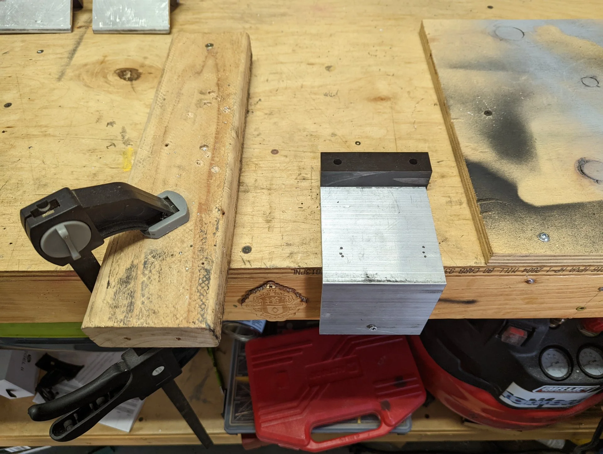

Getting to the finish line on this DIY prinsu style roof rack build. Today I tackled the mounting brackets, bought 1/4" 4" angle just in case, as I can always trim off the excess.
I devised this cross bar so I can determine with spacing of the bracket and then proceeded to slot the bracket so I can do adjustments. My bars are 51" across so I cut the wood at 50.5" + the 2x1/4" yielding me a total of 51"
It's painfully slow to slot since I don't have anything fancy, just drilling holes and cutting out what's left. Not elegant at all but it works. As I worked towards the front bracket the width of the truck is wider putting the slot really close to the right angle, so I'm going to try and use a straight cut 5/16 carbide router bit to slot those holes, if it turns out good I might go back and clean up the other slots. None of the big box stores have them in stock so ordered it through Amazon and expect to have it Sunday.
Prepping the "jig" so I can run the palm router run a straight cut.
I see the end of the tunnel can't wait to finish this up.
