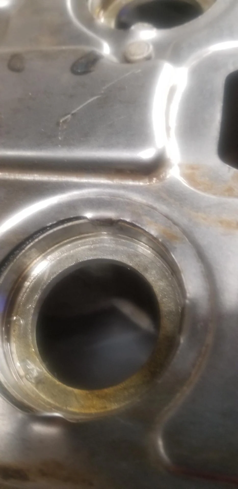

A simple spark plug change / bad ignition coil became much more when I pulled out a coil and noticed oil in the tube. I pulled the valve cover and sure enough, some idiot mechanic had simply forced the grommets in the slots without bending back the tabs. The grommets on the leaking tubes were ripped in places letting oil thru. I punched them out easily enough, but you can see from the image how the tabs were bent in. Pulling the other side this week as I know what I'll find.
A PO ground off the tabs on one of my valve covers...luckily they press in pretty tight and there was no impact.

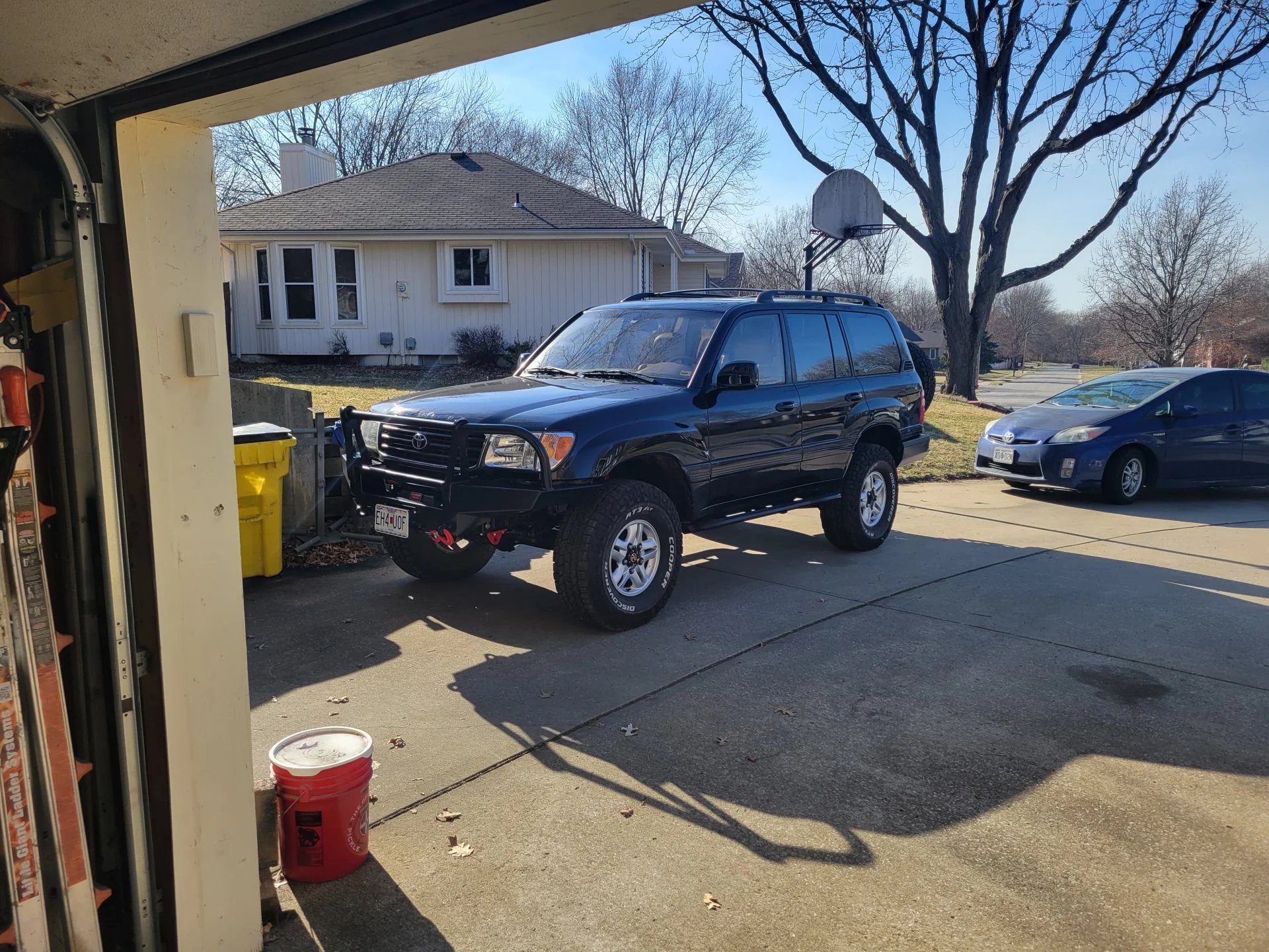

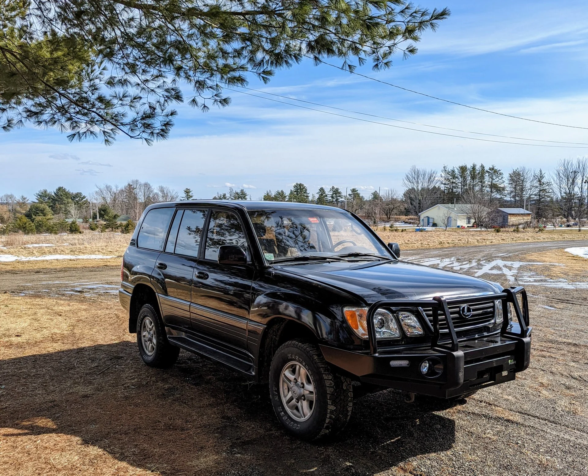

Bumper is just something I cut n welded together. Lights are auxbeam 9in spotlights. Extremely bright, tight beam. I'd say the throw is dang near 1mi.
I went searching to see if you'd already answered this question about your bumper. It looks really great, but now I'm bummed I can't buy one!

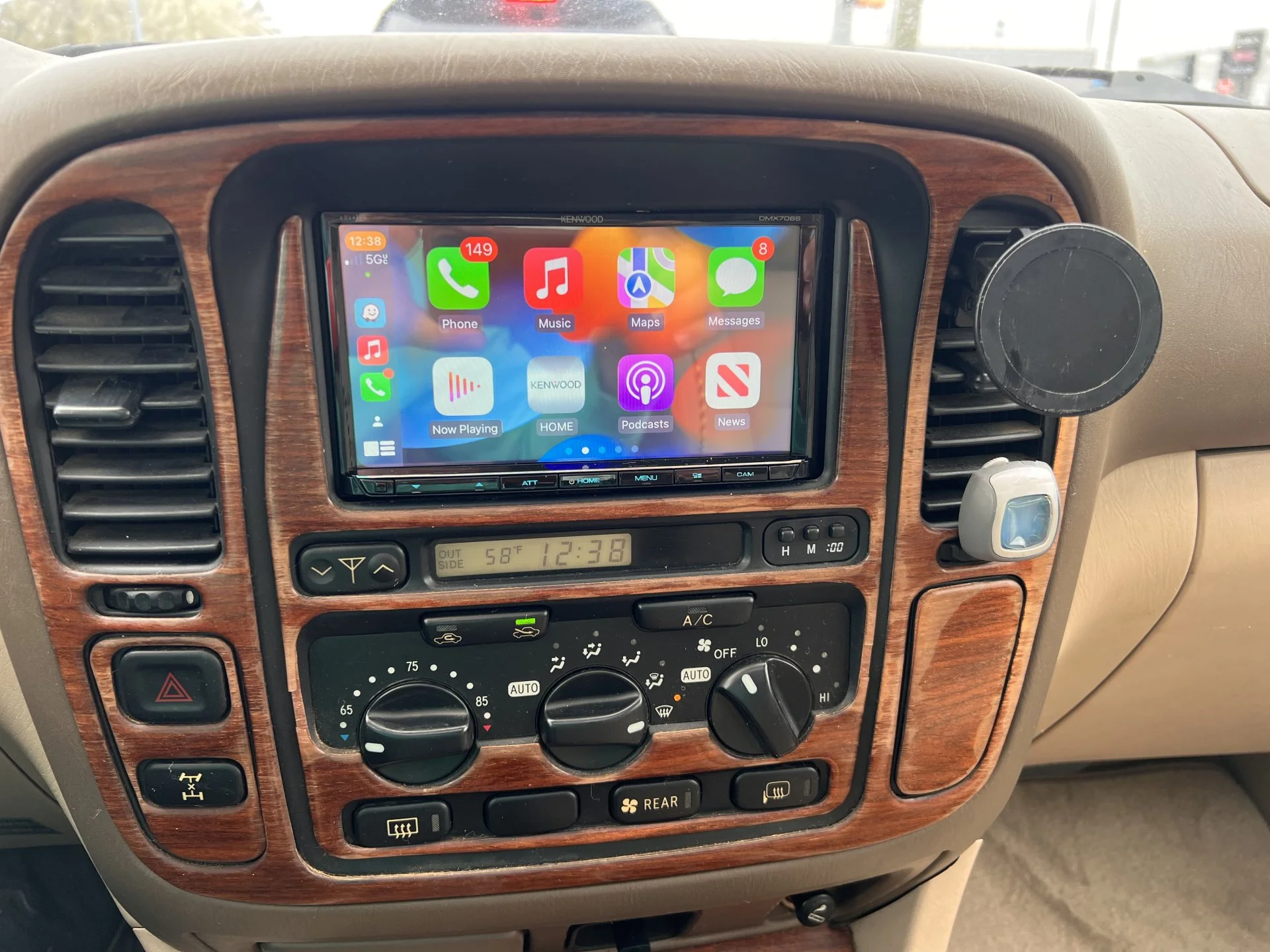

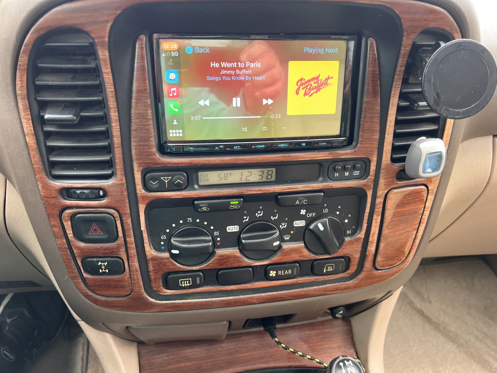

Had the head unit replaced with a Kenwood with Apple CarPlay (and Android) and a rear camera. - CarPlay works great so does the backup camera. This is a great upgrade to your legacy LC infotainment, plugs right in with no dash modifications

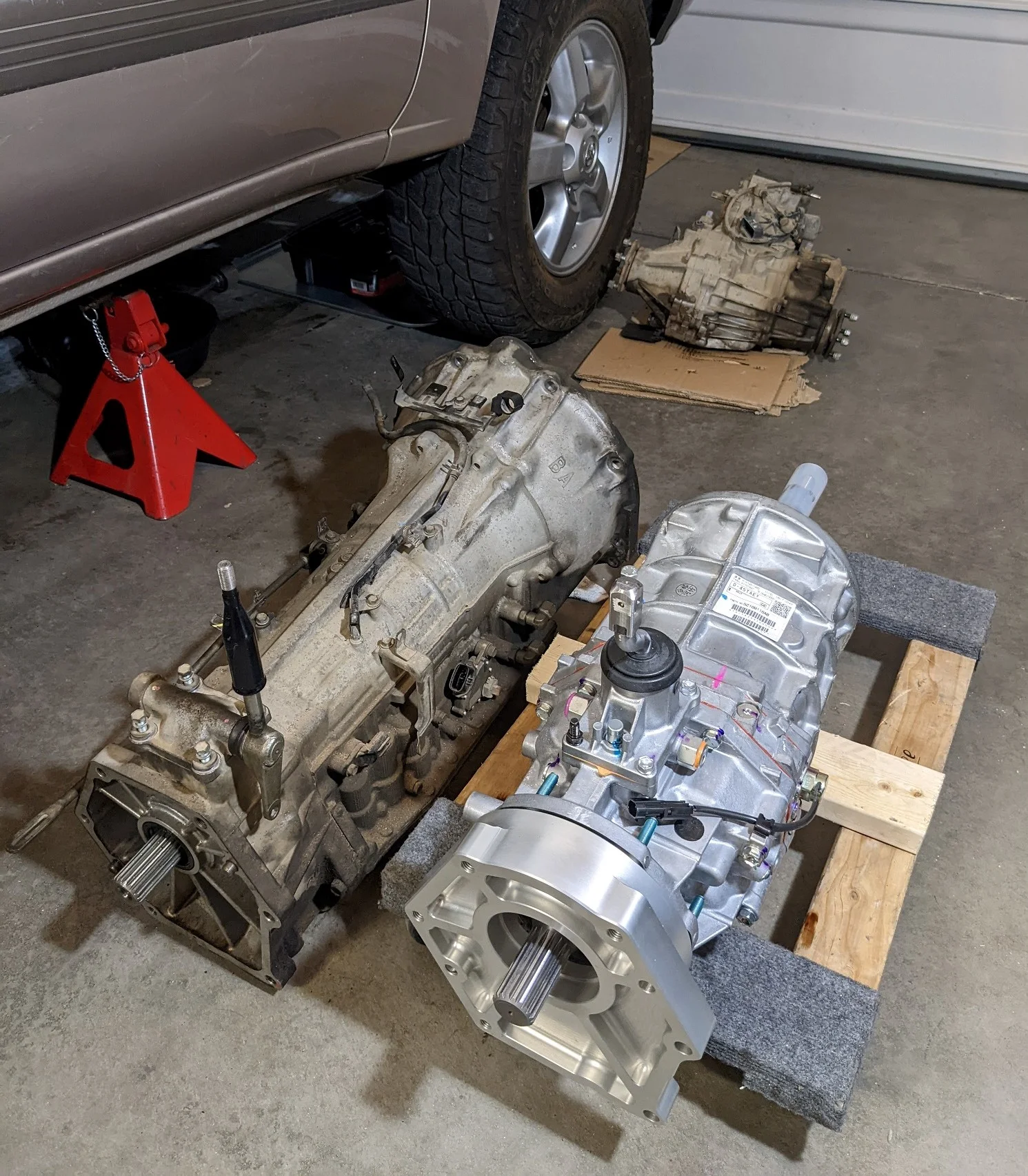

Helping my brother make this 06 LC a bit more fun with a third pedal :D

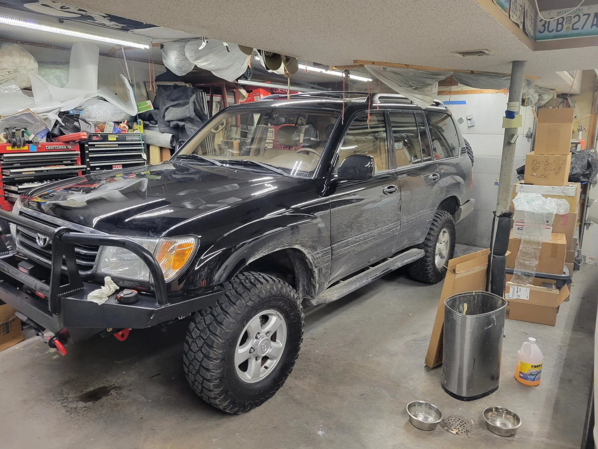

Had this thing a week, new 35" shoes today. It just looked too small with 33"s. Installed @Lutz Auto speedo calibration. SAS 100 done by @TRAIL TAILOR pd for by PO. Still a few things to dial in and check b4 it gets wheeled. I'm gonna have questions but reading thru lots of your all's threads for now.
Had this thing a week, new 35" shoes today. It just looked too small with 33"s. Installed @Lutz Auto speedo calibration ainstalled. SAS 100 done by @TRAIL TAILOR pd for by PO. Still a few things to dial in and check b4 it gets wheeled. I'm gonna have questions but reading thru lots of your all's threads for now.
If you’re ever in Arkansas I’d like to take a gander at that one and maybe take it for a spin

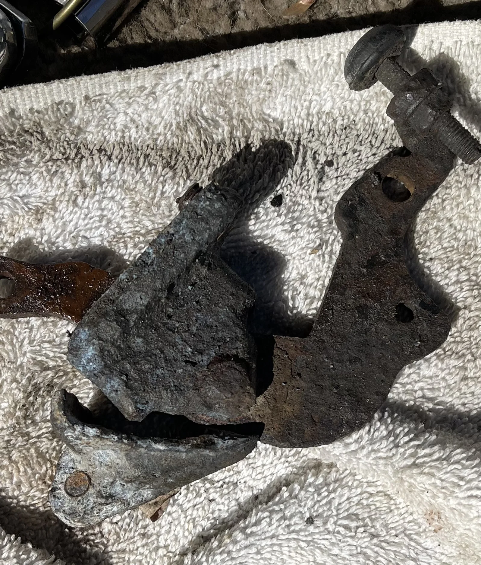

Starting to warm up in north Iowa spent a few hours on the non functional emergency brakes. This weekend I will get the drivers side and be ready for an emergency braking situation!
