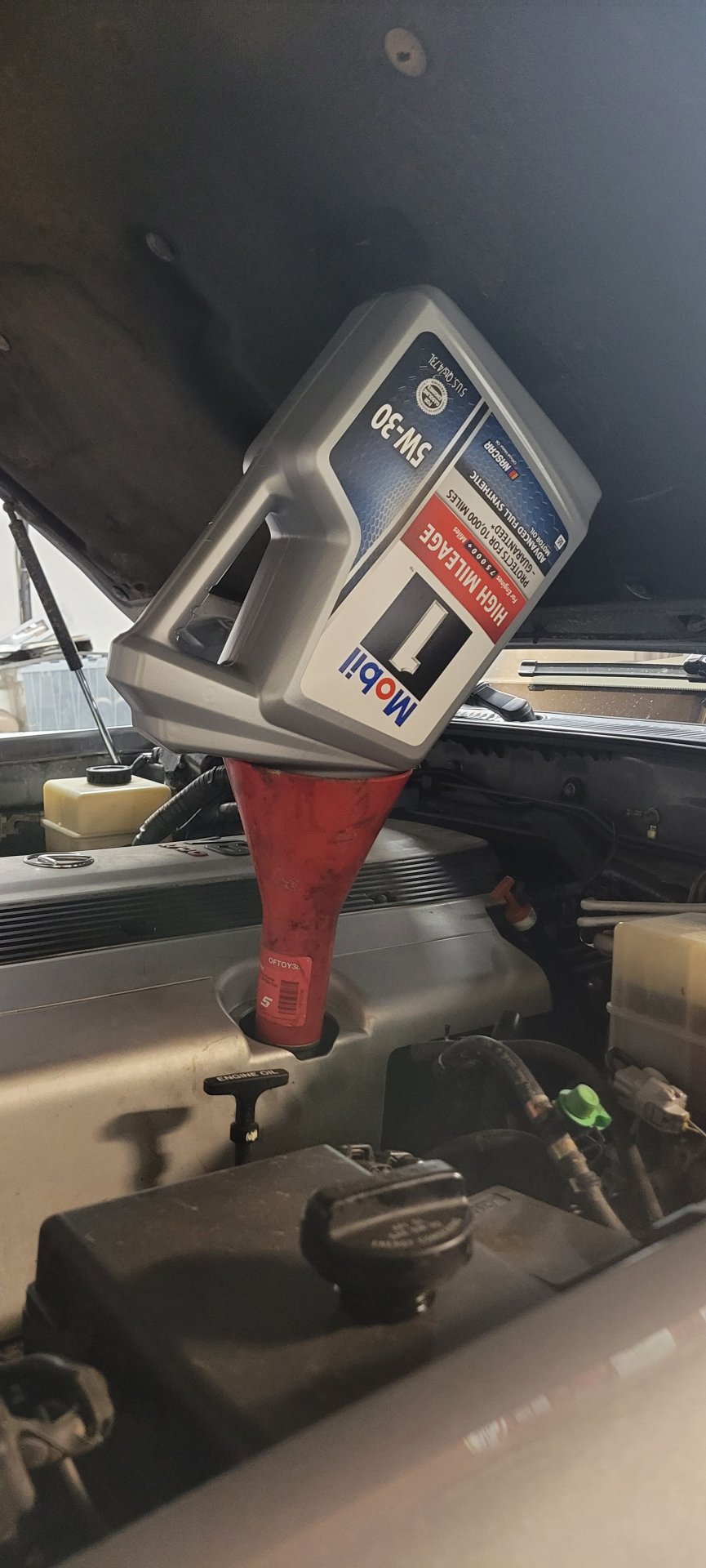

Just did my 470 yesterday... Mobile 1 HM is great stuff. :beer:
These oil have a little conditioning inside to help freshen rubber seals i think. I've heard that somewhere but too lazy to search.

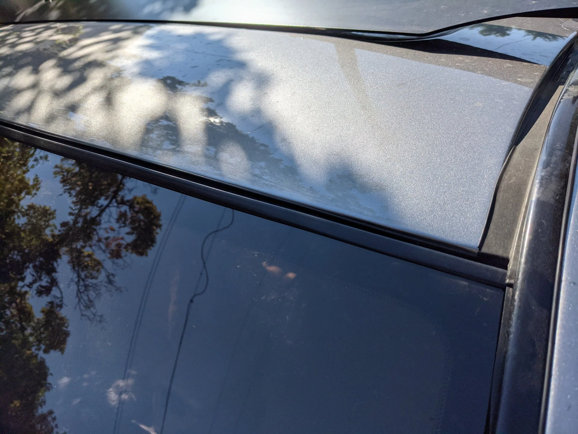

Had a rust spot over the windshield repaired. The previous owner had to have the windshield replaced in Argentina, and apparently they scratched the paint with led to the rust. Local body shop took out the windshield, sanded it down, treated it, and matched the paint. Hopefully that will protect it moving forward.
Before and after...

@Ghosting My passenger side A-pillar looked just like your first pic, but I also had knife cut marks all along the top edge of the window frame from shoddy work under the PO. My windshield got cracked bad on the freeway just a day after buying it, but was fully-covered by USSA (they even approved OEM TOYOTA glass with the correct green tint up top). Safelite needed the rust fixed first before they would replace the glass, so I had to take it to a body shop. My original quote was around $560, but after they got into it, the rust was much more extensive than originally thought. I wasn't surprised as the PO had a dealership/body shop address it many years ago during a windshield replacement (and subsequently making the problem worse with the aforementioned sloppy window molding removal). I'm now looking at about $650 for it to be completely sanded down, treated with POR-15, and then repainted and blended. I anticipate getting the Cruiser back tomorrow. Curious what your body shop charged you for similar work.

Total cost was $1500, but that included the windshield replacement, removal of the roof rack, replacement of the seals on the sunroof on top of the rust treatment and paint. I know these guys are expensive, but they do great work.

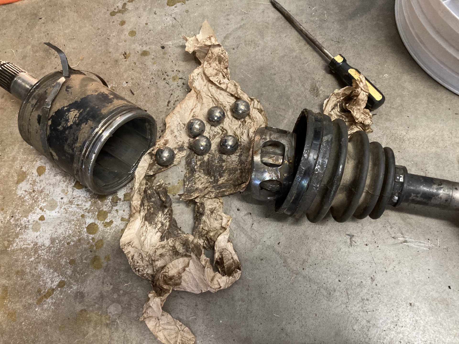

Wanted to replace diff seal but in the process dislocated my CVA.
It was original OEM. Didn't have much grease left inside.
Refurb OEM arrived after about 3 weeks.
After the destruction of passenger side, I decided to replace the driver side as well. That will get done tomorrow.

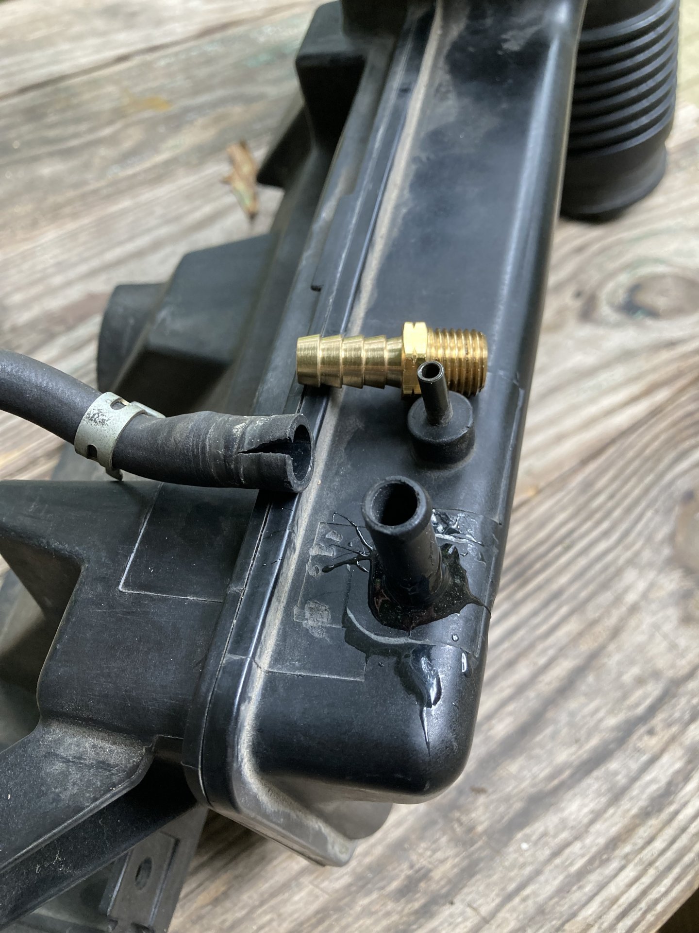

I just installed a new Sony head unit and backup camera. Then I accidentally broke a nipple of my intake while removing it. A new intake is over $400 so I'm going to try building up a layer of epoxy first and if that doesn't work use a brass fitting. Also, it's time to replaces just about all of my vacuum lines.
Hmmm i think i'd feel more comfortable if you shaved the nipple down and then bore a hole and thread the brass fitting through and epoxy that as well. Shouldn't take long, that fitting should be self tapping into plastic if you use the correct dril bit.

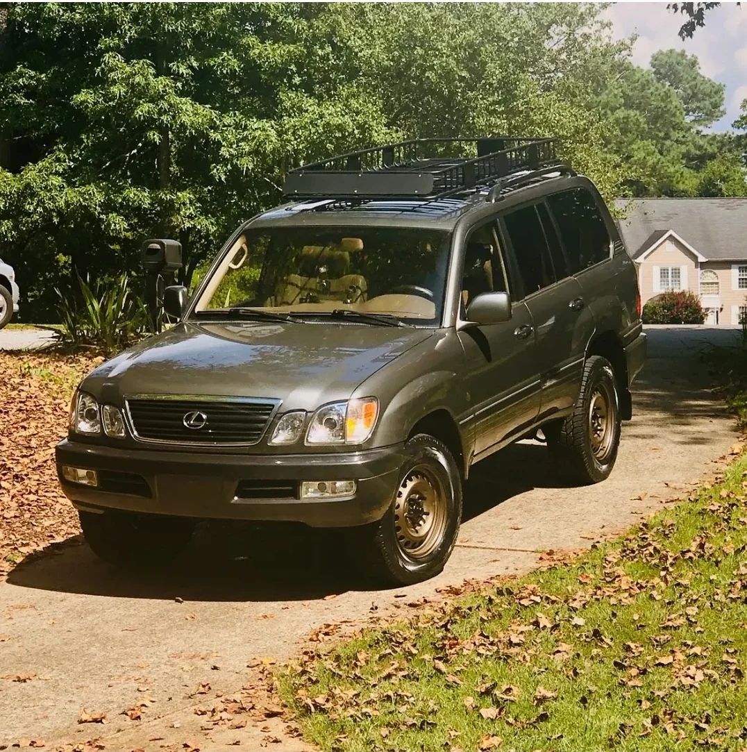

Can you share more about your wheel refinishing process and what color you used?
I just pressure washed them, hit them with a wire wheel, wiped with denatured alcohol, 3 coats of duplicolor self etching primer, sand with 400 grit, 4 coats of duplicolor Bronze wheel paint. I really took my time with each step, but not a pro job by any means.
