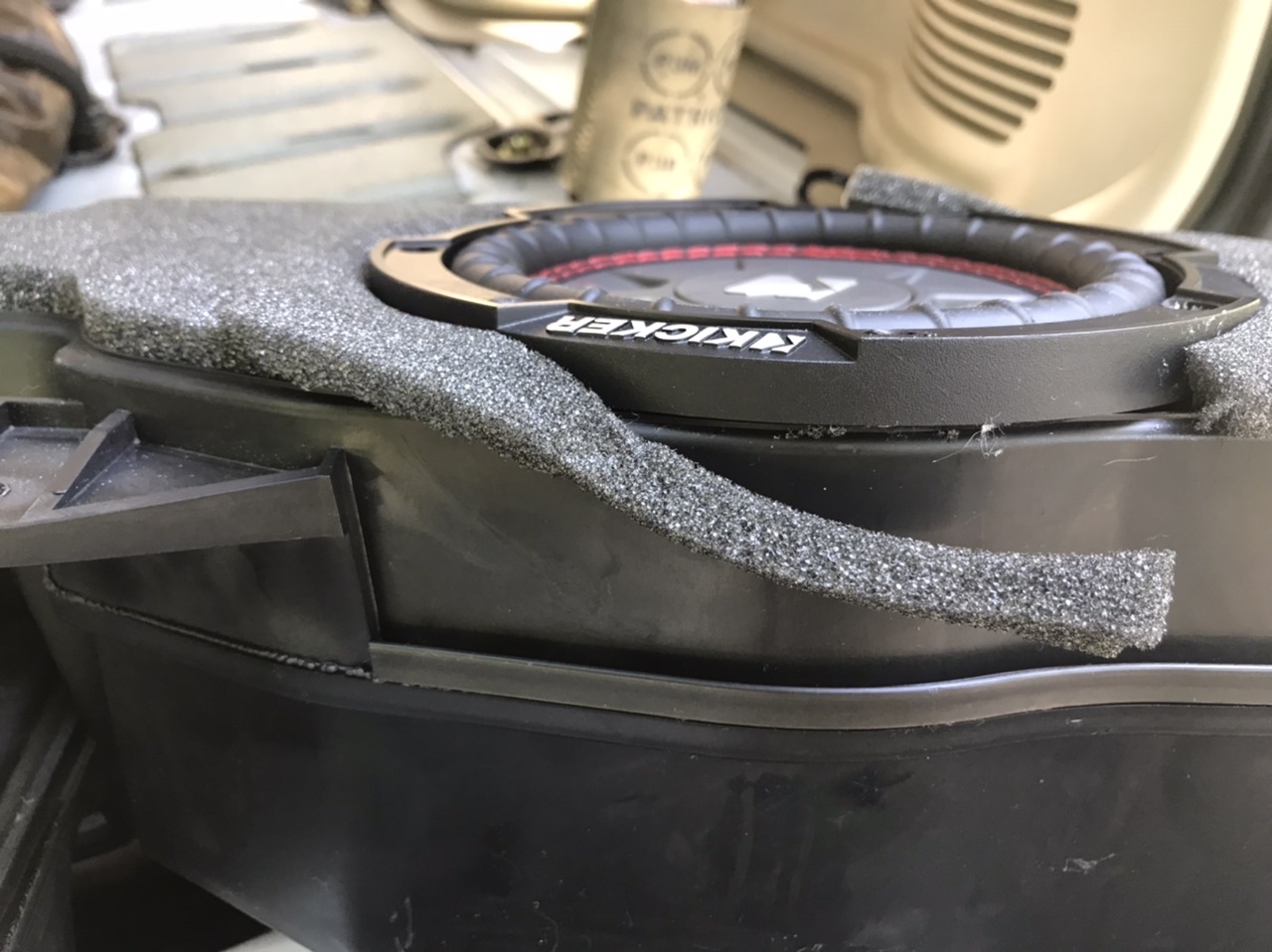

Bought a salvage-yard subwoofer assembly and refoamed the factory speaker from it. (I had replaced my speaker with aftermarket but it stuck too far out and kept the trim from seating right).
Before (dumb aftermarket speaker):

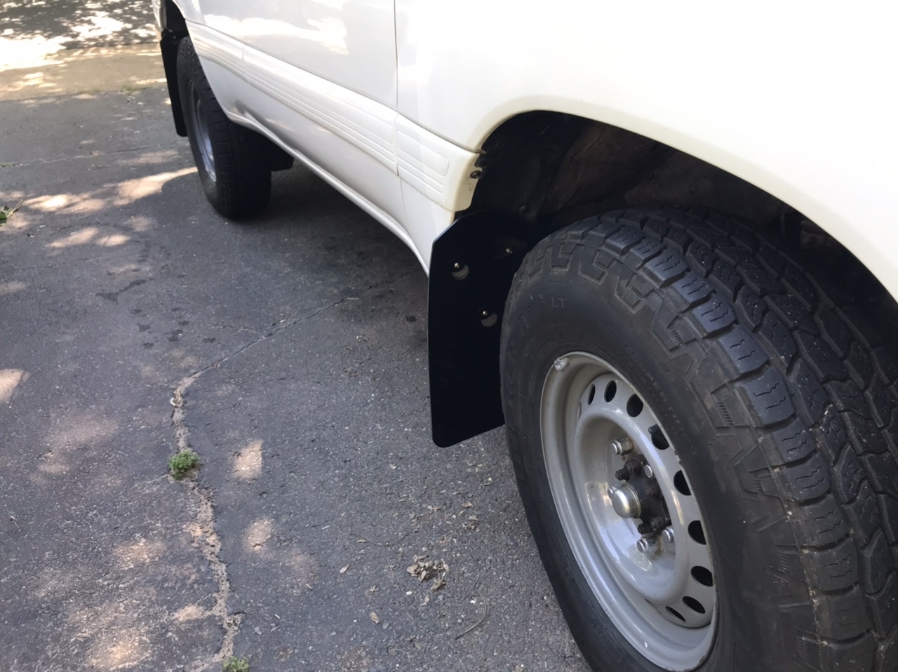

Then I installed the incredible mudflaps from @ramangain : edit: @Ramathorn15

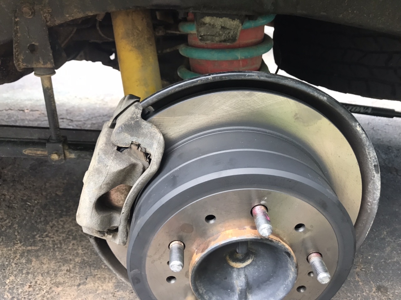

And then I was driving yesterday and heard an ominous grinding sound when braking at low speeds….yeah, metal on metal on one rear pad. I could’ve sworn I had checked those….arrrgh. We’ll, I put new genuine pads and rotors on today—putting down the rotor expense as tuition at the school of learning from your mistakes….
oops:
New:

Not my mudflaps, you must have meant @Ramathorn15

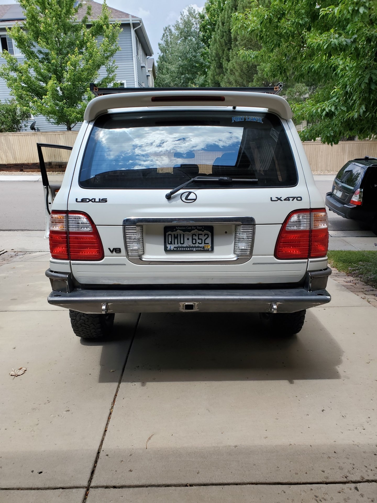

Rear brake day here too.
Thank you. I got the wedge bulbs did all the map lights and courtesy lights. Just need to do the domes and the taillights. Do you like the reverse light output?
So far so good. The pattern is much wider than the stock bulbs (duh). I was a little surprised at how much better rearward visibility is and I've actually found that pretty handy in the 3 nights I've had them in......also allows drunk speeding tourists to actually notice you backing out of your parking spot after dinner LOL.

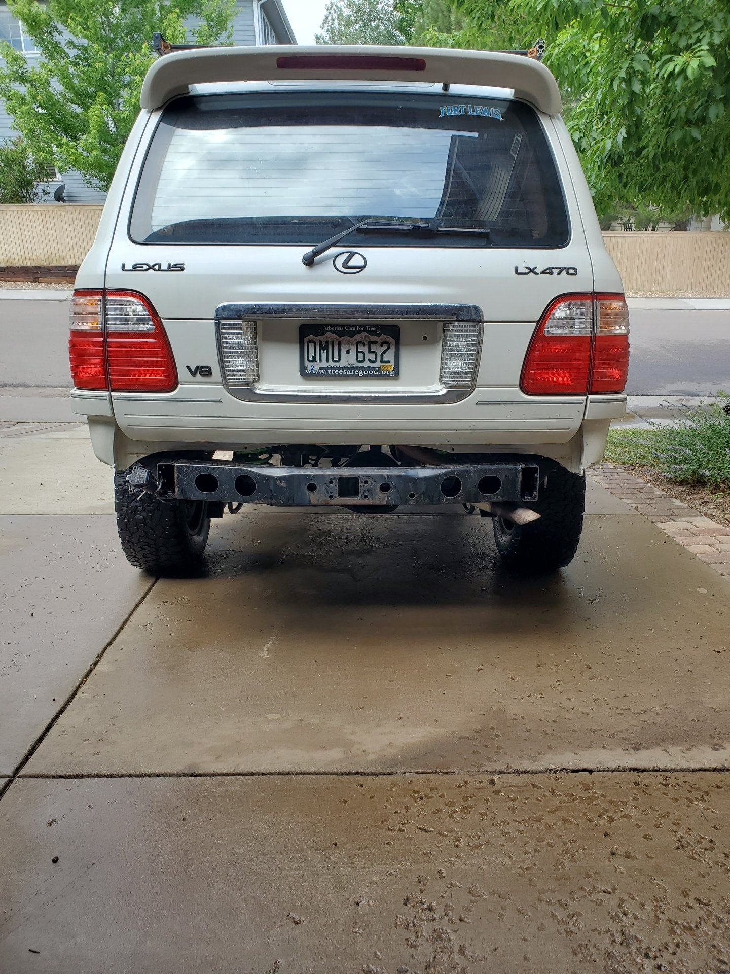

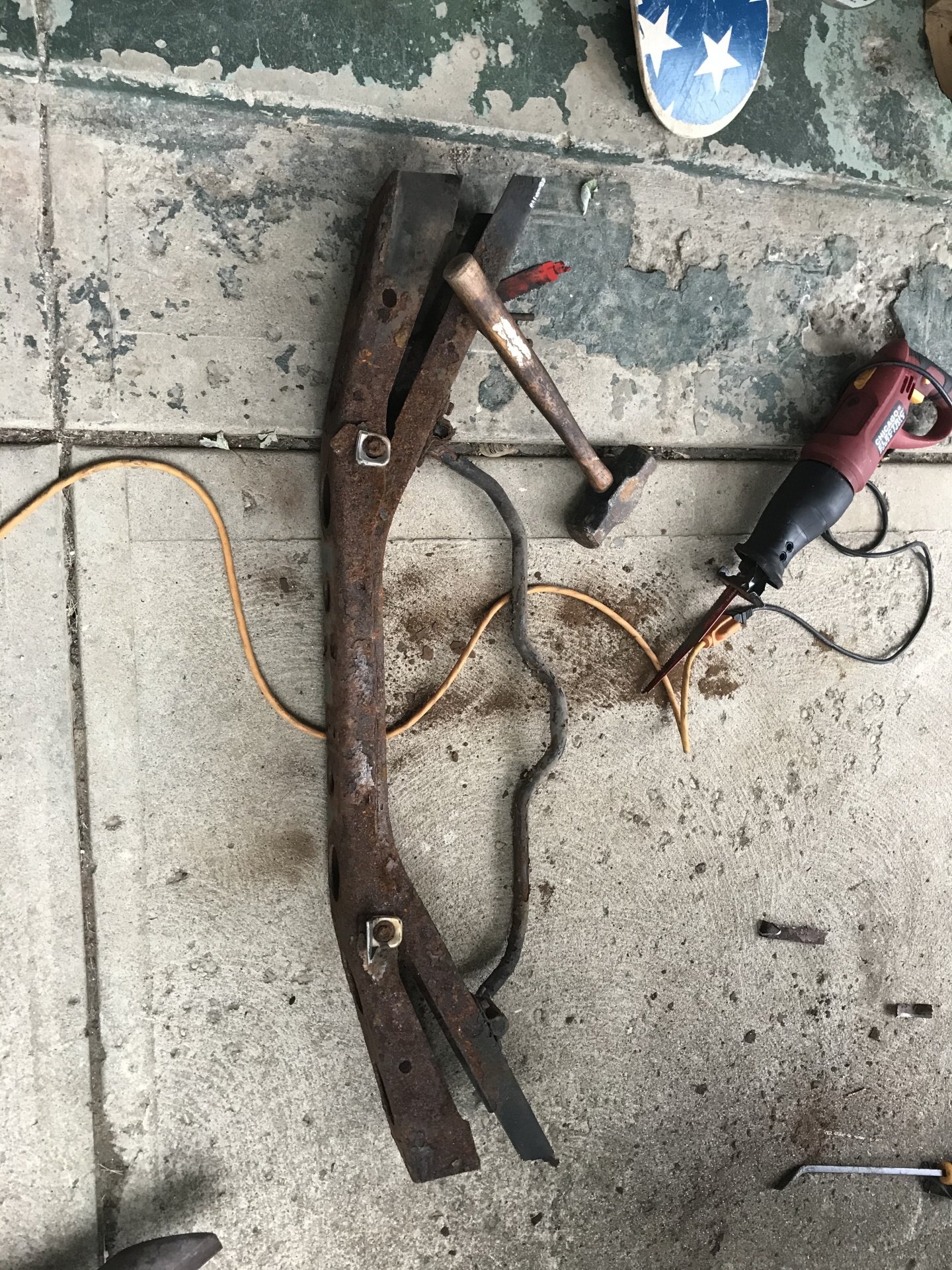

Nearly finished my 4X4Labs bumper build- 1 spindle left and building the arms of the carriers left, and then, in a pique of conscience, decided that the first day of a long holiday weekend should be spent cleaning the old girl up, pulling out the front seats, vacuuming the whole area, and “steam cleaning” the carpet. wiped down everything in sight as well. Next two weeks will be wrapping up other projects, then I think I may play with her for the rest of the summer.

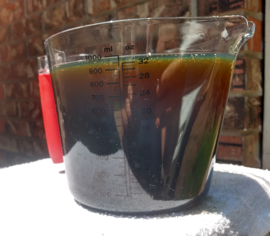

Changed both diffs and XFER case lubes today.
These Valvoline Flex Fill packets are just sweet. No muss. No fuss. No messy pumps. Even works well on the front diff hole.
Contains a limited slip additive and an anti-foam agent.
I've been doing a lot of off roading and water crossings so I wanted to change the diff lube after 6 months and 3,000 miles. Last change was M1 LS.
A tiny amount of sludge on the magnet.
Color was ok.
Seals from last year's diff maintenance are holding. A mud covering lets you see any leaks.

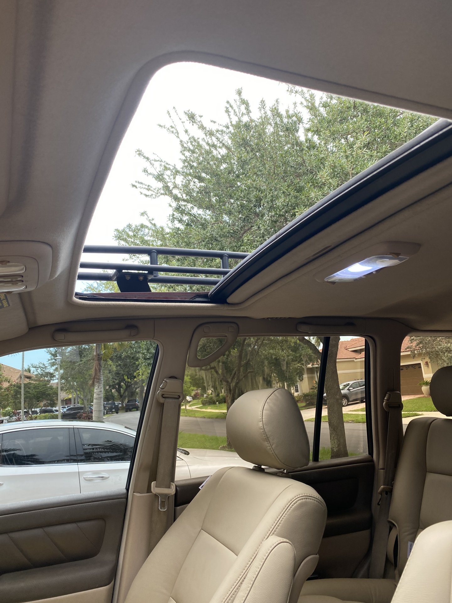

For the first time in 2 years, the moonroof opens and closes on its own accord. Turned out the motor just need a good cleaning and some grease. The cables were fine. It certainly makes the trails more enjoyable, but it’s going to take some time to rebuild my trust in its operation

Moonroof motor cleanup/ lube- how involved is the teardown/ replacement? Does the whole headliner come out and/ or what's the process? My truck's a similar age and I think a lot of the window/ moonroof tracks/ motors/ etc. could use a good clean. No alarming sounds or anything, but sometimes you can hear the motor maybe a little more than I think you should.
