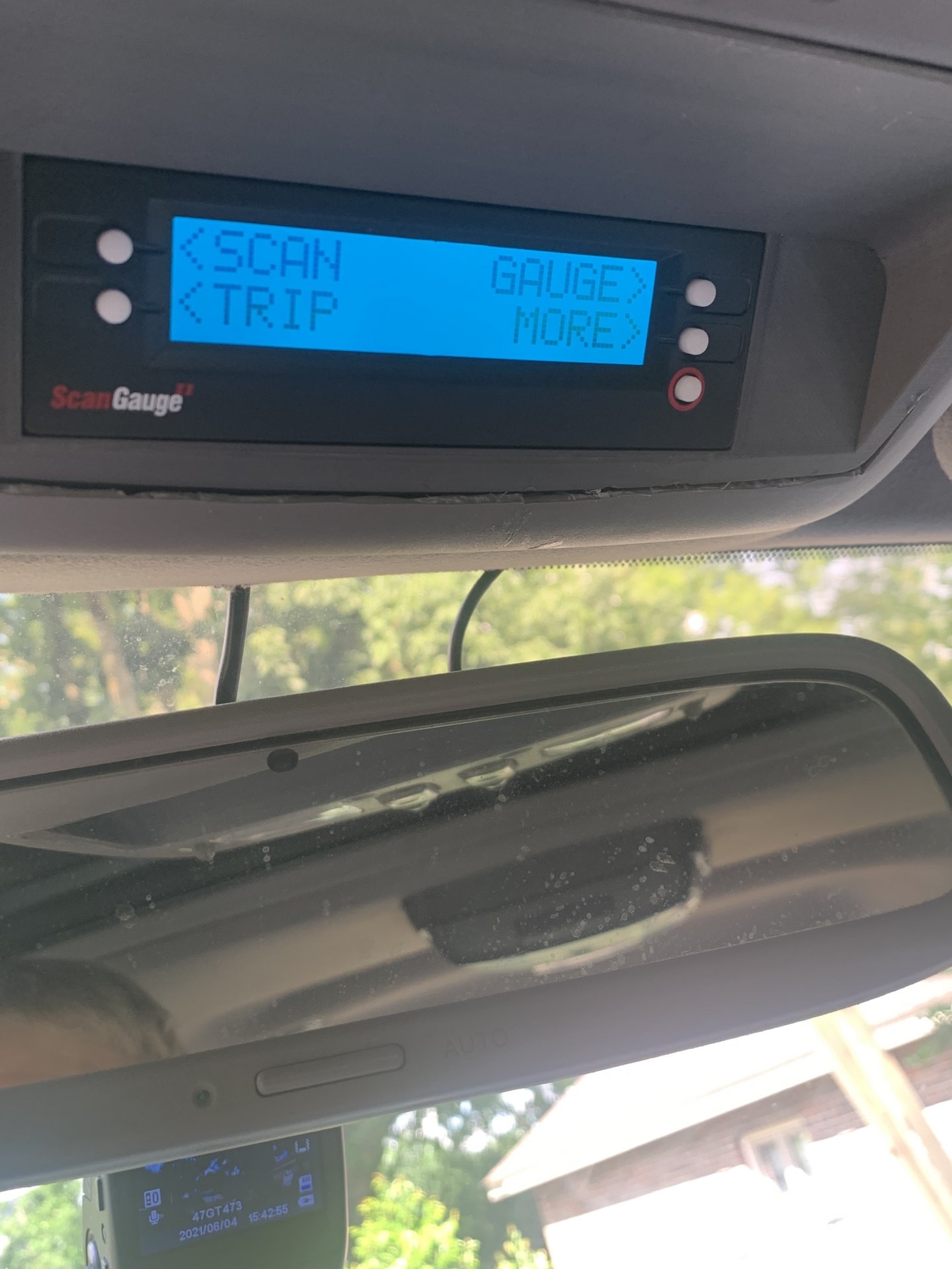

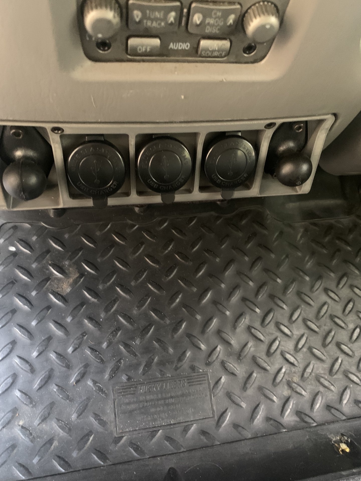

Installed 3 of @BenCC printed parts
MK 1v1 - sunglasses replacement/Scangauge II mount
MK 28v1 - New front row cupholders
MK 29 - 2nd row cupholder replacement
M1 is not fully seated. Push it a little harder.
Yep, I knew you would see that! I'll push harder. I had to buy some longer screws to try and pull it together more. Let me see what I can do this weekend!

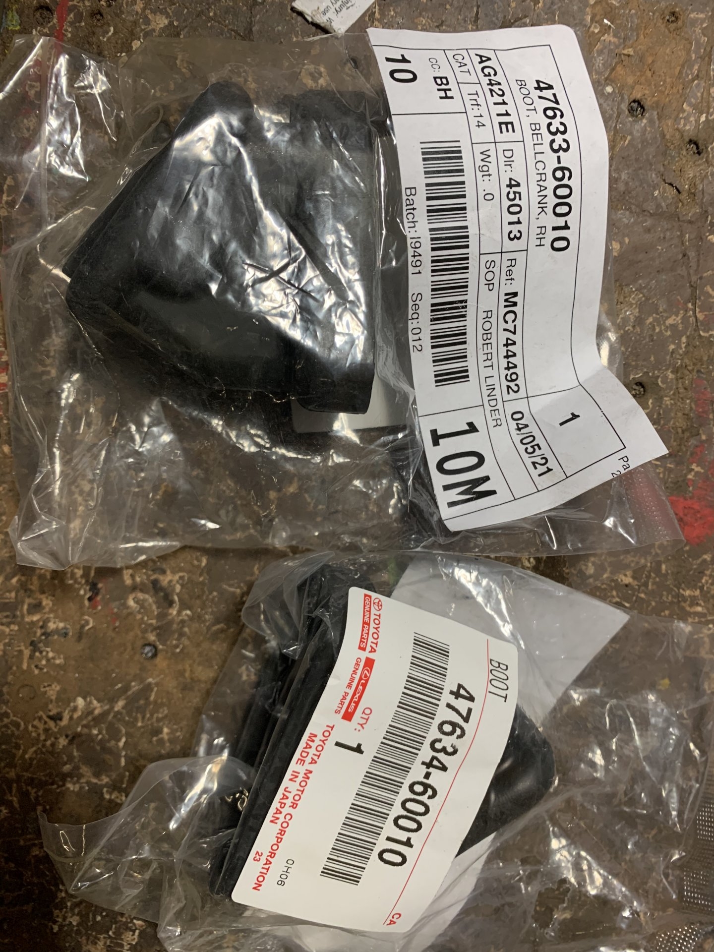

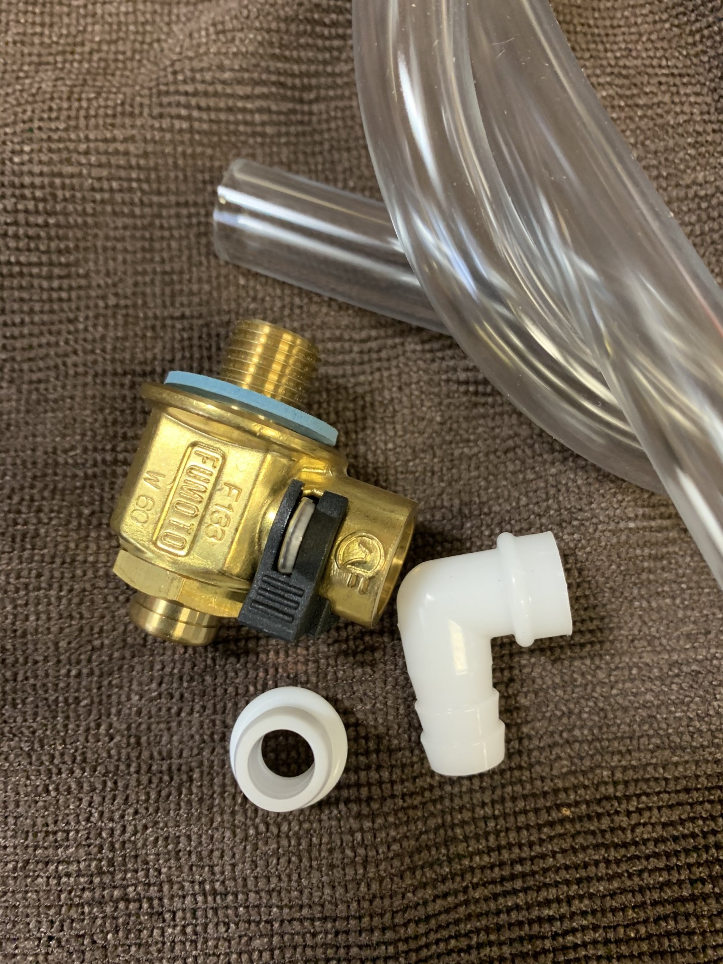

Replaced the parking brake shoes and innards (especially those cruddy bell cranks). Changed the oil and finally remembered to take that mid-stream sample for analysis. Fitted one of those oil quick release valve gizmos. We will see if it leaks. If it doesn’t it will make oil changes a lot more tidy.

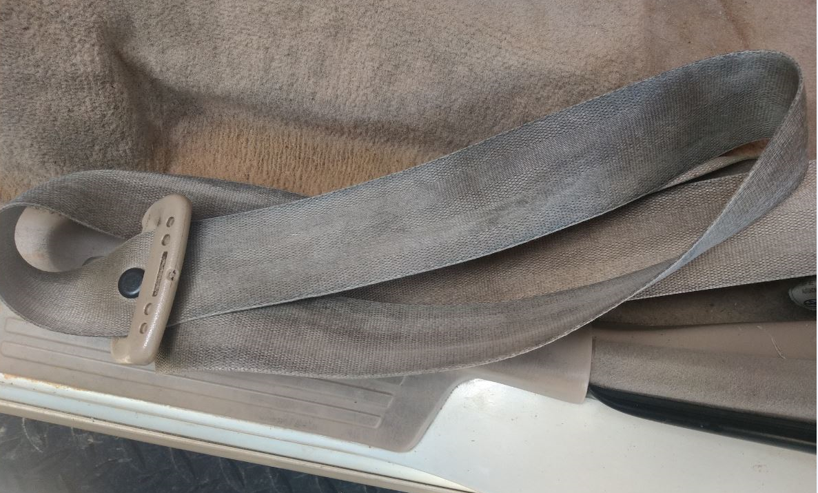

Brace yourself.
Before. Both driver and passenger sides looked like this.
After cleaning with the Tornado and a few raindrops for spots.
The Tornado tool is slow on carpet but works like magic on seat belts. I used some spring-loaded clamps to keep the seat belts from retracting until cleaned and dried.

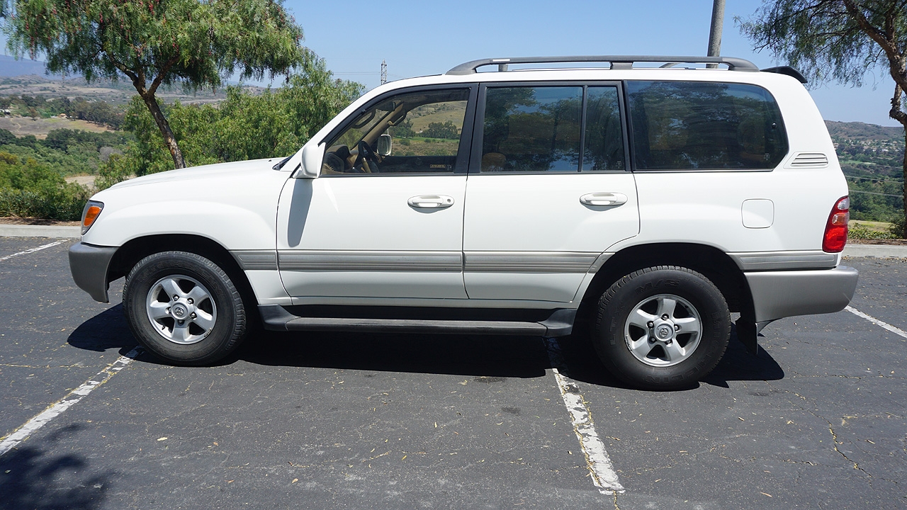

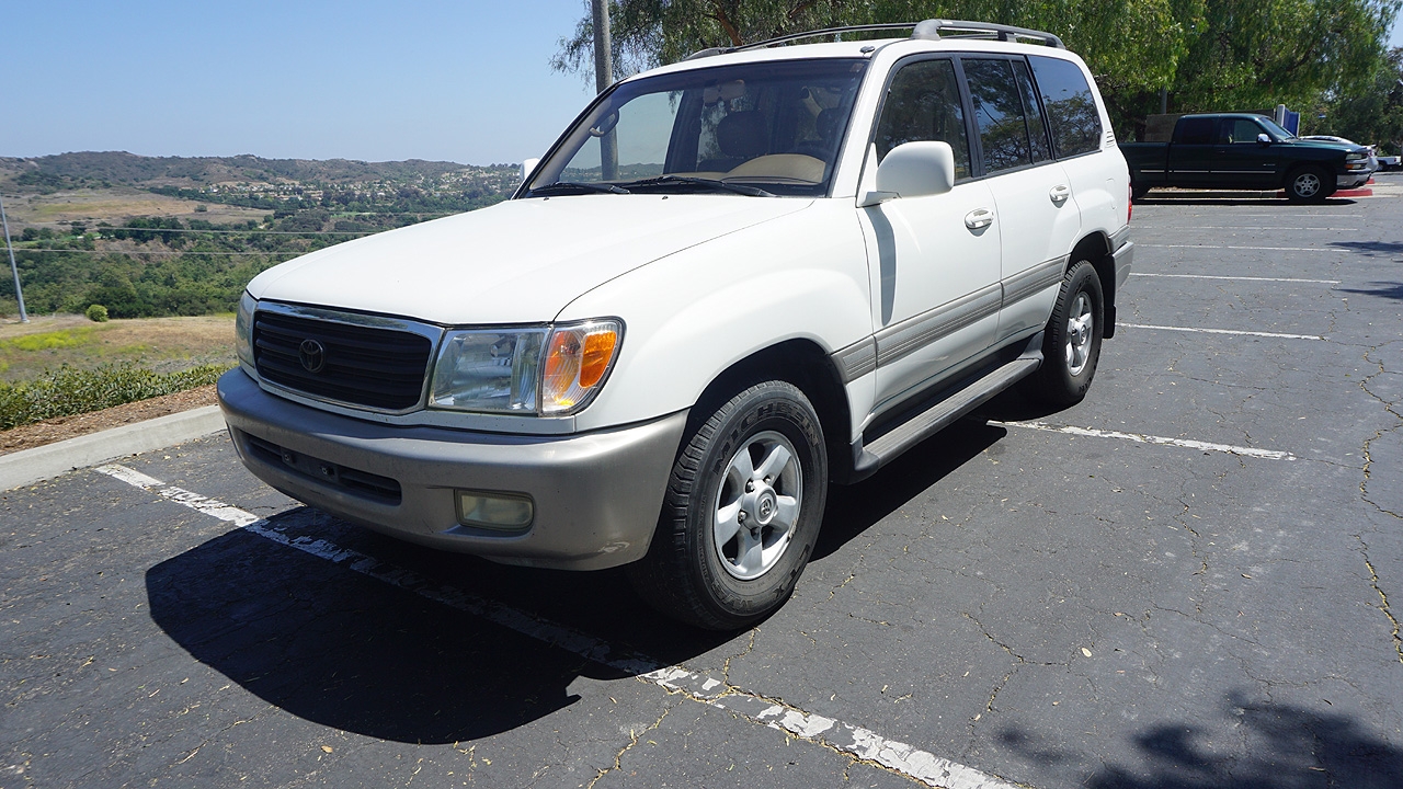

Before pics here:

Before pics here:

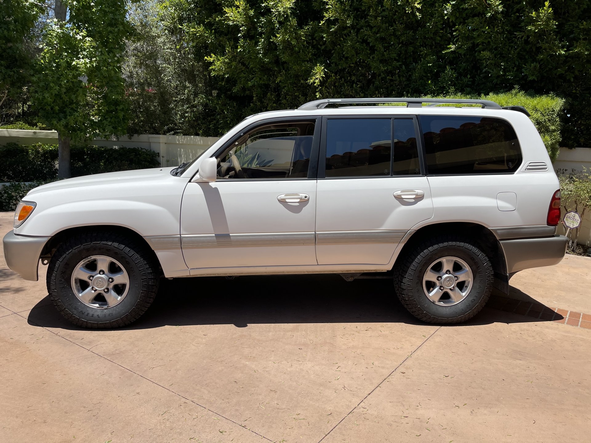

Went from 275/70 R16 to 285/75 R16 Firestone Destination X/Ts
After pics here:

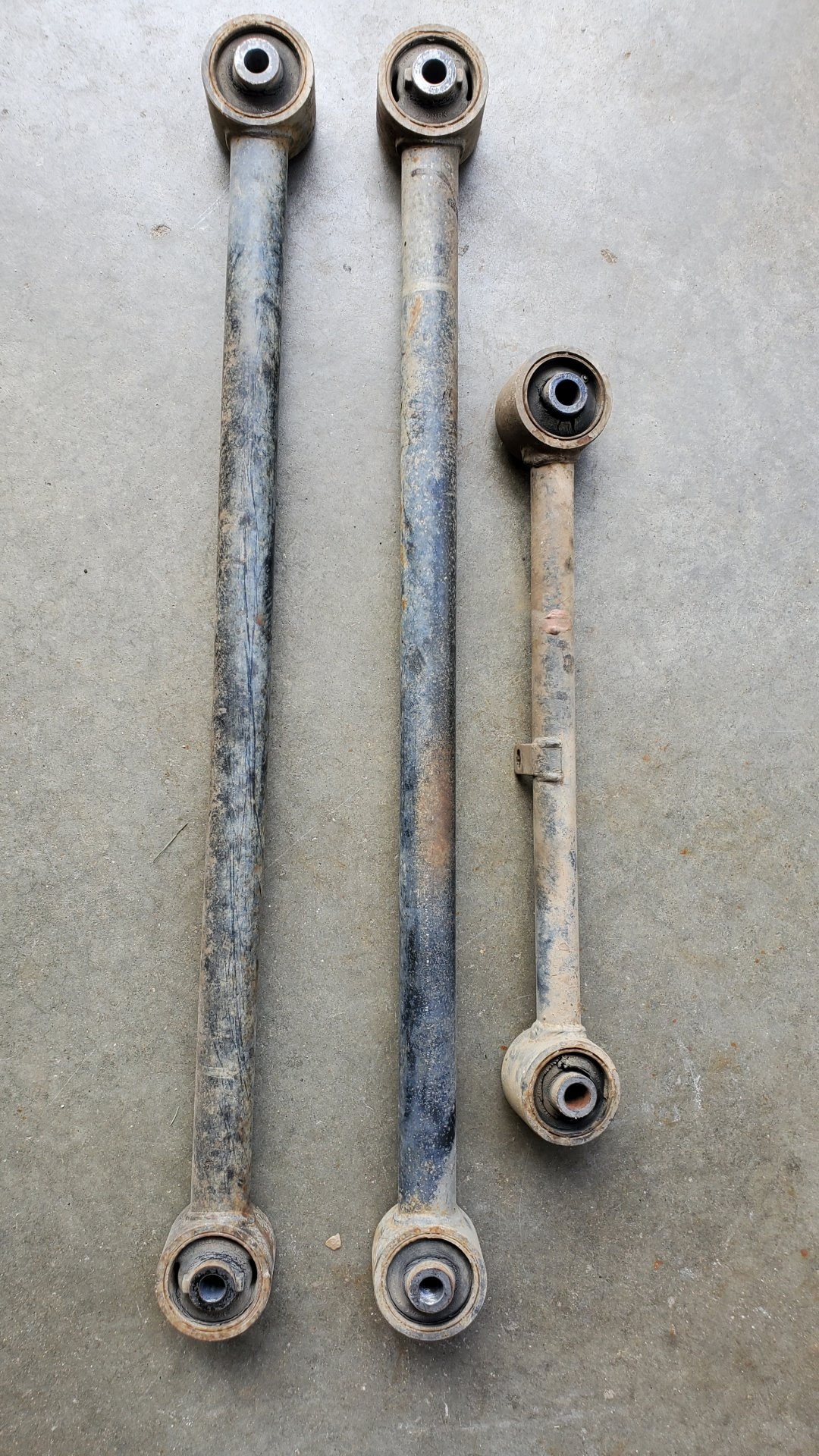

Old rear control arms bushings were pretty much shot! New OEM ones are shiny!

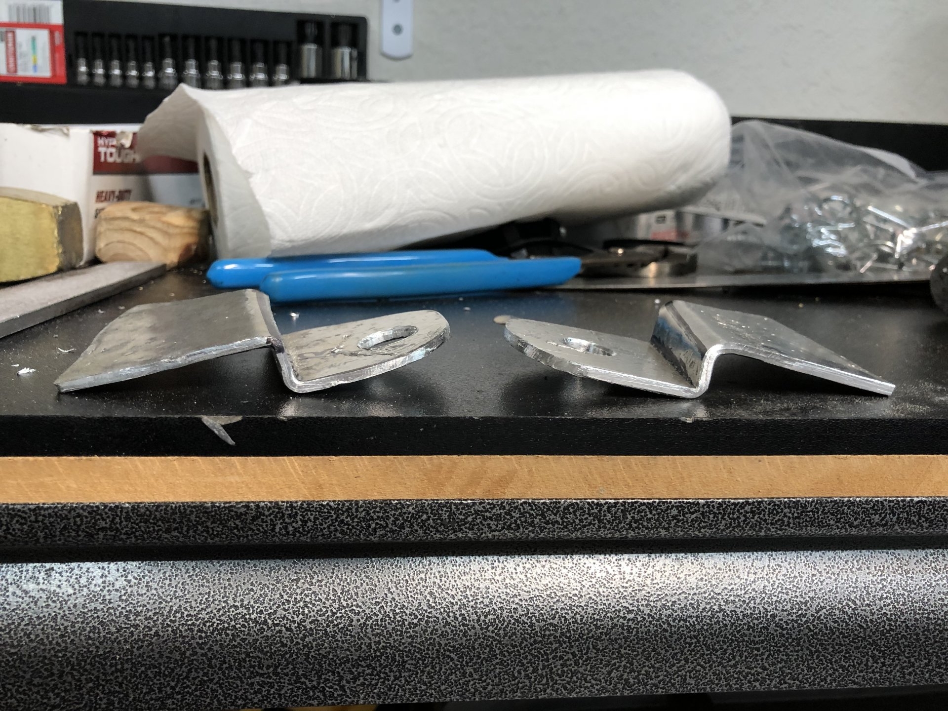

Like many, my mid-section plastic skid plate / belly pan tabs broke off, it was dangling and had it off for a while. I have TJM steel version on my other LC but for my DD, didn’t want all the weight and added cost.
So, I took some leftover aluminum plates I had around the garage and created a support bracket. Just traced the original tab and left extra metal hanging so it can support the rest of the skid plate. Had to also bend couple times to get the correct steps like the original plastic tabs.
Bought 2 sets of bolt, washer and nut from HD to attach the new brackets to the plastic skid plate. Painted it black. Cost about $4 in all.
Not perfect but it’s functional and does the job so far. Basically, the plastic skid plate is sitting and resting on the aluminum bracket/plate. Not taking this LC off-road so it’s all good. Took about 1 hour total to cut, bend, drill some holes and install.
