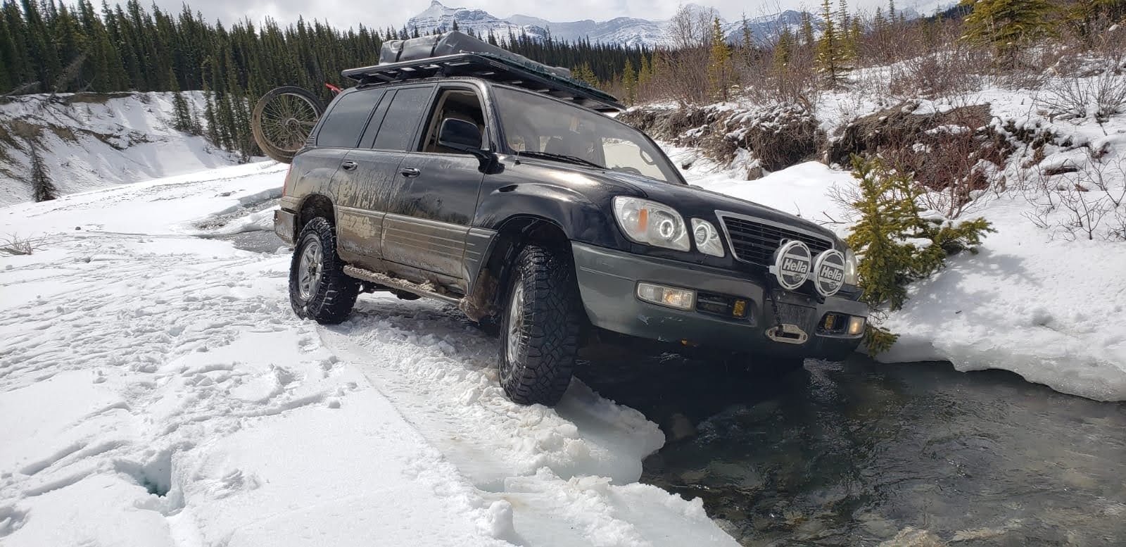

got stuck in a dinky stream for an hour and gained some panel damage. Yes it looks like you can drive right out, the ice on the edges breaks and makes a nice little wall taller than 2/3 of my tire.
Whoops! Great view in the background there. I could think of worse scenery to be stuck in!
How did you end up getting out? Looks like you had a winch so I am guess not good anchors nearby.
You sir are right. The only anchor point was a friends 4runner and I would just drag it on the snow. Eventually after trying to just drive out in multiple spots we figured out a position where he had a couple tires on some rocks, traction boards under others, traction boards under my poorly footed wheels and crawled out. Now I've got a 100' winch extension line and 2 more traction boards coming.
And a pull-pal?
