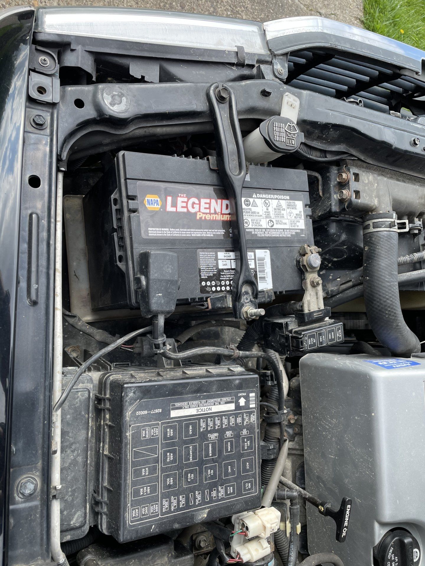

Replaced a dying AC Delco battery with a Napa Legend Premium 34R. It's smaller, but has better specs than the 27F's I could find locally. Fitment was no problem, but I did have to cut a piece of 1/2" plywood to use as a spacer until a proper spacer arrives next week.

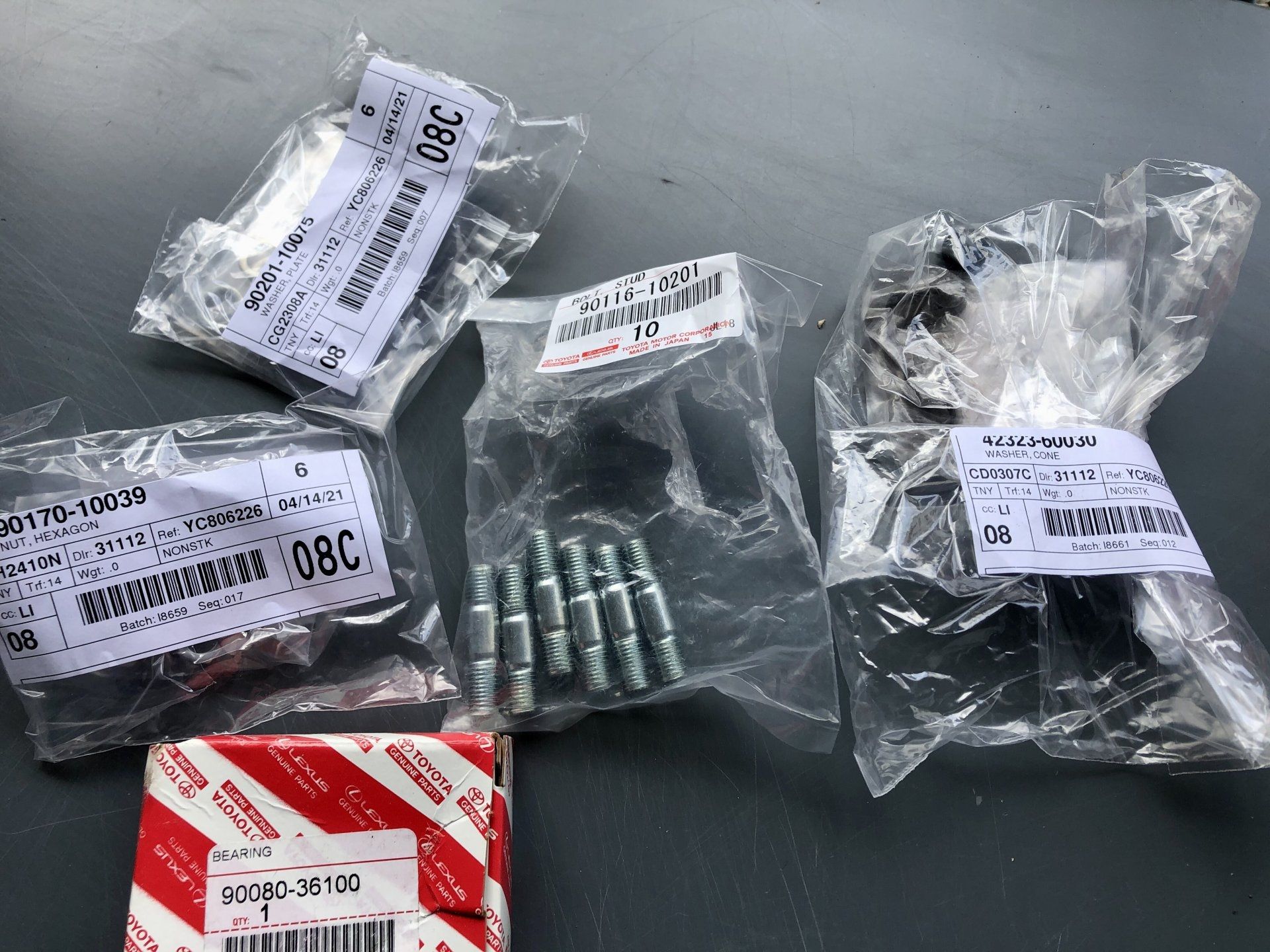

I spent a bunch of money with @Onur . The 1999 100 Series has been eating aftermarket CV axels since an insurance claim used Autozone parts while I was away from home for 4 months.
Coming up on 290K miles, with no intention of selling, it was time to make the front-end right with Toyota.
I hit up @Onur, and just as he has done for most of the last 20 years, he took extra time on the phone, talking me through the solution.
I use a shop that isn’t familiar with Land Cruisers, but are honest guys and fairly priced. From the Northeast, @Onur fills the gap of needed experience to my Toyota problems.

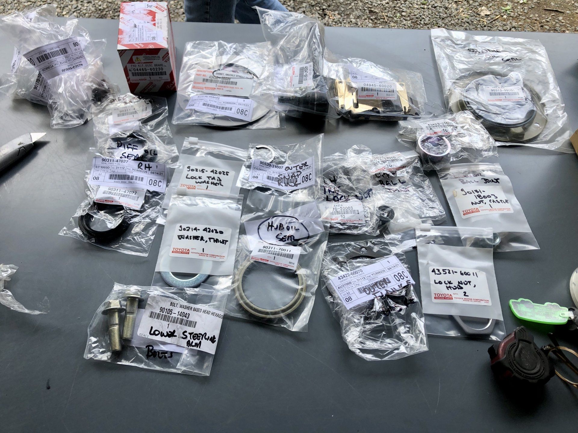

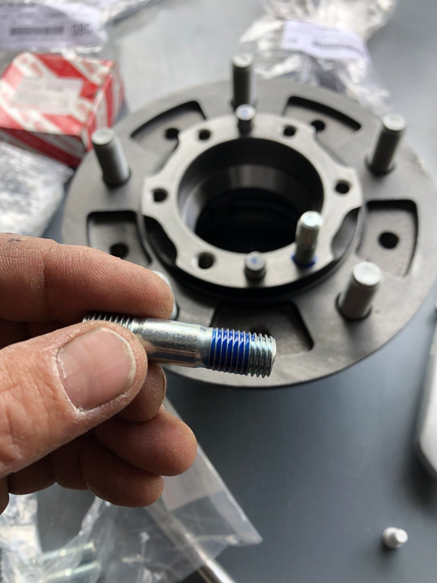

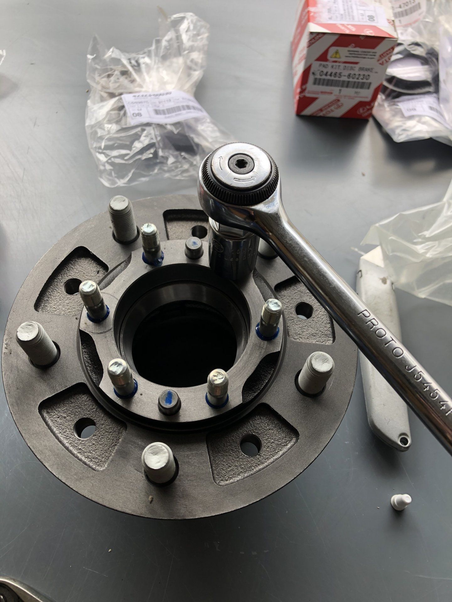

We settled on replacing everything a mechanic will touch (less caliper) while replacing the CV on the D/S, and just the CV on the P/S as it has had no issues.
@Onur even assembled the hub and labeled each Toyota part for the shop...
@Onur , the Land Cruiser SME formerly known as Beno, came through as always.
For me, especially, it’s his deep knowledge of Toyota 4x4s and sound reasoning/advice that I value most.
