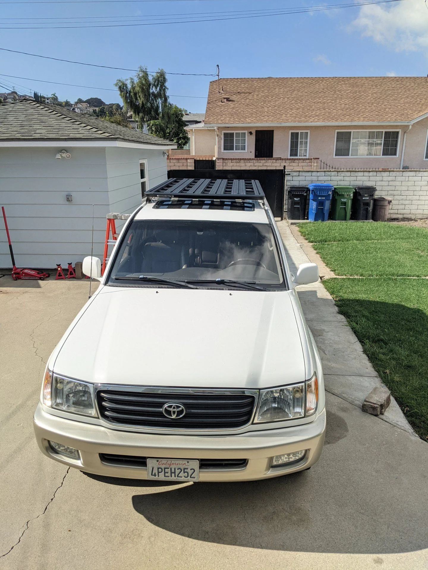

Installed the Rhino Rack Backbone and Pioneer platform roof rack.
Installed the Rhino Rack Backbone and Pioneer platform roof rack.View attachment 2564479
got me one of these to go on. waiting for the mountings and feet. just ordered 1220mm C channel cross bars for my rod holders/ski carriers.
That the 2128MM X 1236MM or the size up?
It is the 76x49 in or 1930x1244mm.
Looks great. You notice much wind noise?
Haven't had it on the road since installation. It is not my daily driver, just a weekend and camping vehicle. Will be adding more items as they come in. Waiting on bumpers, sliders, tires and suspension lift.

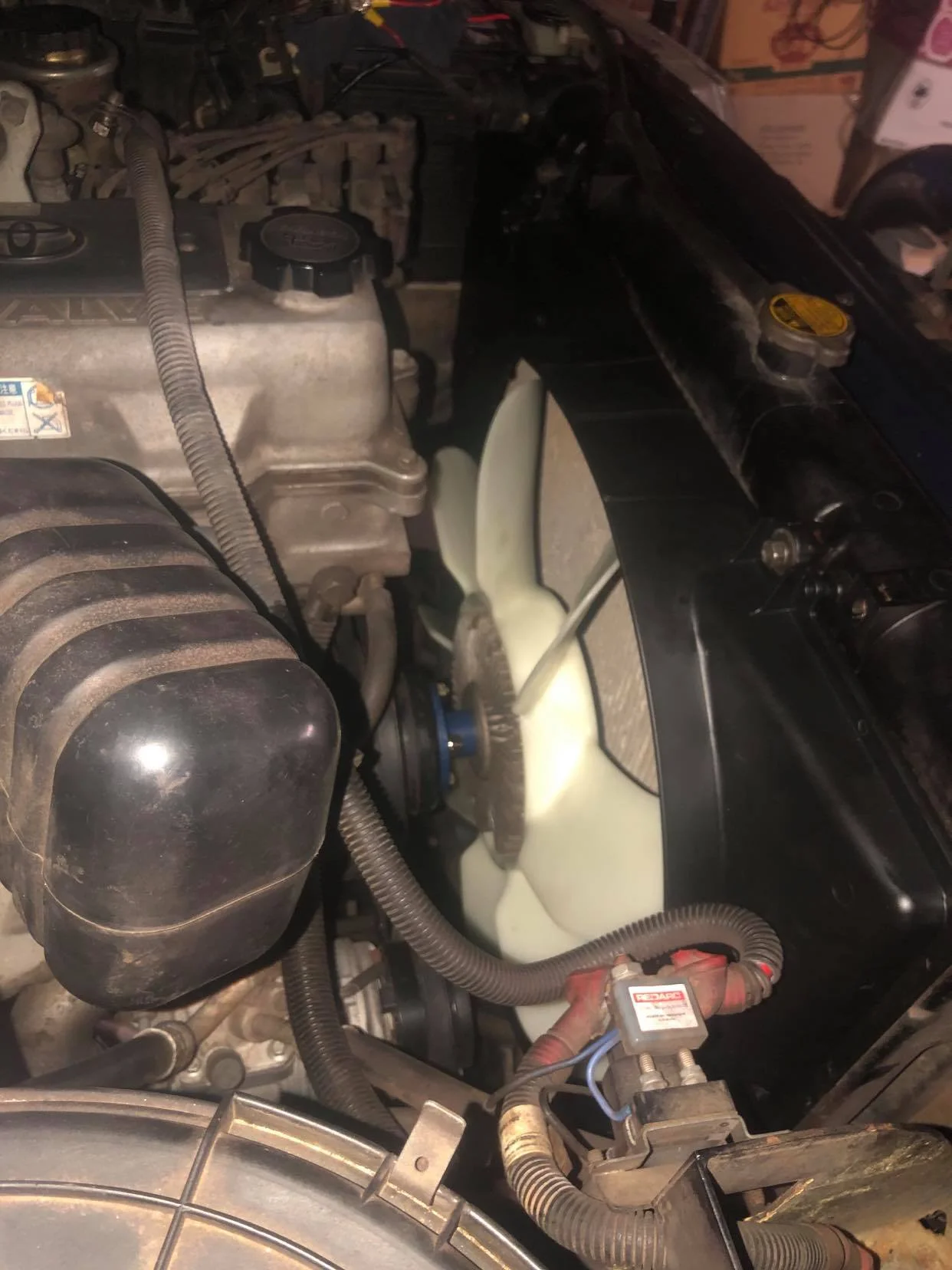

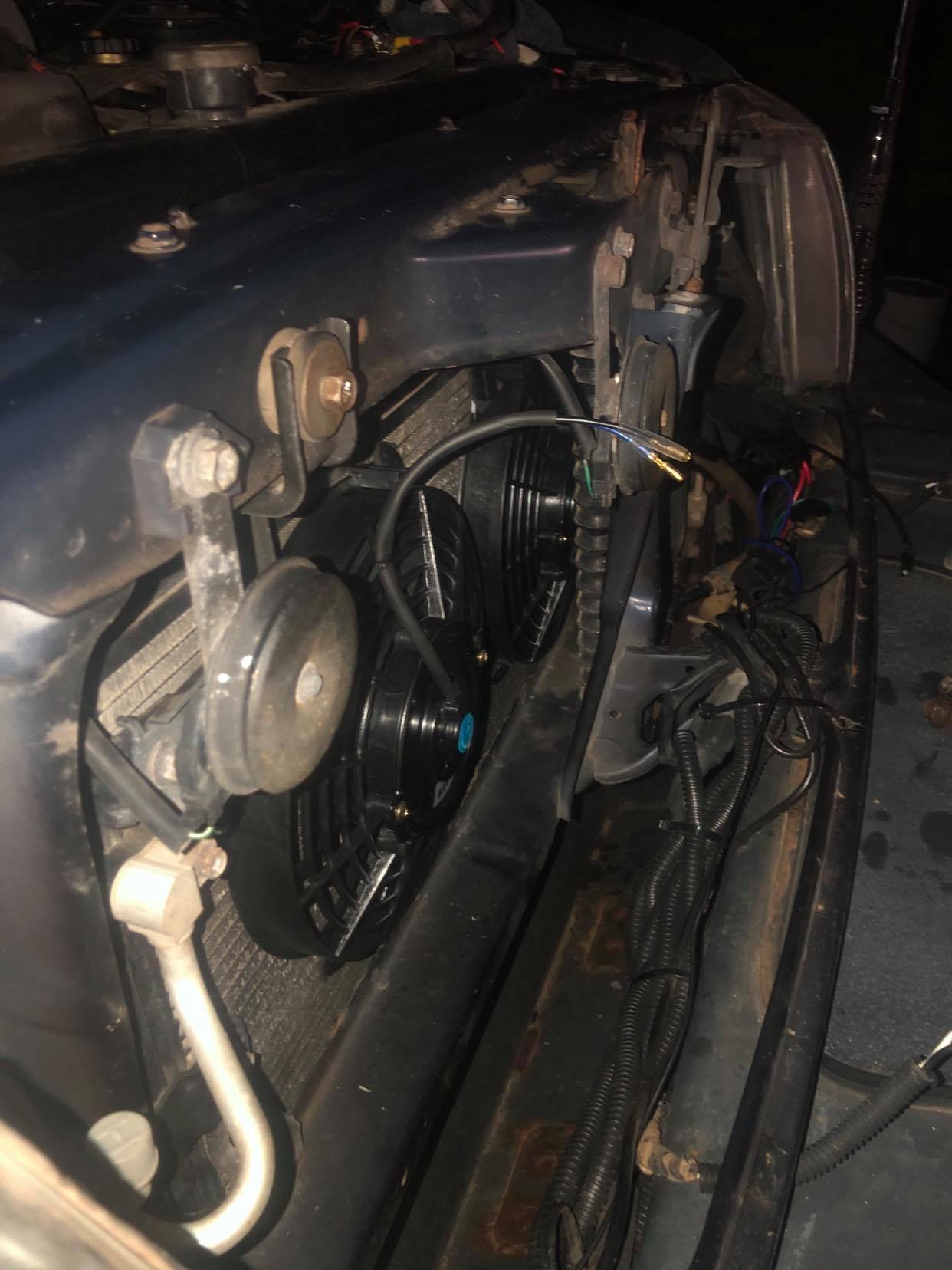

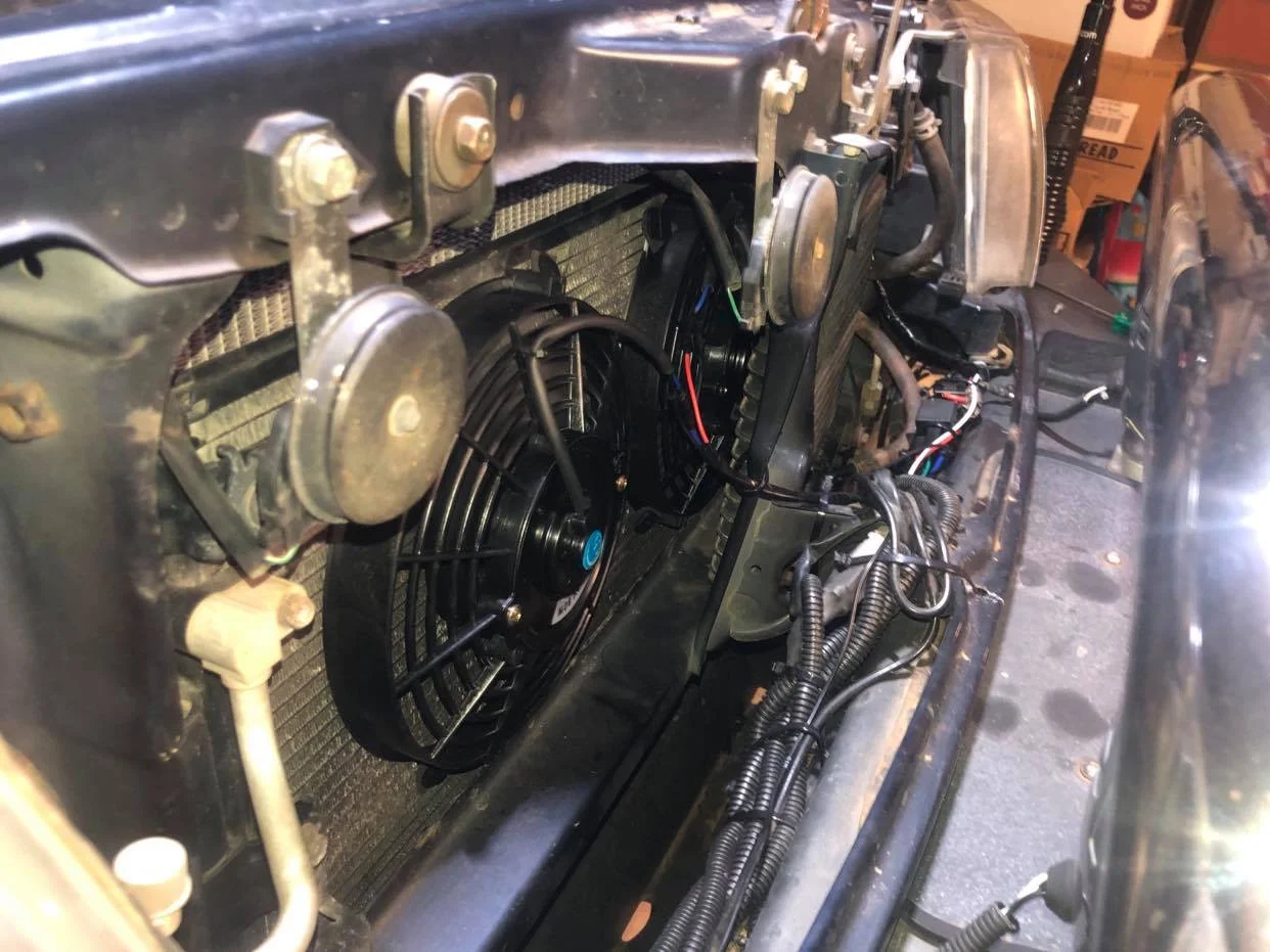

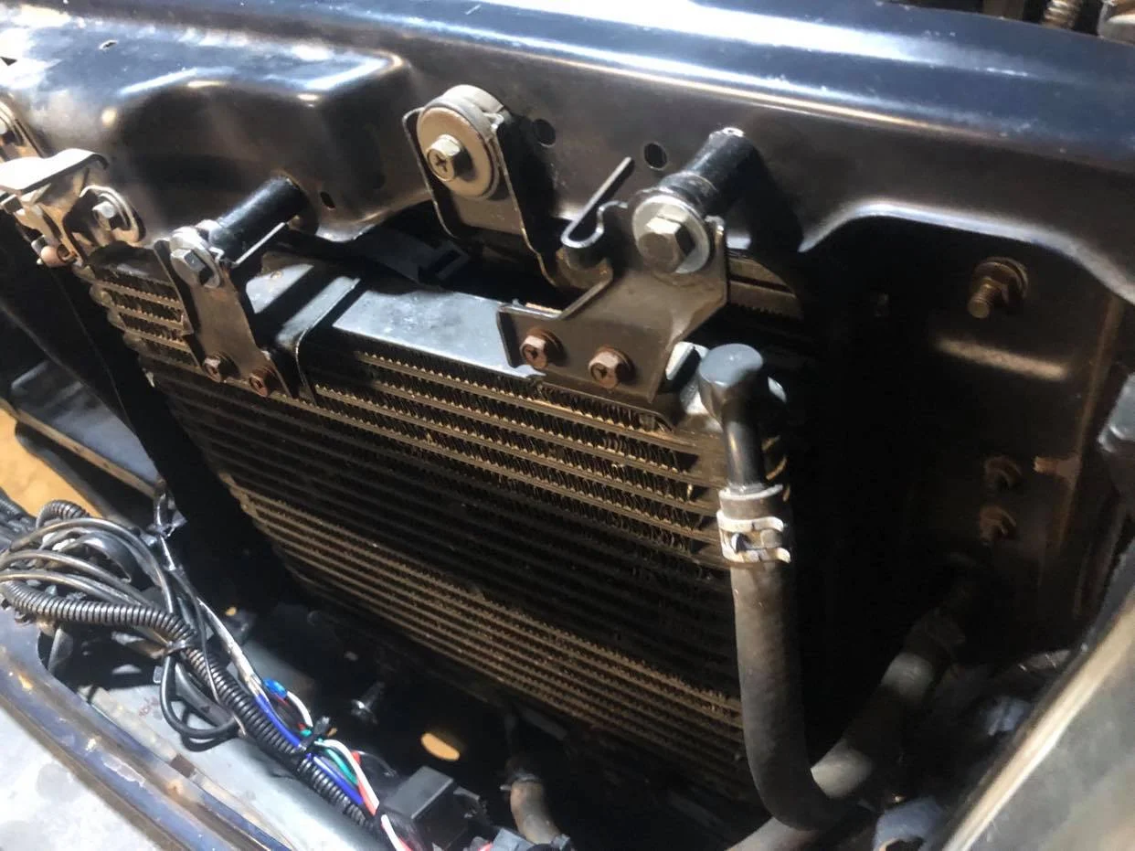

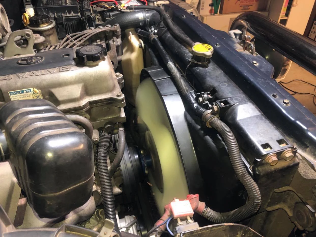

Got the TORA engine Fan & 2 x 9" Thermo fans in today. So started the job of pulling the old shroad and fan off.
Did the Thermo's with it all off, taking some bolts off to push the radiator foward to mount them both.
Got new nuts for the main fan cos I did round a couple - lol virtually impoassible not to do.
It's all on now. Gave up cos night time, just gotta tighten the engine fan nuts and wire the thermo's both up to everything.
The fan shroud was in a much worse state than I originally thought. Missing the entire bottom sections. Fan practically in same state, horrible.
Oh, and forgot, got the extended bolts for pushing the A/T cooler foward. Job for tommorrow too.
So you’ve got a new clutch-driven fan and new shroud, AND two electric pusher fans??
I assume one of those is mainly for addressing your A/C performance woes, but, with two, couldn’t you have done away with the crank-driven fan and shroud altogether?

Finished finally, half a day job to finish it off.
Much, much better. The A/C compressor actually started cycling correcting @ idle. Due more I think to that new fan/shroud.
Had to custom make my own relay, cos the spare one I had wasn't for a thermo fan. Took the longest.
I've only just repaird the cluthc-driven fan and shroud, the A/C cycling is a new thing to me. Found it weird seemed to be idling down correctly and back up. Can't remember it doing that before ? Bah the condenser fans will be for stand-still cooling (stop lights, parked up) its a sauna in there on 40 celcius days.
Although it seemed to work pretty well driving to the shop without the thermo's not connected and the new fan/shroud. It still was pretty poor. Will give a review once I get back from Quobba station, post some pics of that later. 600km, headland of WA home of pelagics galore. Should be fun.
