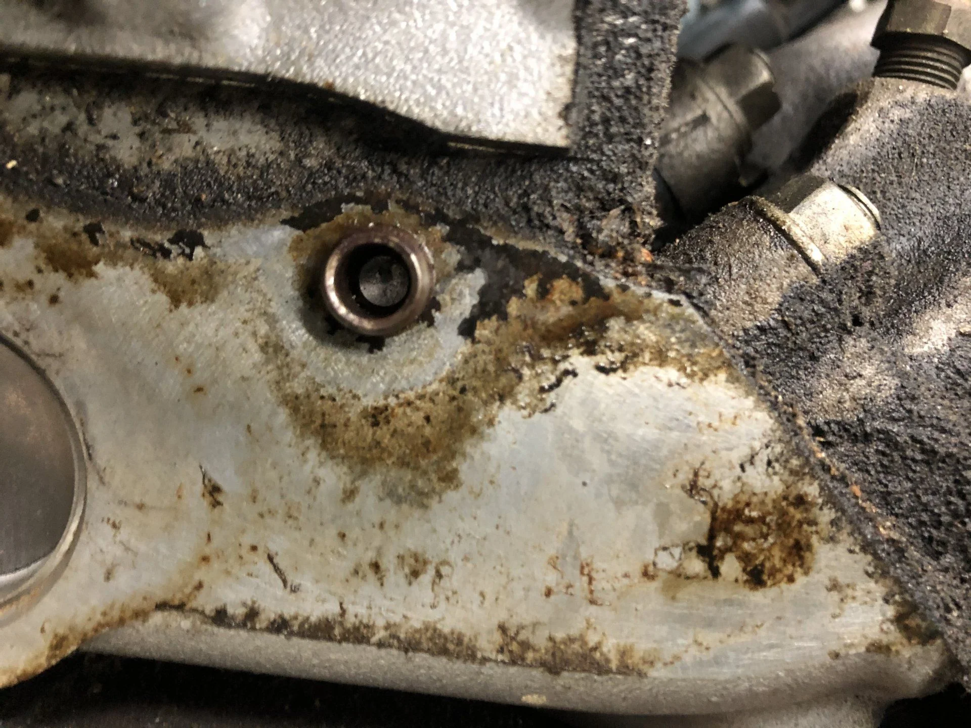

I posted yesterday about what I thought was a rear main leak. It seemed to be dripping faster than oil so I put a pan underneath and checked it again this morning. It's coolant. How am I leaking coolant right here? What am I missing and/or not checking? Where am I not looking? I can't see anything wet other than right where the engine and trans meet. Why would I have a coolant leak right there?
Is it coming from the top of the motor on the rear where the coolant pipe attaches by any chance, and running down to there?

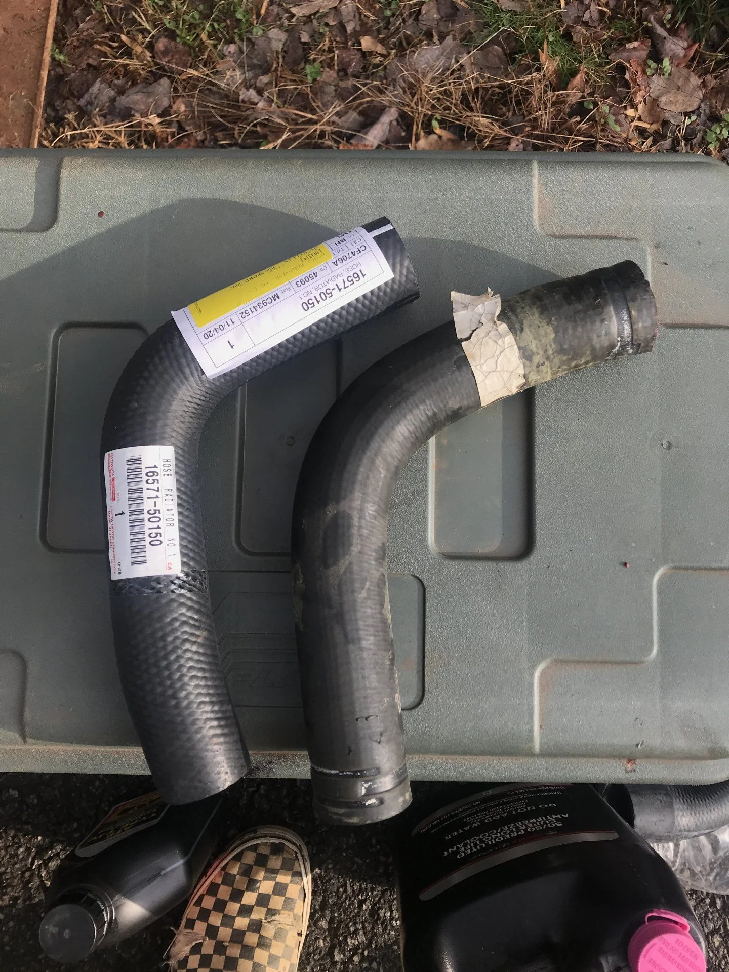

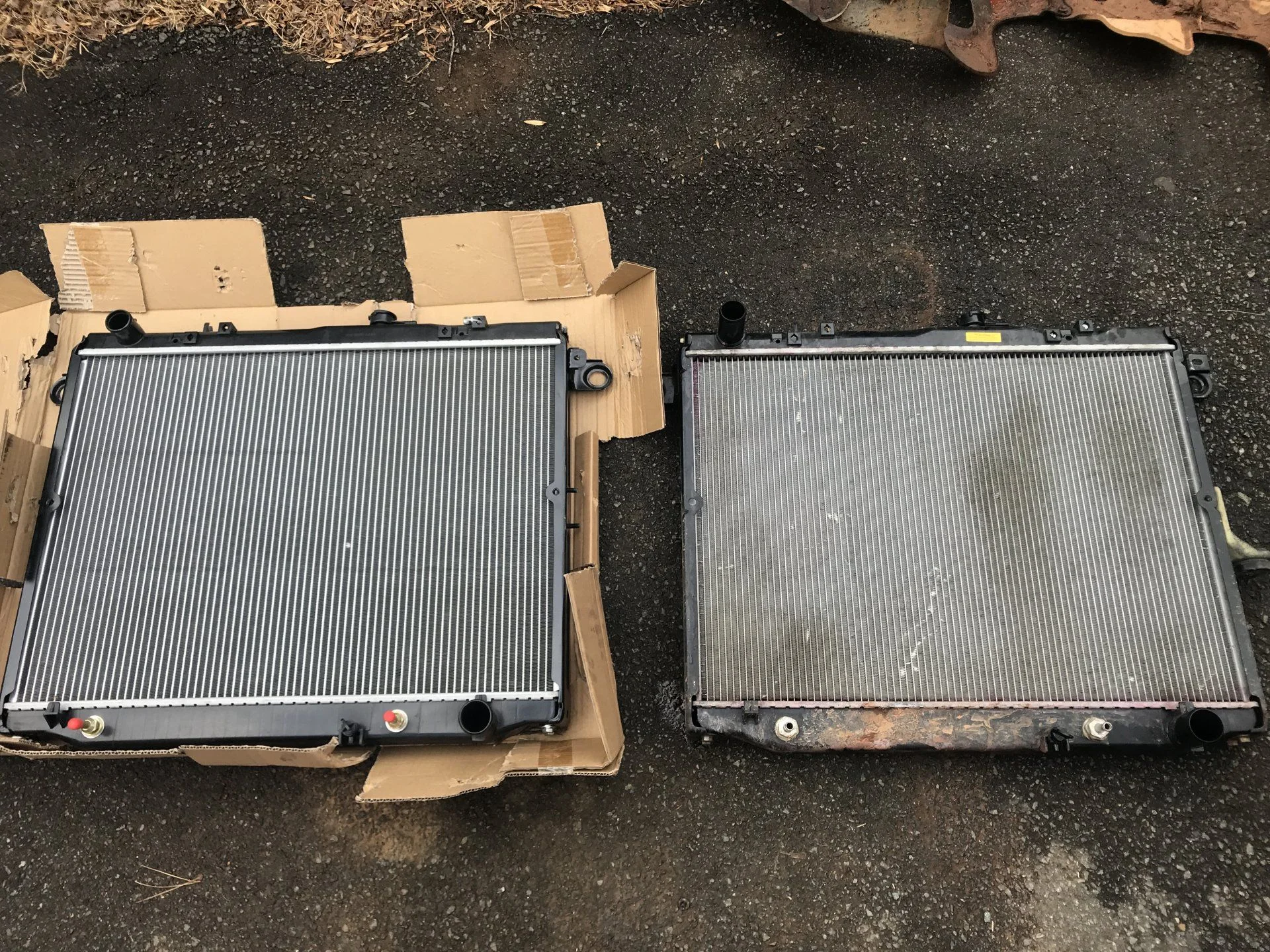

Replaced the leaky old china radiator with what turned out to be a leaky new China radiator! :grinpimp:
Ordered a Mishimoto replacement radiator a few weeks back and just found the time to install it this morning. After starting it up I noticed a small but constant drip and realized this tiny fracture slipped by my inspection. :redface:
Reached out to mishimoto and hopefully they will resolve this quickly and painlessly as one of the main reasons I purchased from them was their warranty system they seem to be fairly proud of. Unfortunately their customer service call center is closed on the weekends, so I hope the email I sent reaches them before Monday.
Anybody have a quick fix I can cover this crack with until a new one comes? Old radiator was busted as well, so not much good putting it back in:cheers:
Trail repair would be JB Weld- Water Weld. And while it dries, 10 Hail Mary's for good measure.
(Before applying, sand and rough up the surface... then clean.)
