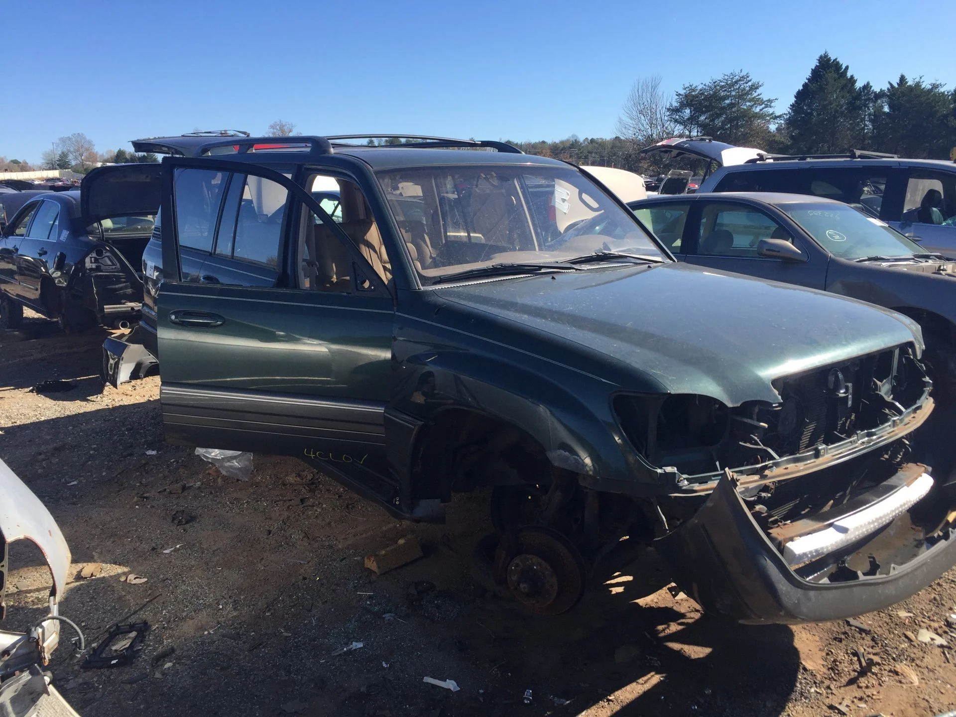

Went out to the local junk yard to see what was left of this 99 LX.

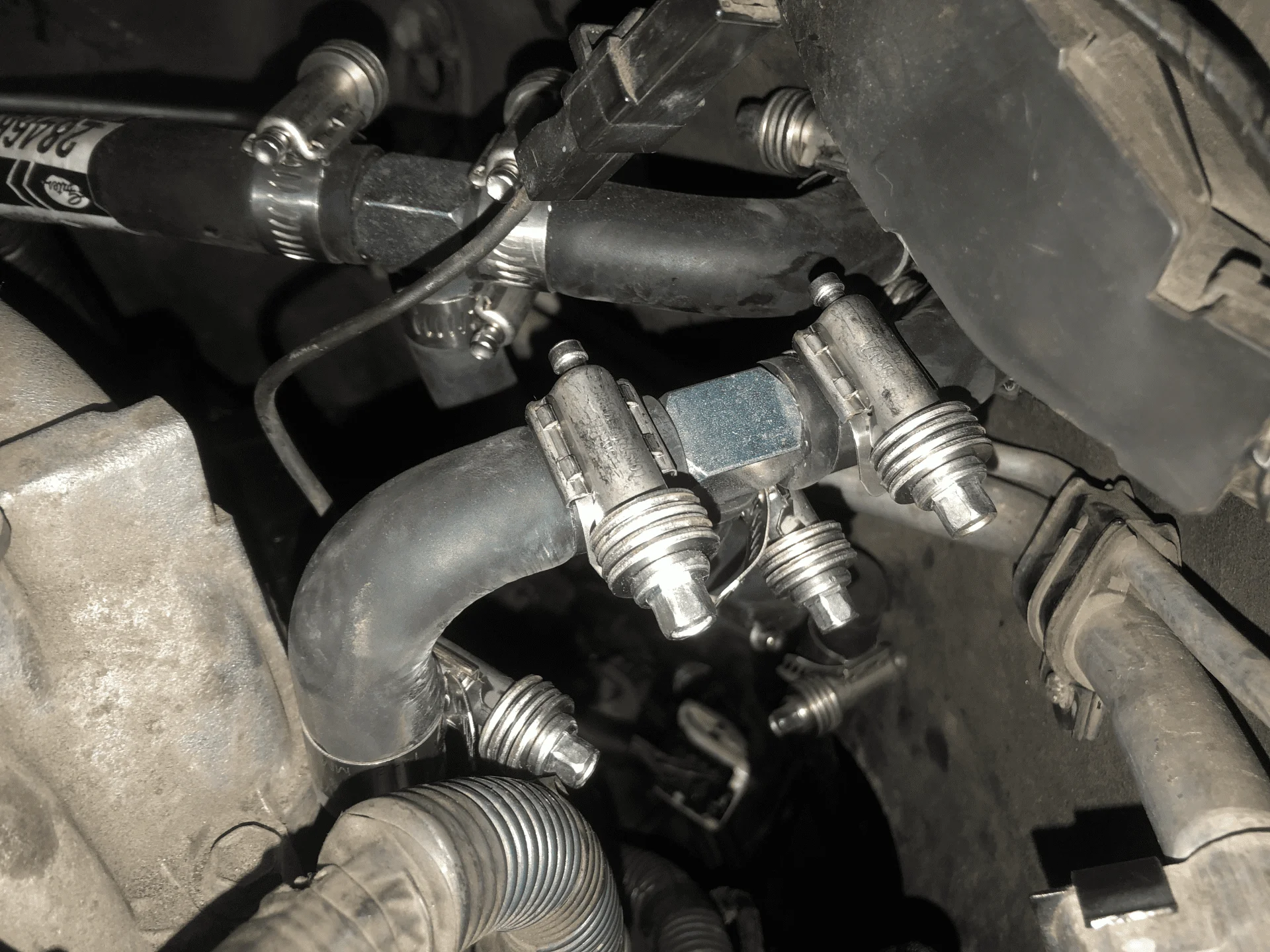

I am not sure what clamps everyone here has used. When I did my heater tees I used Breeze 'constant-torque' clamps and all new hoses. Zero leaks in about 25k miles. Based on my past experience with these clamps, I expect that they will never leak. I use them anywhere they will fit. In circumstances where I have seen problems with the standard hose clamps, it is because they will not tighten evenly and leak. Then somebody will notice said leak and over tighten the clamp causing it to cut into the hose. Later, said hose bursts open or dribbles out on the bottom where you don't (or cannot) see it. Making diagnoses......fun. They do not always leak, so I hope that yours don't leak. 🍻

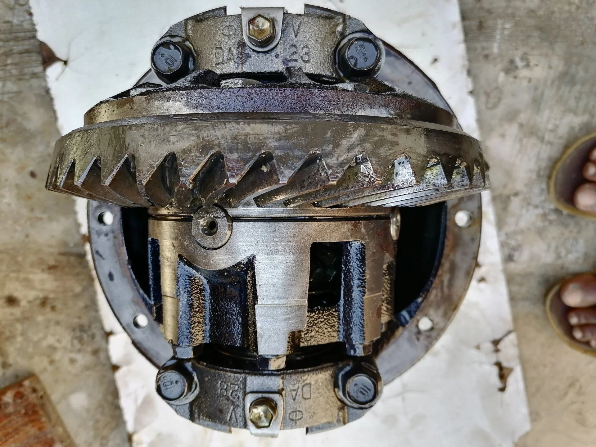

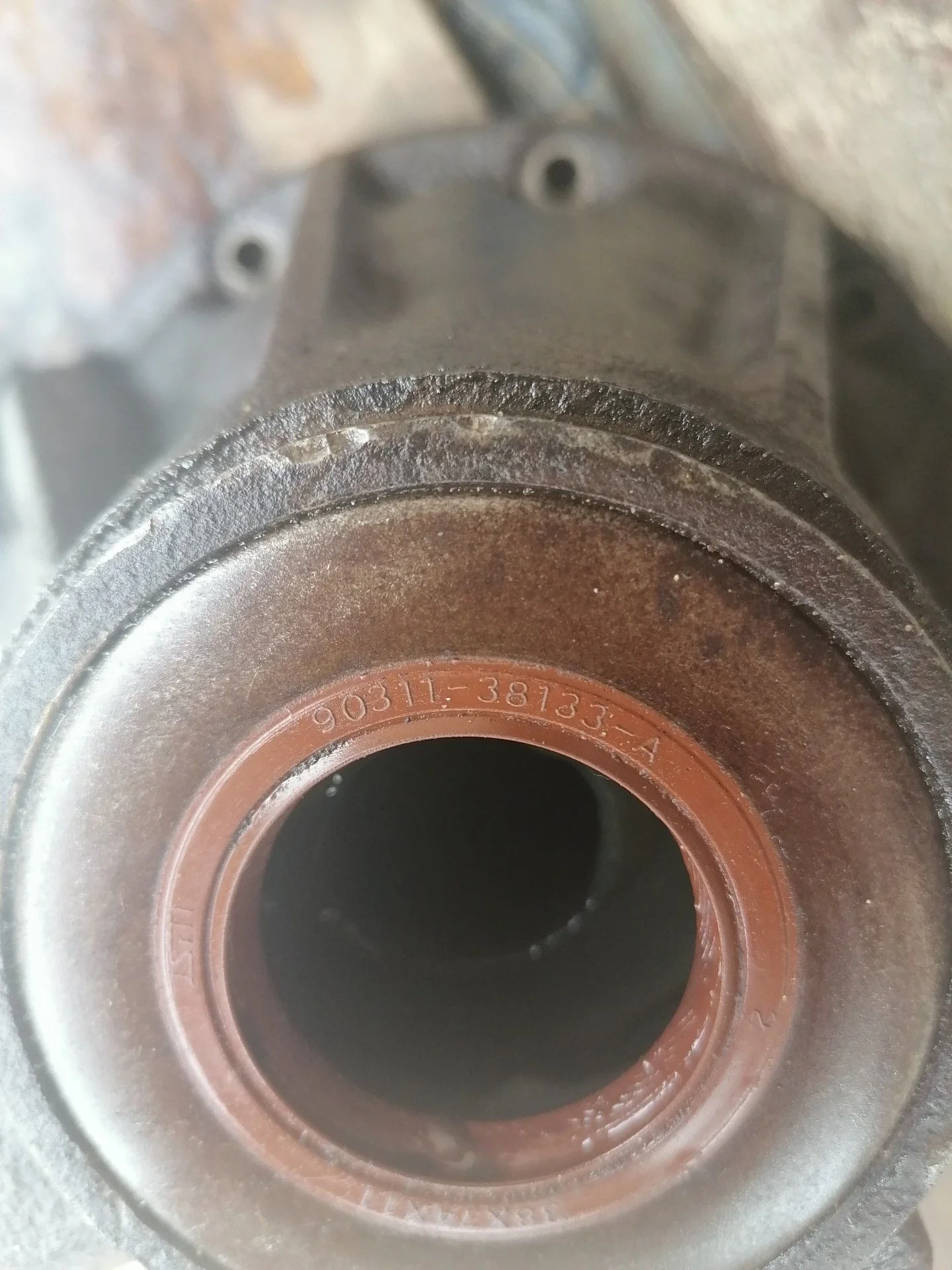

Why doubting me. I tried posting pictures of when I dismantle the parts. Only I didn't do video as I was the only one working on it.
Pictures I took was to make sure, they were reinstalled they way it was dismantled and also did measurements.
I used koyo bearings to replaced the 4 sets, one big and one small bearing on the pinion and two midium sizes on the sides.
It took me one day to dismantle the diff from car, remove the bearing and replace bearings with the help of a welder that has a big jack and bearing puller. And one day again to re-install back to car.
The hardest part for me was during installation, I put the diff on top of a small bear crate because it was very heavy to carry unto its position.
Before attempting it, I downloaded and watched several videos of how to do this job.
So it has happened! Commendable Sir!

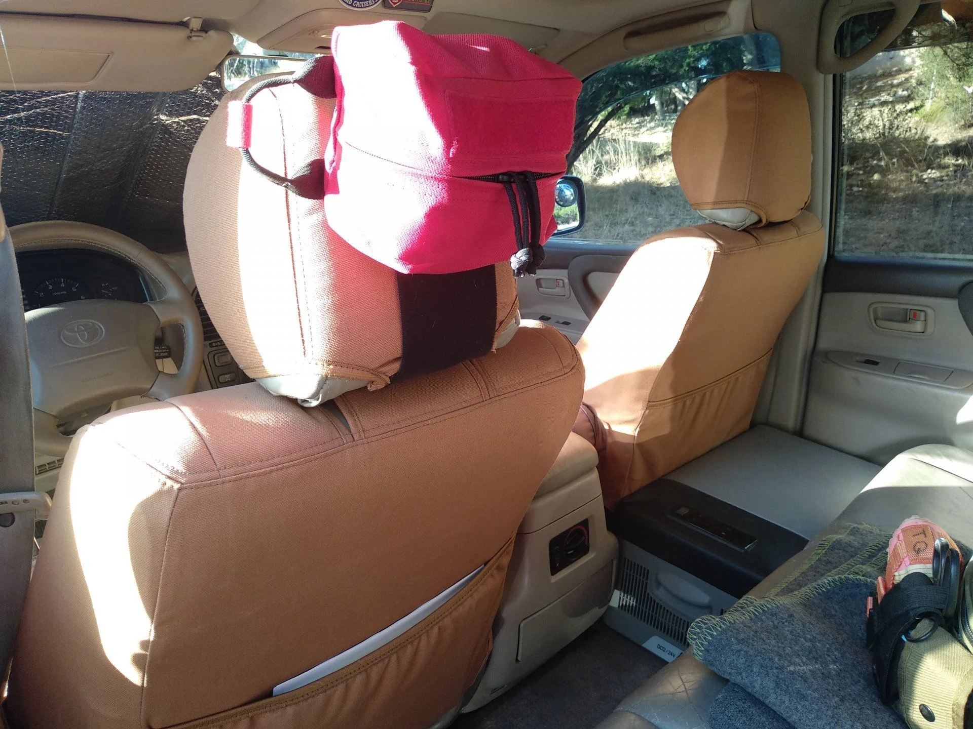

ID on that sick first aid kit?
ITS Tactical makes the velcro wrap on the headrest as well as the pouch that affixes to it. I've got a floating trauma kit that is more robust that sometimes goes in the Cruiser but the red kit is always present. Basically enough stop the bleed stuff for one and a half people.
X2. My metal tees and torque clamps leaked directly into the ends of the connectors for the transmission harness causing conductivity issues.
Noted! Appreciate the feedback. I’ll keep an eye on it. If they begin to fail, it would be responsible to replace the hoses anyways. As far as any reaction between the coolant and either stainless steel or brass, that shouldn’t be an issue.

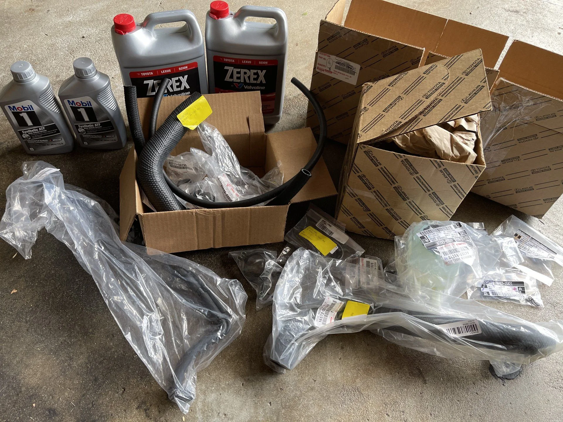

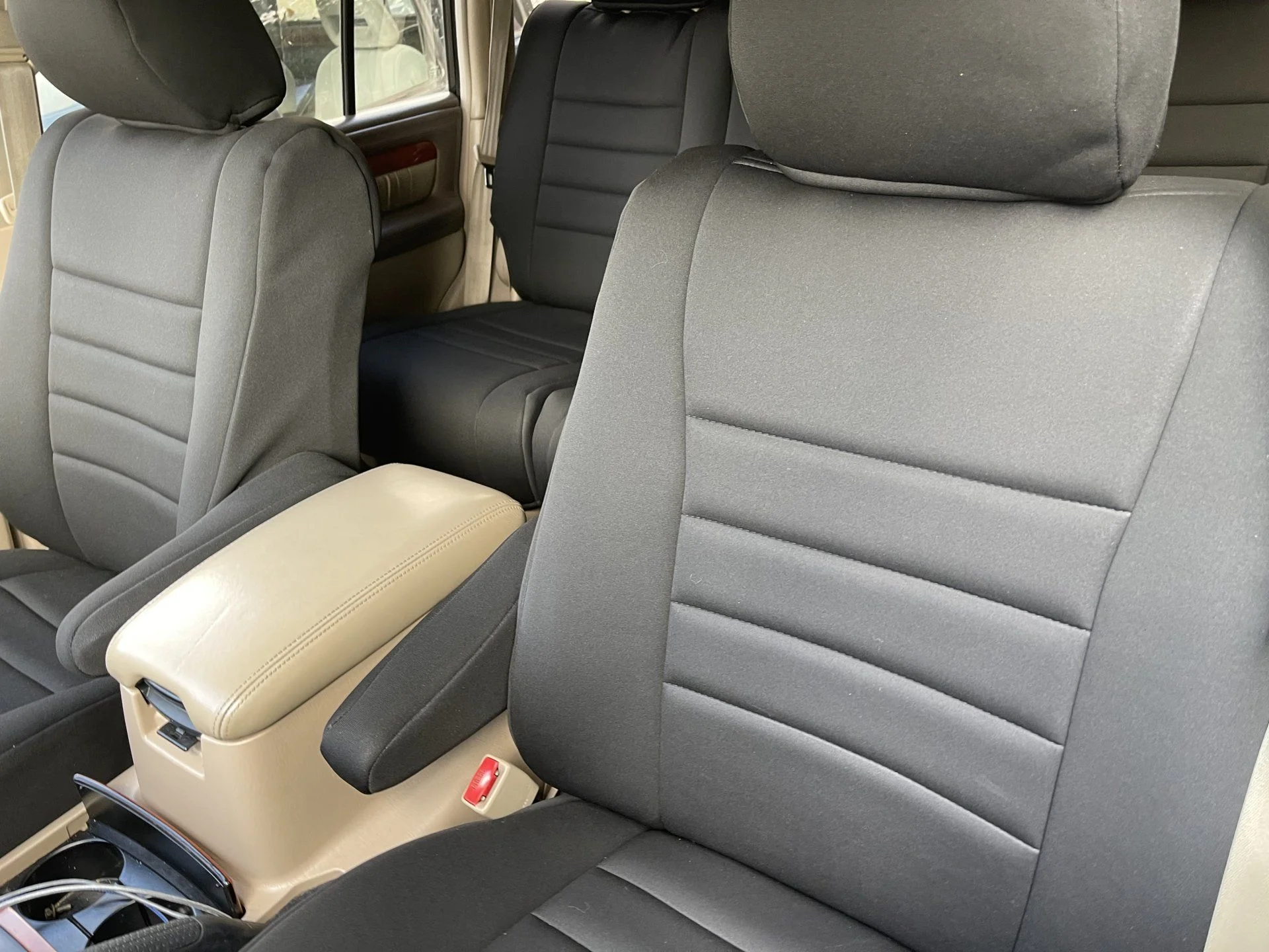

Replaced the alternator, harness, PS reservoir and hoses, upper and lower radiator hoses with all new OEM clamps. Also replaced some vacuum hoses. Then two days later, got my wet okole seat covers and now it feels like a new rig! The only bummer is the center console wasn’t available. Looks weird to me.
View attachment 2501943View attachment 2501944Replaced the alternator, harness, PS reservoir and hoses, upper and lower radiator hoses with all new OEM clamps. Also replaced some vacuum hoses. Then two days later, got my wet okole seat covers and now it feels like a new rig! The only bummer is the center console wasn’t available. Looks weird to me.
Those covers are sweet.
