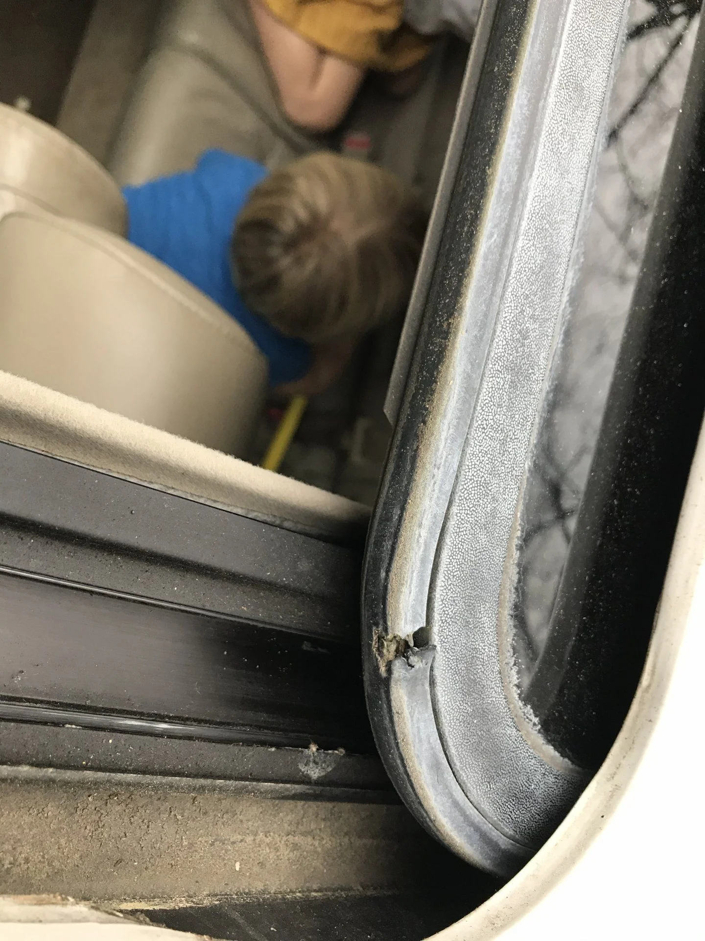

While up there confronted my sunroof trim issues. No leaks at all but matching tears at the front corners—what the heck?
Planning on replacing but if there’s something causing this wear...
@mdcoa That appears extremely weathered in addition to the cuts, & looks like someone put some sort of coating on the trim directly connected to the glass which is normally black plastic. When i did my drains i first tried the weed eater line from a step ladder outside but no luck then i pulled the glass out so i could get my big self in the truck to go at it which worked better. Taking the glass out is pretty simple. Pull down on the plastic trim at each side to expose two fasteners on each side then lift it out. While i had it out i ran a bead of clear acrylic latex caulk along the glass where it meets the plastic trim and then a bead between the rubber outer strip and the plastic trim. You may be able to put some rtv sealant on the cuts in the rubber strip once you have the assembly out of the truck. Good Luck.

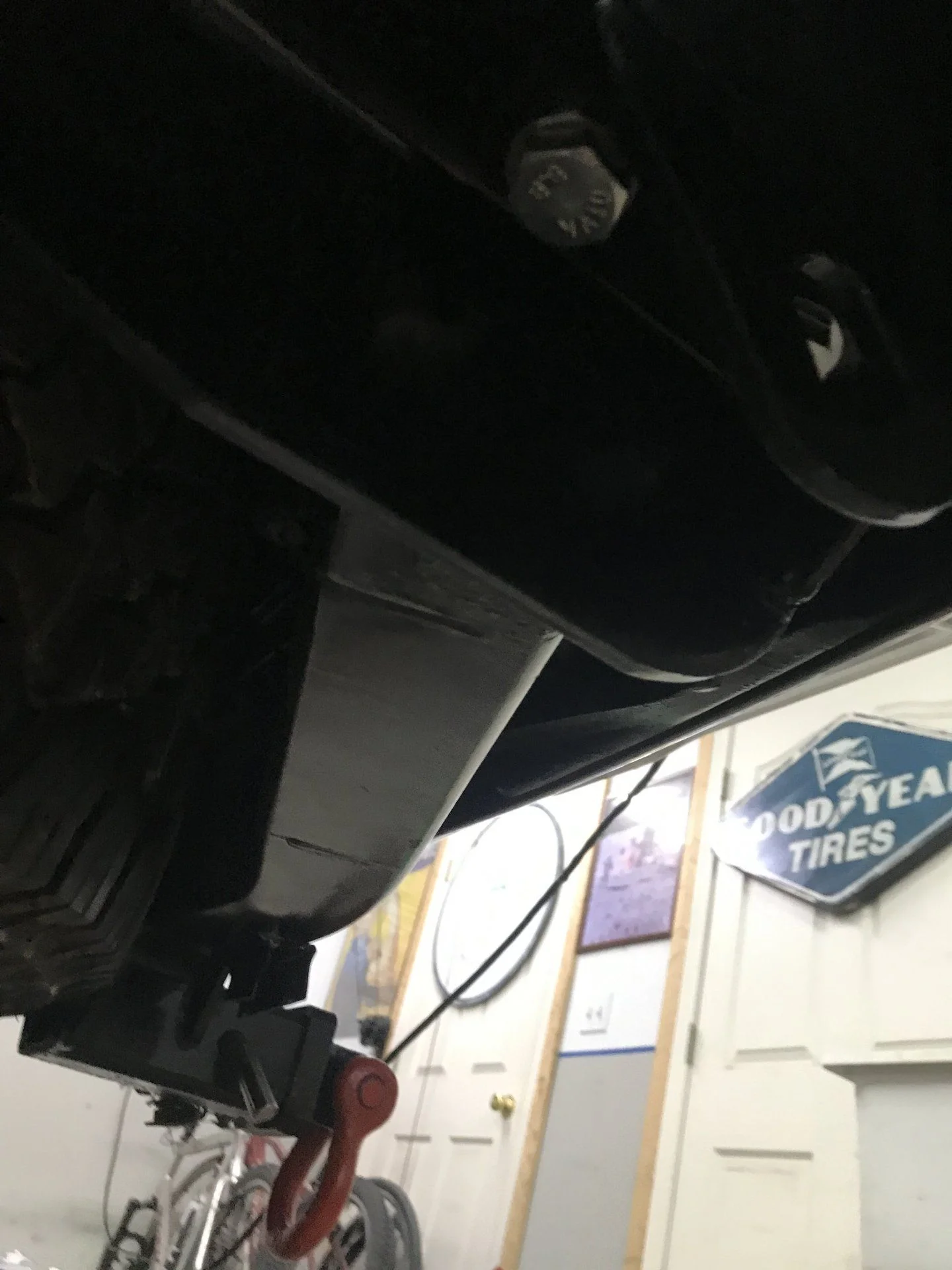

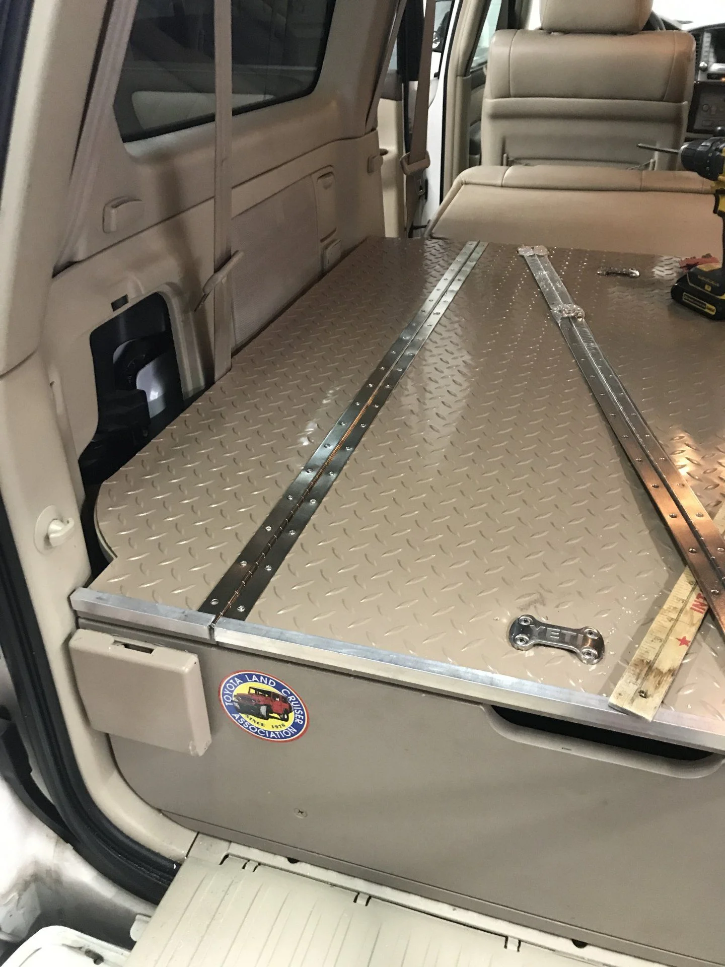

Nothing terribly exciting today. (Ironman bumper next week). Today, I refurbished the receiver hitch, built some simple but beefy crossbars for my XL RTT and hinged my drawer system wings. Nice, low-key day. Sure beats the exhaust manifold install from 4 weeks ago.

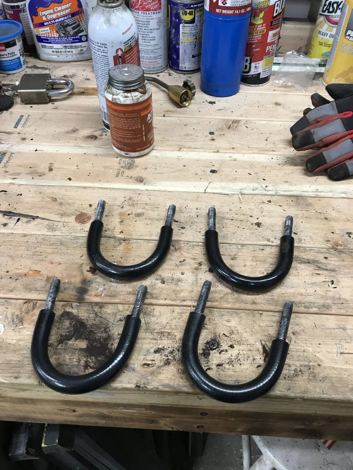

@LXKevin Yep, 3/8” fuel hose. Soapy water and slide them on. Cut with a razor blade where the threads start. It’s very stout. I had a very similar setup on my ‘03 100 and took our XL RTT through several Moab trails with it up there. I was going to buy a fancy off-the-shelf system but thought, meh, this is stout. 12-gauge. Bought the 1.5” end caps at Ace Hardware for $1.09. Cost of everything about $45 probably.

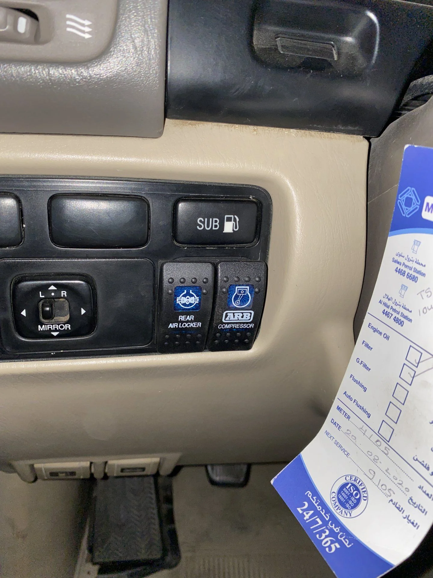

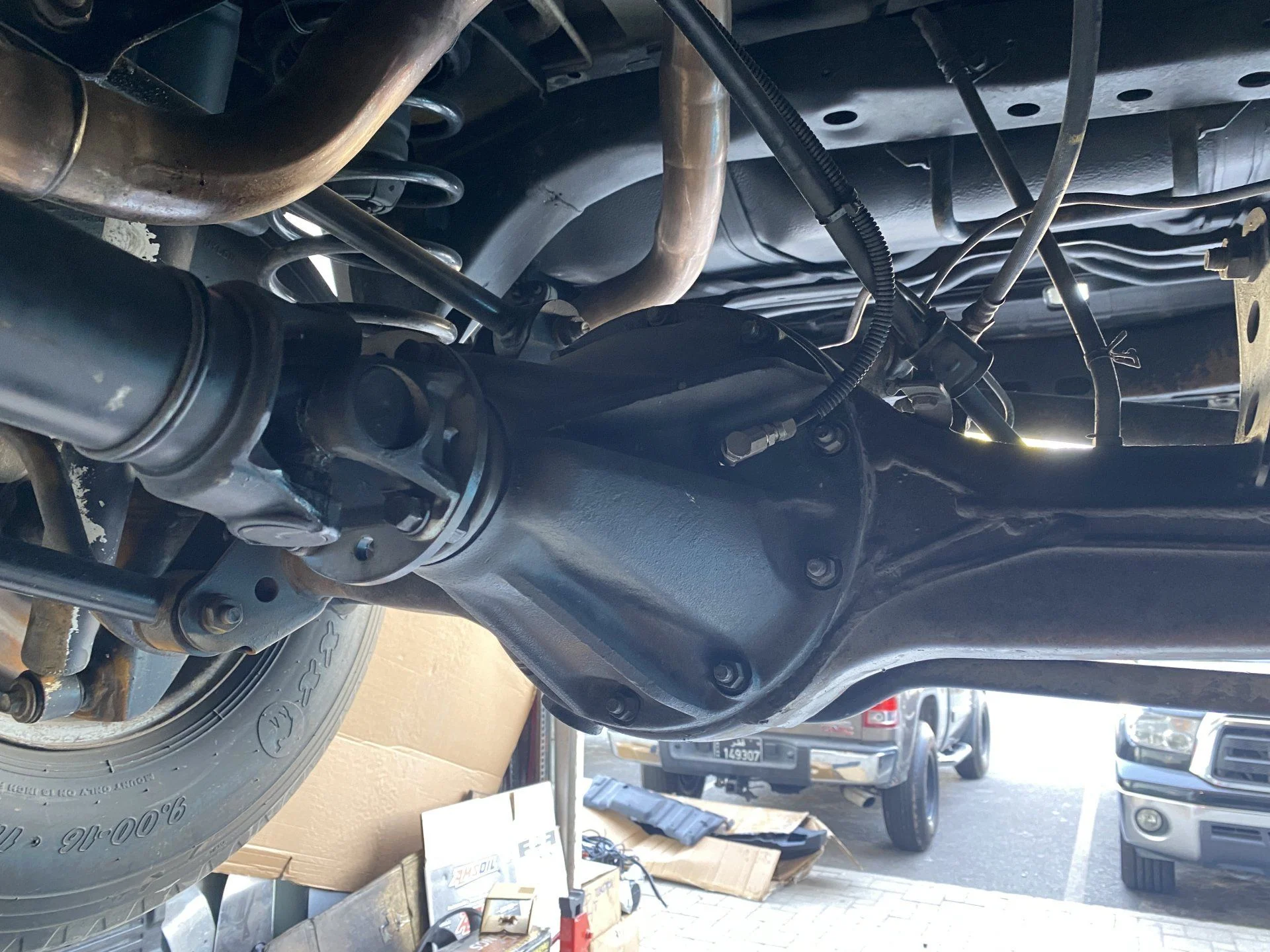

This week on my 2006 100 series:
1. Upped the final drive ratio from 4.1 to 4.88 by installing nitro gear ring and pinions front and rear (finally finished breaking them in changing the oil as we speak)
2. Installed a rear ARB locker with the compressor off course

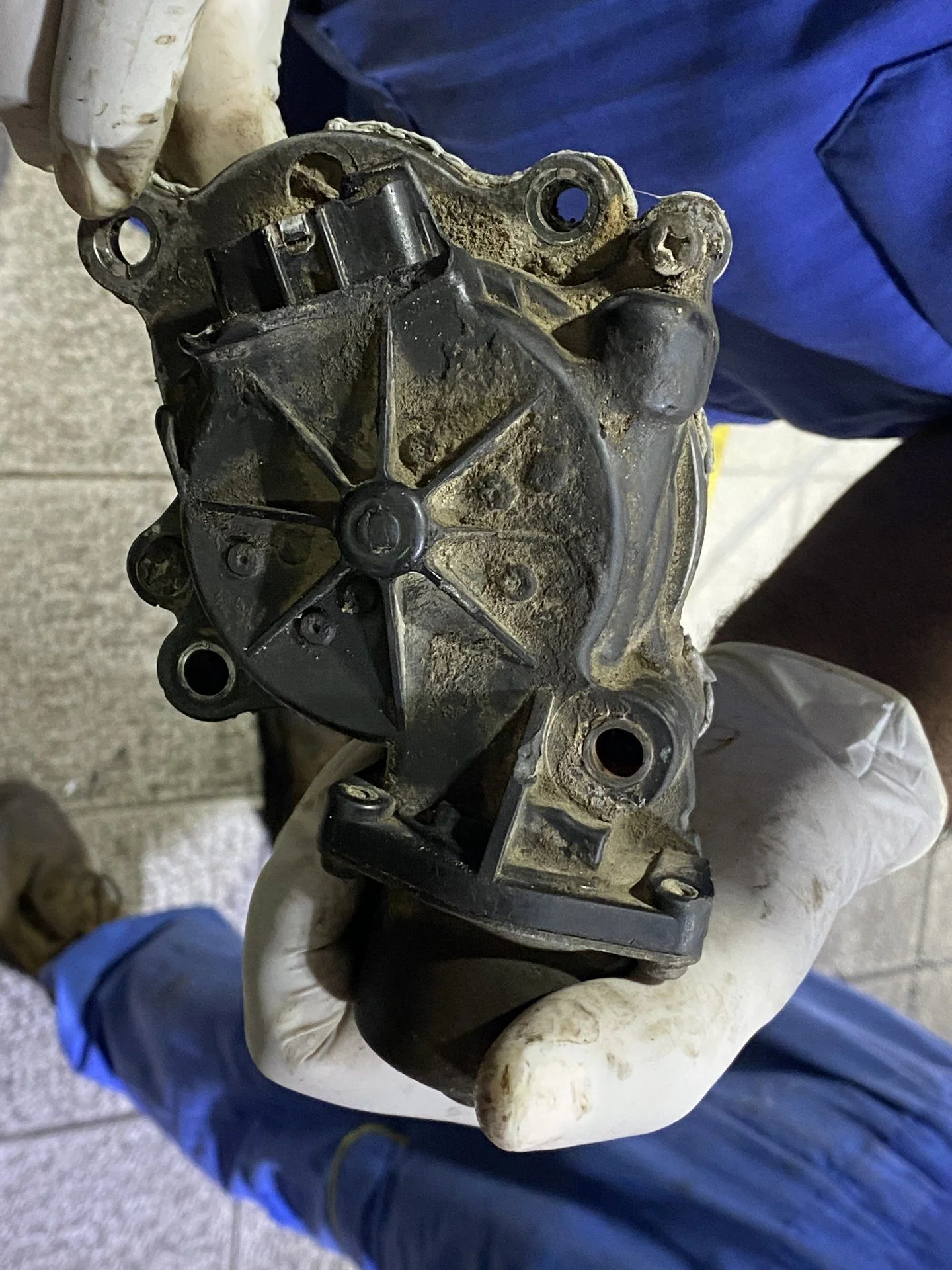

3. Replaced the transfer case actuator motor

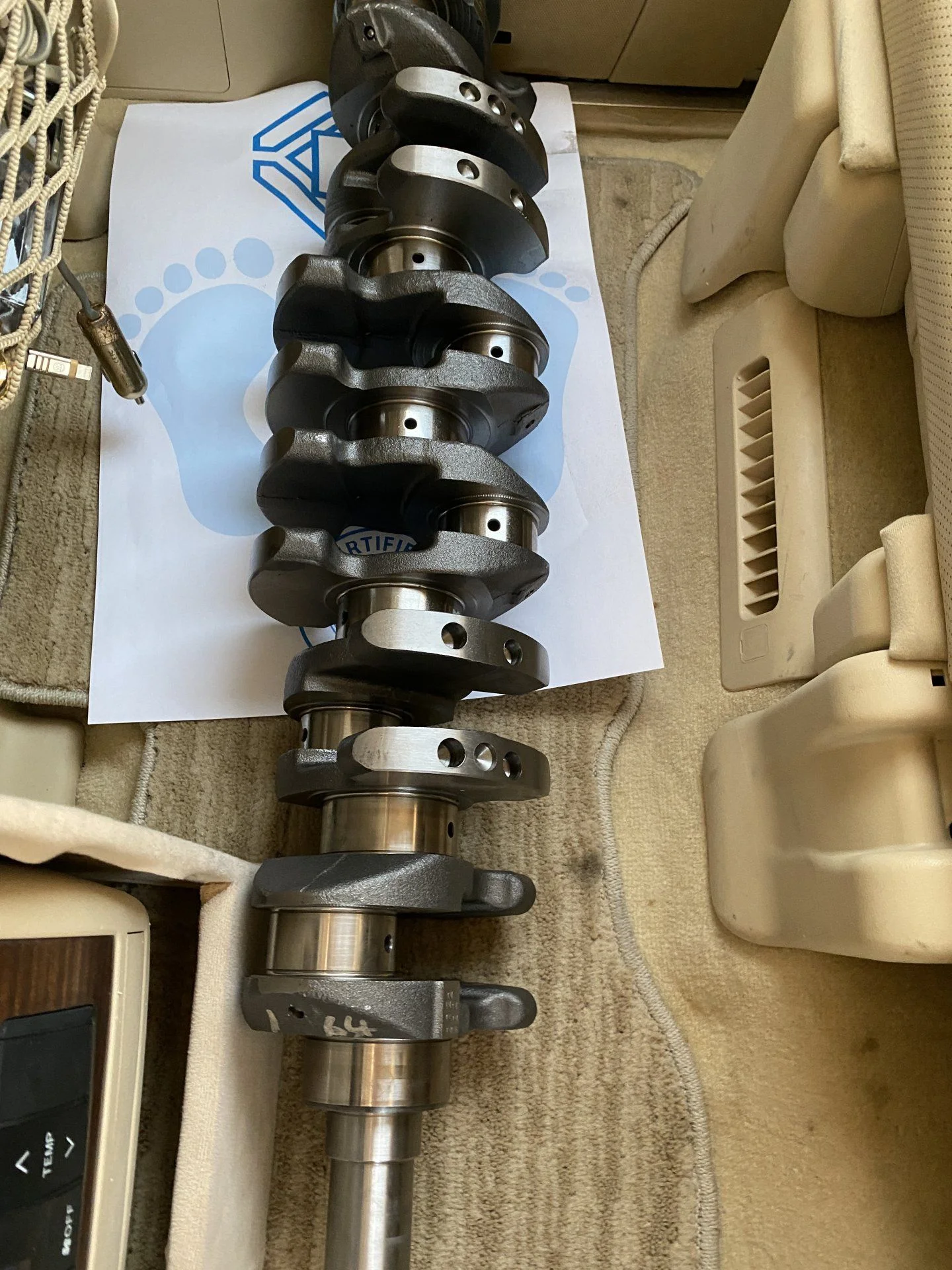

(1fze update)
4. Replaced the factory crankshaft(95mm) with a 101mm stroker from Brian crower

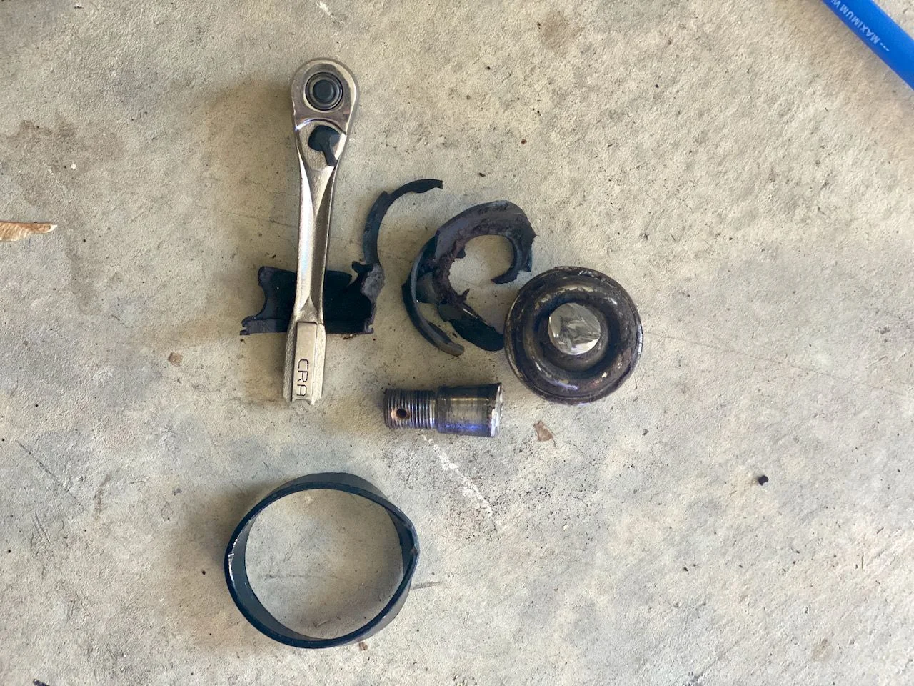

LBJ — this one went downhill fast. One day it was "I think there might be a noise up front", and the next it went full clown show. Somewhere in a recent move I've misplaced a jaw puller set, so...I ended up having to cut it off.
The Harbor Freight ball joint press kit works to pop it out, but requires some...creativity to press it back in. I cut down a length of one of the included pieces. Didn't work well, as you can see below.
The carnage:
At least the noise is gone?
