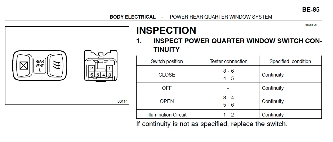

FSM says to check the switch for continuity, but shows the LH switch in the example. Upon testing the RH switch I found continuity to be exactly the opposite (i.e. Open results in continuity between 3-6 and 4-5), so I'm guessing it's supposed to be that way and the switch is good. Assuming I now need to remove trim and check the motor itself, but is my thinking on the switch right-on?

FSM says to check the switch for continuity, but shows the LH switch in the example. Upon testing the RH switch I found continuity to be exactly the opposite (i.e. Open results in continuity between 3-6 and 4-5), so I'm guessing it's supposed to be that way.
Is that a safe/correct assumption?
Precisely my question! Sorry that wasn’t more obvious....
Since it’s difficult for me to imagine a broken RH switch behaving in exactly the opposite manner as a functioning LH switch, rather than just having no continuity when rocked in one direction or the other, I’m assuming it’s probably working fine, but did want to poll the group, especially if someone’s got a working one laying around they can stick a multimeter on....

So that tells me that the RH and LH switches are opposite. FSM test is 180-degrees out for RH switch, unless of course there's terminal numbering printed somewhere on the switch itself and the terminals are numbered differently on the right??

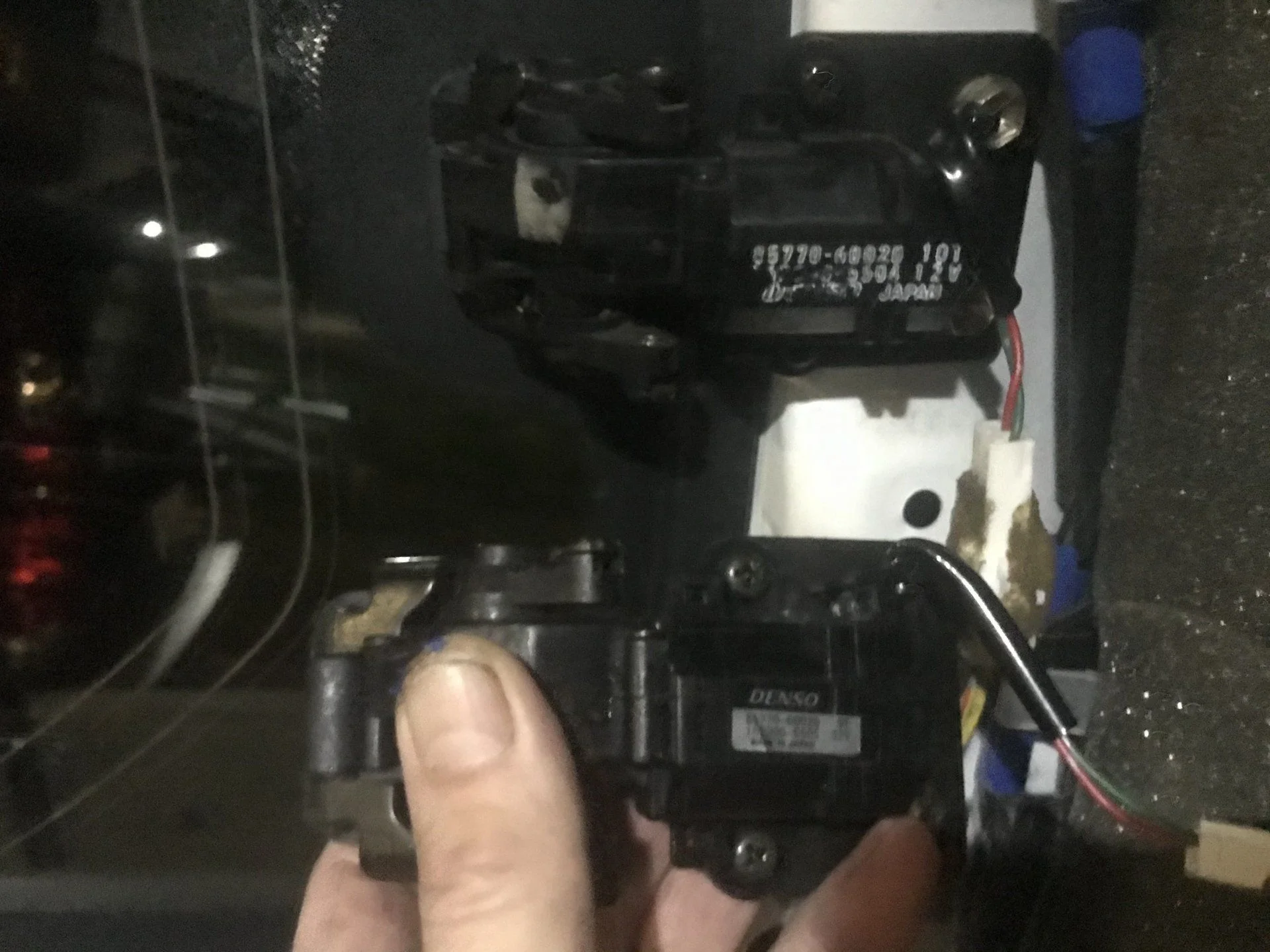

Replacement motor (installed in the pic below) was dusty and generally looked like hell. My non-working motor looks like it just came off the assembly line. Go figure.
Part no. is 85770-60020. Same part number for left and right vent windows.

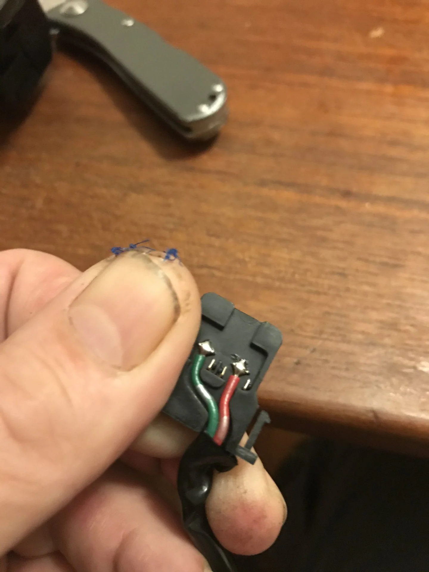

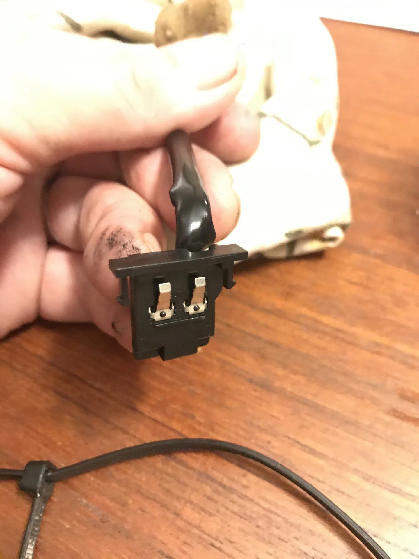

When I noticed that something that looked almost like a memory card was sticking out back by the wires for the motor.
Which I then realized was how the wires connect . . .
Which means I probably knocked this loose when I had the quarter vent windows out several months ago to replace the trim at their leading edge . . .
Plugged it back in and ran out to the truck to apply 12V. Works perfectly. My only comfort is that a) that is hard to notice with the motor mounted, partly because that motor is tucked up against rear climate control stuff, and b) at least I bought a used motor and my mistake was only an $80 one . . .

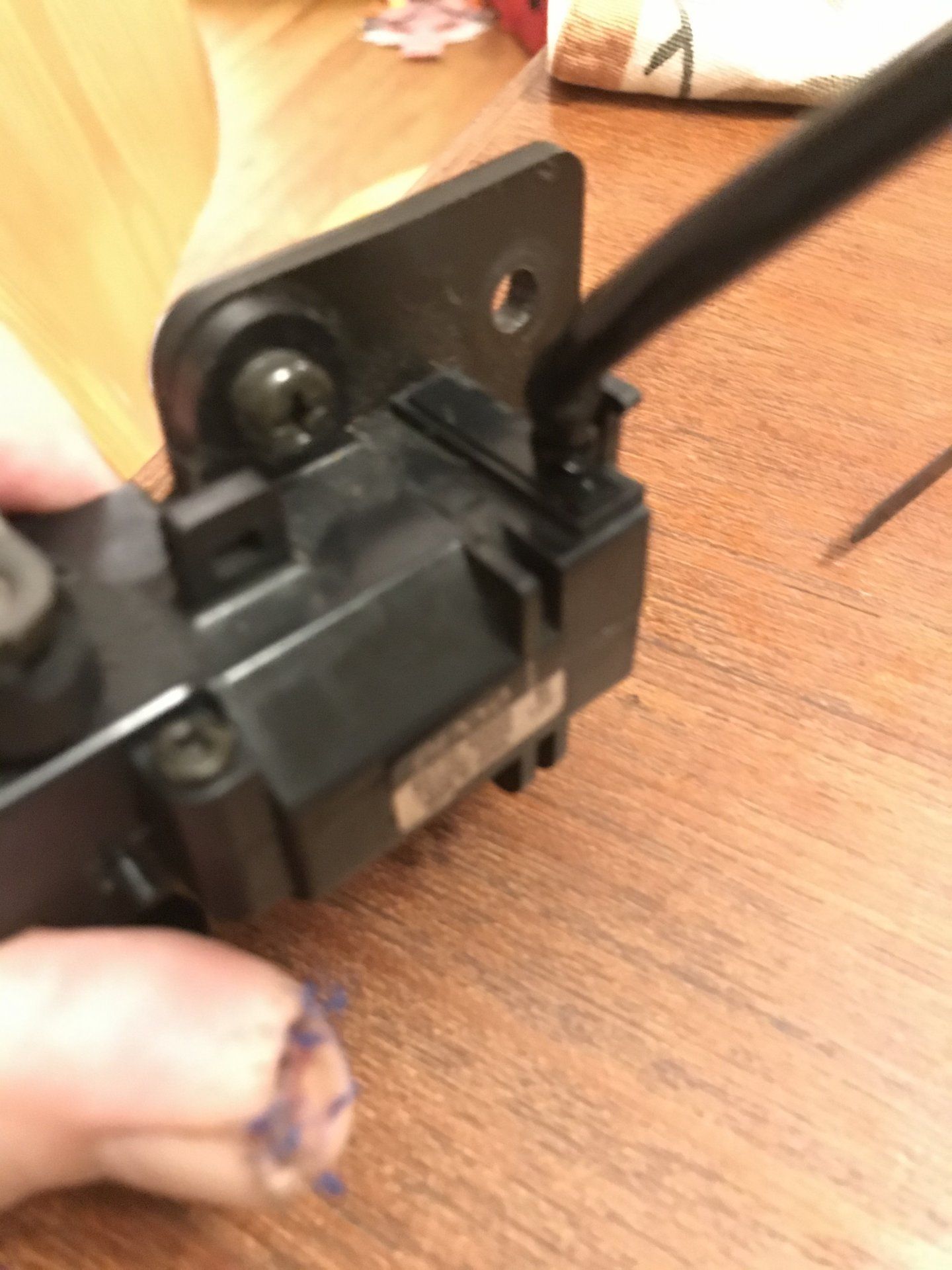

Pics: Pic 1 is after I cut the tiny zip tie that is supposed to be holding that connector in and pulled it out a bit further--it wasn't sticking out that far, but the wires had gotten out of their track (pic 3) and were keeping it from being pushed all the way in without removing and re-routing those little fellows:

ummm dude, @mdcoa...whats with your finger lol....looks like you self super glued and stitched the tip of your thumb back on...
@ShenValley100LC and @LXKevin : Yeah, unsuccessful attempt to amputate the tip of my thumb while chopping some bacon for the kale . . . wondered if anyone'd notice, given that poorly focused photo . . .
