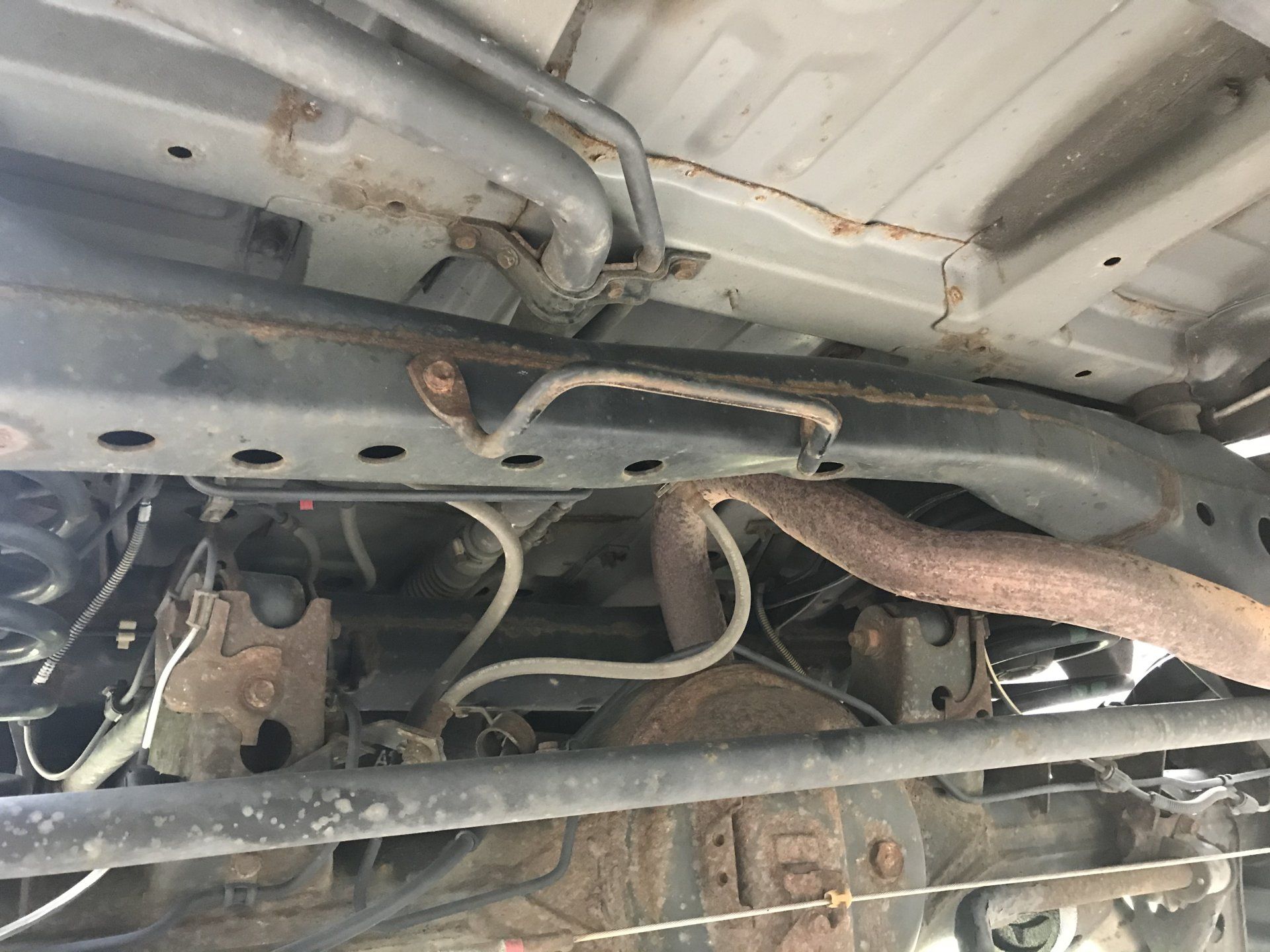

Started the rust remediation process today. Worst area was the back of the rear axle. Most of the other rust was just along weld seams in the back half of the truck. Thanks to a leaking steering rack, replaced by the previous owner, the front half is about 98% rust free. Used a wire wheel on a grinder and wire bush. I then sprayed the rust with Rust-oleum Rust Reformer. The plan is to let it cure rest of the week and spray Rust-oleum gloss this weekend. My understanding is that gloss is slicker and holds less dirt, grime, salt, etc than a flat paint. I'll then hit the entire undercarriage with Fluid Film following that. My truck is in very good shape and I want to keep it that way.
Looks great! How long it take ya?
Took about 5 hours. The next step should go much faster now that the worst is done. (Brushing and wire wheeling rust off.)

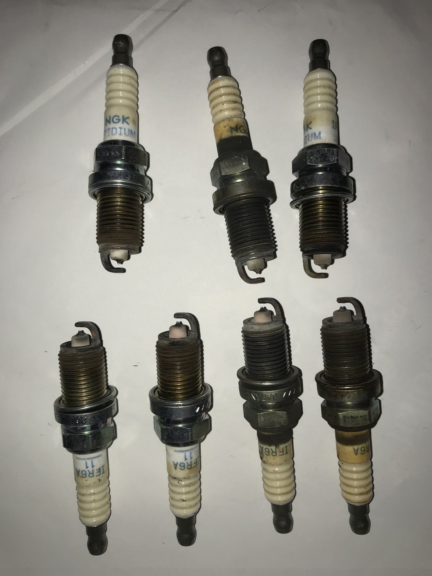

How bad were these spark plugs?
Should I replace some of the carbon fouled coils? 2 of the coils were pretty covered in carbon soot.
Those look pretty good to me, normal color but if you've got them out I'd just replace them.

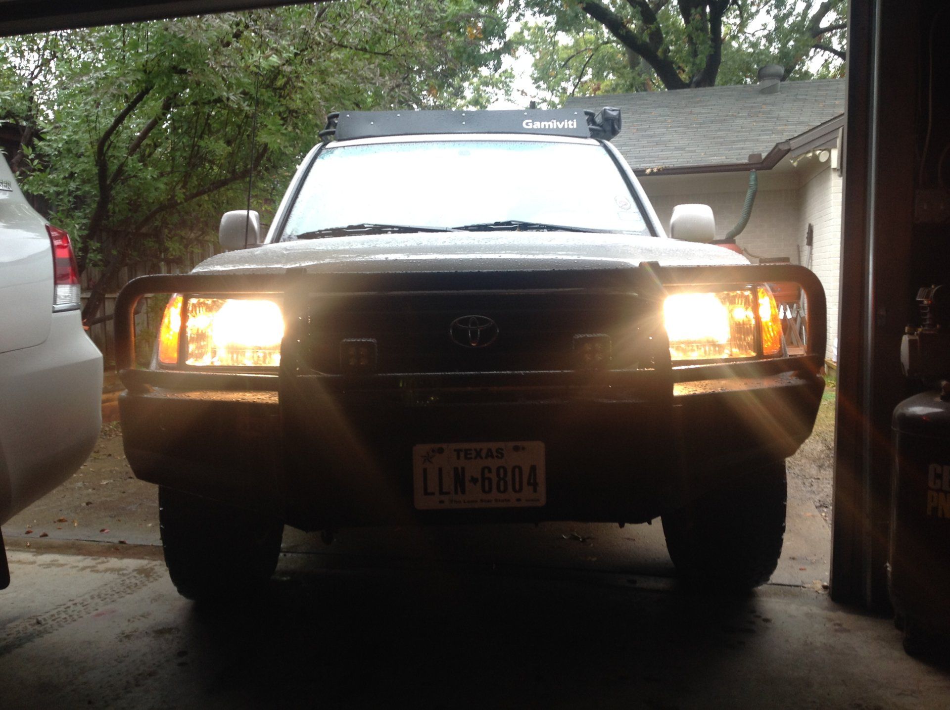

I was looking at those lights. How do you like them?
I mean for the price, they are good enough for me. The quality seems decent, time will tell. I just didn't have the coin to drop on rigid or baja design lights. They are 1050 lumens each, so more than enough output for what I'll be using them for. I just really wanted to retain my factory fog switch since installing the ARB, so these did the trick. Today I also replaced my high and low beam, and my DRL bulbs all with Sylvania SilverStar bulbs. A friend of mine ran the Sylvania SilverStar Ultra's and they only lasted him about a year, and they are the more expensive of the two by about $8 a pair. I just noticed the ones I had in there just seemed a little "dull". These have a noticeable difference in output. The first picture is before, the second picture is with the new bulbs in the drivers side, and the third is with the original brights on the passenger and the new brights on the driver.
We will see when I get out in the morning. Also finally wired new LED turn signals into the ARB turn signal locations, tapped into my blinker only, didn't want them to be tied into my DRL, I didn't like the look, just too much going on upfront with them and the DRL's lit up.
