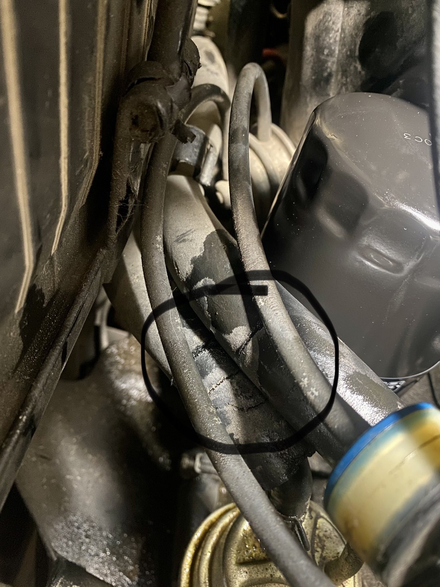

Mitch he’d to tell from that pic but my guess is heater hoses. Do they connect to the firewall?
So I took my youngest son (13) out to change the oil in the ‘82 FJ40 this evening. While removing the oil filter we noticed these cracked hoses. This pic is from after removing and replacing the oil filter so the fluid is likely from my removal of old filter. Anyway, can anyone tell me what these hoses are for and how easy/difficult they are to change? Thanks in advance cruiser heads! 2F
Mitch
that funny looking thing attached to the block is the mechanical fuel pump. those 2 lines are the gas inlet from the tank and the return line back to tank.
most likely the fuel line is OK, what you are seeing is a covering over the fuel line. the cracks are nothing to worry about. if you look at the line at high noon in your pic you will see the smaller fuel line where it attaches to the pump, it is a smaller diameter than the larger cracked covering.
final answer is nothing to worry about
Awesome! Drive and enjoy :). Perfect. Thank you guys!!!!

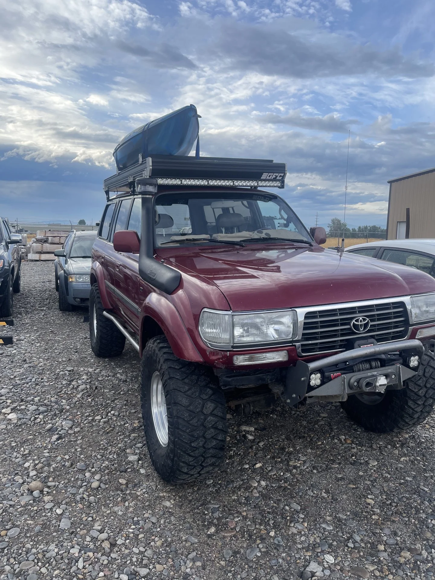

I made my ac work by replacing the tensioner pulley that fell out(??) and installed a snorkel (thanks @thetoyotaman ) so that I don’t suck in water anytime it rains
I made my ac work by replacing the tensioner pulley that fell out(??) and installed a snorkel (thanks @thetoyotaman ) so that I don’t suck in water anytime it rainsView attachment 3084901
The tensioner falling out is a fairly common thing in my experience. It's happened to me and I've seen it a few time. Mine started making noise and then the noise went away and I strangely lost ac at the same time and it was gone
