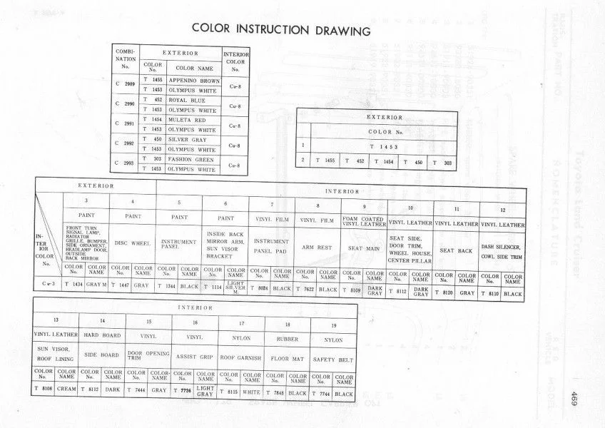

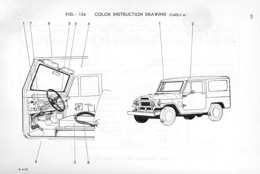

Can others chime in on T1447 just to confirm that for sure?
I'm sure
Pics from @Landpimp I think...
They are toyota codes
I am almost 100% they were for 69' ... but... the gray is the same ... it has been posted in other manuals ... other years
Thank you! So if I am looking at getting those mixed and my paint shop couldn't find in their computer and old paint chips, code manuals and catalogs where do you think I could find that information.
