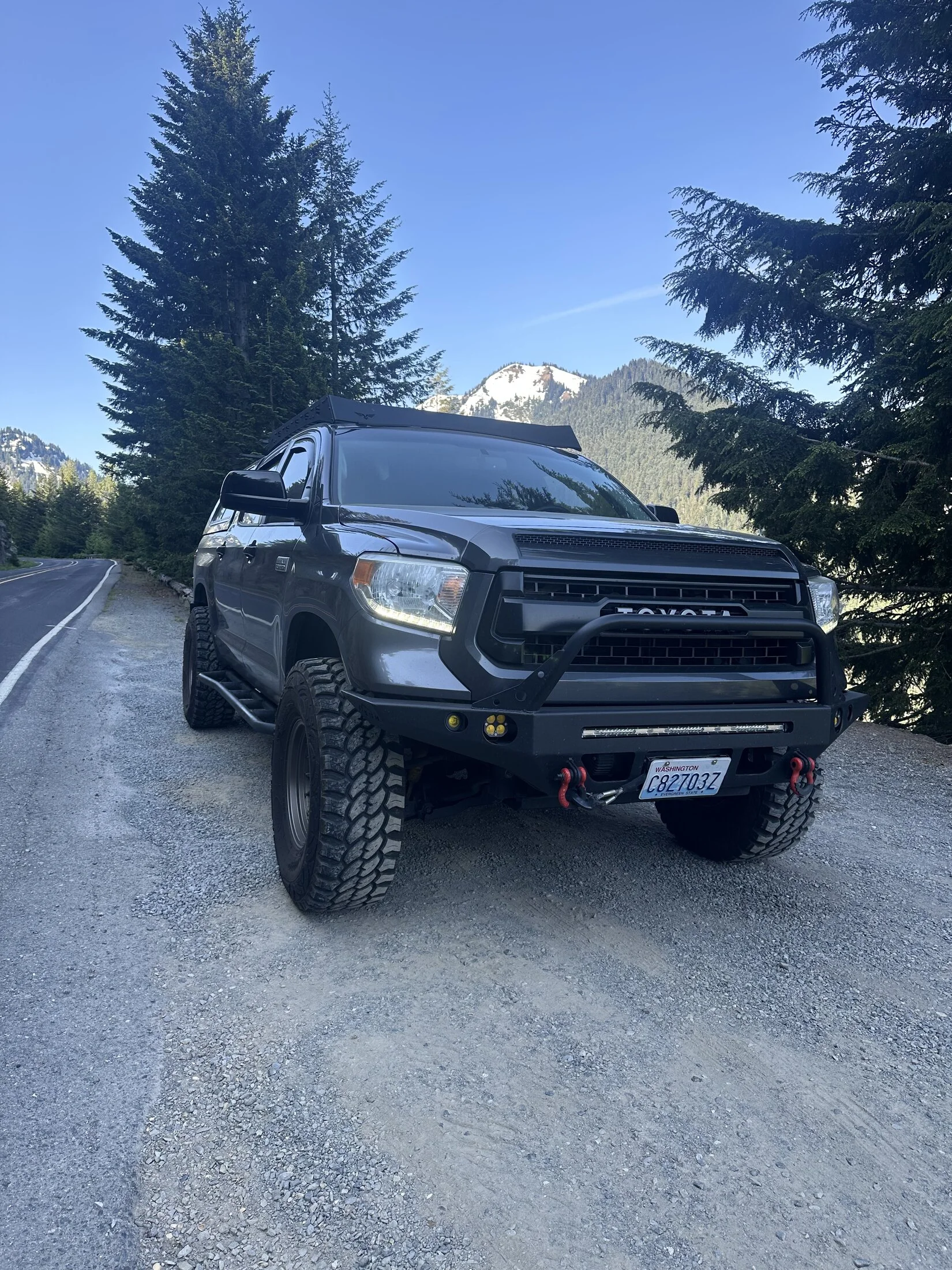

Finally put my CBI bumper on after having it in storage for a year or two ..lol 12k lb warn winch too

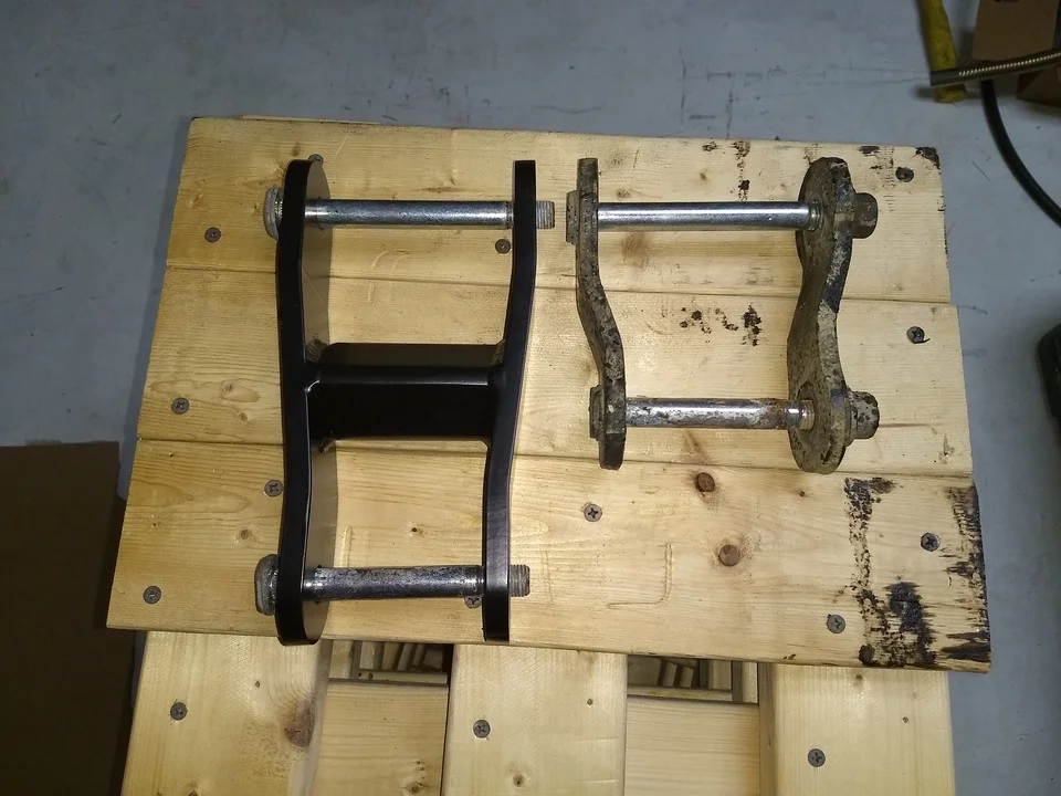

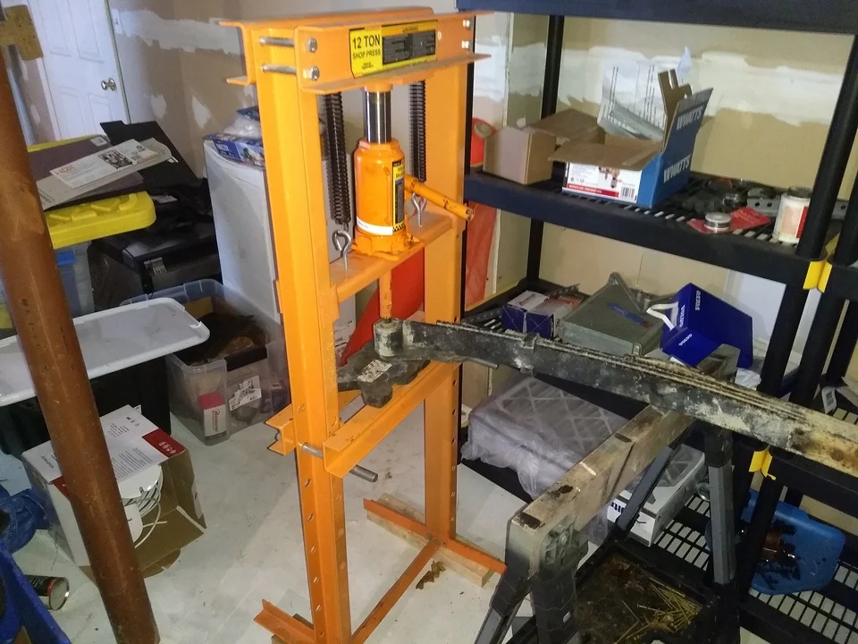

Replaced +1" Amazon noname shackles ("Protunes Suspension") with +2" Pro Form Fabrication. Here the new shackles are compared to the stock ones.

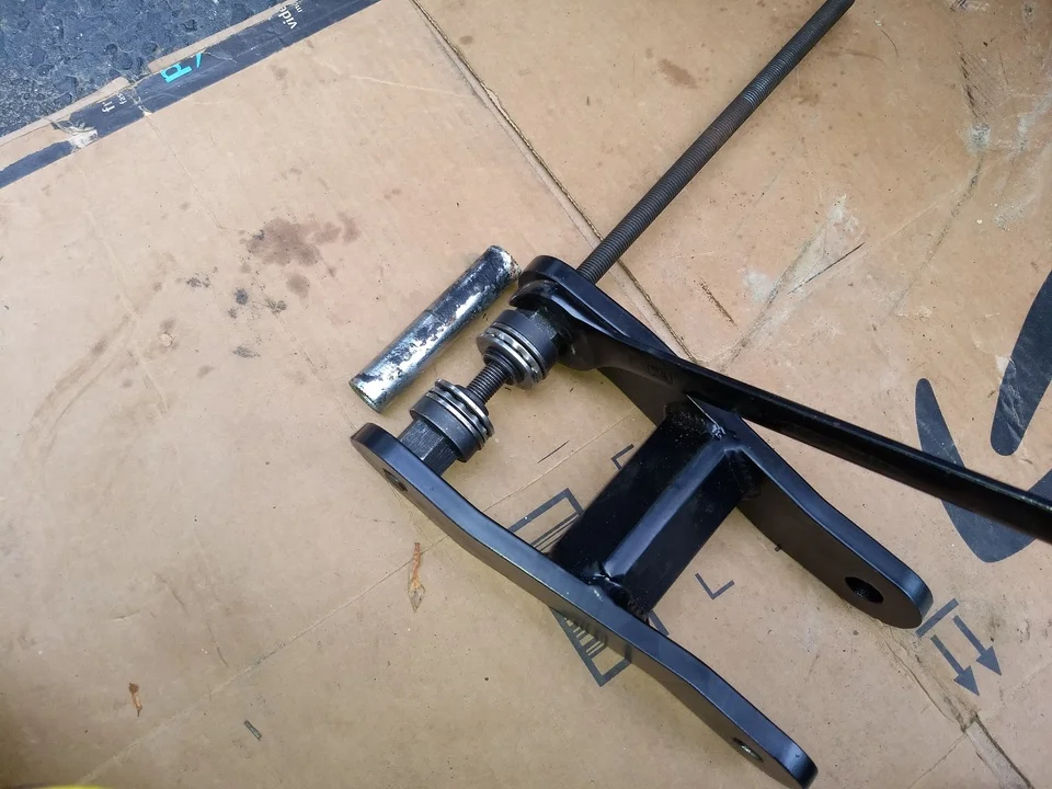

Lower bolts were both seized badly, even though I greased them with Lukas marine grease 3 or 4 years ago. Had to take leafs out, heat the bolt remnants with inductive heater, cool with PB Blaster, repeat N times, and finally press them out. Next time I'll just use greasable bolts.
The new shackles needed a stretching surgery for top bolts and some paint removal from the insides of the holes. Pretty sure I've heard a weld cracking while doing the other one.
One bolt wasn't cooperating, I was tired and just smacked it in with a sledge. Of course it damaged the threads, I'm waiting on a M14 die&tap to finish the work.
