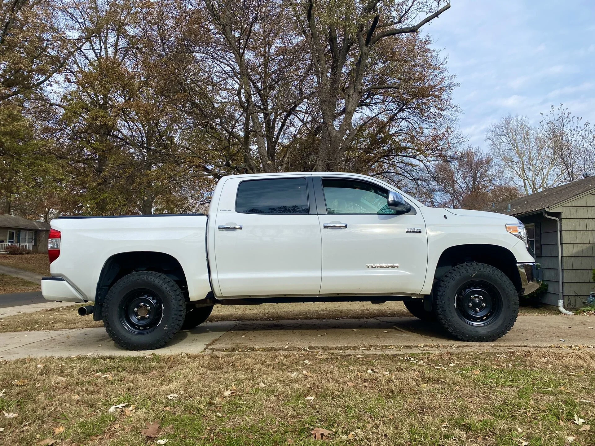

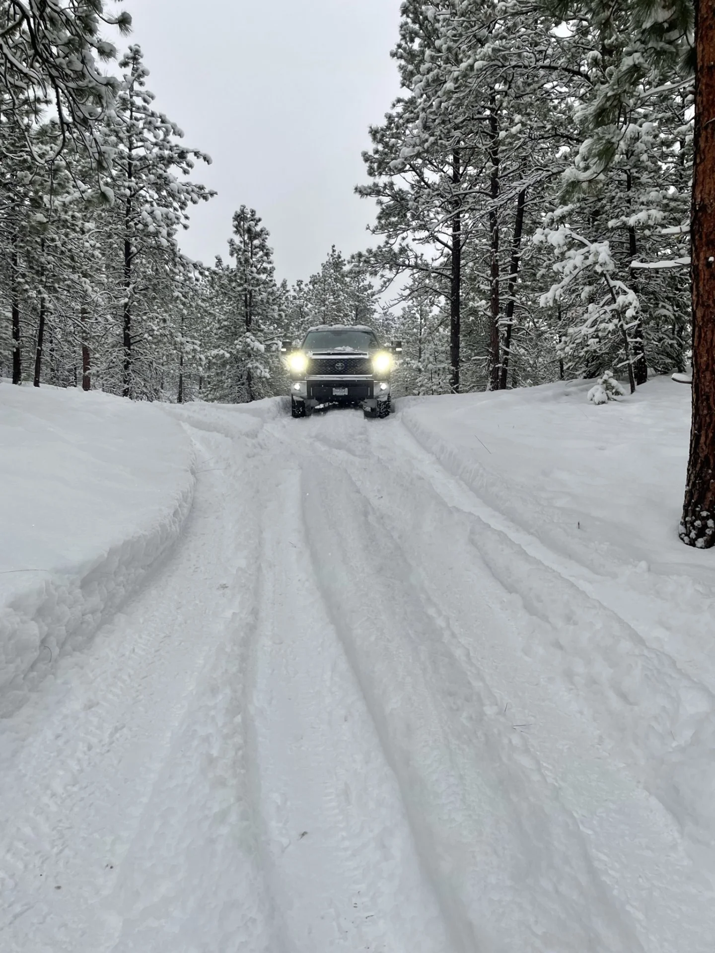

These pics were taken a week apart. Snow arrived last week.

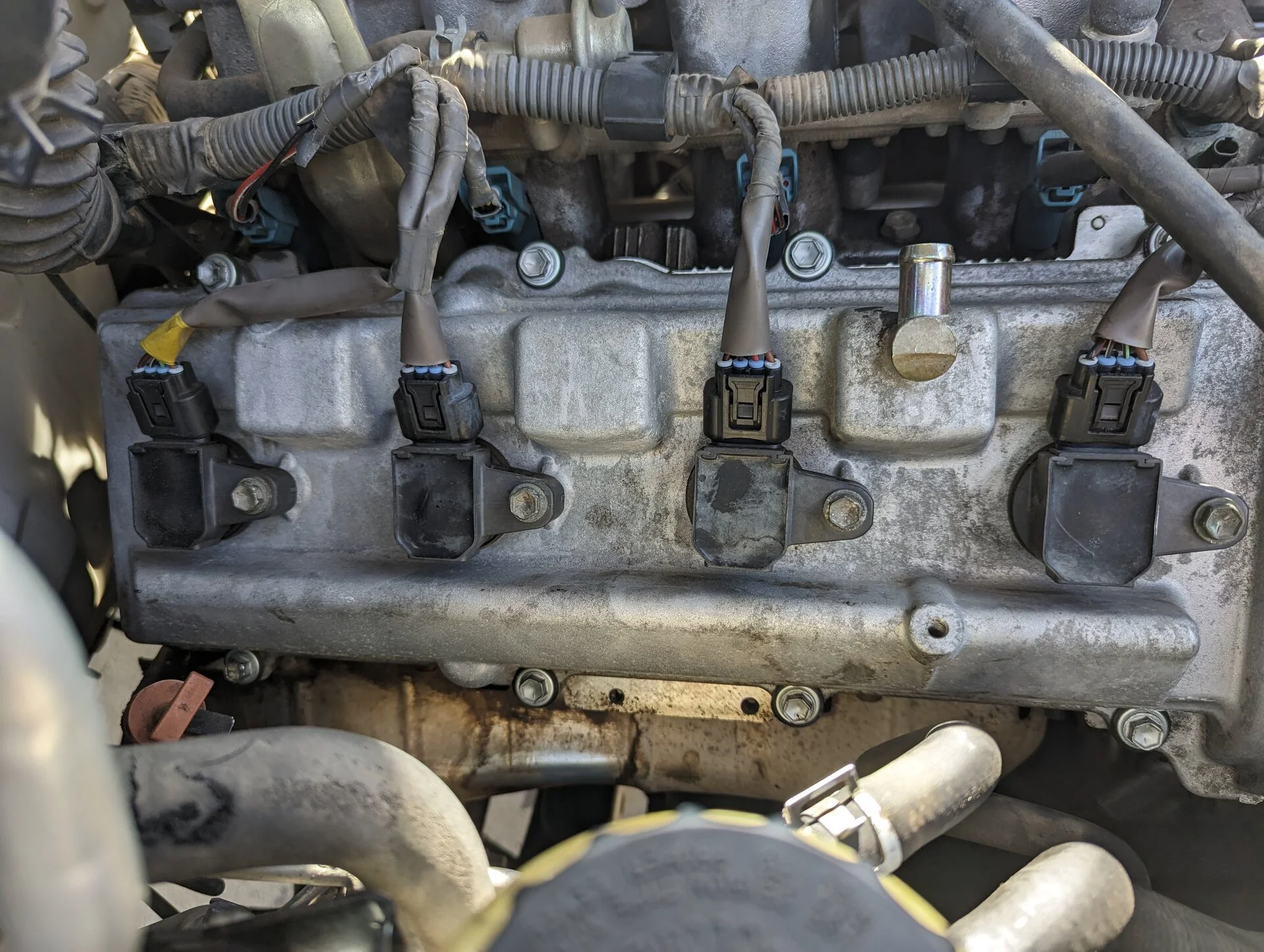

Swapped out the starter on my 2nd Gen (244,000 miles so it had a good run). What a PITA. I used the motor mount lift method vs the exhaust manifold method. My one other piece of advice would be to thoroughly soak the dipstick tube hold-down bolt before removing, mine sheared and is now hanging in there with zip ties until I figure out how to properly address it for tap out or maybe just JB Weld. It’s in a tricky spot for a drill, even if removing the air box.

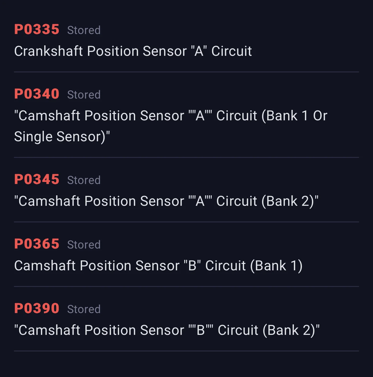

Symptoms were spinning sound but bendix not engaging, every 4th start attempt or so. Also would get several codes that didn’t seem starter-related at first blush:

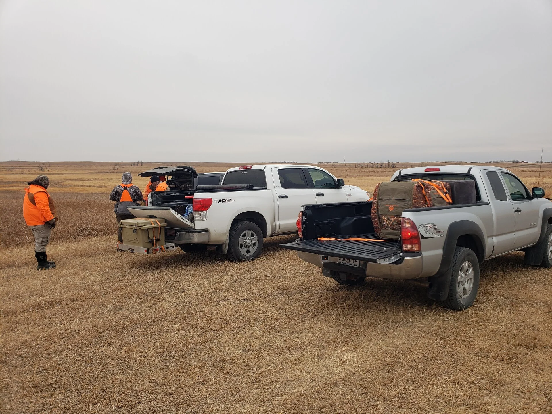

Drove a ~1,500 mile round trip to put some birds in it. I had previously only driven it about 3k miles this year. Threw some new takeoff P-rated Michelins on before the trip. WOW, I forgot how smooth and quiet this rig could be. Also proved that a 1GR Tacoma (and a pretty new 5.3 Tahoe) only beat a 3UR Tundra by 1 MPG at sustained highway speeds that we'll simply leave at "exciting."
