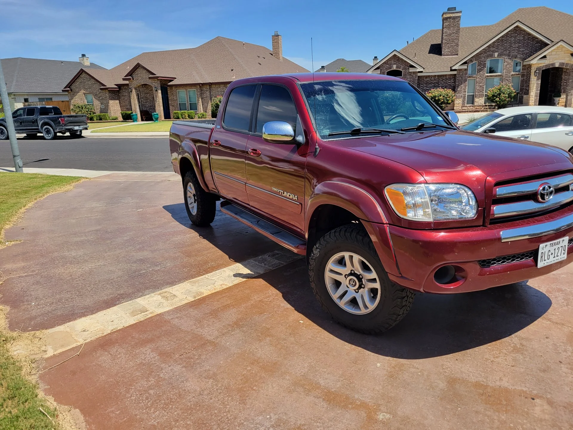

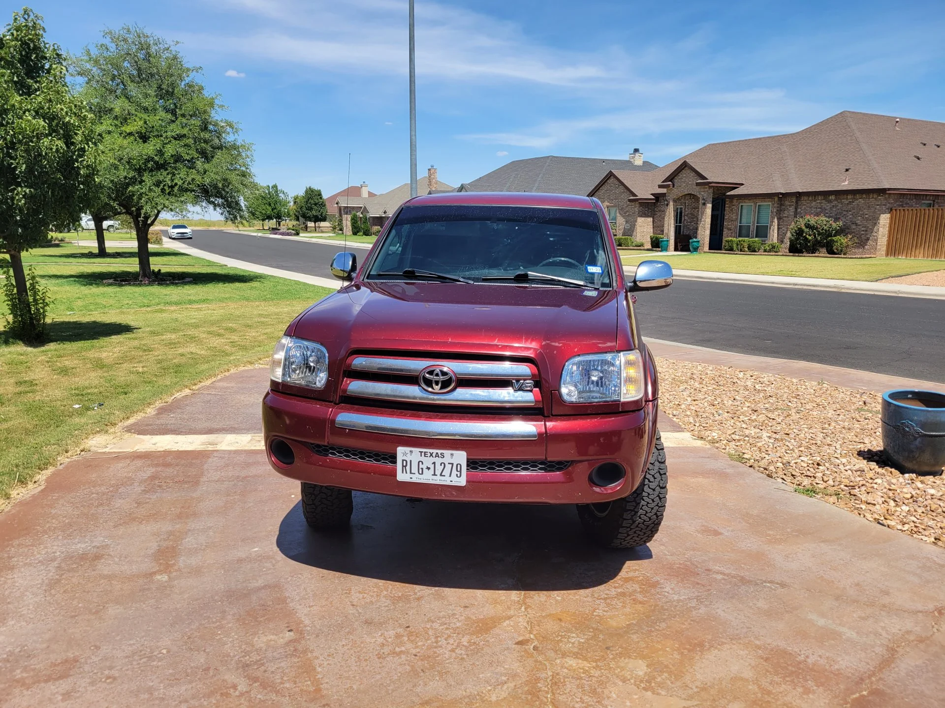

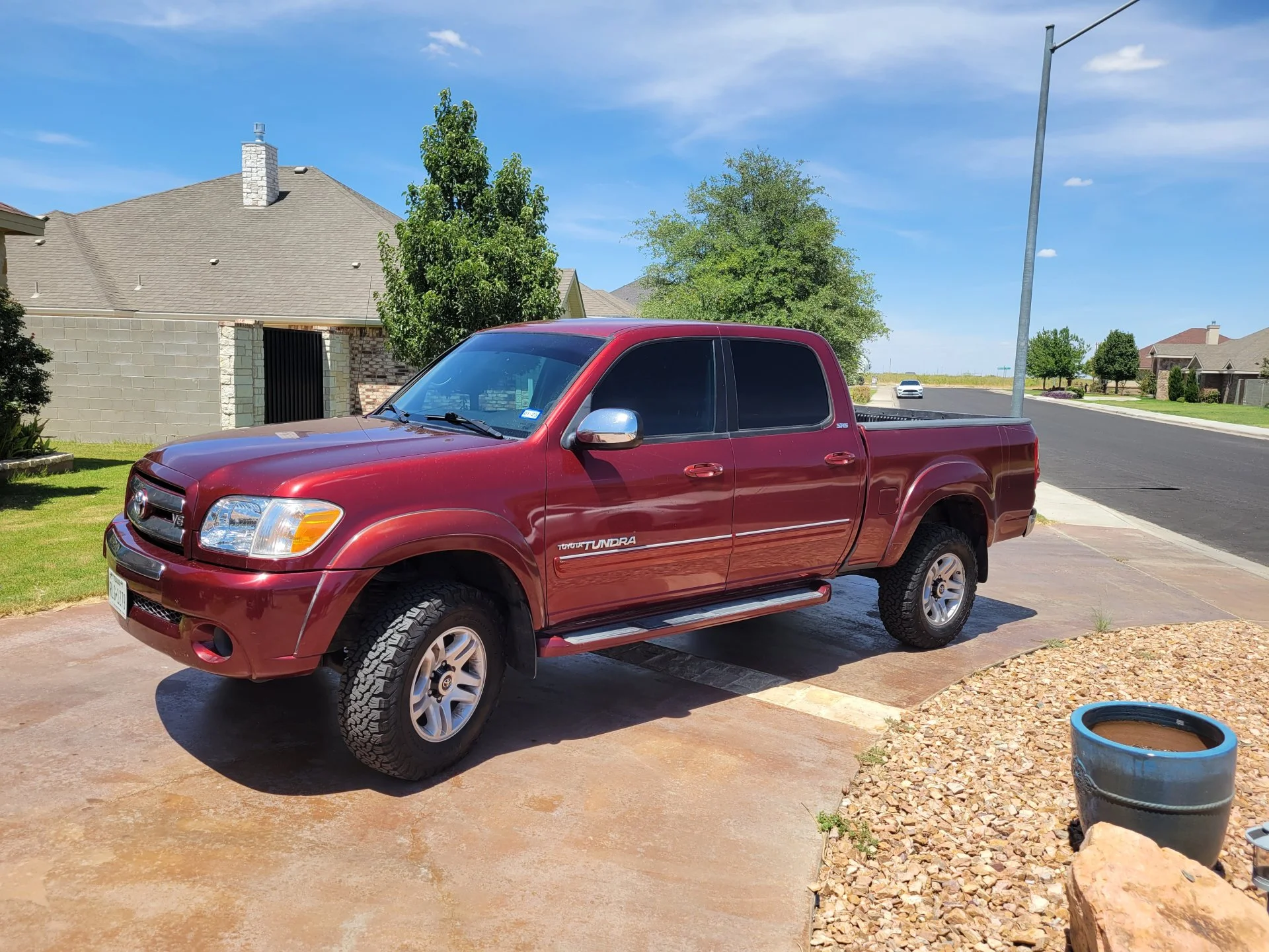

Nothing major. But put ceramic tint all around. What a huge difference in cab temperature. In the past few months since purchase I have added a rough country 3 inch lift, it's been very smooth and I am impressed for the price. It's not a toy tech by any means but it has been pretty nice so far. I also replaced wheel bearings all around, and lower ball joints. Replaced, steering rack bushings and got an alignment. Replaced all differential and TCase fluid. New Android auto double din, and jbl speakers. Replaced timing belt and water pump. New head lights and better bulbs. New tail lights. Oh, I had my cats and downstream 02 sensors stolen on a trip to Houston. Straight piped for now. It actually runs fine without it. But I'll fix that next. It's slowly coming along.

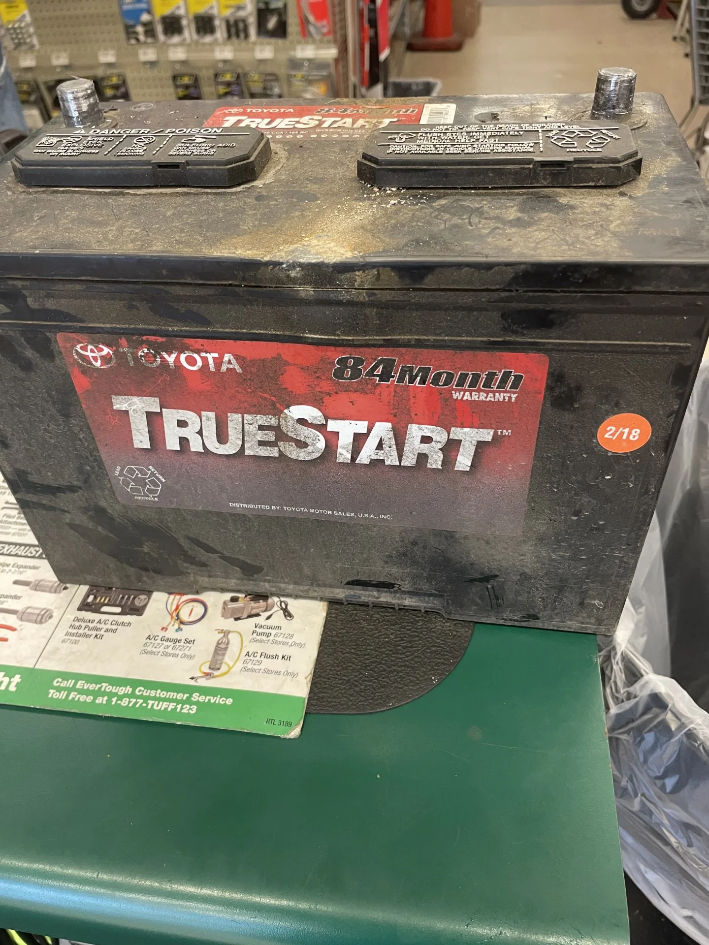

Don't TOUCH That, it's HOT! Wow, 4, w/You as center, it's a BBall Team! At Least they HAD a Battery! You do know they have TOOLS they'll let You Use to complete the task more efficiently than that Leatherman/Gerber/Buck tool, right? (I'm a leatherman guy, & yes, it's Always on me when not naked, But.....) Perhaps it's time for a small emergency tool kit? What caused the Battery to take a crap on Your afternoon?

Lol, I have three older ones too. I’ve got a basketball team if we ever played sports. I’m just grateful they had a battery that would work for what I wanted. I had all the right wrenches and stuff except for the terminal was a little too tight, had to improvise with my sons plethora of Leatherman/ utility tools that he has stored in his door pocket. Between he and I we’ve got quite the emergency tool kit at all times lol.
I’m not 100% sure why the battery died like it did, I was doing some electrical work trying to put new battery terminals to allow for the winch, auxiliary transmission cooler fan and the light bar. But ran into issues with the Amazon crap terminal expanders and had to go back to a more traditional battery terminal set up. So it was either the drain on the battery while it was disconnected or me testing the winch for the first time. I had the truck on so that shouldn’t have been an issue but for some reason it toasted the cold cranking amps .
You Really need a High Output Alternator And a 2nd Battery for a serious winch? Those LED off road lights aren't a serious load, but the amp draw on winches is Fierce! Wish I had a nickel for every jump needed by folks who thought just leaving the engine Idling was sufficient charging while winching out somebody else or themselves, then running back up 200' of cable? Especially where & when it's "Cold"? BTDT, & another thread I read earlier, I think in this forum, re: "JEGS, drop in battery tray & connections for Sequoias" where You still have to make up cables but adding 2nd batt. isn't a big deal. We have 2 8D's under/in bottom of ventilated tool box in bed(Tundra), & 2nd Type 27 on LC & High Output ALT is a Must. Isolator/switch is advised as well? You can kill a battery, multiple cells dead as doornails, when doing these connections, accidental contacts, etc. It does look like You got Your money's worth out of the original, if that's an '08? Batteries here (FL) are living on borrowed time after 3-4 yrs, swear.

Dude, awesome piece of knowledge on the JEGS drop in battery tray! That’s good to know! I’ve been wanting to get another battery etc. what sort of isolator should I use though? It seemed like there was a lot of cheap Chinese crap or super expensive ridiculous overkill things. I don’t winch very often, in fact it’s mostly just extra insurance if I ever get stuck so I don’t anticipate using it more than once or twice a year if ever honestly. But I want to be able to run it correctly when and if I need it.

You're gonna laugh (Everybody else has) but I used MARINE BATTERY SWITCHES....pop it from bank 1 to 2 regularly, and if winching, or jumping (I've jumped off Pinzgauers, Unimogs & Deuce & a Half's, Even a 20 ton Wrecker w/dead batteries) w/this setup. just switch to 'both/all'. You can run a 12k lb warn for 8-10 min. and be fine (that'll KILL STONE DEAD, most other single configuration batteries where somebody isn't sitting in the drivers seat pegging 2500rpms to keep the std alt. maxing the 90amp output, & sometimes even Then) & learned the isolator trick from 12v specialists. Starting battery, house batteries, keep 'em separate unless You need it "ALL", then go for it. A marine battery selector switch (located under hood, close to 2nd battery (saves on long copper runs....they aren't cheap these days) is Much Cheaper and just as efficient as the pricey fancy isolators. Just be sure to insolate/isolate behind the back where mounting (I used RV Roof Repair Tape, it's thicker than shower pan liner and removes any chance of 'grounding' from back side where all connections are). West Marine is probably the most expensive source, any marine surplus store or boatersland.com is probably most reasonable. I have 2 'house' batteries hooked up to a 3kw inverter in bed of a work truck & have never needed to lug a 'generator' to most work sites (that's in/on an '00 Dodge 2500 4wd w/Reading Utility Bed). Been rigging sailboats and doing construction work (as well as twisting wrenches) life long & i'm no 'whipper snapper'. I thought 'why would I spend all this money when something else I see every day will do the same thing?' I've even seen (Smarter folks than me) people do the whole setup, then POUR EPOXY in the back side & let it set 24 hrs, 'upside down' to accomplish the same 'insulating' process, then flip over & screw to the firewall. It's badazzed when done. Wish I had the truck here now (it's at shop 24mi away), or I'd shoot You pics. It's like a turbo, or better yet, Nitrus For Your 12V System! Don't 'reinvent the wheel' or pay somebody else to do it, or buy chinese crap. Somebody else already went there and did that, 100+ yrs ago! HTH?, -Mick
