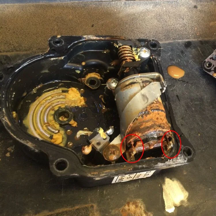

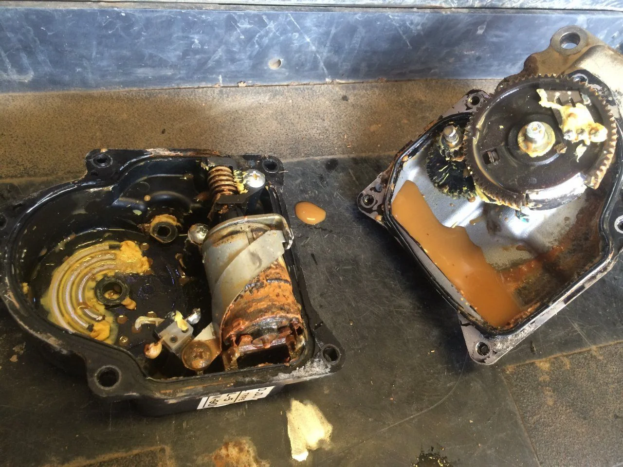

Found my problem with the front ADD actuator
breather tube had come loose, so any water crossing I hit and the pressure washing it got after my last trip sealed its fate.
Wow, makes me want to go out and check my breather tubes after swimming last week!
On a side note, from the factory the motor contacts are not soldered to the posts that are fixed in the housing, they just rest against each other. My original ADD had reliability issues, so I had read somewhere about the posts not being soldered. This ADD had actually been opened up, soldered then put back together with additional RTV on the outer edges (it has an o-ring type seal already). But the open breather port just sucked in all kinds of crap.
Dear god, man! Stupid question I'm sure, but is there a risk of water ingress in to the differential?
I'm sure a little worked its way in, but the inside of the actuator does not get oiled by the gear oil - only the shift collar and post get oiled. And I had to drop most of the gear oil to remove the actuator off the axle housing anyway, so new fluid goes in when this gets replaced. This isn't much different than the e-locker motor on the rear axle.
That is some nast right there... Are those gears plastic? nust not be a lot of stress on the.

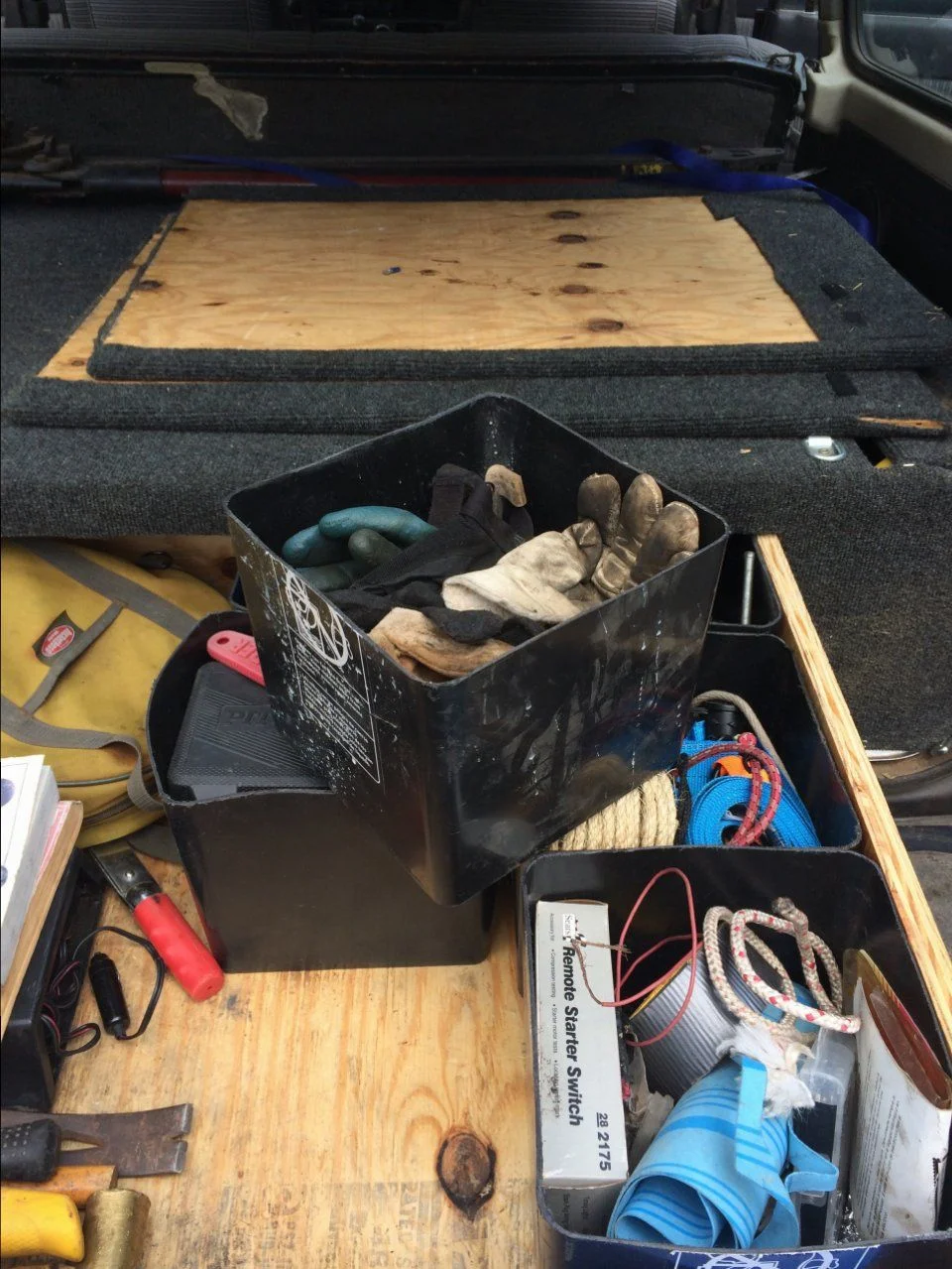

Changed the oil and checked the rig over for this weekend to OTMT. Well as you can see the box was pretty disorganized, well I had a ton of these square buckets that came from lowes old chain buckets. So I cut them down and used them to keep all the crap from rollin around in there. Worked out quite nicely. You can usually ask an associate if they've got any empty ones, best part it's free!

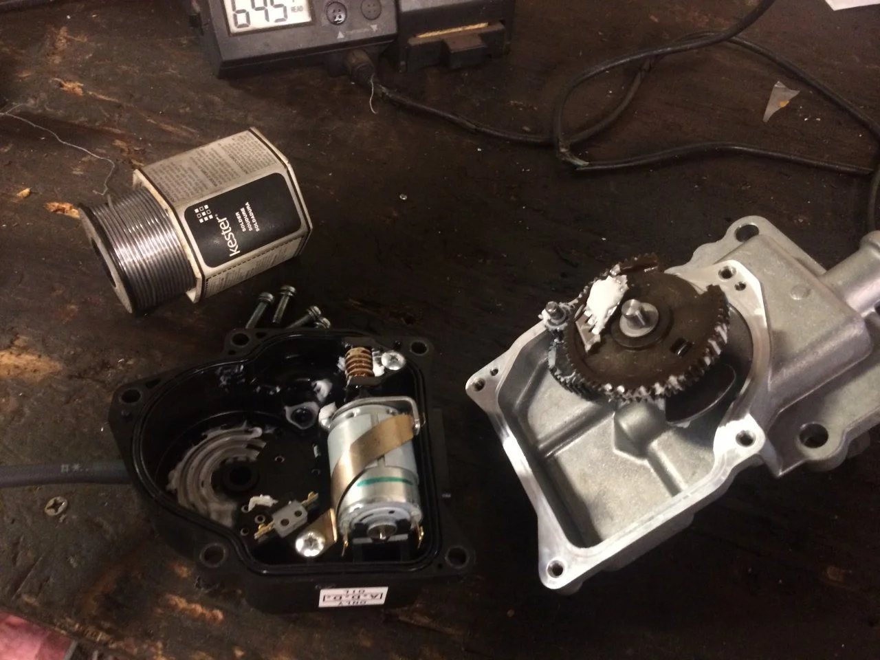

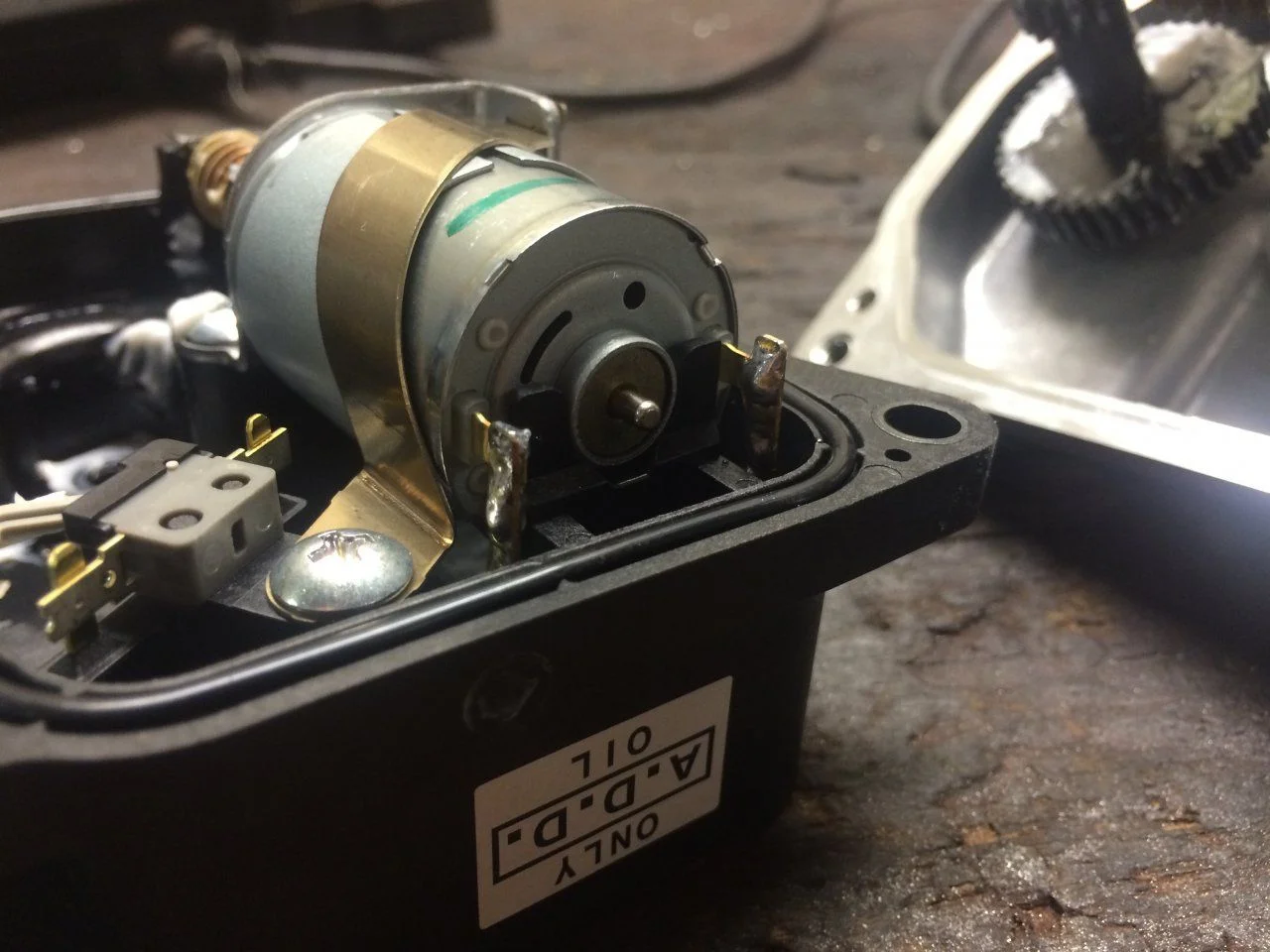

Got my new actuator installed and so far so good. Opened it up first and soldered the motor contacts to the power poles. Ready for Golden Mtn!!!
