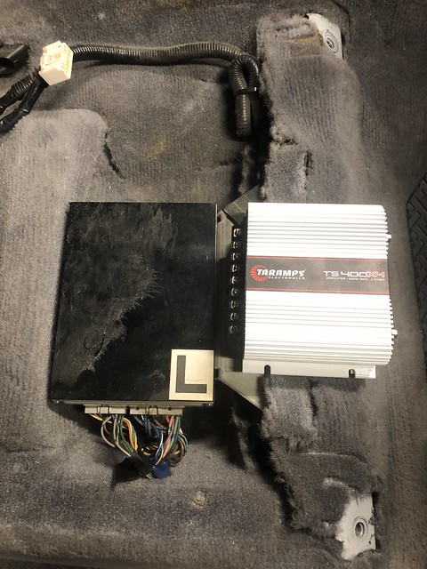

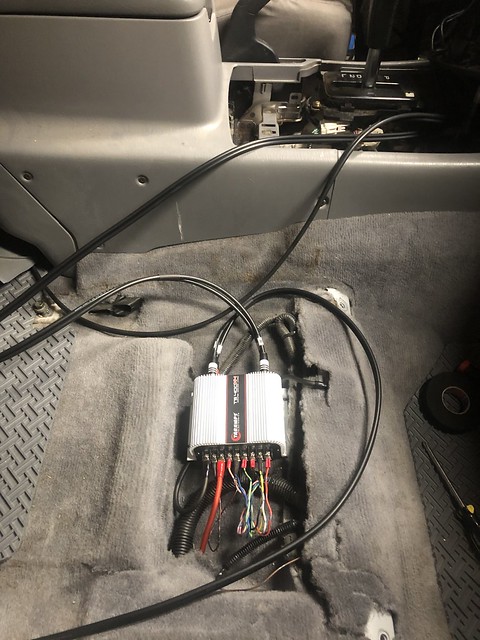

Spent the about 4hrs today replacing the factory amp in Alita today. This was one of the final stages of the stereo upgrade. The stock amp has a floating ground issue when a new headunit is installed. Luckily the site TLCFAQs has a great wiring diagram to bypass the factory amp (if necessary) and also shows speaker wiring and amp trigger wires. Last part of the replacement will be replacing the rear door speakers and then eventually adding a small compact powered sub in the rear. The sub mount will take some fabrication so I got to figure that out first as I want to keep as much room as possible back there for dogs, camping gear, etc.
Old Factory (Old n Busted) vs. New (Hottness)
Factory amp was 170w x 5-channels from what I have read. New Taramps is a 400x4 (both at 4ohms).

Here she is in her new home. I need to do different RCA interconnects as these ended up being WAAAYYY too long.
