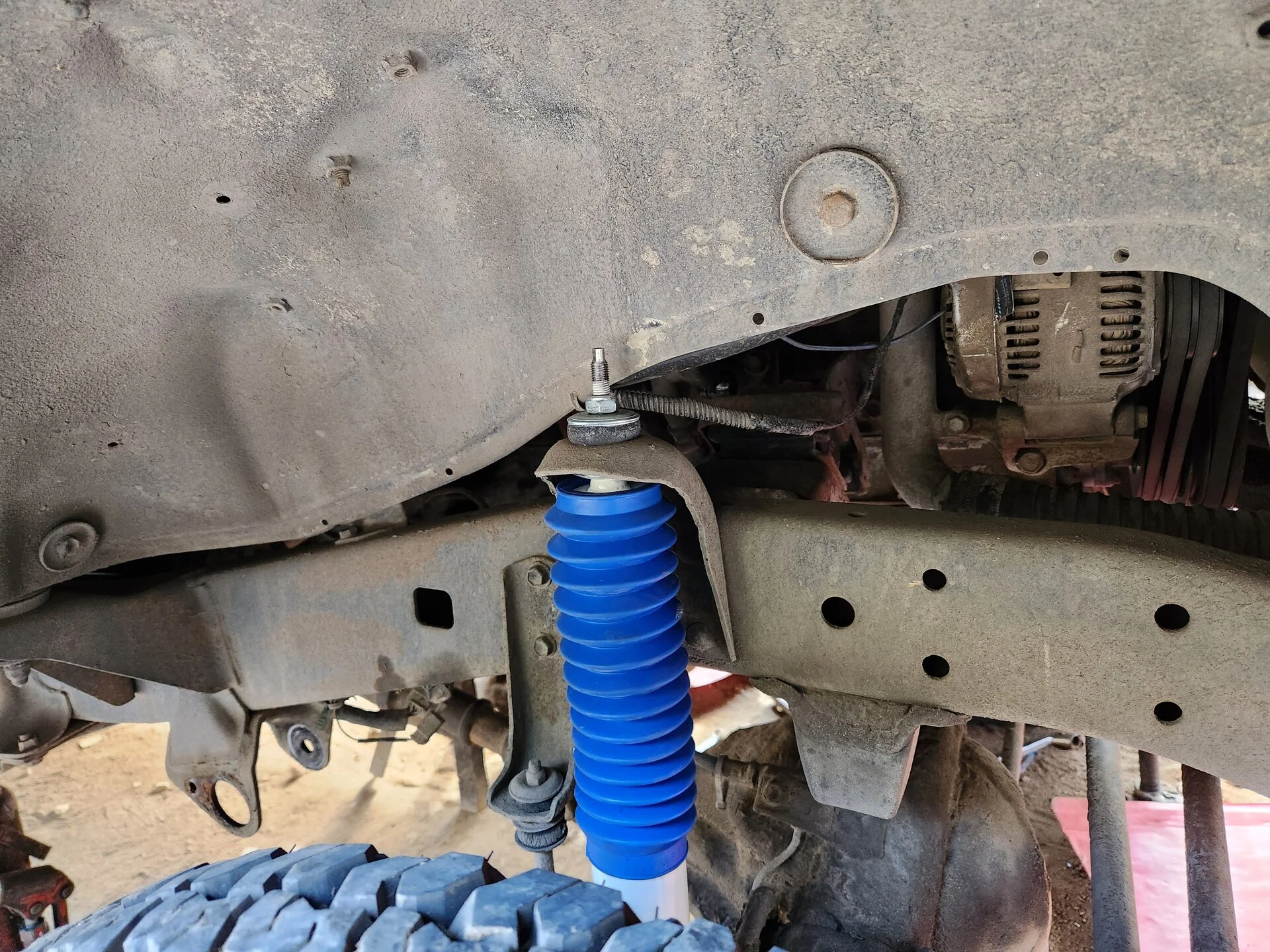

Replaced steering damper and new front shocks. Back ones are still in shipping.

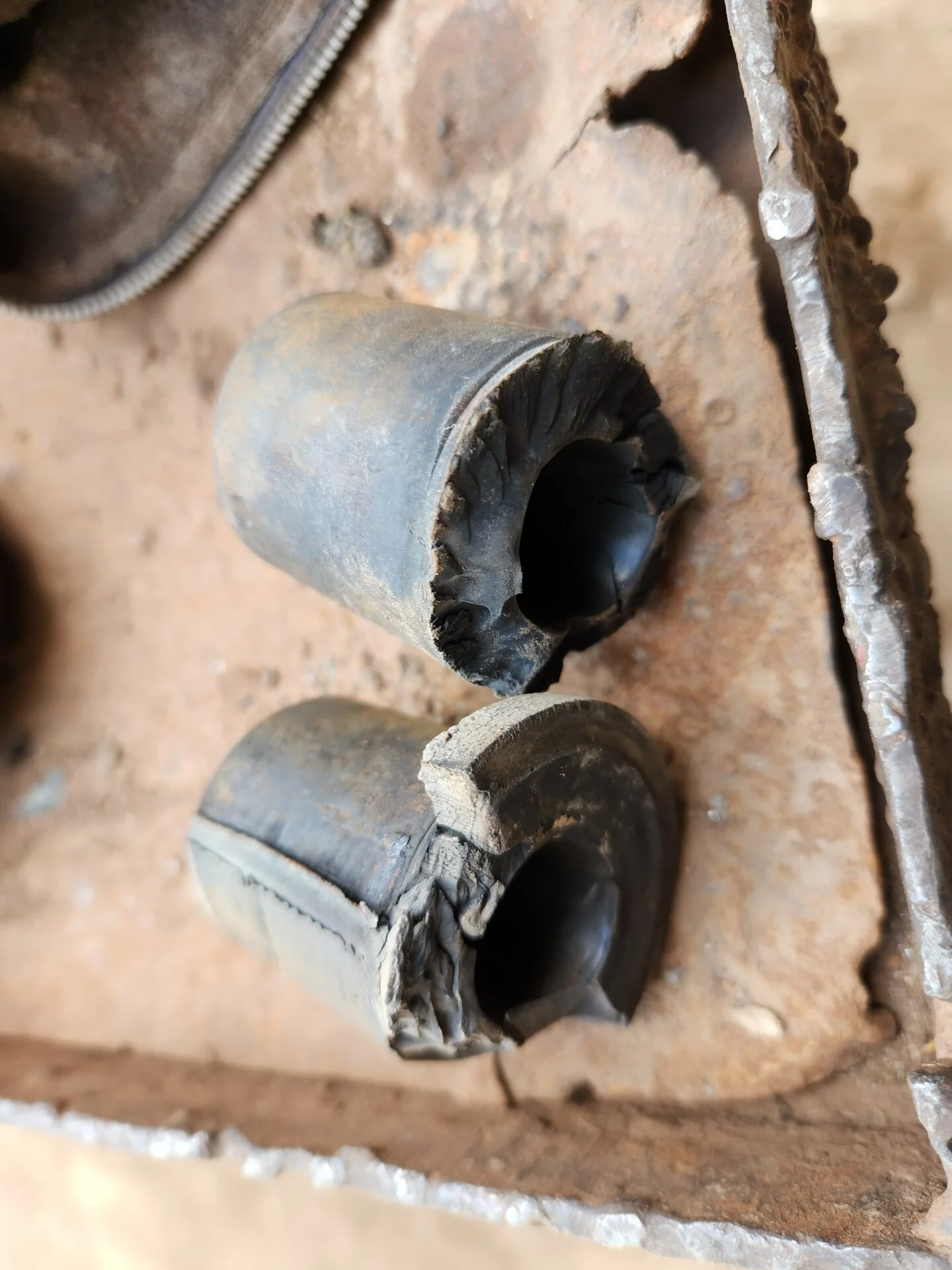

Changed rubber mounts (old ones where shot).

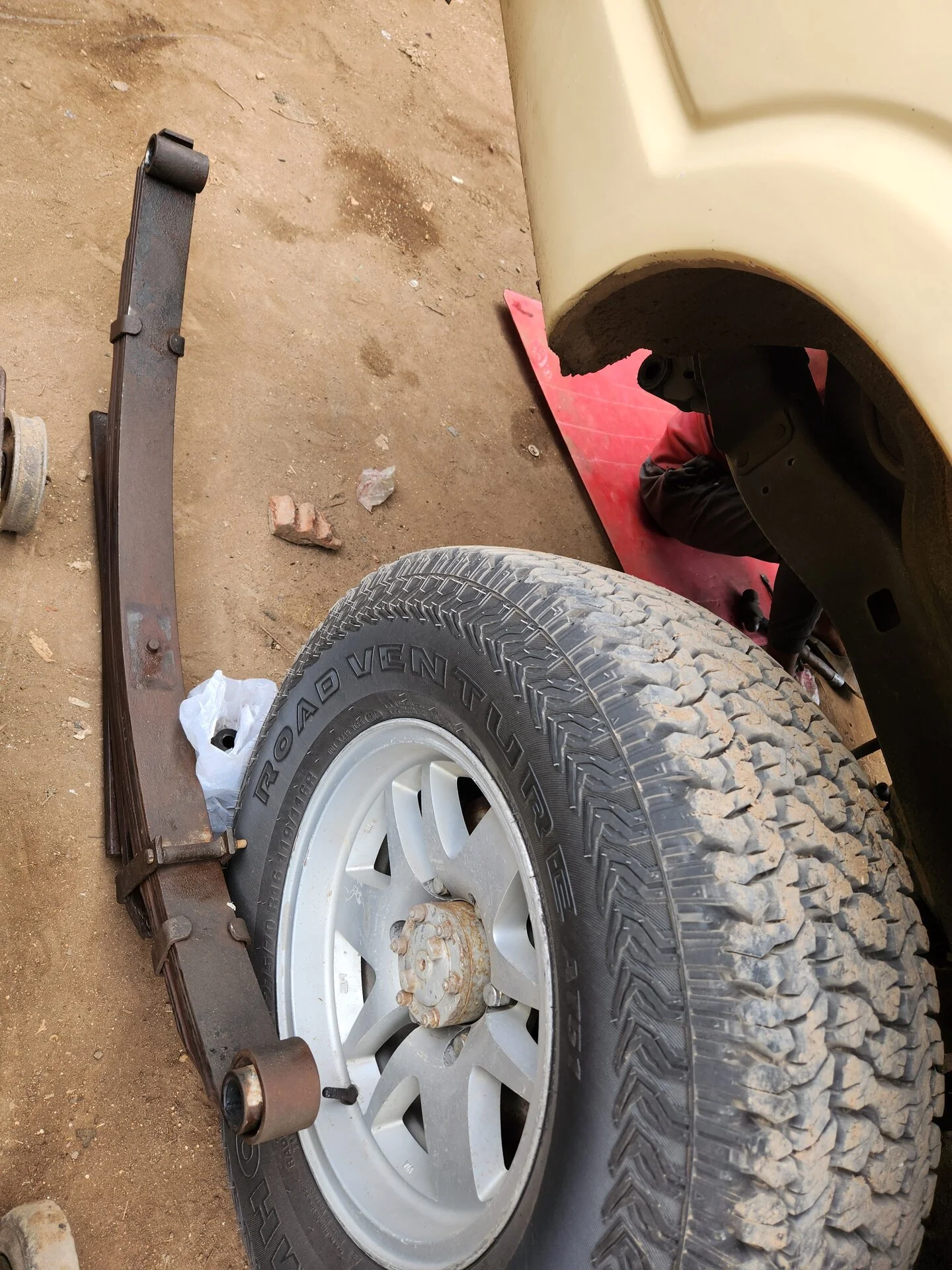

Cleaned & greased leaf springs.

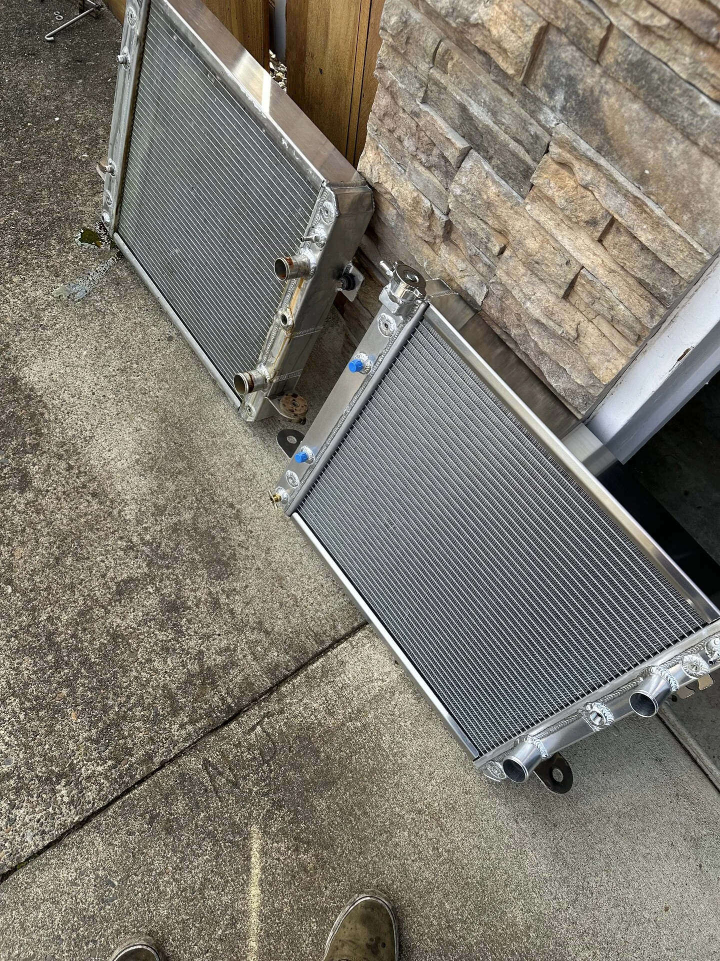

Got my replacement radiator in because my first aluminum radiator corroded from the inside out from .2-.3 volts running through the coolant from a bad ground. Idk why the internet says .3 volts and less is ok, it totally destroyed mine.

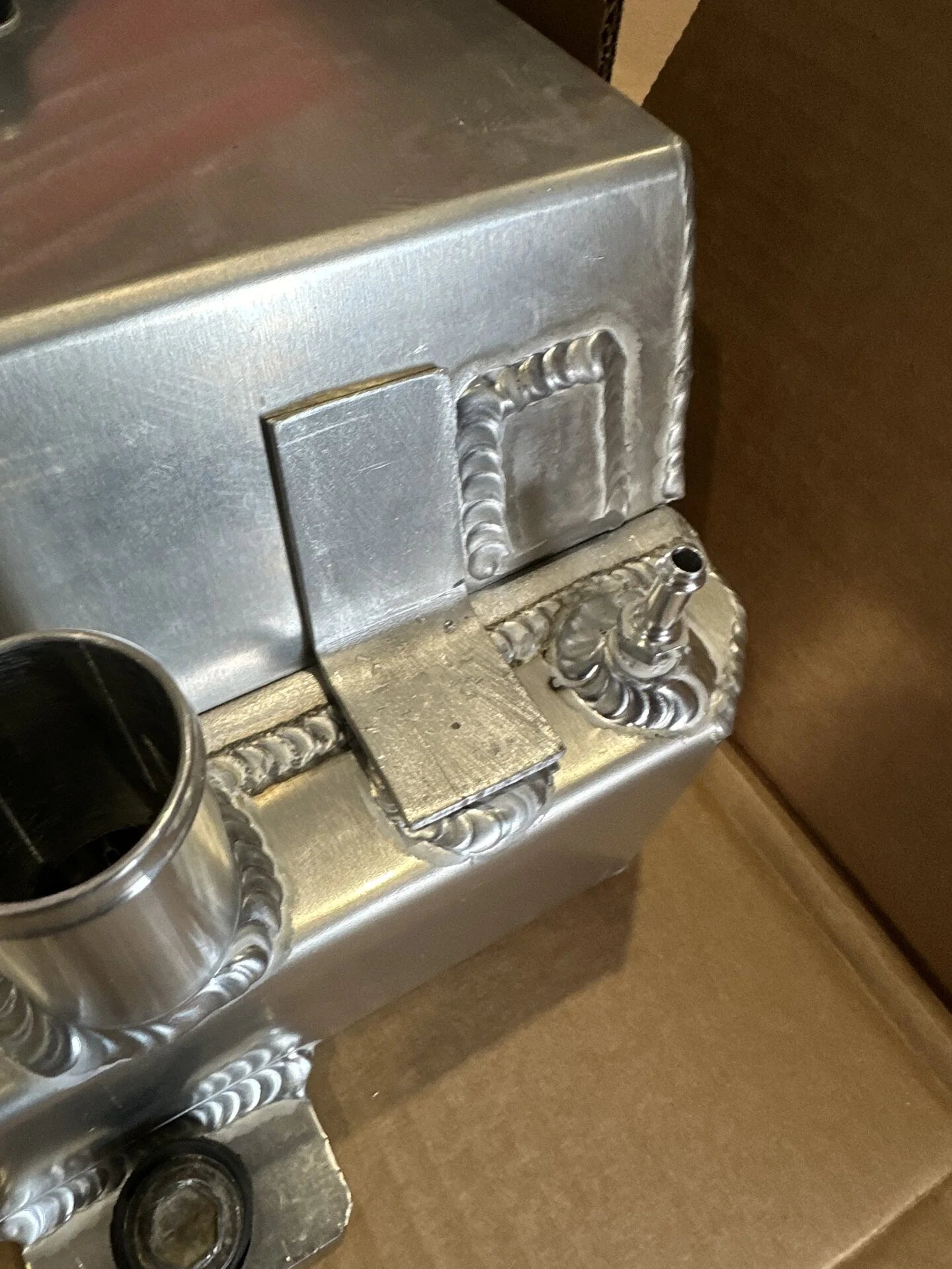

Unfortunately the replacement had the steam port and my fan shroud bolt hole flip flopped. Also, the mounting holes weren’t spaced correctly on the two main flat mounts, and the rubber grommet holes were too big to have the rubber grommets do anything.
Had to ovalize the main mounts with a carbide bit to take up the 2 cm that the holes were off and use a series of washers for the grommets to work and not just smoosh through the holes when I tightened the bolts. For the incorrect positions of the threaded hole and steam port I had to cut off the tab from my shroud and make and weld a new one.
Old vs new. Top right you can see the differences in placement.
I don’t think the nipple goes there
Thankfully had some scrap aluminum sitting around from a picture frame stand or something

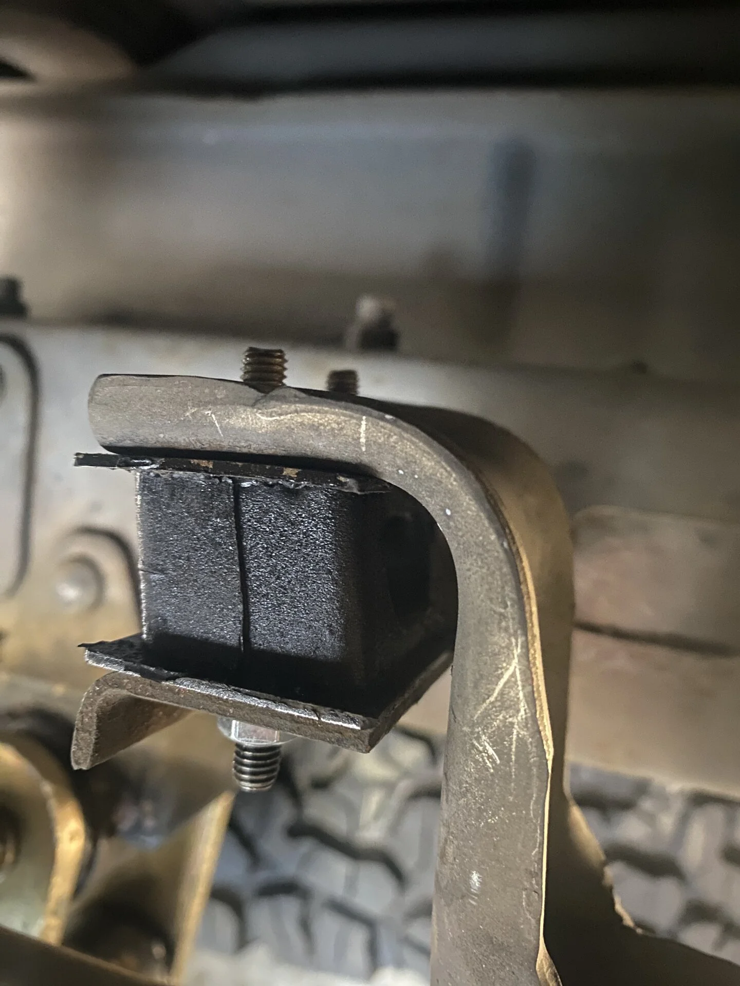

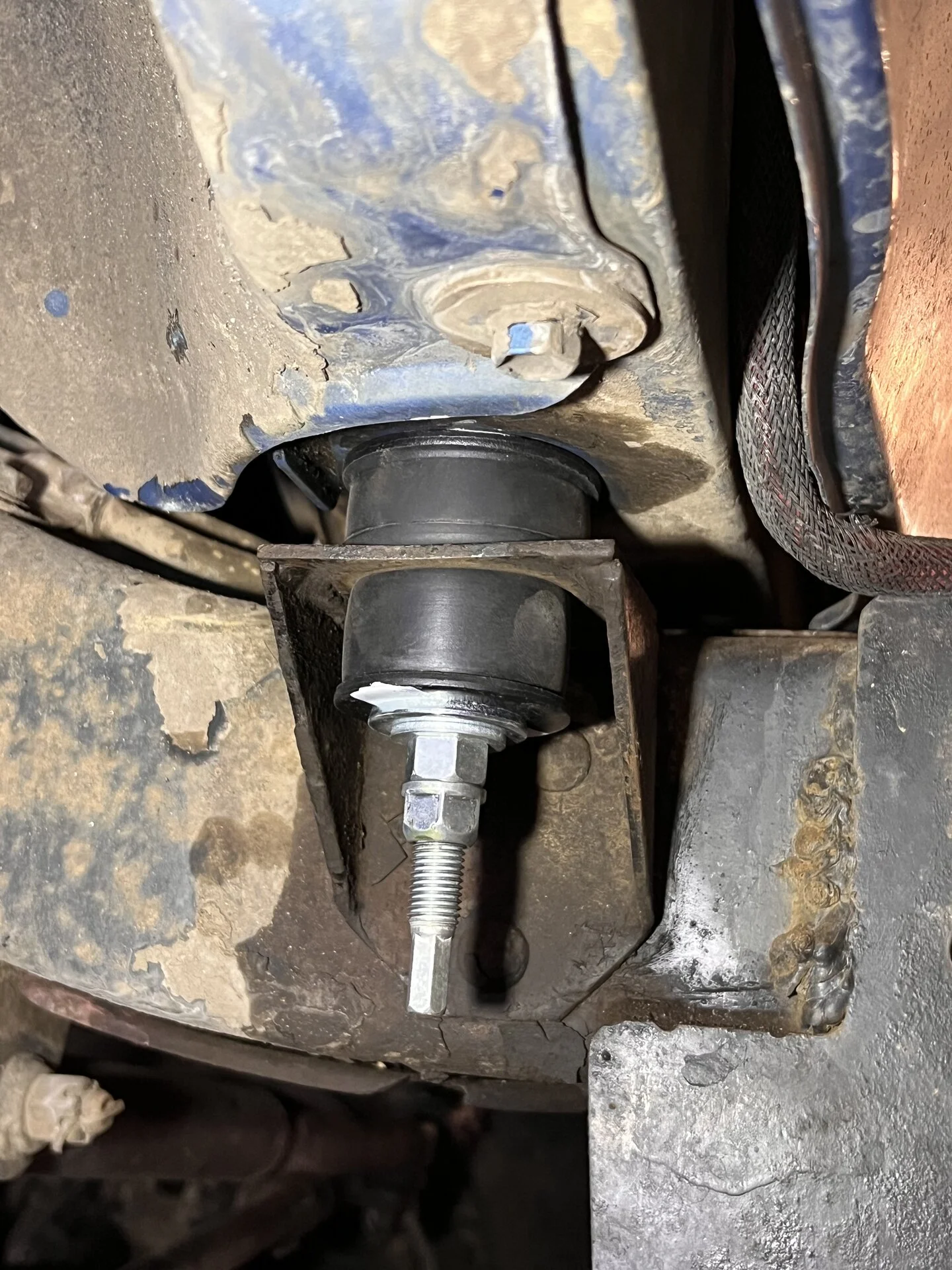

✔️New OEM body mounts on the front corners

The front corner body mounts on my truck are much worse than the rest - chunks of rubber were falling out. Replaced with OEM. I wanted rubber rather than poly to maybe have a softer ride and less rattles, even if they won’t last as long.

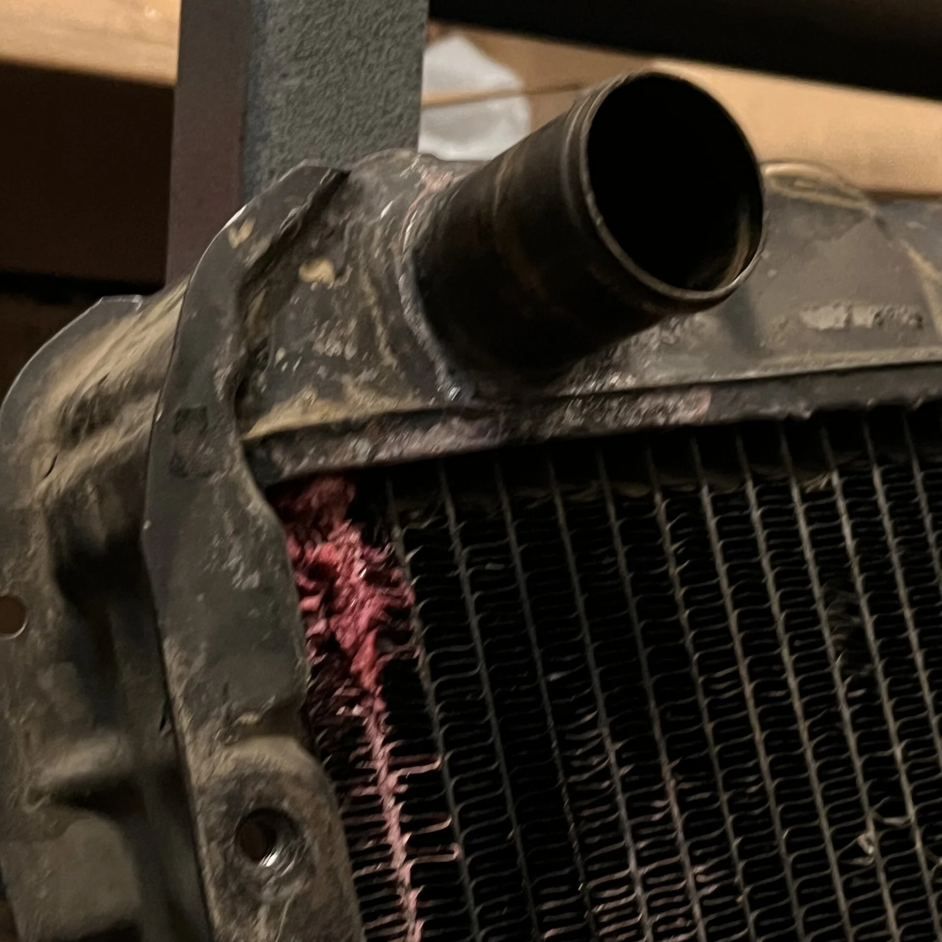

Original radiator put in 42 years of work and was leaking badly so I picked up a gently used CSF from @Rockymtnreaper with the intention of getting by until I get the original repaired. Got it in, forgot to move the fan shroud out of the way and it was pinched between the diagonal frame gusset and the lower rad tube inlet. Had to take it all apart and readjust. At this point I’ve been going all day, it’s 11PM, so I fill the thing up and start driving home. About 1.5 miles down the road my temps are creeping up fast. Takes me 1/4 mile to pull over and shut it down, and at that point my temp sensor in the upper rad hose is showing 240*F and the coolant is boiling. Oops - I forgot that when I filled it when the thermostat was as closed, so I was only partially filling the system. Waited for temps to come down to about 170, cracked the cap, and filled it. It took in another 1.25g and was cool all the way home - arrived at 12:45AM this morning.

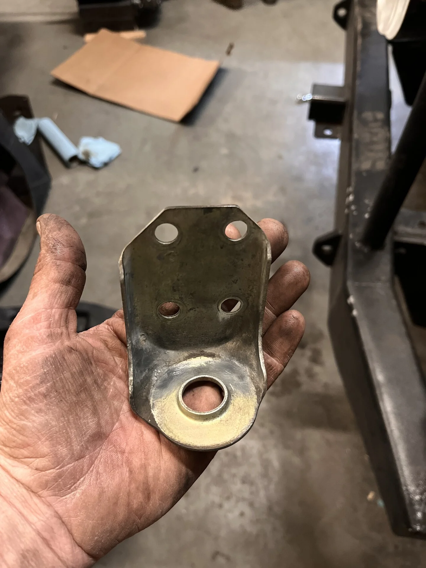

Questions: how much damage could I have done with the short overheat condition? Also, these radiator brackets shown below are directional, but I forgot which way they were when I took it apart. Anybody know how they go? The difference is that it can move the whole radiator about 1cm closer or further from the front sheet metal.
