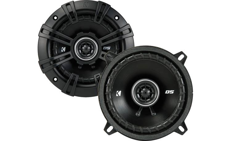

I swapped out the junk front door speakers for these 5.5" jobbies and covered them with the speaker covers from CruiserCult
